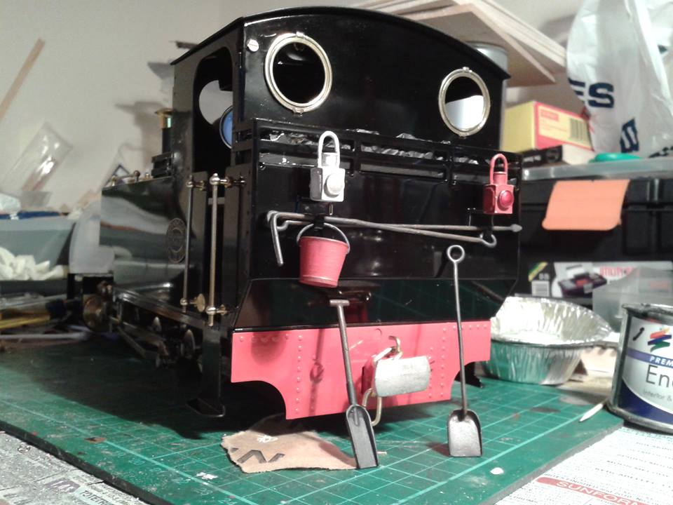

in other news, I'm given her some tarted up bits....all from roundhouse. The light on my phone camera is not doing anything any justice though...
That's all folks.

That looks great!! Getting some of the Roundhouse tools ect was part of my eventual plan. Dont need the lanterns as I have my Regner ones that I can actualy light up eventualy. The water on the roof will be normal till you get a chuff pipe. That will stop most of the water from squirting up the chimney and instead cause it to drain back under the engine from below the smokebox. I highly recommend you get a chuff pipe from Summerlands Chuffers, you wont regret it. Cheers Mike

Decorating a locomotive with useful little metal bits is fun. I think I will order some of those firing tools too. They look good.

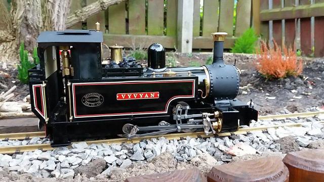

Anyhow, she is now complete, the lining is not the best but it is trimline and one day I might get it professionally done. or risk doing it myself.
Real coal has been added and detailing is by Locoworks and Brandbright (RIP). unfortunately I'll need to reattach the front vacuum pipe properly as whilst in transit it broke and is temporarily fitted on with Uhu superglue.

[/urlAnyhow, she is now complete, the lining is not the best but it is trimline and one day I might get it professionally done. or risk doing it myself.

Cheers chaps, she is a jolly little loco now I've added everything. I'll give you a brake down properly once I get the photo's sorted.

Welcome back Sylvian, it has been a while.
Good to see Vyvyan lined out - all the better if I may say. Seems like she has settled down to become a good performer as all Roundhouse locos do!

Couldn't agree more. They look lovely as the basic model but adding stuff just enhances it tenfold. She was frothing a bit but I think I over filled the boiler too much apart from that no problems at all, if i do get another I have my eyes set on a Katie.
