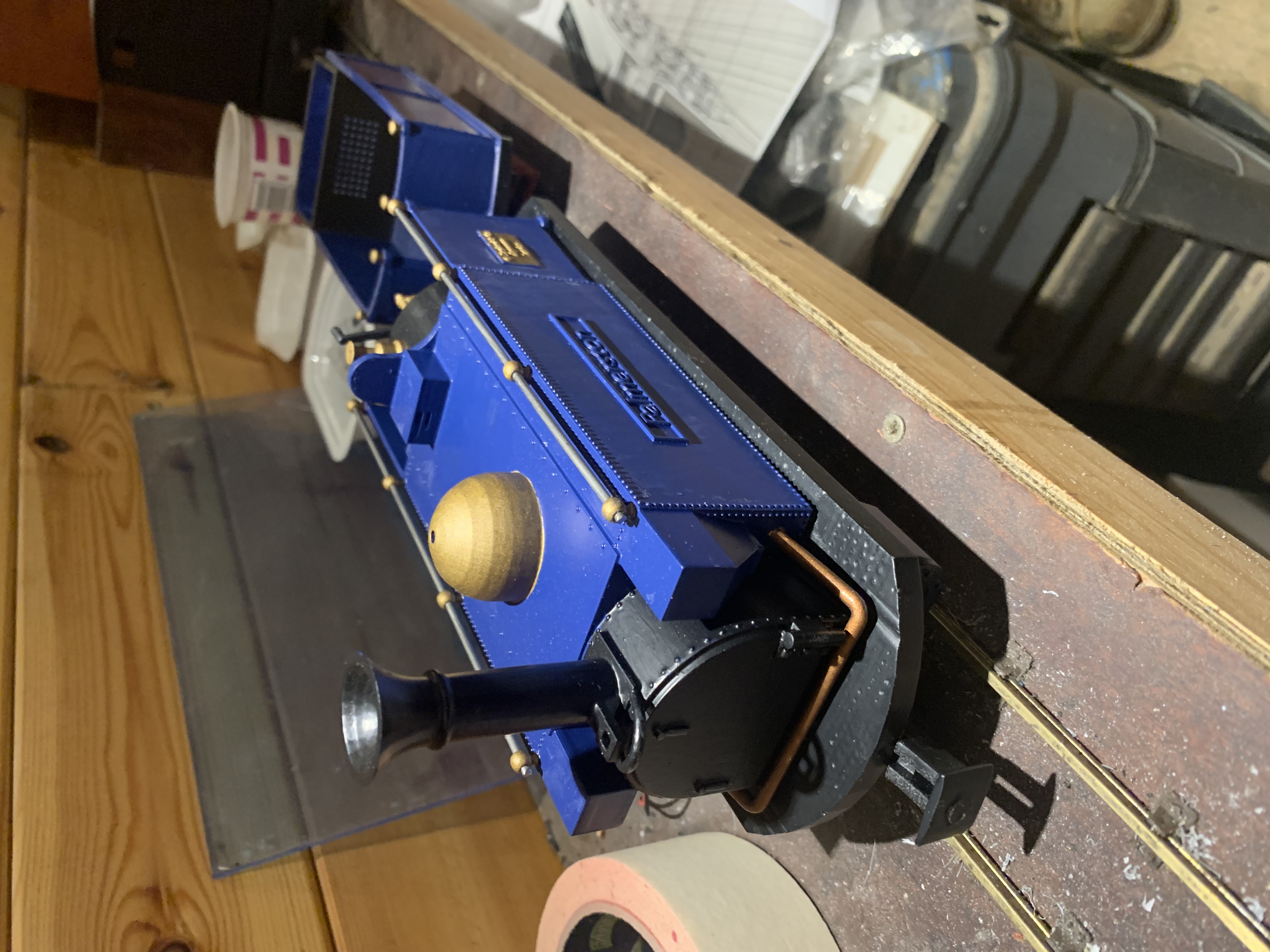

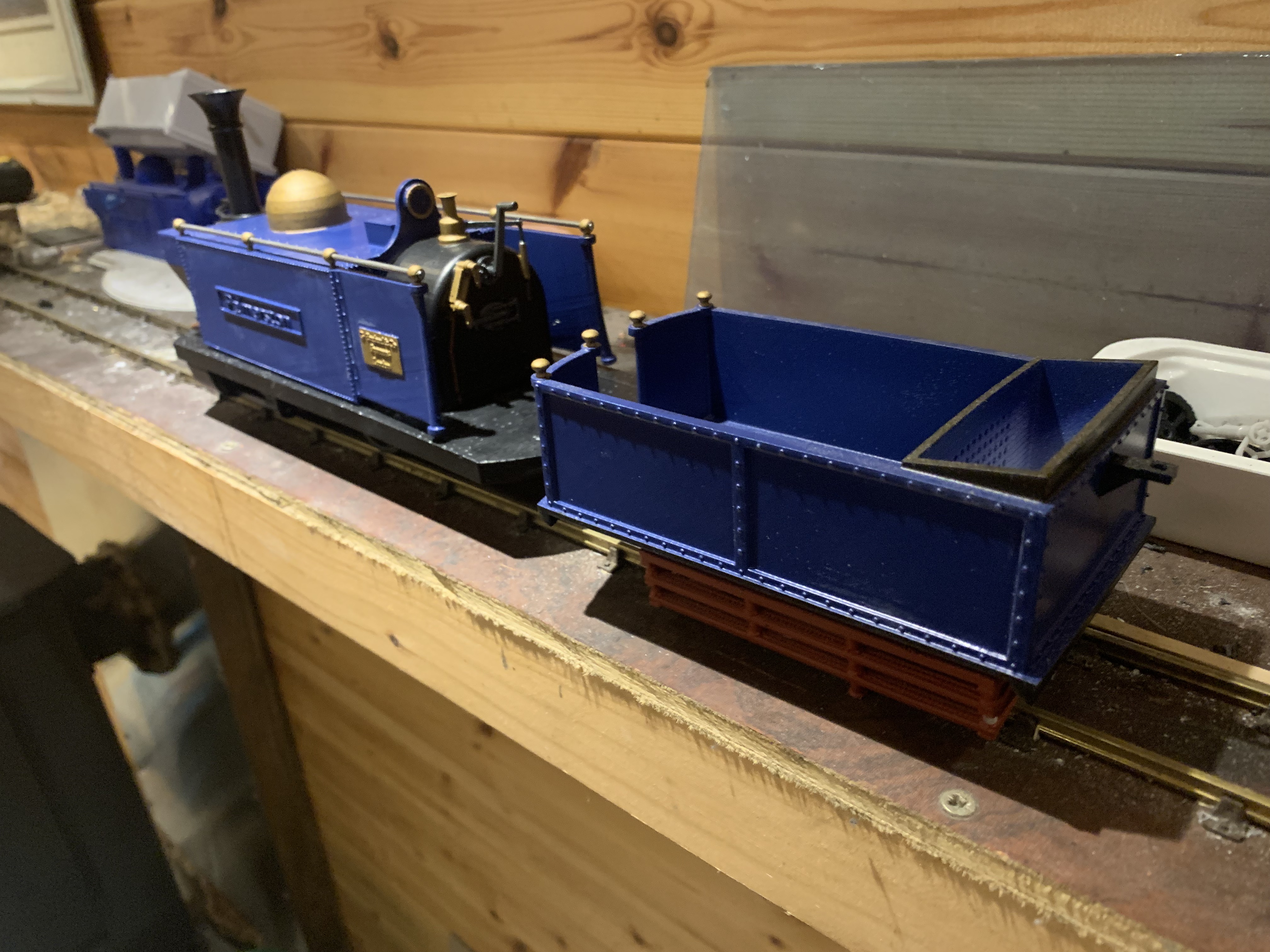

Progress on t his has been slow - I am at the painting stage and the different layers need to dry properly.
I did reprint the body again, and this time I am satisfied with it. The one major change I made was to remove the handrails and make a hole through the handrail supports to take a 2mm diameter stainless shaft. The plastic handrails tend to distort readily - and metal handrails are much more robust. I expected that the brackets would be delicate but they have proven to be very robust. Printing a hole through them worked, but it did need "Reaming" to take the handrail. I did this by sharpening the end of the handrail and careful twisting it as I pushed it into place.
The tender is ready to take a sound card and speaker, in due course. There is more painting to be done, the nameplates, and then the lining.
The one thing that has not worked perfectly is that the footplate side screens have warped outwards slightly at their rear ends. They are held straight by the handrail at the top - but the bottom is still slightly warped outwards.
The bases of the stanchions cant be permanently fixed to the footplate as they are part of the body - which has to be removable. However I think some form of support to locate them would be feasible. Perhaps a rod inside the stanchion, going through a hole in the footplate.
The motion works correctly, and only one motor is required. I don't think 2 motors on a coupled wheel set is actually going to work - the motors seem to work against each other to some extent. I am currently connecting up the batteries and radio control.

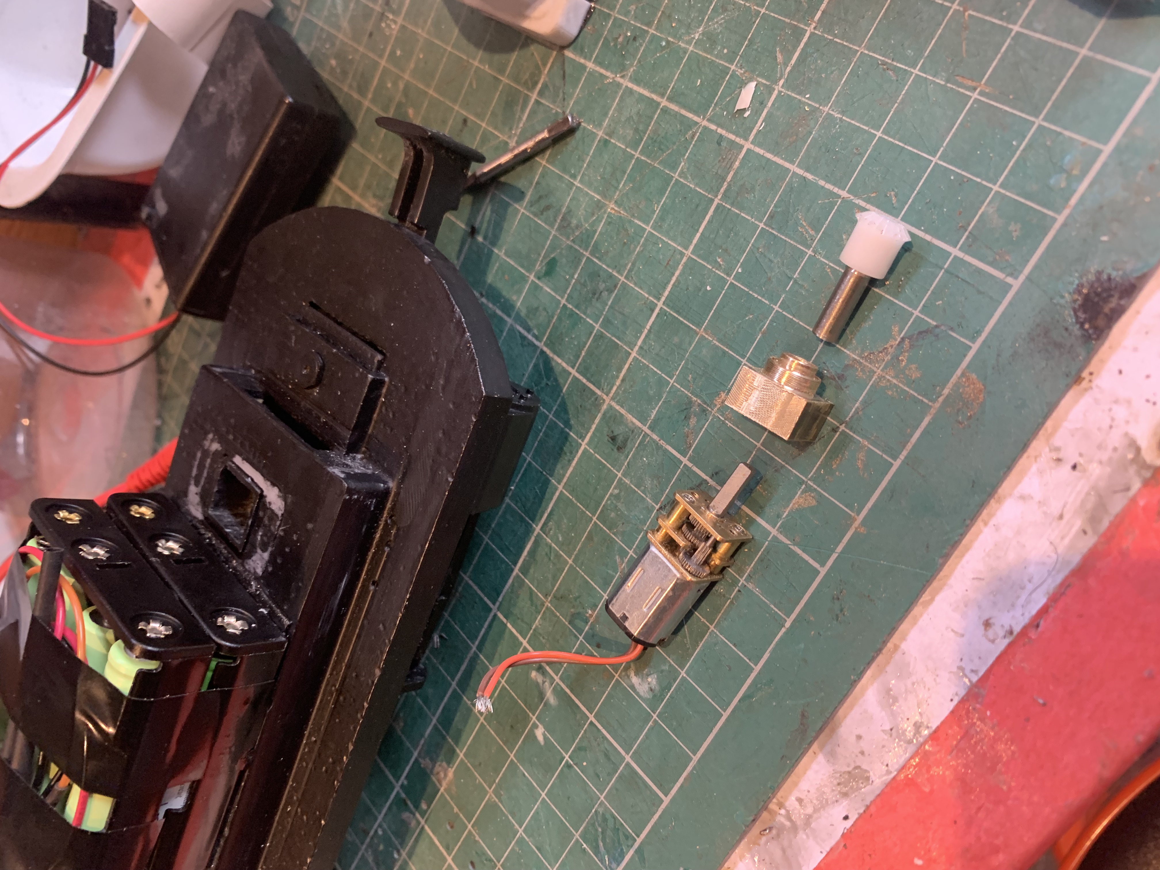

Progress on Palmerston has been delayed by a problem with the motor and the bevel gear drive. I have solved it and I thought it might be worth sharing the problem and my solution - in case anyone else has issues with these miniature geared motors (which I have been buying via eBay).

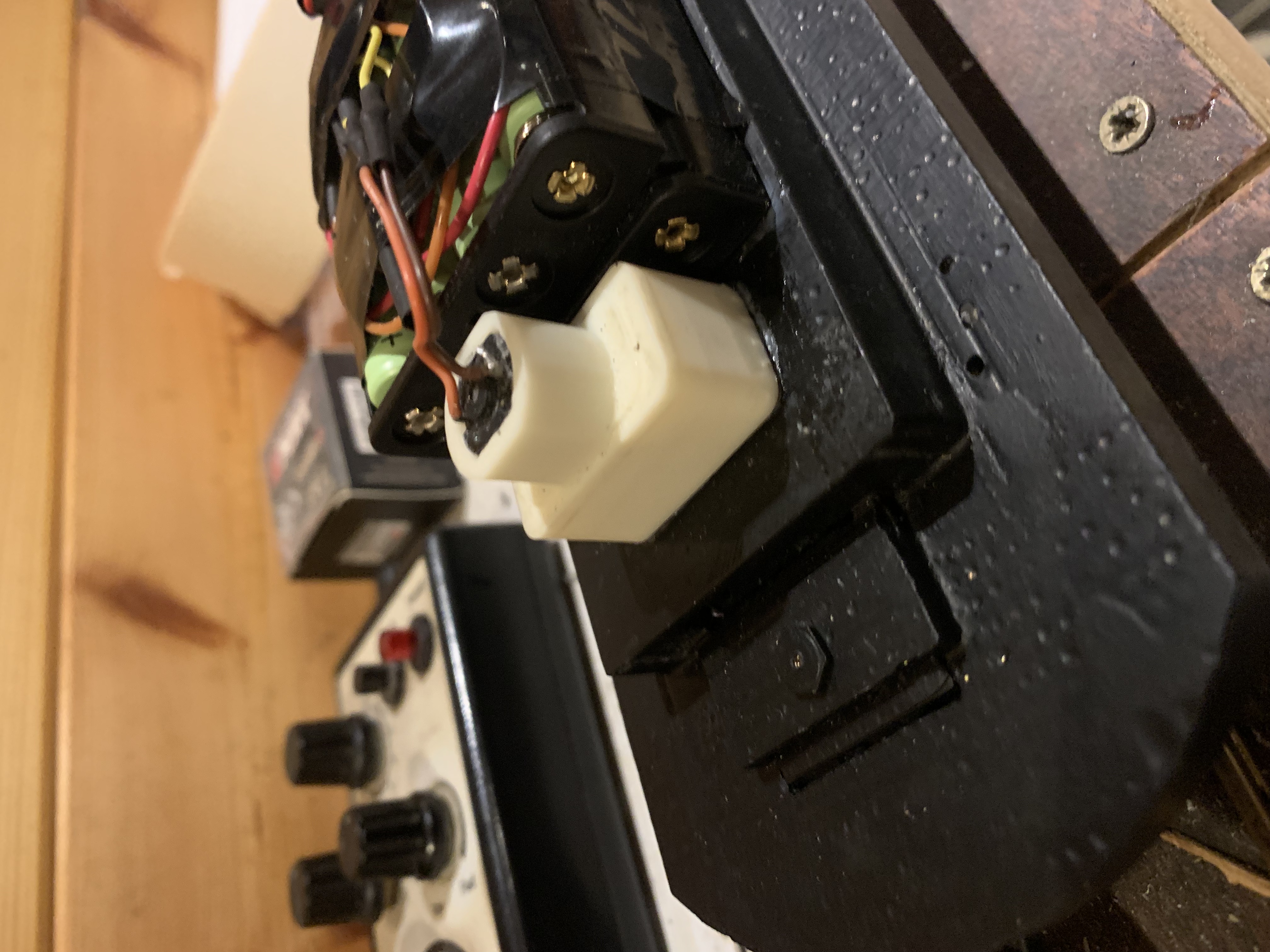

So the problem was that I mounted the bevel gear on the end of the shaft like this:
The gearbox fitted inside a rectangular depression in the footplate and the gear engaged with a similar gear on the front axle. I found that the play in the output shaft of the gearbox enabled the gear teeth to move sufficiently to disengage. So the locomotive stopped - and made a horrible noise.You can see that the gear is at the very end of the shaft - which was part of the problem.

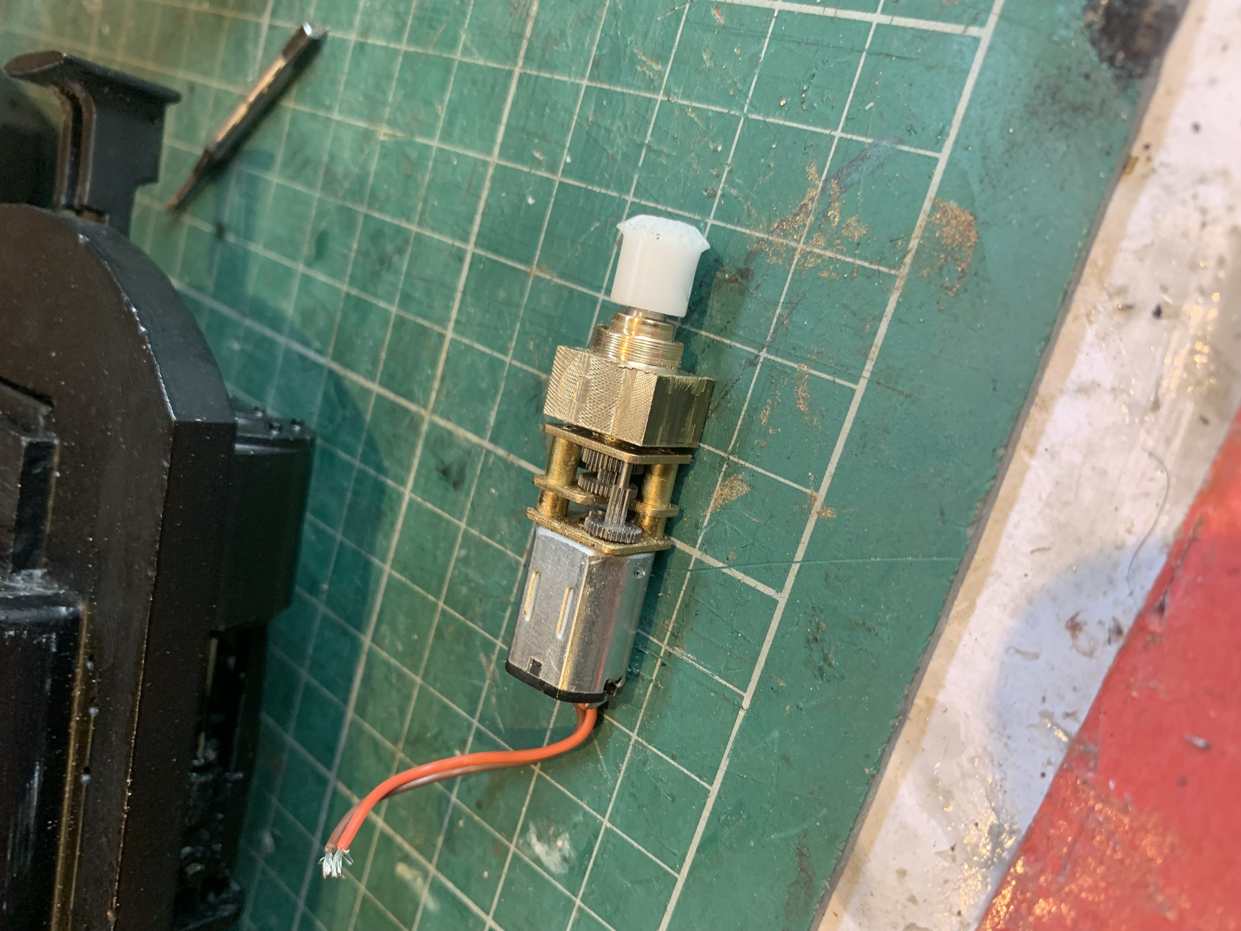

The solution was to extend the output shaft and to make a bearing to support the shaft properly. The components:
Screenshot 2024-02-09 at 09.33.19.png (70.5 KiB) Viewed 36940 times
Screenshot 2024-02-09 at 09.34.56.png (60.34 KiB) Viewed 36940 times

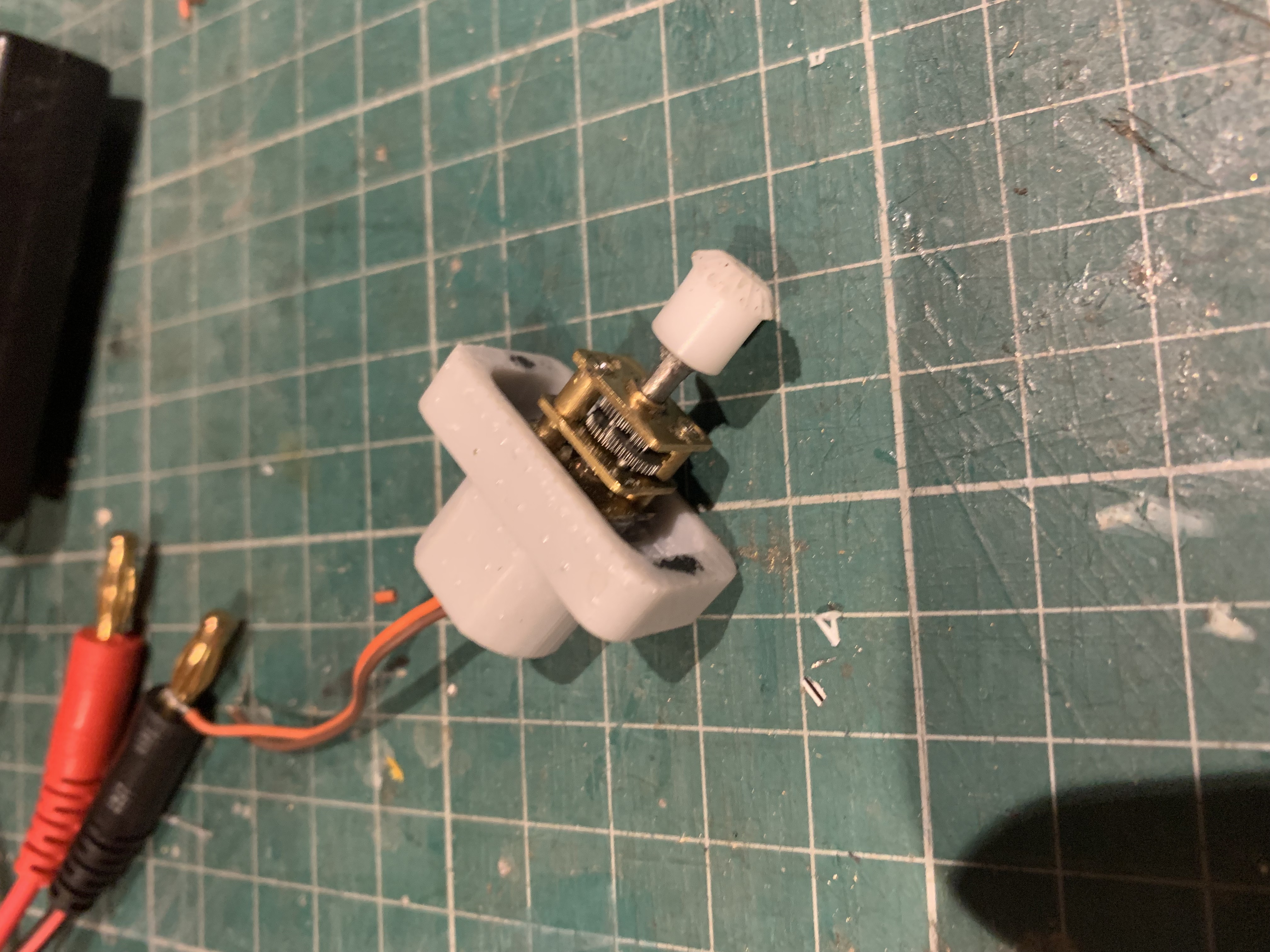

The bearing is the same size overall as the gearbox so it slots into the space where the gearbox was mounted, and the 4mm diameter reamed hole in it engaged properly with the 4mm shaft extension. That extension has a 3mm hole in it for the motor shaft and the extended bit is reduced to 3mm diameter. The components:
Bear in mind that the motor shaft was actually a bit small to grip the 3mm hole in the gear properly, and that shaft fits easily into the hole in the extension.
Assembly required the bearing to be pressed onto the shaft extension first. I used a spare length of 3mm rod mounted in the lathe to hold the shaft extension while I pressed the gear on with the tailstock. Then the shaft extension and bearing were mounted onto the footplate with a couple of drops of superglue used to hold it in place. That also made sure that there was little end float allowing the extension shaft to rise or fall (to prevent the gears disengaging). The assembly before fitting:
The motor was connected to the shaft extension using bearing retainer to lock the shafts together. Of course the motor body was free to rotate at this point so a modified motor mount was printed, and superglued in place:
Having connected the motor to the receiver I can confirm that the chassis is running properly with no hint of gears disengaging. It is also quite powerful, easily pushing a long rake of goods wagons.
