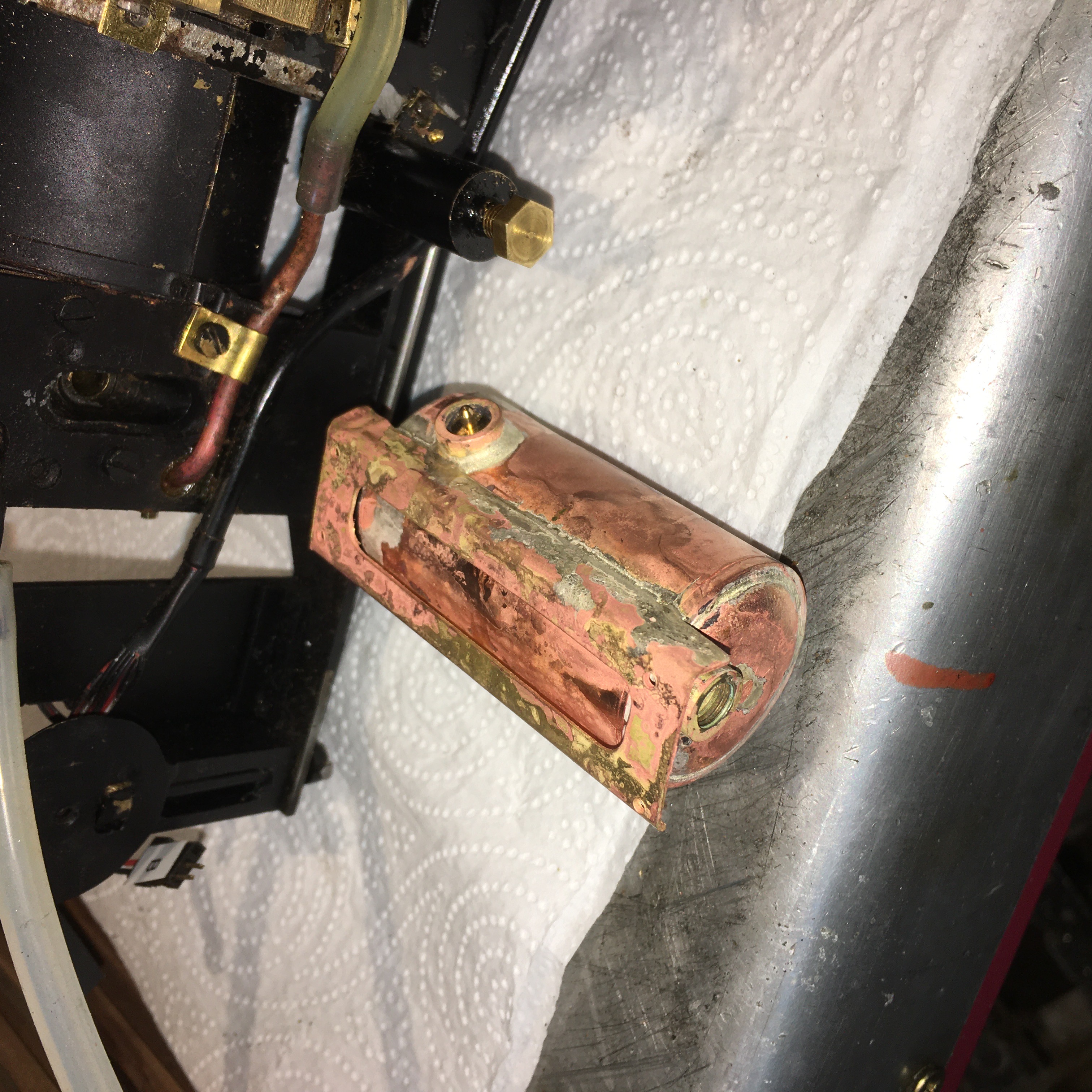

Believe it or not I have been working on this since I last posted.
That steam test didn't work out - not because of faults on the steam system, but I just couldn't get the coal to burn.
So I tried it in the multifuel burner in the house and it wouldn't burn there either. Not even in a roaring log fire.
Trying to run K1 on bits of smashed up BBQ fuel just didn't get steam to be generated fast enough - at least that is what I think was happening.
So I am in the process of making a gas fired burner for it. Not that I have given up on coal firing - but I need to get small amounts of proper coal and charcoal for this purpose. So duel fuel seems a good idea - if only so that I can separate out the issues.

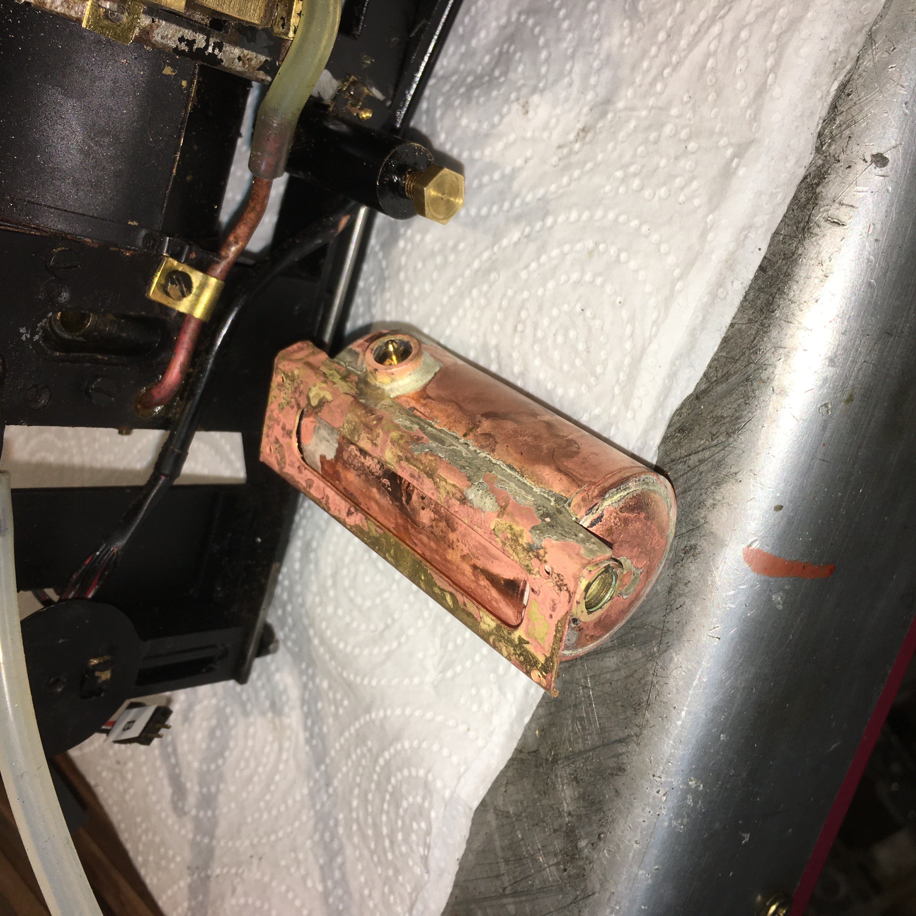

So a gas tank - as big as I can get into the space previously occupied by a dummy air receiver:
All silver soldered and tested. Just needs its valve making.

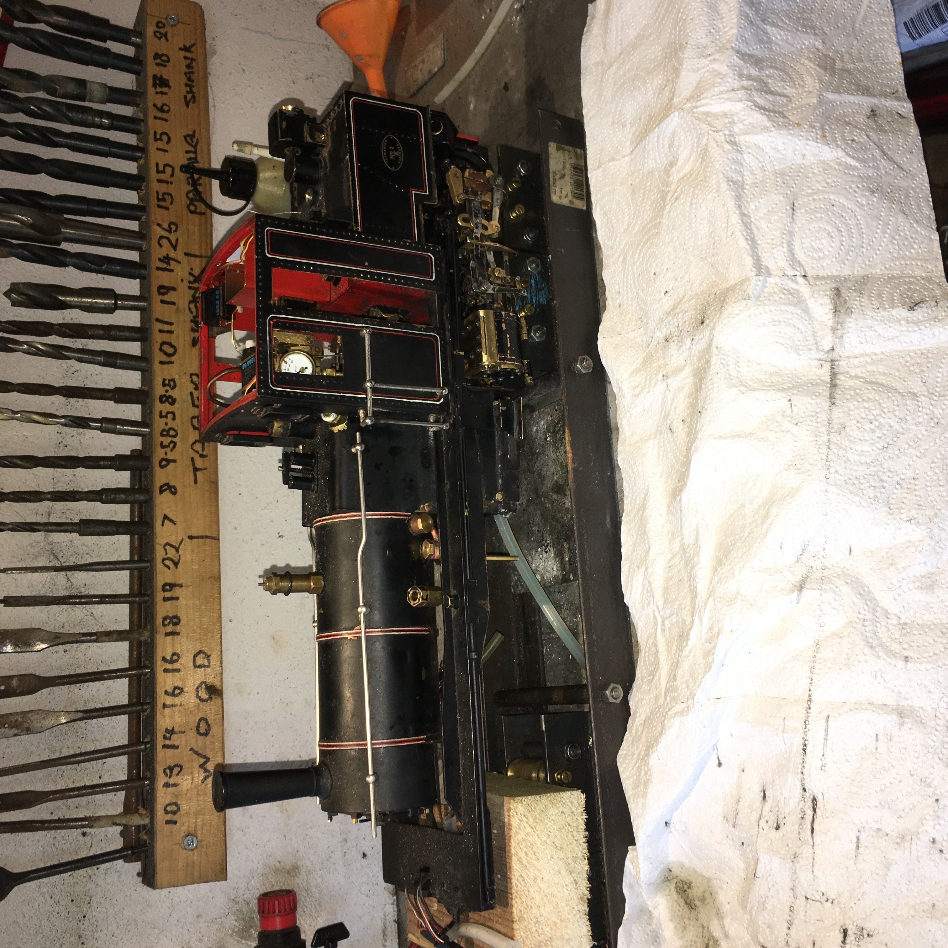

In its final position:

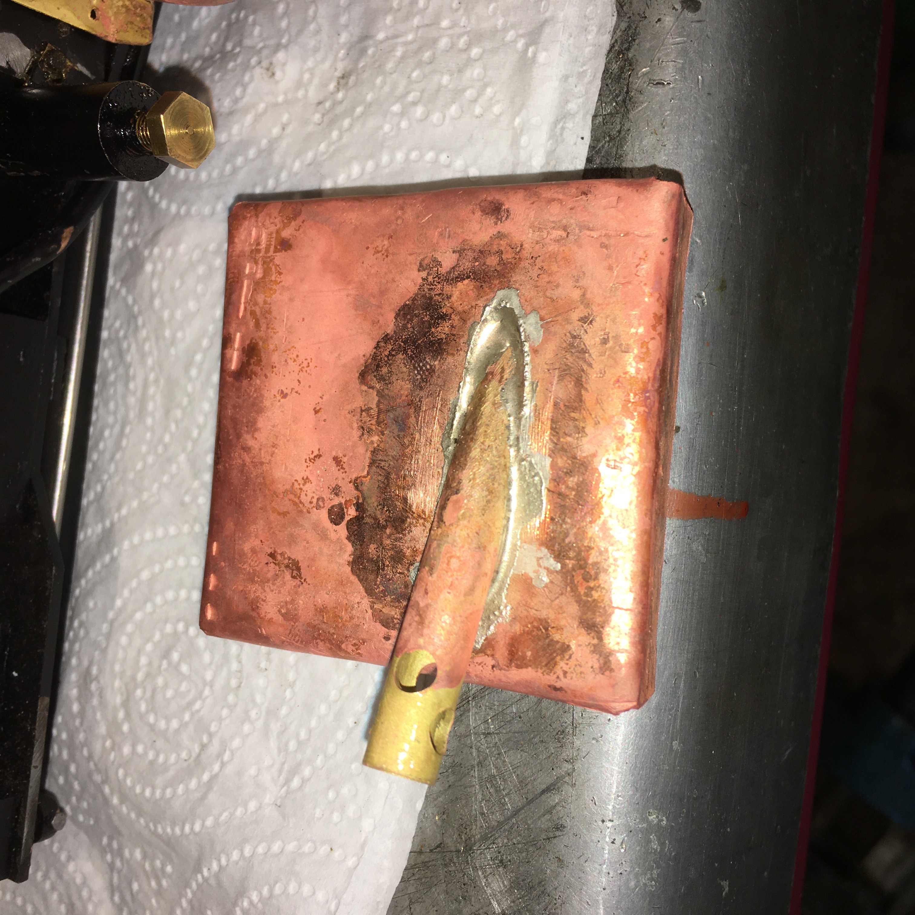

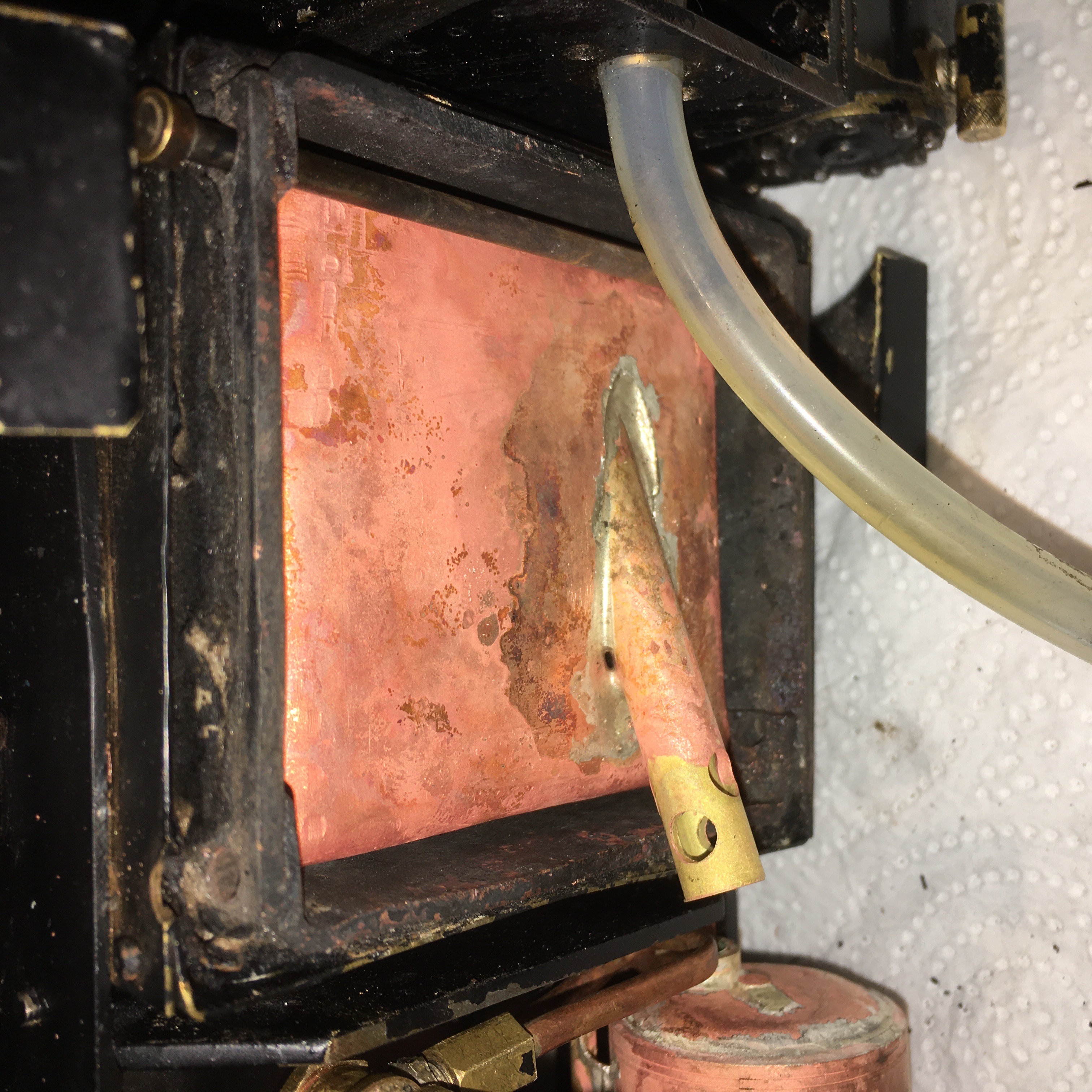

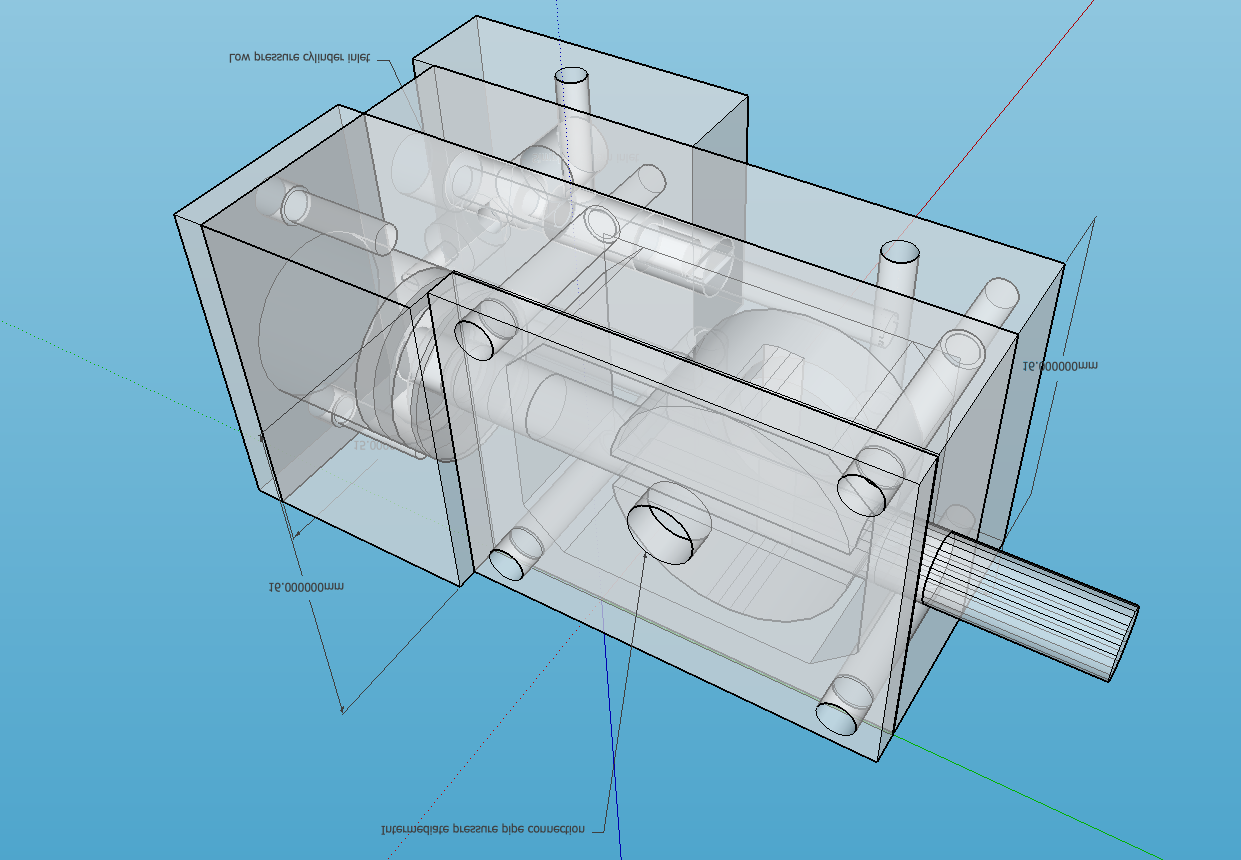

I have made a ceramic gas burner to fit into the space where the coal grate and ash pan fit. Held in place by the same two pins which hold the grate and ash pan in place.
A bit speculative in that the intermediate pipe which takes the steam between the two bogies might foul it - but it's worth a try. Its just a copper tray silver soldered up, with 4 pillars sticking up into it - on which the ceramic insert will sit:
and in position in the fire box:
I have spotted the hole in the soldering and have corrected it.

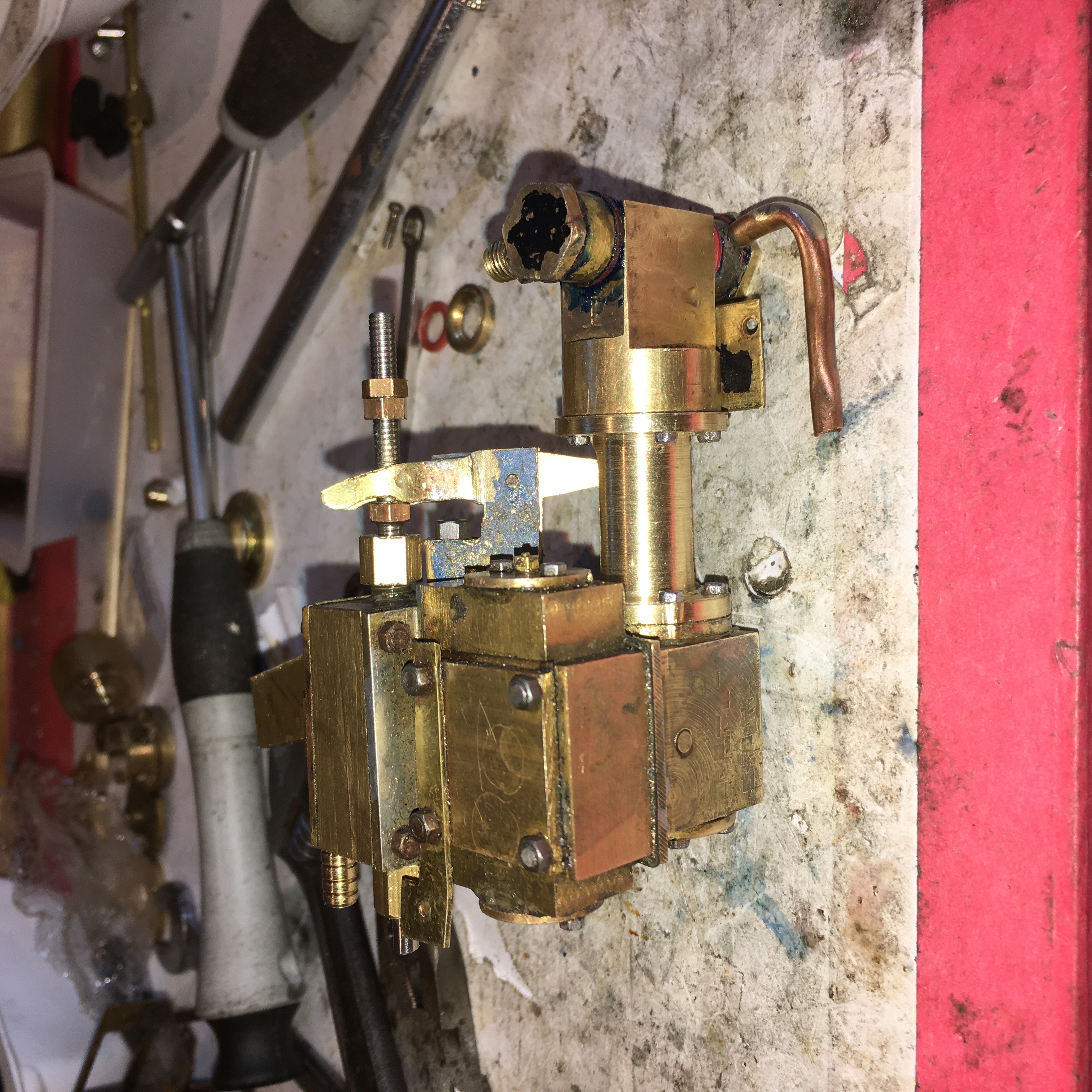

I have also completely rebuilt the front unit in the same way that I did for the rear unit. That now runs smoothly and freely on 10psi even with a valve chest leak. So a leak to solve as well.

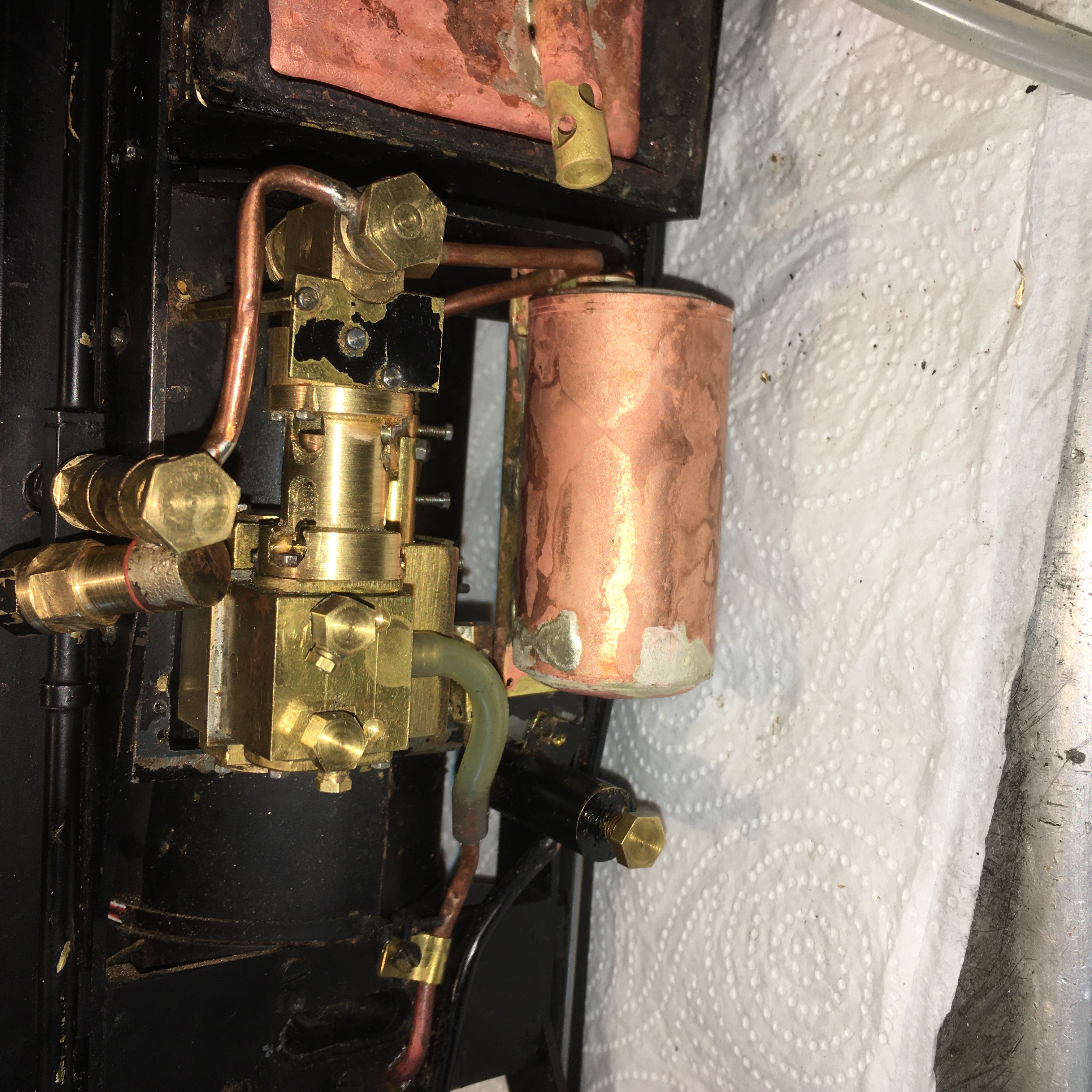

So to get the pump running off the loco. I had made the manual filler point part of the feed to the steam pump, thinking it was simpler that way but I don't think it worked properly like that - and with the pump removed I couldn't fill the boiler manually. The arrangement has been modified so that both pumps feed into the clack valve. The manual filler point is a bit "in my face" but I can improve it if it works:
with everything dismantled I have temporarily mounted the rear tank (which contains the electronics as well as a water tank) near by and reconnected the water level indicator:
I'd played with drain valves on the pump - but that didn't seem to help so I took them off and blanked the holes off. Lighting the fire again using charcoal soaked in meths 20psi came very quickly. At 40psi I started the blower, and opened the steam valve to the pump. That bright light from the water level indicator does mean I can't fail to see when it needs more water.
Having pushed the pump piston rod back and for a few times it started up on its own. At this stage the pump isn't connected to anything - I'm just trying to get it to run on steam.
The next stage is to prove it runs mounted on the loco and actually pumps water.

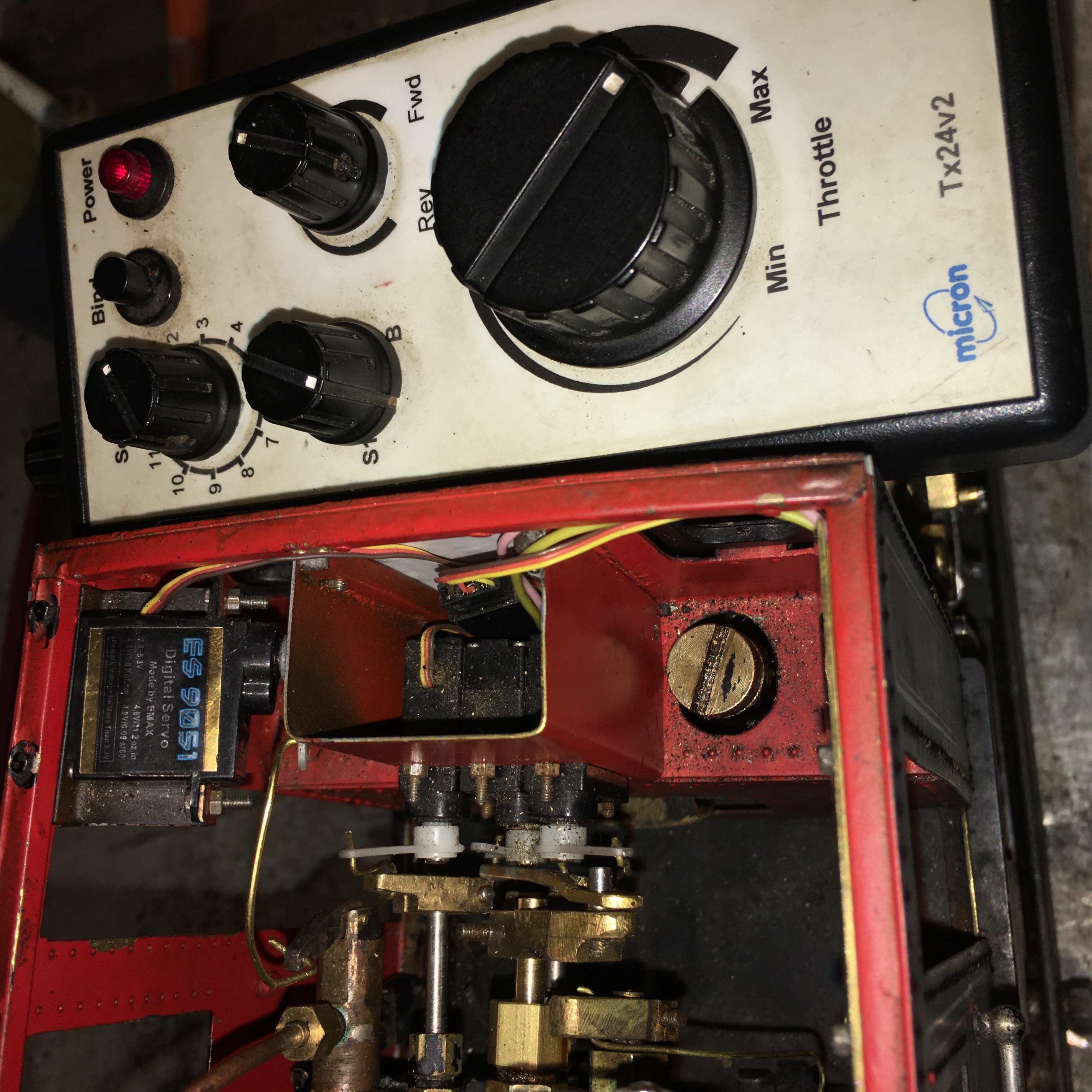

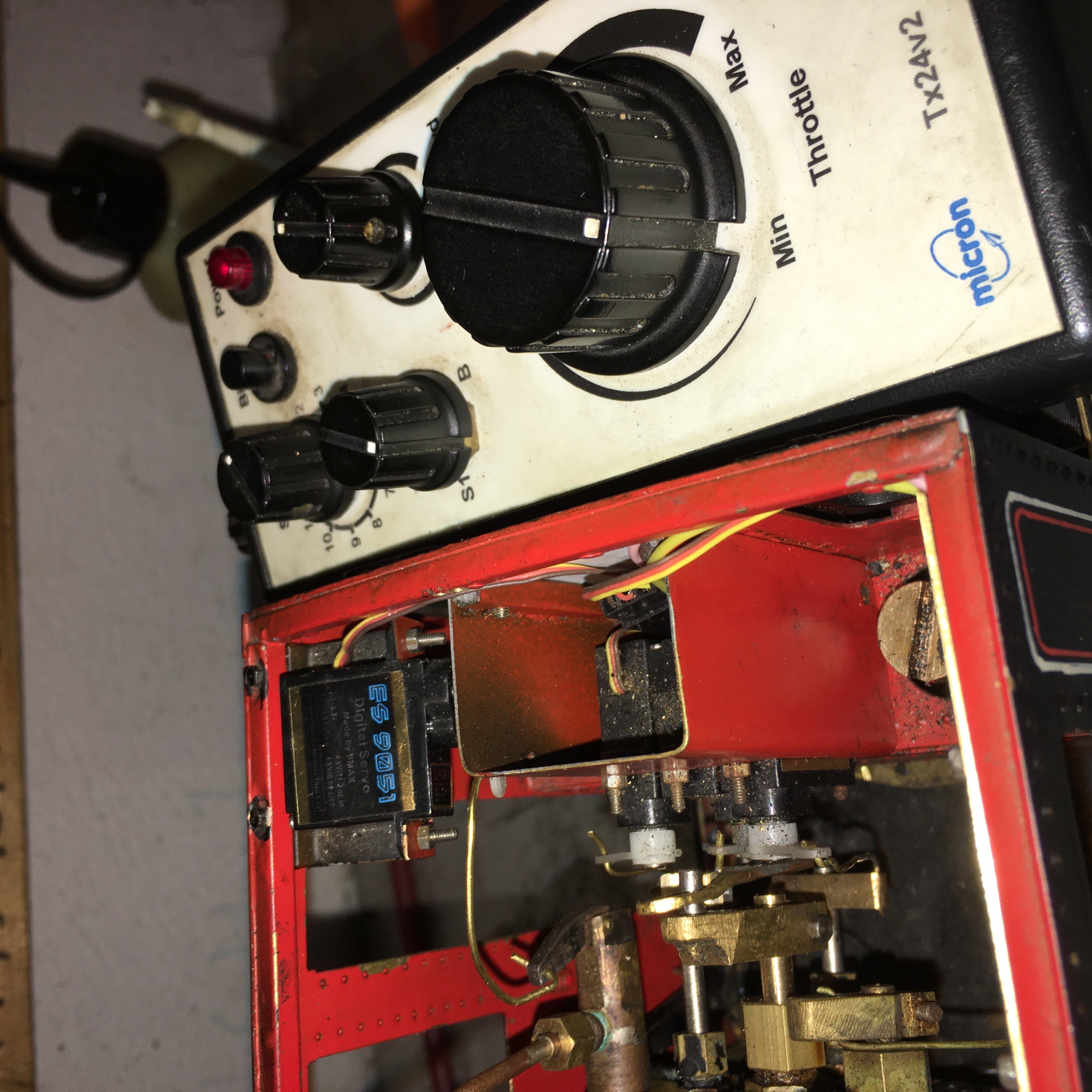

The throttle (regulator) does not rotate as much as I want it to. I have used emax 9051 servos on all of these controls. In the next photo you can see the regulator fully closed. The servo is the centre one of the three behind the metal box:
I have included the transmitter in the photo showing the throttle position. The throttle is the large brass lever.
Now the same with the controllers throttle fully open:
I estimate that the servo output is rotating through 60 degrees. Because the throttle is linked directly to the servo arm, the throttle has also rotated through 60 degrees. The connection allows them both to rotate in unison. So a servo which rotated through 360 degrees would move the throttle through 360 degrees. I would really like that rotation to be about 180 degrees! How can I achieve that? Will some other form of servo do that and perhaps fit into the same space - or at least fit without excessive modification?
I have adjusted the throws on this servo to their maximum that the receiver will allow using the shorting plugs and the receiver instructions. Interestingly when I use the same servo on a servo tester the servo moves through about 95 degrees. Also an emaxES08MD moves through over 100 degrees on the tester.
I would prefer to modify the servo side of this control rather than the throttle valve itself. If only because getting that valve off means taking the cab off, the radio control to bits, and disassembling all the other valves to the right of the throttle to get it off.( I could have designed that better!).
So is there a servo out there that I could use to replace the throttle servo with?

....... I would really like that rotation to be about 180 degrees! How can I achieve that? Will some other form of servo do that and perhaps fit into the same space - or at least fit without excessive modification?
.......So is there a servo out there that I could use to replace the throttle servo with?
I came across several when I was looking for a Continuous one.
Do a google search for: " 180 degree rotation servo. "
This is one that came up but there are others.

Thanks - I have never noticed these before. The 180 degree servo's tend to be bigger ones, but a few are little bigger than the ones I have been using. Further thinking required before cutting anything!

I have been searching the internet.
I have found particular EMAX servo which has the same dimensions as the ones in the loco. The specification says that it can rotate a maximum of 160 degrees. It is a digital servo, and I think that means it uses pulse width modulation (PWM?). It can rotate up to 160 degrees with an input signal varying from 600 to 2400 micro Seconds (the greek symbol MU which I cant find on my keyboard).
I also found references to Hitec and EMax making servo programmers which could be used to alter the rotation angle of some of their respective servos. Of course no one has these in stock and the information on websites is sparse.
So I think I am going to have to buy one to see if it works as a direct replacement.

Well that was easy - I worked out that the first symbols are the "option" button - and after that it is straight forward!SimonWood wrote: Mon Oct 31, 2022 9:07 am I can't help with the servos, so I will watch and learn.
But I can at least help with µ which is ⌥M![]()
An update on the servo question. I have asked Andy Rutter at Micron. He is going to investigate whether the RC102 can be reprogrammed to give the bandwidth ( I suppose that is the best term to describe the range of frequencies that it can provide to a servo ). If it can't he has offered to programme one of his new receivers to do it. That means buying a new receiver - but I am making a number of locos so it isn't an issue really.
So I suppose the answer to my original question is that the receiver can't control a 180 degree servo as it stands, on the basis that they all seem to use a wider range of frequencies than a normal servo.

I'm somewhat surprised that your Rx102 can't do what you want, but if Andy doesn't immediately have an answer I guess it must be an issue.
As I said, my AustroDaimler uses an Rx 41d-22 to raise and lower the roof, and other than programming which output pad to use, it didn't need any other adjustments to be able to run a 360degree rotation servo. My Tx control is by a Tx22 and that simply needed the inertia knob reprogramming to output PWM on Ch4 and that is just a question of holding the switch for the correct length of time ( I think the Tx24 has a similar system).
It is possible to hack a normal servo to be 360/Continuous, ( or presumably whatever angle you want) but it involves opening it up and some micro surgery and I didn't feel up to it myself, particularly with the micro servo I wanted to use. As I understand it, there is a pin on a potentiomer which stops its rotation at the normal angle and that gets filed off and then the pot gets replace by a couple of fixed resistors.There are numerous Youtube videos on how to do it though.
BTW, the 'bandwidth' you referred to is actually the Mark-Space ratio of the Pulse Width Modulation. The Tx generates and transmits a square wave and at the mid-point, the mark (high) and space (low) are equal in both length and amplitude and the servo is centred. If you turn the knob one way the spaces get shorter and, obviously the marks get longer. If you turn the knob the other way, the spaces get longer and the marks get shorter. The electronics in the servo recognise this and adjust the rotation direction and speed, accordingly.

I have modified small servos to get 180 degree out of them, with varying success. It's very simple you just add a small resistor on each side of the motor connector, they can be quite a tight fit.
HOWEVER
Some servos do not respond well to this and start to stall at each end as it hits a physical stop inside the servo, of course eventually it will burn out the electronics.
ALSO
Be VERY careful ordering 180 degree servos, they can be a standard servo which will require the mod to be done to get that 180 degree from a standard controller.
I used my servos in a centre cab loco to have the driver rotate 180 degrees to face the correct direction of the loco. It worked, but MAJOR size chokes were needed to eliminate chatter in the servo movement, obviously down to feedback from the motor which already had capacitors on. Not something you would need to worry about on a live steamer.
HOWEVER
ALSO

Thanks for all of the comments on servos and how they work. There is always something new to learn!
I have a response from Andy. The receiver cant be reprogrammed to provide the extreme mark space ratios that the servo I identified requires to rotate through 160 degrees. The digital 180 degree servos I have found all seem to use the extended mark space ratios that I quoted.
He has offered to reprogramme one of the new receivers that he makes to do this. I am not quite sure how to proceed. I am going to think about it. I realise that everyone else manages with normal servos - so maybe I need to look at my regulator!
I have finished modifying the water pump to increase the amount of water it pumps. I have recently bought a copy of LBSC's drawing for the weir pump. Perhaps I should have done that a long time ago - it would have saved me reinventing the wheel.
Anyway the pump ram is now 5mm diameter (rather than 4mm), and the pump is moving through its full range of movement ( in other words the piston travels from one end of the cylinder to almost the other end - near enough as far as it can go - before the lever reverses the motion).
I have done some tidying up - remaking the tube which connects the steam "engine" to the pump body.
I have also changed the lever which moves the first valve as the piston reaches each end of its travel, and adjusted it.
It has been tested on air, and it works smoothly and freely , as well as pumping much more water. So its back to testing the pump and the front unit on steam.

- Posts: 1180
- Location: South West Wales
Re: Coal fired Garratt K1
This simpling valve. Another experiment!
In compound mode the steam from the high pressure cylinders goes through the low pressure cylinders and then to exhaust, In simple mode the steam from the high pressure cylinders goes straight to the exhaust, and a new steam supply feeds the low pressure cylinders directly from the boiler.
The mechanism which does this is a cross between the steam pump and a normal slide valve. The locomotive has a separate steam supply which is used to operate a this mechanism to set it in simple expansion mode. The mechanism consists of a piston in a cylinder ( fairly standard 8mm diameter piston) operating a valve rod. The valve rod is connected to a slide valve - fairly standard 8mm diameter. Normally the side valve covers the connection to the exhaust, and exposes a connection to the input to the low pressure cylinders (on the front bogie). When the piston moves the valve it exposes the connection to exhaust and covers the connection to the low pressure cylinders. The steam which moves the piston also goes via a pressure relief valve to the input to the low pressure cylinders. The pressure valve (set to say 20 psi) makes sure that the piston stays pushed over - and stops the steam back feeding when in normal compound operation ( that might move the piston into simple mode!)
The only new idea (as far as I know) is to use a spring under the valve so that the valve rod holds the valve down onto the valve face. I have used that twice - once in a reverser for my "Idris" and in the steam pump I have just finished modifying. It seems like a good way to ensure that a valve which is on its side stays pressed against the valve face when there is no steam to hold it there. In this case it is intended to hold the valve down against the steam in the hole that it covers. The strength of the spring will have to be carefully chosen to be sufficient to hold the valve down but not so much that the piston can't move it. I have done this before - on Idris, although that was moved by a servo rather than a piston.
In the drawing using the "x ray view" the piston is on the left and the valve on the right. The pressure relief valve is in the block at the back on the left, and all the interconnections for steam are in the block under the valve. As it stands - and it is a first draft - it will all fit between the wheels and give room to make the steam and exhaust connections with ptfe tube. I can probably make it bigger and that will be sorted out before I cut metal.
