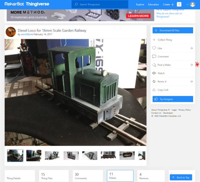

ge_rik wrote: Thu Jul 02, 2020 8:01 pm
Not sure how to do that. I will investigate...
I think all you need to do is go to the original Thingiverse file pages and click the "Post a make" link on the RHS to upload still pics. ( I guess you'd need to do it on both the original and 'Remake' pages?)
Screenshot 2020-07-03 06.06.23.png (282.99 KiB) Viewed 11155 times
Not sure if it will let you upload the actual video but I think you can add the URL in the commenst section.

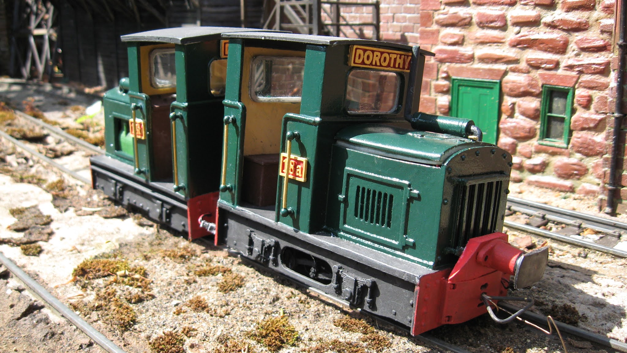

A bit of an update on this build (from two years ago). I've finally gotten around to creating a blog post about it
https://riksrailway.blogspot.com/2022/0 ... locos.html
Since my last update on this thread, I have motorised the trailing loco so they now work as a permanently coupled pair. One has the recommended IP Engineering Budget chassis but the second loco uses the chassis included with the kit to which I added brass bushes, wheels, gears and a motor from IP Engineering. They both seem to operate equally well. They will now quite happily pull eight loaded skips, plus gunpowder van and brake van up my 1:40 gradients.
