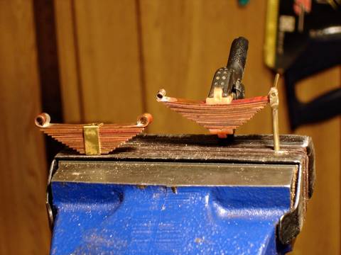

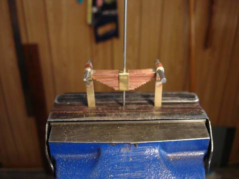

Thanks lads. The leaves are copper, I had a piece the correct thickness, and hacksawed and filed each piece. The central strap is now drilled through to attach to the axle box push rod. I'm working on the hanger brackets now
The leaves have been trimmed

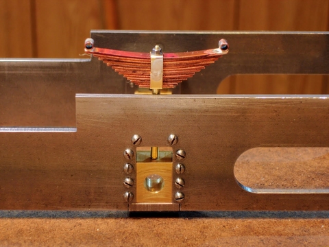

I think I'll paint them Rod
Here's the hangers so far

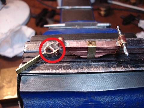

Had a whoopsy yesterday with the hanger cross-hole position being too low. Plugged it with a piece of rod, silver soldered, and then cut out and filed down.
(hq pic for Tom)
rsz_dsc00426 (1).jpg (61.74 KiB) Viewed 11446 times
Best wishes,
Dave

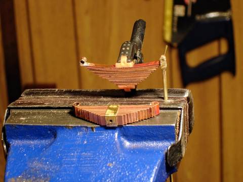

I've made another hanger this time out of brass rod. Hmmm, I wonder which to go for? The leaf spring and hangers so far are just a trial
(Using the old digital camera for Tom)
Best wishes,
Dave
Re: Charles - Penrhyn Mainline Hunslet
Post by tom_tom_go » Mon May 11, 2020 9:21 am
The pictures are better quality using your digital camera.
I like the brass rod bracket.

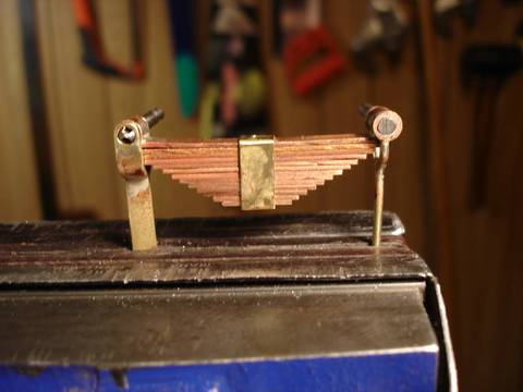

What do you think of this new one? Where larger rod meets flat strip. I think it gets my vote
Best wishes,
Dave
Posts: 6012
Post by philipy » Tue May 12, 2020 6:28 am
Yes, I agree Dave. Thicker rod and strip U bracket, gets my vote.
Post by FWLR » Tue May 12, 2020 8:32 am
Thicker one for me, although both are equally brilliant and look great on the springs.
Post by tom_tom_go » Tue May 12, 2020 9:09 am
Best of both ideas combined, that's the one!

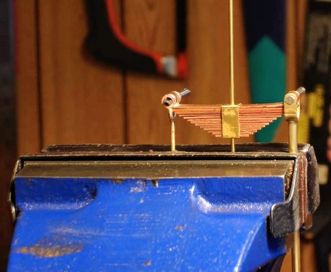

I've been working on a new spring, with the leaves reduced from 1/4" to 3/16", with a type 3 hanger, and a different eyelet. Getting ready for for production :D
Best wishes,
Dave

Post by FWLR » Fri May 15, 2020 7:43 am
Superb job Dave.
Better one now they are bent a little. Did you say you are going to blacken them, this blooming memory, they would look even more impressive then.

Post by dewintondave » Sun May 24, 2020 5:19 am
We are getting there with the first spring
