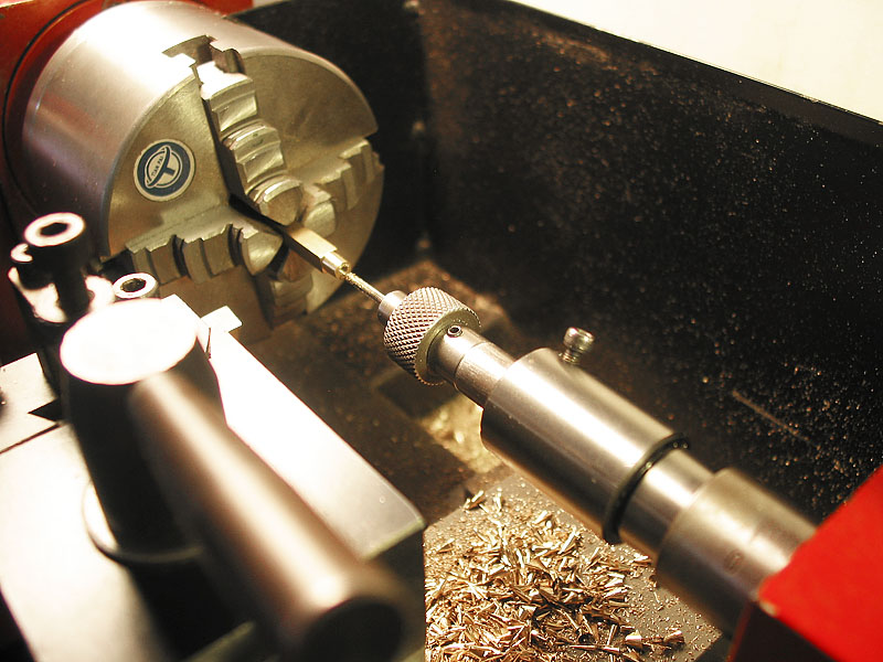

I've been meaning to build a bench tapping fixture for the last 30 years, after seeing one in a friend's workshop. I still haven't found the right size of Round Tuit yet.......-steves- wrote: Sun Apr 07, 2019 3:16 pm I use my taps in my home made tap holder from a cheapo drill press.
My tailstock die holders are rudimentary, but do the job. Never seen the point of polishing up homemade tooling, it doesn't work any better.
The photo shows the tap holder I use for 10BA and 8BA. The knurled bit is about 3/4" dia., so it's hard to apply enough torque to break even a 10BA tap. I used to grip it in a drill chuck in both the lathe and the mill, but that took up too much space on the lathe, so a while back I drilled a suitable size hole in a blank arbor and fitted a clamping screw.
It's definitely worth using tapping compound, as it reduces the force needed to cut the thread and also slows the rate of wear on the taps and dies.

I do like that tap holder for the tail stock, think I might ahve to make (copy) something like that for myself, looks very useful and I love the idea of the knurled 3/4" bit so you don't over do itGTB wrote: Mon Apr 08, 2019 6:17 pm
I've been meaning to build a bench tapping fixture for the last 30 years, after seeing one in a friend's workshop. I still haven't found the right size of Round Tuit yet.......![]()

As it happens........-steves- wrote: Mon Apr 08, 2019 6:23 pm I don't suppose you have any more pictures or dimensions for that,
I used some off-cuts of BMS bar I had in stock, as the only critical dimensions are the dia. of the hole for the tap and the position of the grub screw. I wasn't about to turn the whole thing out of solid, so the grip is a small piece of 3/4" BMS knurled and drilled separately and then pressed on.
The sleeve is the bit gripped by the chuck and this one is 11mm od and 50mm long, with an 8mm hole drilled through it.
The body is another piece of 11mm od about 60mm long. The spigot is 30mm long, turned down to be a nice running fit in the sleeve. The grip is a piece of 3/4" dia., knurled, drilled 8mm and cut off at 10mm long. The tap end of the body is turned down for a length of 18mm to be a press fit in the grip.
My 10BA, 8BA, 6BA and M2 taps all have 1/8" shanks, so a hole that size is drilled in the end of the body, deep enough to take most of the tap shank. The grub screw is M3, positioned so it engages a flat on the tap shank, that way when loading the tap, the grubscrew only needs to be nipped up enough to stop the tap falling out, as the flat stops the tap turning in the holder.
I've not seen anything remotely similar available commercially, but it's worth it's weight in broken taps........

I will be making one of those as soon as I get material and spare workshop time, but hopefully not far off as I think that will prove very useful for this buildGTB wrote: Wed Apr 10, 2019 12:54 pmAs it happens........-steves- wrote: Mon Apr 08, 2019 6:23 pm I don't suppose you have any more pictures or dimensions for that,
I've not seen anything remotely similar available commercially, but it's worth it's weight in broken taps........![]()
