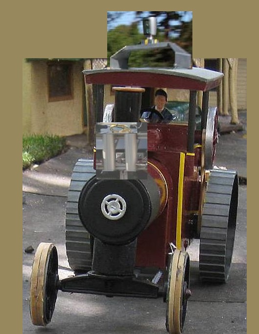

This should be my final post!
I tried putting lap top speakers in the roof, fed from sound recording card. Sounded reasonable, till I ran the engine, then the motor/gear noise swamped it out. End of experiment.
But I did add a hurricane lamp so the driver can see his controls. But really it's so I can see that the power is turned on!
IMG_7929 s.jpg (54.04 KiB) Viewed 12309 times
