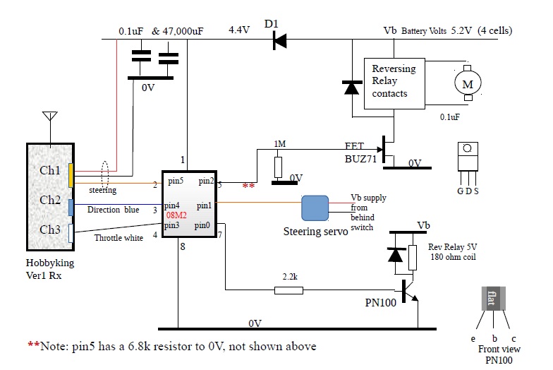

As soon as I started testing I noticed an intermittent control problem. I'm using a picaxe to control the motor speed, direction and steering. But there is some interference which causes the picaxe to stop and restart its program.
I am sure this is what is happening as if itβs in reverse at the time, when I restart it is in forward. This can only happen in the startup part of the program. The engine restarts when the throttle is returned to stop.
It happens mainly at full throttle (which is only about 55% of battery volts), but can happen at anytime, any direction and on straight or curves.
It doesnβt seem to do it on the bench, even when I put pressure (load) on the wheels.
After much investigation using my oscilloscope, I have managed to overcome the problem (I hope - who knows with intermittents?). But I don't understand why.
It seemed to have something to do with 400mV dips on the 5V caused by the steering servo which seems to take spikes of 1 amp when it's moving. I won't go into all the things I tried, I ended up feeding the 5V to the picaxe and Rx via a diode and then a 47,000uF capacitor. I only had a 'normal' diode so that's a 0.7V drop to the picaxe, but I'll get a Schottky type later.
Just for info, this is the voltage trace before I 'fixed' it. The fuzzy line is a 100mV peak-peak exponential type wave caused by the RX (why? who knows?). The dips are 400mV due to servo current. With the diode and supercap, these are both halved. And this is the circuit:

I admire your tenacity, Greg. I must admit that I'd have assumed there was a dodgy connection if it was happening in the field but not on the bench, but the oscilloscope trace suggests something else is going on. Presumably, as the difference between this program and your usual one is the addition of the steering routine and circuitry, then it makes sense that this is where the glitch is happening. But as to why ....... ?

Surely there is a faulty component causing this?

I had a similar problem recently, the DFPlayer sound card I was playing with interfered with another 5 volt circuit (not the processor). I solved it as you with a schottky diode and capacitor. I also changed the layout to ensure the 0v and 5v lines of the offending device went directly to the regulator rather than being at the end of the power lines.
Servos are electrically noisy. I use the Tower Pro SG90 on my steam train and they produce 500mv of noise on the 5v line but the processor I use is 3 volt so is well protected by it's internal regulator.
You have a 0.1uF capacitor in your circuit diagram, ensure you have one as close to the processor power rails as possible.

Southern188 wrote: Mon Apr 30, 2018 9:39 am I had a similar problem recently, the DFPlayer sound card I was playing with interfered with another 5 volt circuit (not the processor). I solved it as you with a schottky diode and capacitor. I also changed the layout to ensure the 0v and 5v lines of the offending device went directly to the regulator rather than being at the end of the power lines.
Not quite sure what you're saying, but my servo has separate power wires direct from battery and the picaxe+Rx are fed along another pair
Yep, It's right at the picaxe terminals

Always a possibility, but since I have got rid of the problem (fingers crossed) with the mods I made, it seems less likely to be a component.
What component could it be? I've tried different picaxe. I've checked that other Rx of the same type cause the same modulation on the battery. I hope it's not the servo as it's glued in. And I'm happy that the battery doesn't have too much internal resistance. I might try and measure another servo's current just for future reference.
One thing I do wonder about is the picaxe - datasheet says it operates internally on 3.3V but has a regulator so can operate from 5V and it selects automatically. I just wonder what it does as the voltage dips. Does it have trouble as the voltage falls and its internal regulator dropout voltage comes into play and that causes a restart?

I agree, if it ain't broke don't fix it but having myslef had all sorts of odd issues with budget servos in the past I reckon it's that.

Just to try and convince myself, I took a similar 'cheap blue' servo and had a look at it's waveforms.tom_tom_go wrote: Mon Apr 30, 2018 1:22 pm I agree, if it ain't broke don't fix it but having myslef had all sorts of odd issues with budget servos in the past I reckon it's that.
Fed from my bench supply, it caused a 250mV dip in the supply every time it moved ( in engine I had 400mV).
I put a 1 ohm resistor in series and measured it's voltage drop= amps, and it takes a spike of 500mA each movement, with no load on the servo. I had estimated 1A in the engine, assuming 0.4 ohms. So I tested the battery and found its internal resistance incl the polyswitch is 0.6 ohms. So the servo would cause a 300mV dip calc compared to my measured 400mV. These are all close enough for me to say that I don't think the servo is faulty.
It all goes down as experience - running a servo takes big current spikes that have never been a problem for me before as I have always used a regulator for the picaxe supply.
