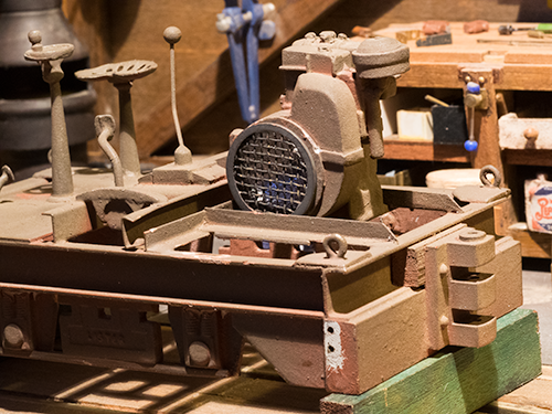

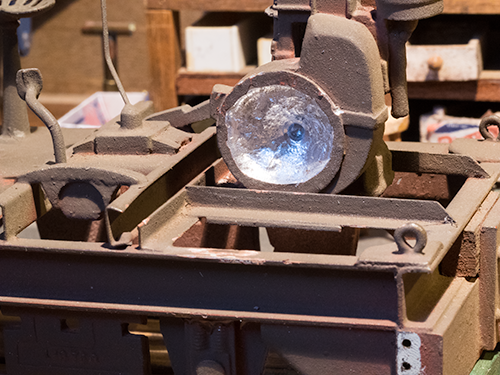

AND continuing the Lister project:
I managed to get several short runs in the (1:1) workshop that allowed me to "machine" out the void behind the new grill. Done with sequential drilling up to 10mm with electric hand drill, then use of handheld mini-drill (predates Dremel but same principle) with a ball mill.
As you can see pretty crude:
But when the grill is placed lightly up against the void the irregular edges are hidden:
And then next step will be spraying the raw metal, but not with today's weather. The rest of the afternoon was devoted to small repair jobs and my rolling programme of adding tare weight markings to rolling stock (interspersed with the odd nap!).

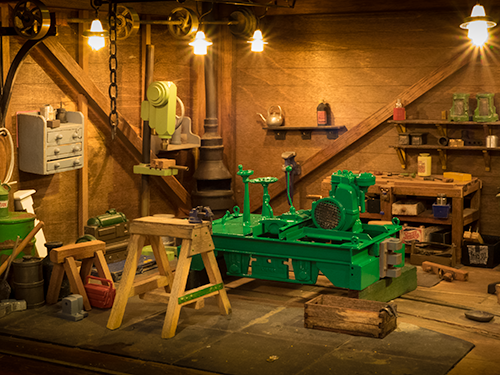

Lister project continues:
This may get mired again as Big Jim has made me think again. RC size has greatly improved since the project stalled last time. Thanks Jim for link to Boaz project.
However there was some progress on painting until the wind got up again. It was finally finished as light was failing.
Tony, the Lister Renovation Project co-ordinator, stood back to admire the paint job after he'd lovingly applied the last brush-stroke. He insists that careful research showed that this was the nearest match to Lister green. The CME came across from the running shed and stood a full minute before gulping and walking back out to the twilight without a word. Old Tom muttered something about it "maybe be even more in yer face in 'daylight", with a definite impish smile. Hard to tell under the incandescent lights.
Still progress has been made.

Just wonderful.
- Posts: 6051
Re: Finishing the unfinished
Personally I'd settle for one at 1:19 !! It really is a work of art in it's own right.
So would I in any scale....philipy wrote: Fri Jan 05, 2018 9:18 amPersonally I'd settle for one at 1:19 !! It really is a work of art in it's own right.
Agree with Phillip....
- River Lin
- Posts: 411
- Location: Leicester
- Posts: 8002
Couldn't have put it better myself......

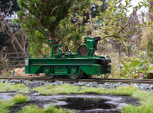

Thanks everyone
The Lister project continues with a look at the livery in daylight. As you can see it looks better for matting down and some light weathering.
A slightly elevated view allows a comparison of weathering techniques. I find weathering where the surface is worn away (eg the footplate wear where the driver's feet sit) is best achieved by literally wearing it down with light wet and dry to reveal the previous layer. However I find built-up weathering ( eg the grime in corners of the frames or the rust on the grill) is best with building up by layers of paints powders and dyes. An overall light spray of ModelMates weathering dye (rust) gives a patina of use. I did like the oil colour (it really looked like a oil-water separation effect) but have run out and the company is no more. If anyone knows of similar products I would be grateful for the heads-up.
There will be a slight hiatus on this project as after Big Jim's temptation, I am researching small RC receivers and Li-lo batteries. Mmmmm.

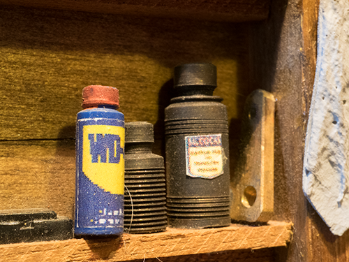

And as an aside did the Lister make it out into the yard under its own steam? One answer:

What, no easy-start?
Have you tried the Humbrol range of weathering washes?

Looked at them with uncertainty, but saved from the decision by the sheer amount of empty spaces on the rack!Big Jim wrote: Fri Jan 05, 2018 4:12 pm What, no easy-start?
