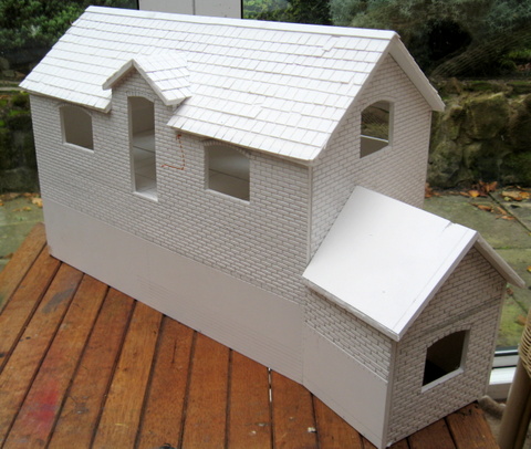

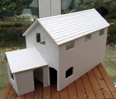

A little while since I posted about progress with the mill building. This is partly because I ran out of 1.5mm plasticard for the slates but mainly because I started the build while we were on holiday in France (you mean, you don't you take a modelling project away on holiday with you!?) and I had to wait until we got back before I could assemble the prefabricated pieces. I somehow felt that the completed building would not fit into my hand luggage.
Anyway, have managed a crack on a bit further with it ...........
Yes, the outbuilding is deliberately skewed, to fit into the available space
And there's no need for brickwork on the lower section as it abuts to the raised siding
As you can see, I still have a fair bit to do. I'm working on the windows at present.

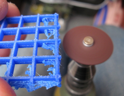

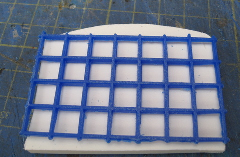

I was wondering how to make the frames for those small panes when I came across this in my local pound shop.

What adhesive will you be using on these pound shop "windows"? In my experience these soft plastics which I suspect they are made from, don't take too kindly to the type of adhesive that us modellers are likely to use.

I've assumed that the small-paned windows are more likely to be original so set myself the challenge of finding a cheap way of representing them. Bit of a fiddle slicing the mesh in half, but hopefully will be worth it (especially as I get two windows for the price of one, if I'm careful enough).

Do i suspect you used a Hot Wire Cutter Rik.
Posts: 7947
Re: Revamping the stream
Post by ge_rik » Thu Oct 05, 2017 7:45 am
FWLR wrote: Thu Oct 05, 2017 7:24 am Do i suspect you used a Hot Wire Cutter Rik.
It is an idea, but no. I used a slitting disk and a razor saw.
I suspect this sort of plastic would weld itself back together once the hot wire has passed through.

Trial and improvement ....... The first one went perfectly, the next went askew and another one caught fire when I thought that using a flame would be a be better way of removing the swarf than using a file and a knife blade. :? :(

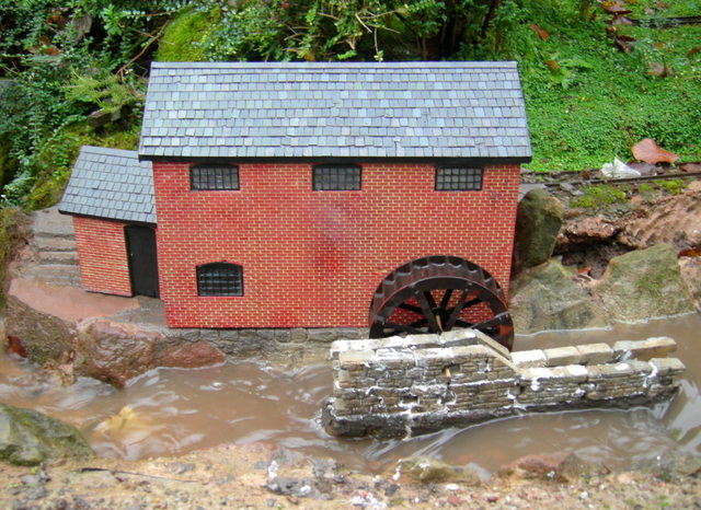

A little while since I updated this thread. Amazing how life intervenes when garden railway projects need to be completed. The mill is now nearing completion. The building is more or less complete, the site has been landscaped and some Jigstones blocks have been placed in the stream to support the wheel and direct the water flow on to the wheel. The building needs to be properly bedded-in and the concreting needs to be tidied up and some detailing is needed - eg sluice gates, railings, gutters and downspouts etc. But I wanted to check the wheel would function in the stream before I tidied everything up.
Rear view of the mill showing the raised siding and lucam for loading grain sacks.
A view from the main line across the stream. The Jigstones walling has just been fixed in place. It needs in-filling with concrete (did that this evening)
I was pleased that even before sluice gates have been fitted the wheel rotates at a respectably slow speed. I assume my wheel is very inefficient at translating the water flow into rotary motion - but that suits me well!
