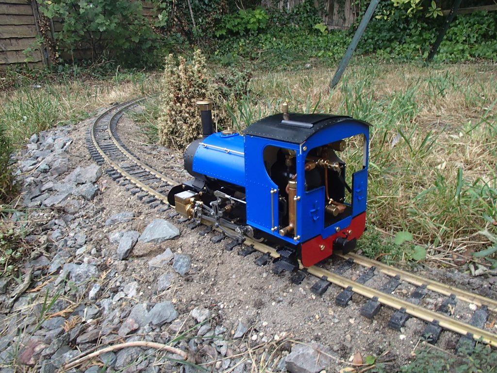

And she's finished (for now). Photos to follow. The painting is not perfect and acquired a few chips during assembly. But for now done.

Post by Boustrophedon » Mon Aug 22, 2016 7:26 pm

Post by JMORG » Mon Aug 22, 2016 8:37 pm
Looks amazing! More pictures please!
Are you going to add any extra detailing at all? Or is that a future project?

Post by Boustrophedon » Mon Aug 22, 2016 9:09 pm
JMORG:119638 wrote:Looks amazing! More pictures please!
Yes; all screws will be replaced with bolts where they can be seen and I plan to make new riveted buffer beams in steel and new valve covers in brass with bolts to hold it down with dummy bolts in between.

Post by Chris Cairns » Tue Aug 23, 2016 9:44 am
That is looking very nice Don. I assume the boiler wrapper has been painted blue as well?
Like your split colour cab interior - very prototypical.

Post by Boustrophedon » Tue Aug 23, 2016 11:46 am
No the wrapper is satin black. I did try to paint it blue at the front and black at the back, but then decided to take the easy way out for now.
