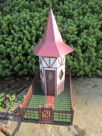

Post by jim@NAL » Sun Nov 23, 2014 4:13 pm
good work peter what did you use to make the fence
Posts: 5712
Post by Peter Butler » Sun Nov 23, 2014 9:13 pm
Thanks Jim.... the fence is made from galvanised fencing wire which comes on a large roll. It is about 3mm diam. but flexible enough to bend into a sort of straight, each just over 3.5 inches long. It is meant to look wonky!
The bottom of the wire is set into holes in the 6mm ply base and the tops into hardwood strips. Posts are also hardwood with wooden beads on top.
None of my structures are intended to live outdoors, although I have just acquired some of the concrete board, as discussed elsewhere on this Forum, and I will use this for my castle walls in the hope it survives the wet conditions here.

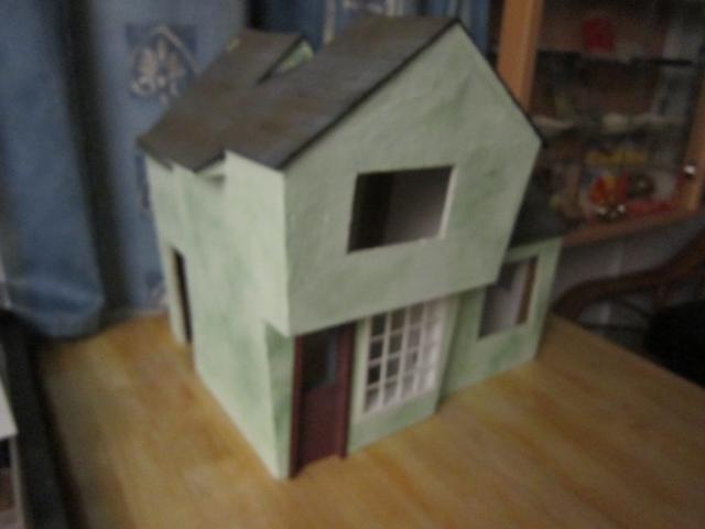

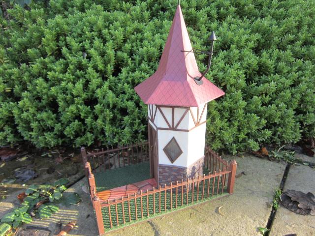

Another building from the same cartoon as the one above...
This is made in the same way with identical materials as the first.  I still have details to put into the garden but can wait until inspiration strikes!

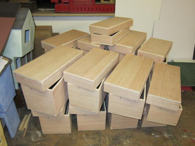

Just to keep the thread up to date, today has been spent making storage boxes for some of the stock items I have built throughout the past year. It is just amazing how many there are when it all happens at once!
There are 13 here (so far) and they all need painting, lining with felt to prevent damage in transit, hinges, catches and finally lettering to help me identify what is inside each one.

there are a lot of boxes there peter how much stuff have you made this year ?????????????????????.what are the other buildings in the background of your picture

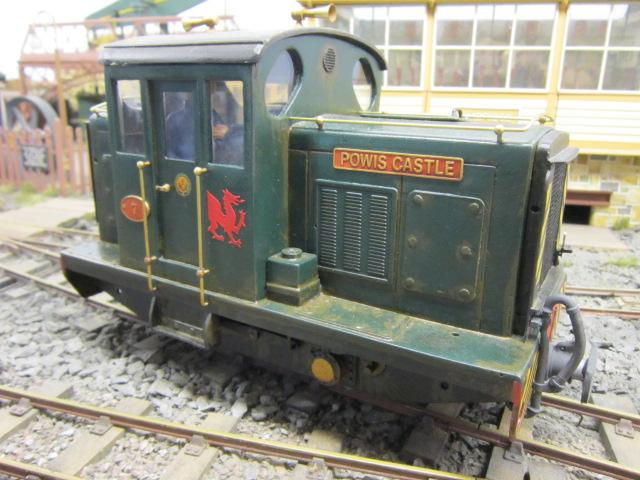

Post by Peter Butler » Tue Dec 23, 2014 10:26 pm
jim@NAL:106625 wrote:there are a lot of boxes there peter how much stuff have you made this year  ?????????????????????.
One or two.......
Beginning with my Christmas Loco:

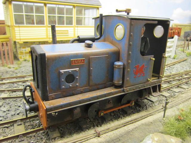

Emma:

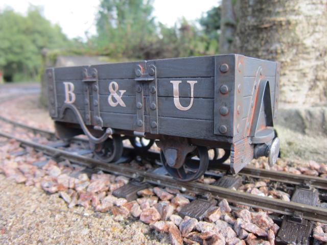

Open Wagon:

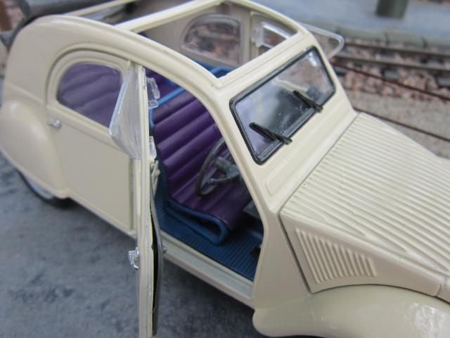

2CV Twins:

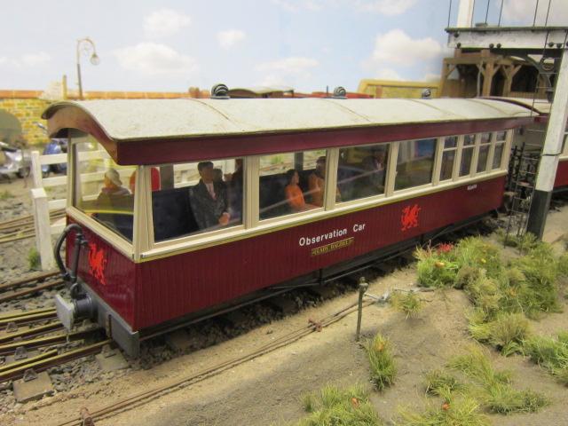

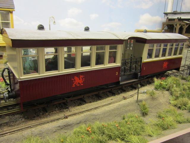

ImageBchmann conversion... Observation Car:
1st/3rd Carriage:

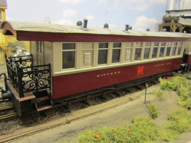

Dining Car:

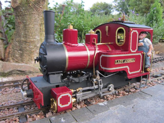

Roundhouse Billy rebuild to 'Lady Andrea'

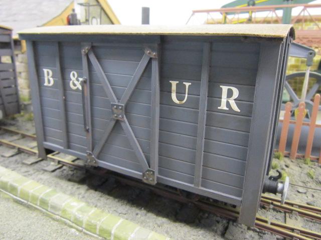

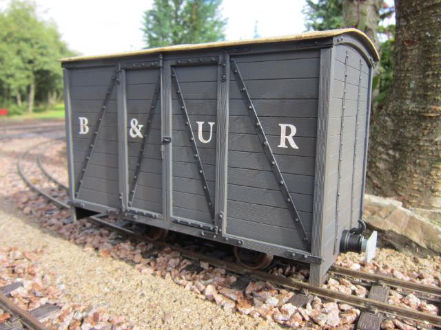

Covered Van #1:
Covered Van #2:

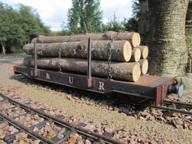

Log Wagon:

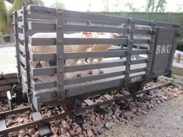

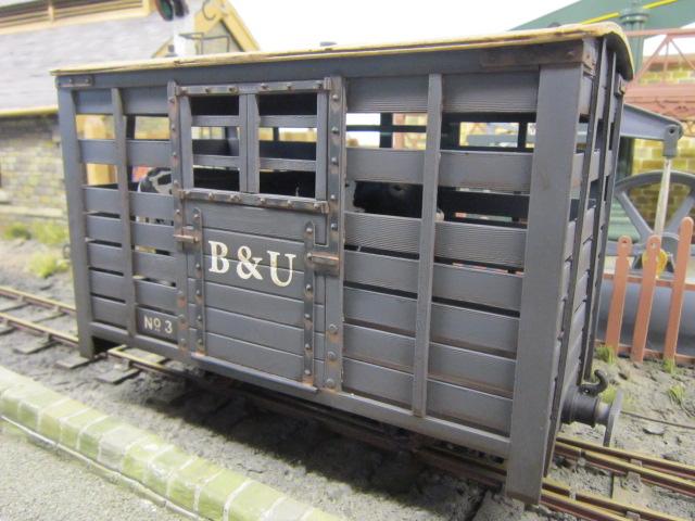

Cattle Truck:
Sheep Wagon:

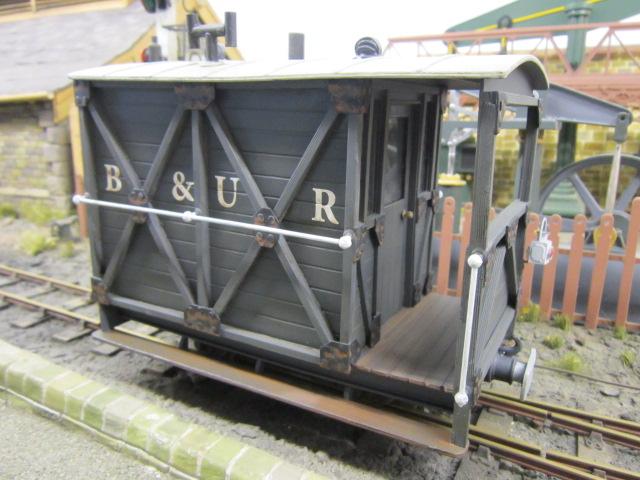

Guards Van:

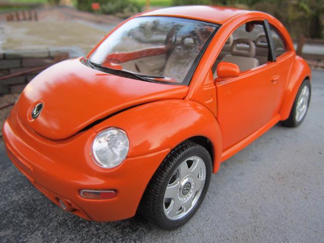

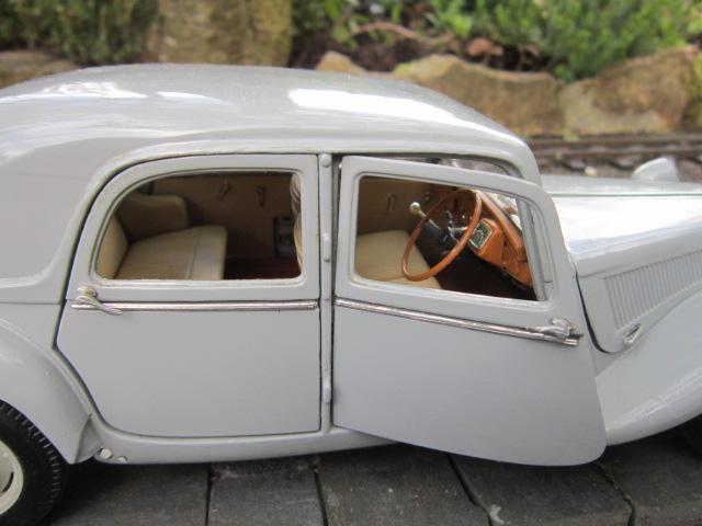

Various road vehicles converted to right hand drive:

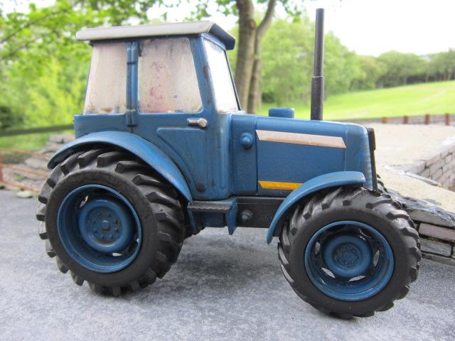

Tractor build:

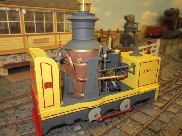

An Emett.... 'Snail'

Great work, Peter - inspirational! I really like that vertical boilered loco btw (actually, really like everything else as well). Have you detailed the construction of that anywhere?
Posts: 5712
Post by Peter Butler » Wed Dec 24, 2014 11:51 am
Hi Rik, there is a build description on this Forum.... look under 'A February Loco' in the Locomotives-Electric section. It tells the story of what materials I used etc...

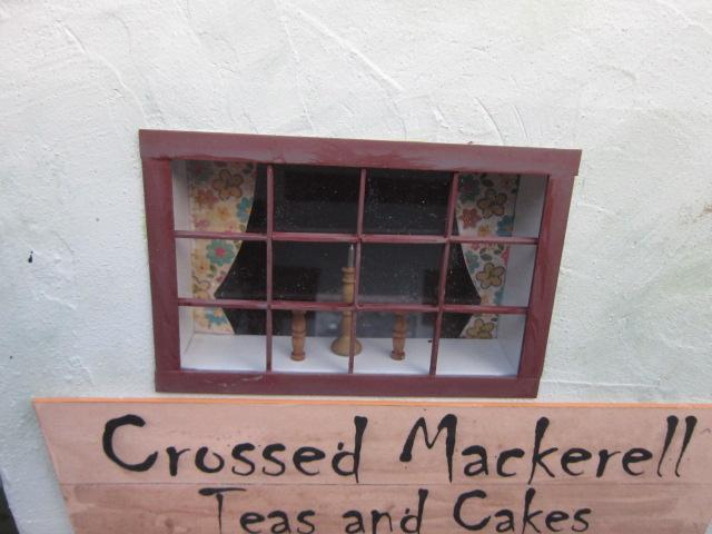

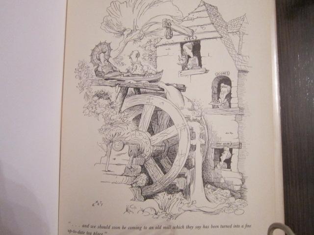

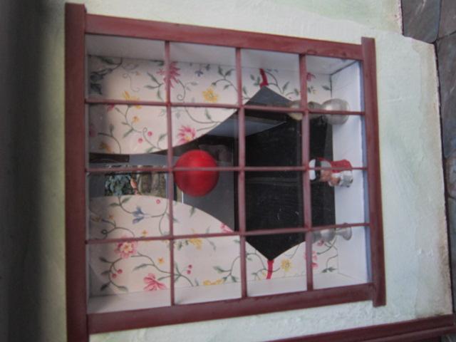

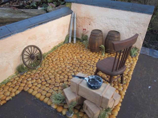

This latest building is not quite finished but is coming together nicely.  It is taken from one of Emett's cartoons.....
It represents a tea room so has a sign above the front window and ornaments inside. Around the building are 'slate' slabs made from Plasticard and individually painted.   The rear of the building has a small yard area (not shown in the cartoon) so I have added cobbles and junk, weeds (again) are growing against the wall which is made from chipboard covered in a layer of Plaster of Paris with bricks scribed and painted.

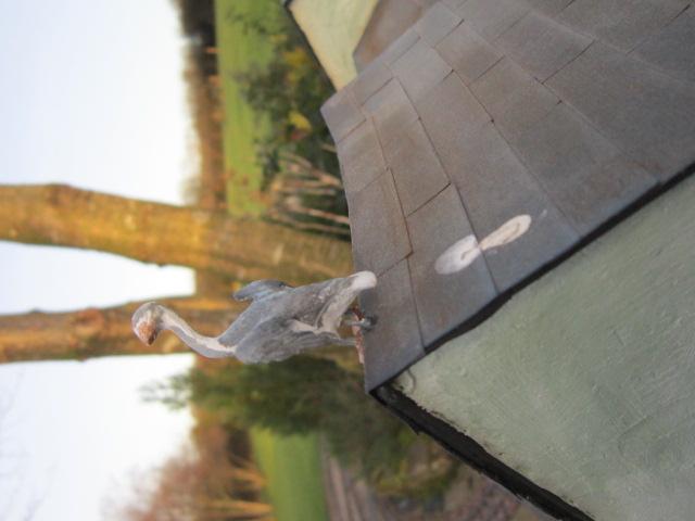

When I was making the roof (coloured paper cut to size and individually stuck to card) a bird flew into my shed and did a woopsi
on it..... I couldn't resist the opportunity to leave it there with a model bird sitting strategically placed above it!
More to follow soon....
Apologies for the two images wrong way up.... they don't show like that in my file!

I think the bird 'dooings' should be kept and repainted when necessary!

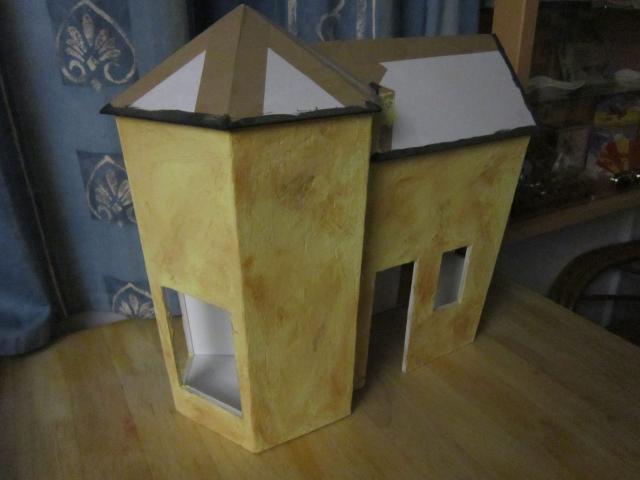

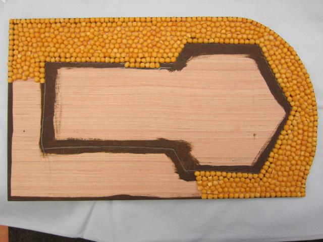

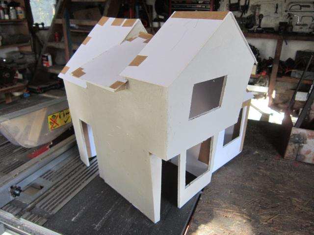

My next Emett building will be from the same cartoon as the one above....
Shaped like a toll-house it has been turned into a tourist ice-cream shop. The structure is made in the same way, foam card, PVA and brown tape. Each house is complete with its own baseboard, any paving, fencing, garden or yard is attached.
Baseboards are 4mm plywood suitably shaped to surround its building; not the same sizes or shapes so that a random village layout can develop on site.
The edges have been painted dark brown to blend into the road landscape when on site. Pencil lines around the building show where the cobbles are to be placed. This building has cobbles as paving instead of slabs. The cobbles are individually placed split peas on a bed of PVA. Those with little patience should switch off now! There are hundreds of the little b****rs and have to be carefully lined up so no large gaps appear. What you see here kept me occupied throughout most of Saturday evening's TV 'entertainment' so it can't be all bad news!
Posts: 1142
Location: haverhill suffok
Post by jim@NAL » Mon Jan 26, 2015 9:03 pm
good work peter I like the cobbles a lot .my nan always used to say .patience is a virtue be patience if you can seldom found in women but never in a man
