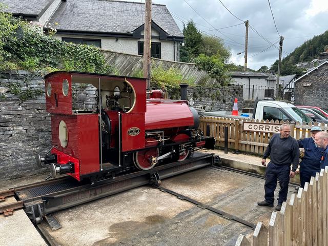

Once-at-Corris-No.-10-has-its-the-first-use-of-the-traverser-to-enable-it-to-be-repositioned-at-the-other-end-of-the-train-formation.-2106012558.jpeg
Once-at-Corris-No.-10-has-its-the-first-use-of-the-traverser-to-enable-it-to-be-repositioned-at-the-other-end-of-the-train-formation.-2106012558.jpeg (99.66 KiB) Viewed 23857 times

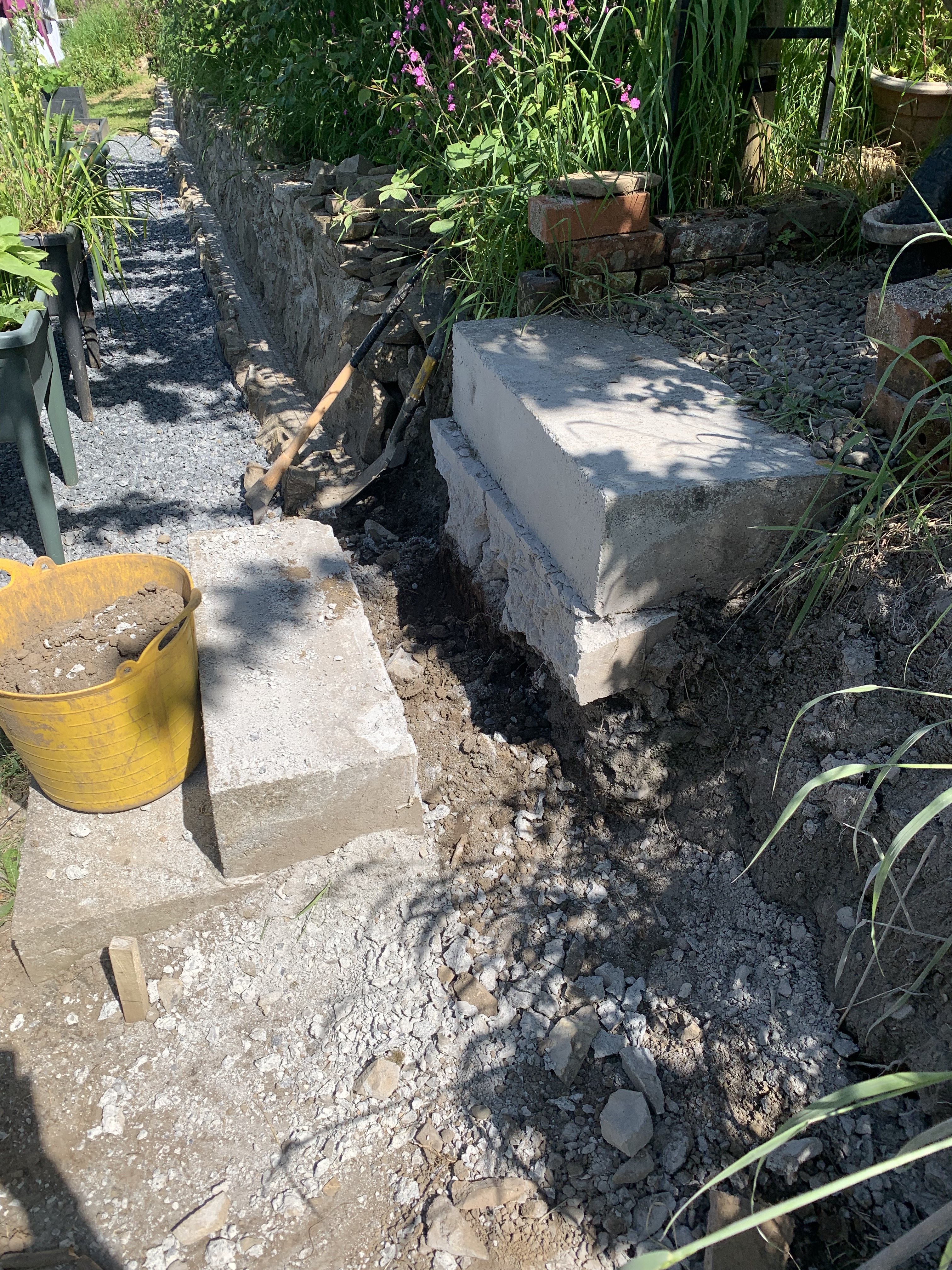

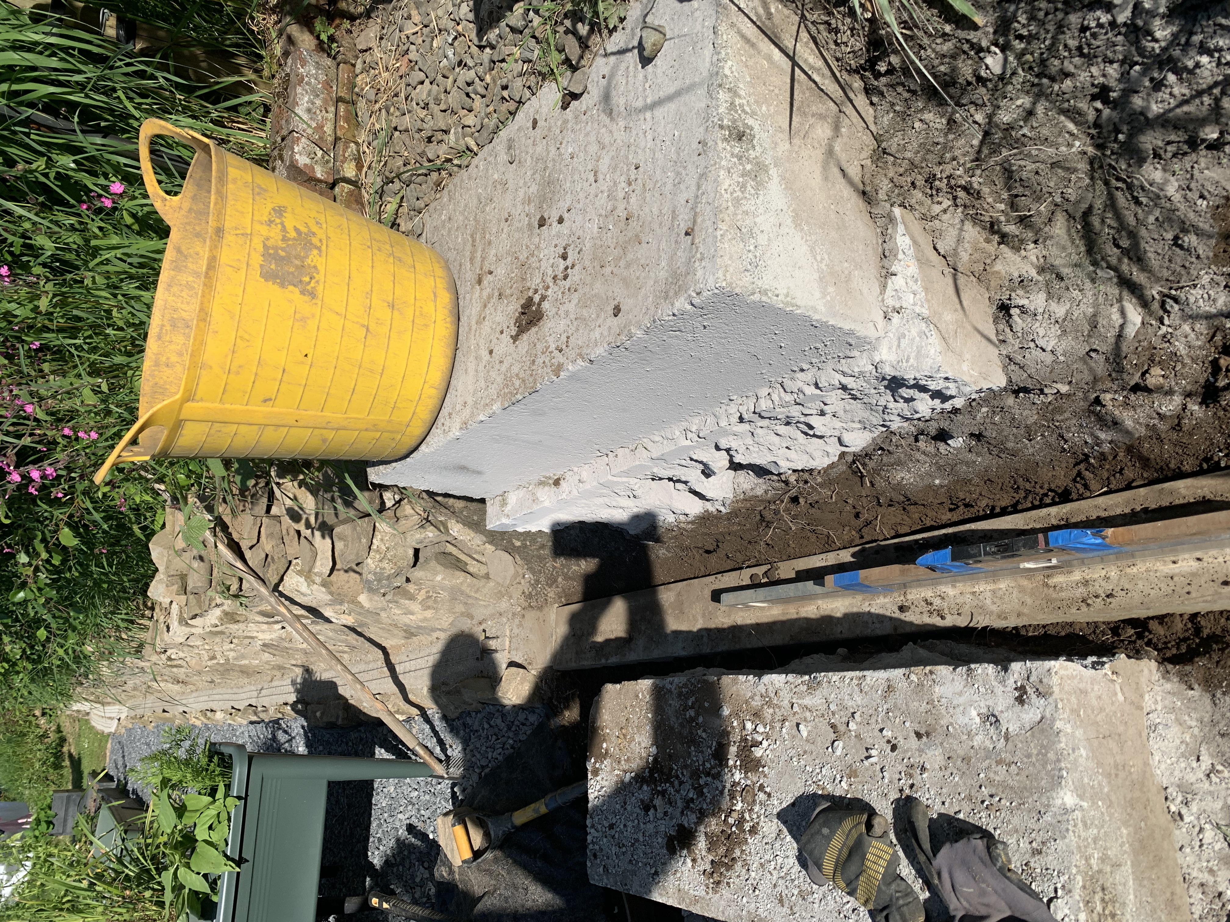

I have made a bit more progress:
That is the third step removed, and the second step trimmed back to make room for the tunnel. To do it I cut grooves parallel to the step using a 9 inch angle grinder, and then used an SDS hammer drill with a chisel blade to break the step up into handleable chunks.
The soil exposed by removing the step has been removed and I now have a length of concrete gravel board in place at the right height and angle to form the trackbed in the tunnel. So over the next few days I hope to be able to widen the hole, shutter and pour concrete to form the tunnel, and finally rebuild the third step.
