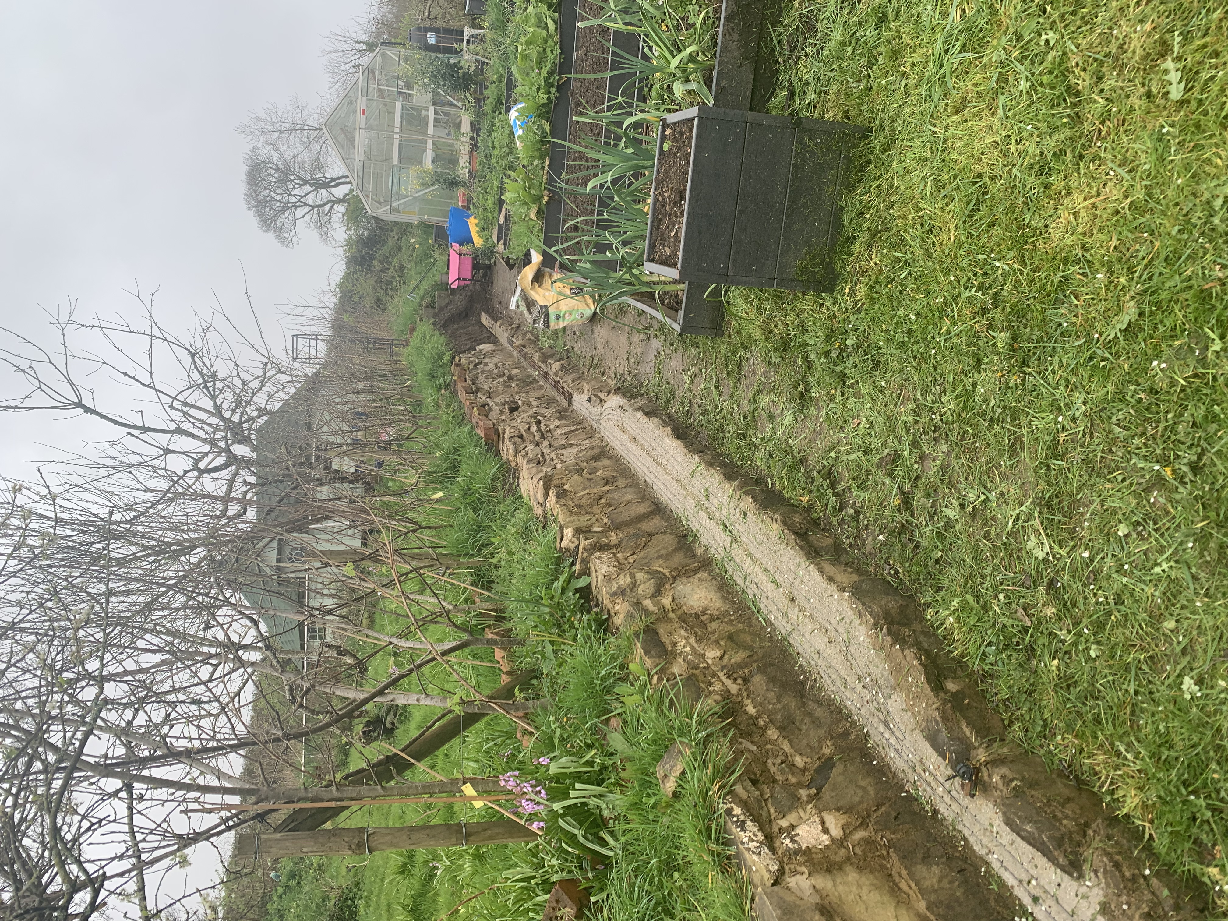

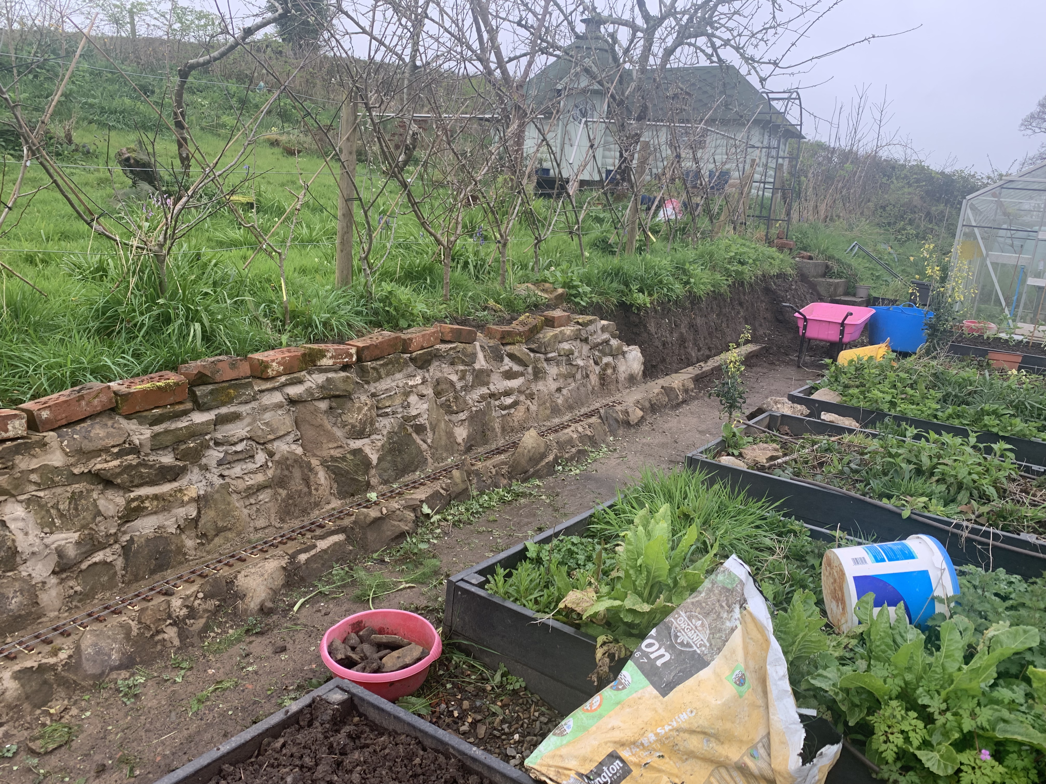

It has been a while since I posted an update. However things have been progressing. The bank has been excavated further, and I am now working on the last 5 foot to the concrete steps by the greenhouse. The retaining wall and the all important shelf for the track have also moved on, and there is "only" 12 foot of it left to make. Track has been laid along the completed wall, and the passing loop has been ballasted:

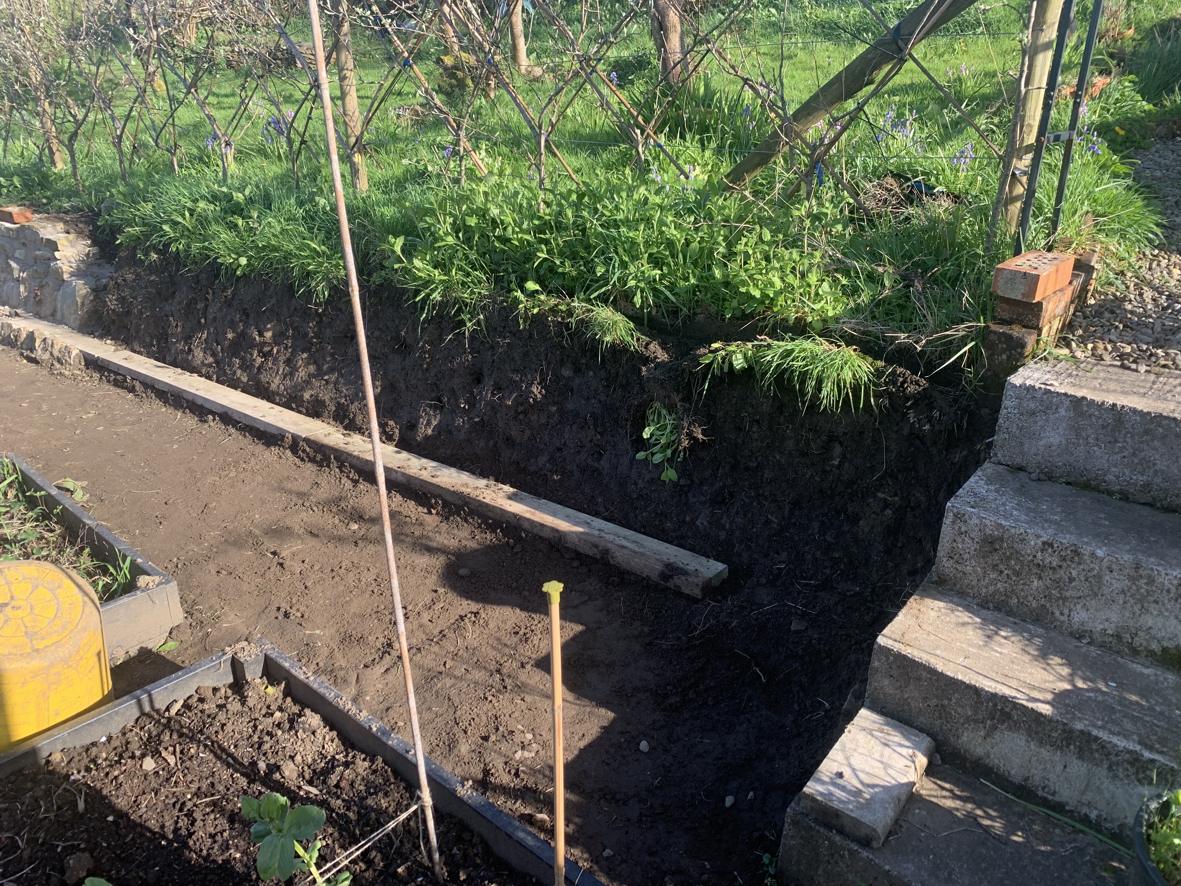

The digging continues!
I have now reached the steps, and laid the gravel board track bed in place. So I just have to build the last 12 feet of retaining wall:

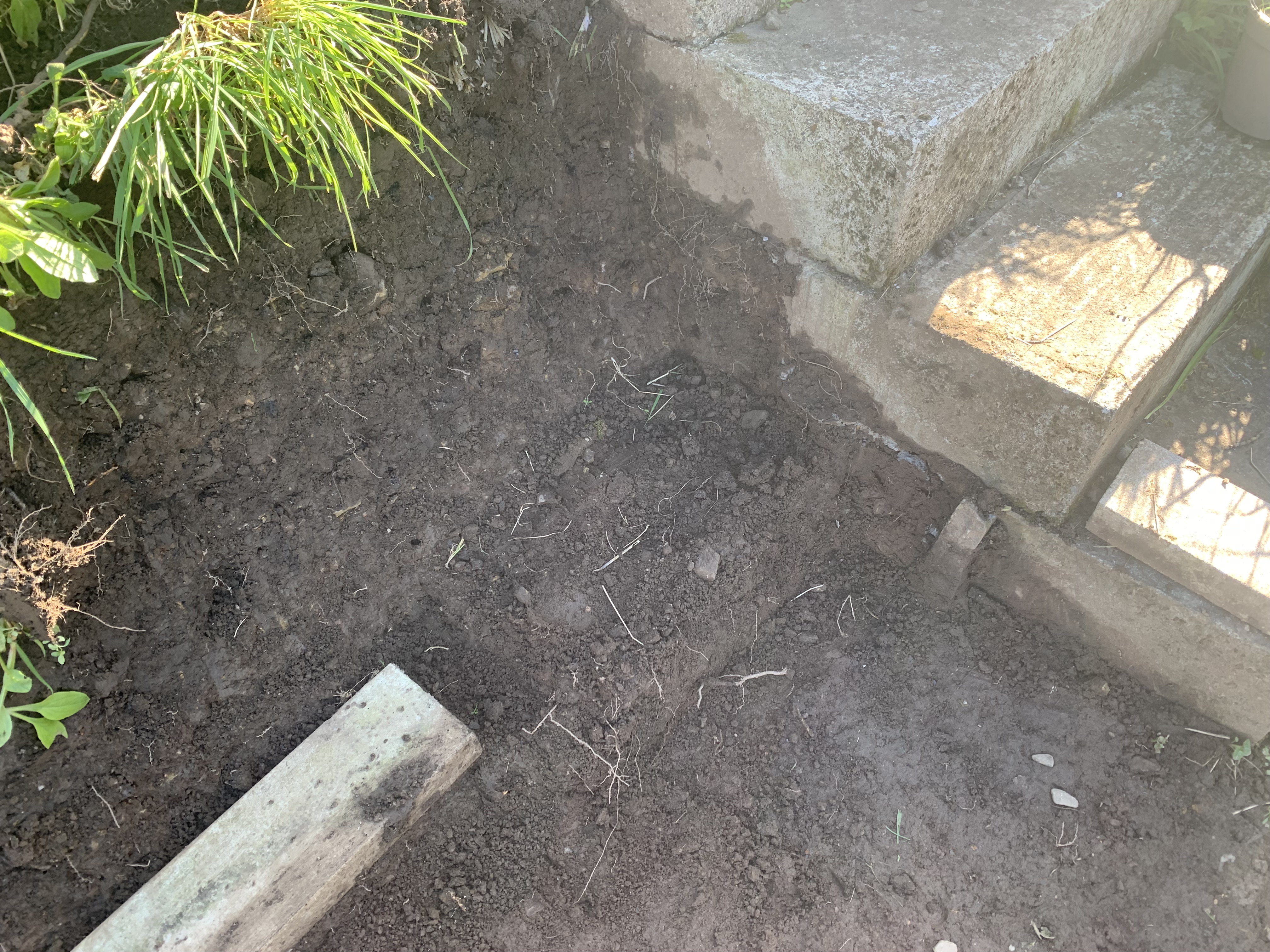

I can now see where the tunnel has to go - as in exactly where it has to go - and how it is to fit in with the existing steps:
I wondered if I could get away with just digging the soil out below the highest step in this photo. Thinking through how to actually do that, and how to line the tunnel (so that soil does not fall onto the tunnel track) makes me think that isn't the easy way to do it (if there is an "easy way" to do it). So I think I will use my large grinder to cut slots across the step, then use my SDS drill with a chisel, to break up that step. With the soil below the step exposed I can dig it out from above. Then lay the last piece of gravel board as a track bed, shutter and pour the concrete sides of the tunnel. Cover the tunnel with sections of concrete slab before shuttering and pouring a replacement step.
Of course before doing that I will need to cut away some of the bank behind the greenhouse, but then I have a gardener lined up for next week - so guess what he is going to be doing. The clue is I hope he likes digging!

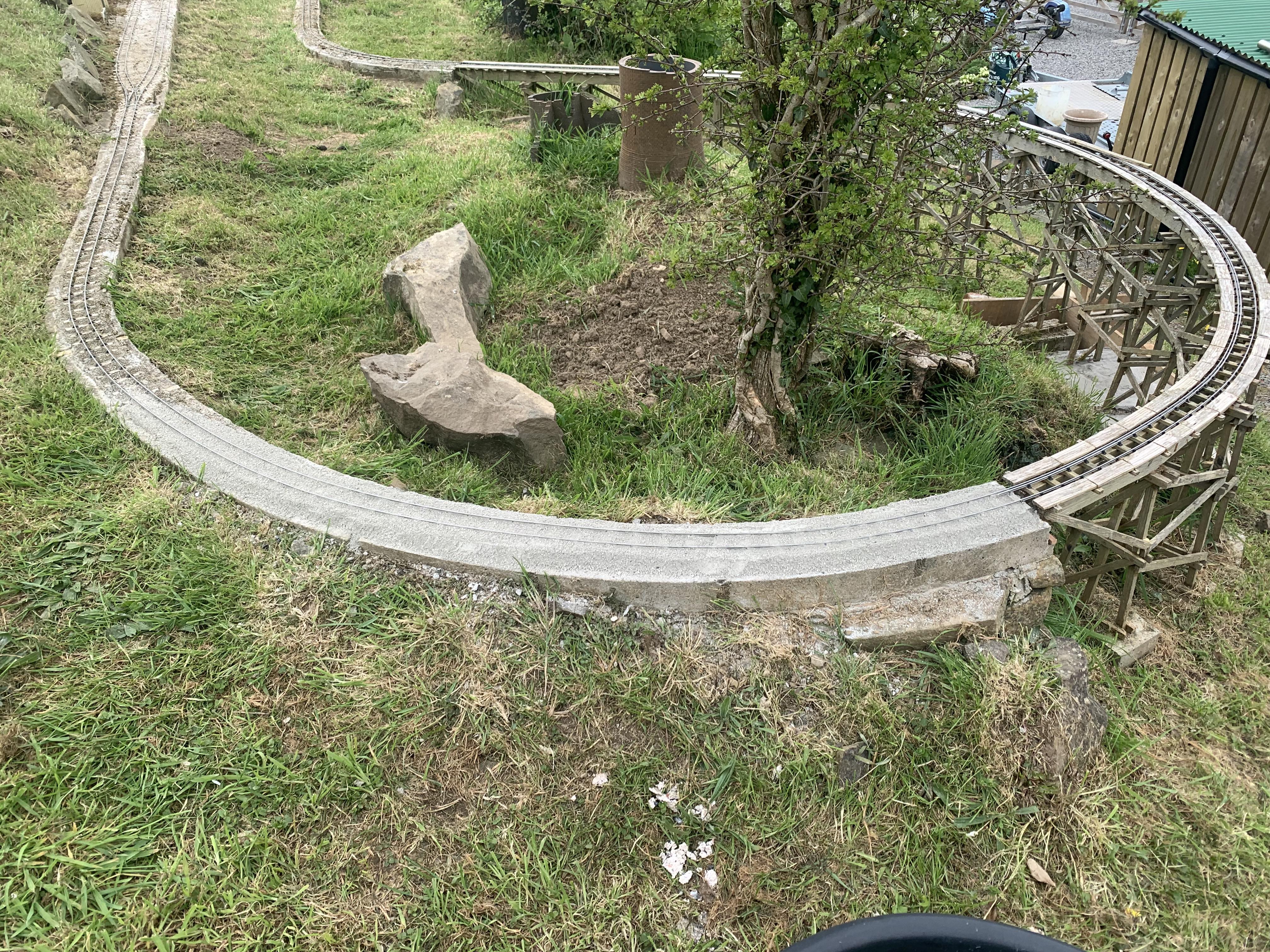

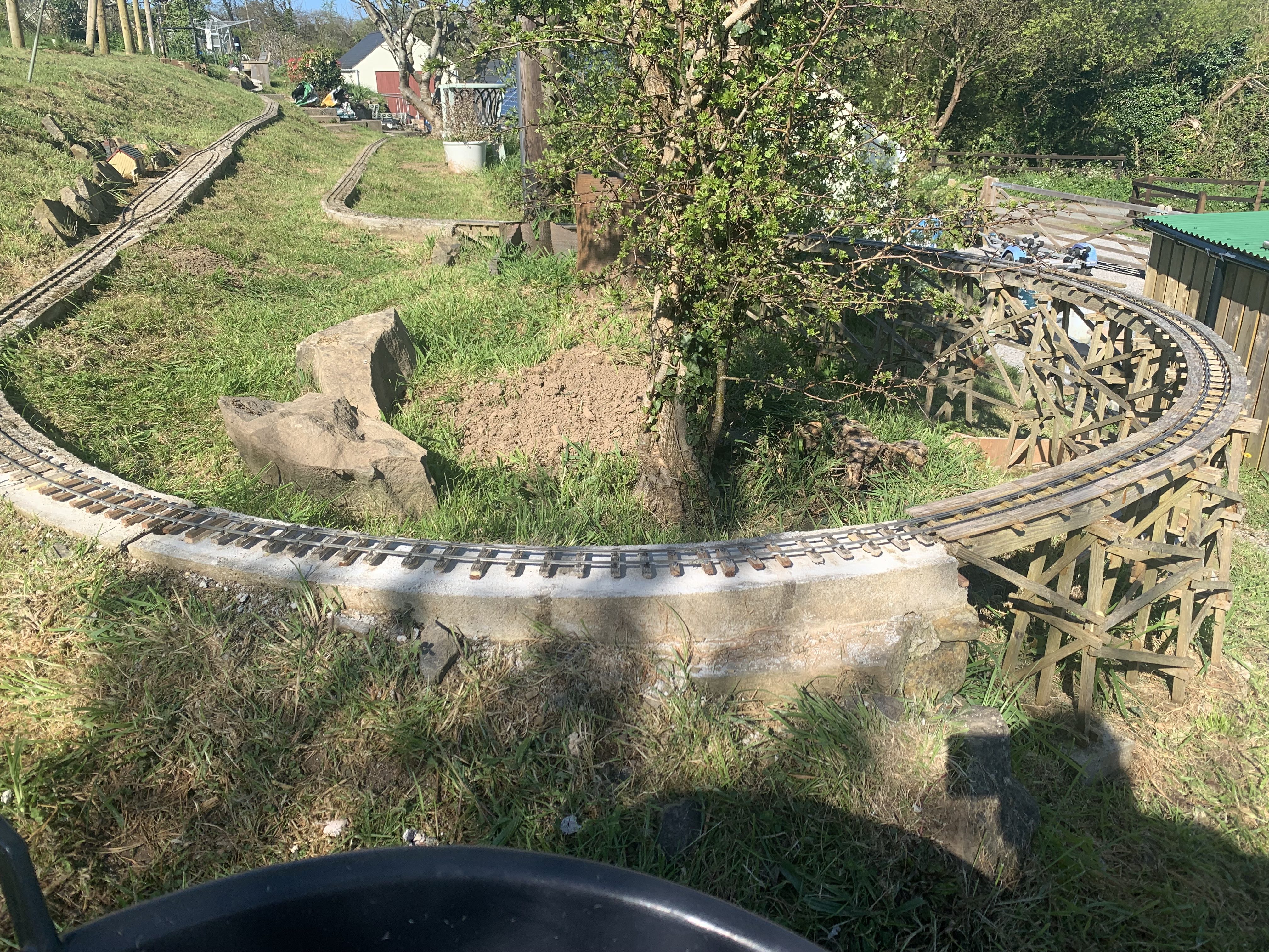

Posted: Wed Apr 24, 2024 7:32 am
by Trevor Thompson
It's stopped raining! :sunny:
So now for some maintenance:

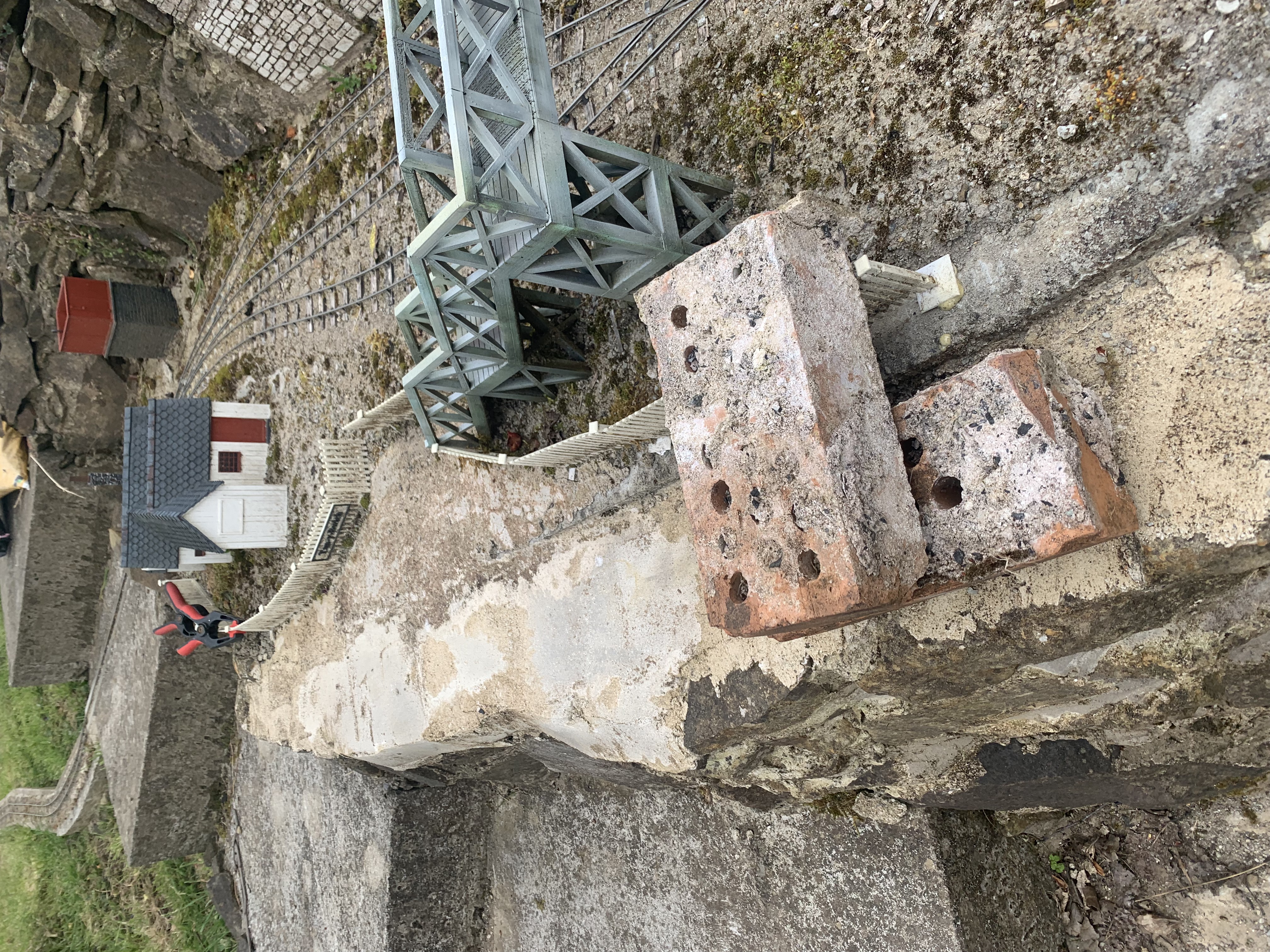

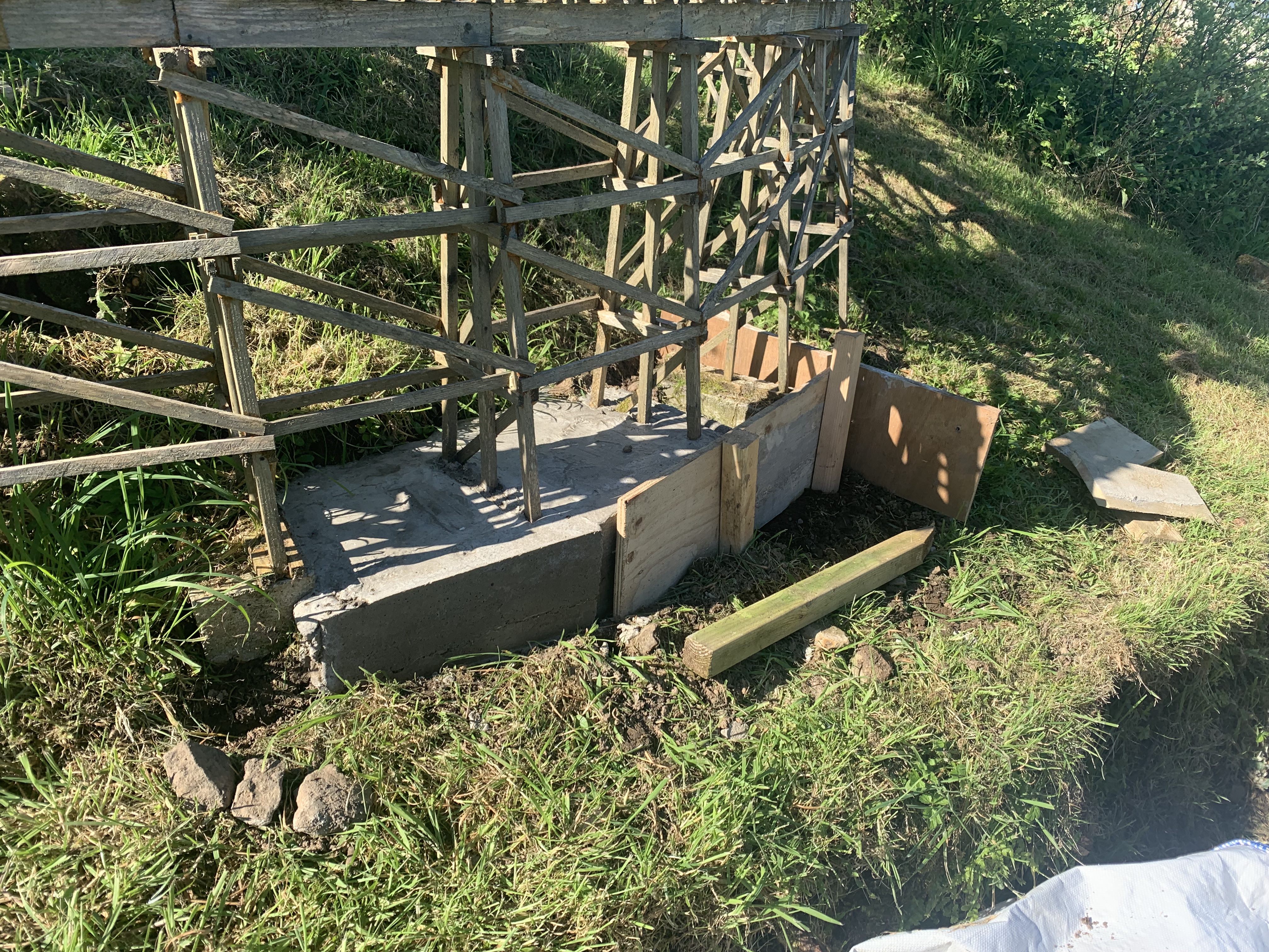

Firstly the viaduct needs some attention. The foundations have moved slightly ( I didn't make them properly). So I have reinforced them:
The first section cast and the shuttering in place for the second section.
Secondly the concrete foundation in the centre of the next photo has dropped slightly over the last 2 years or so, leaving some odd lumps in the track which long coaches struggle with. The last section of the viaduct took a decidedly downward dip to meet the concrete. So I have lifted the track and reset the last section of the viaduct so that it was in line with the rest of the viaduct. The track has been refitted into the gap and supported on spacers:
and re-ballasted:

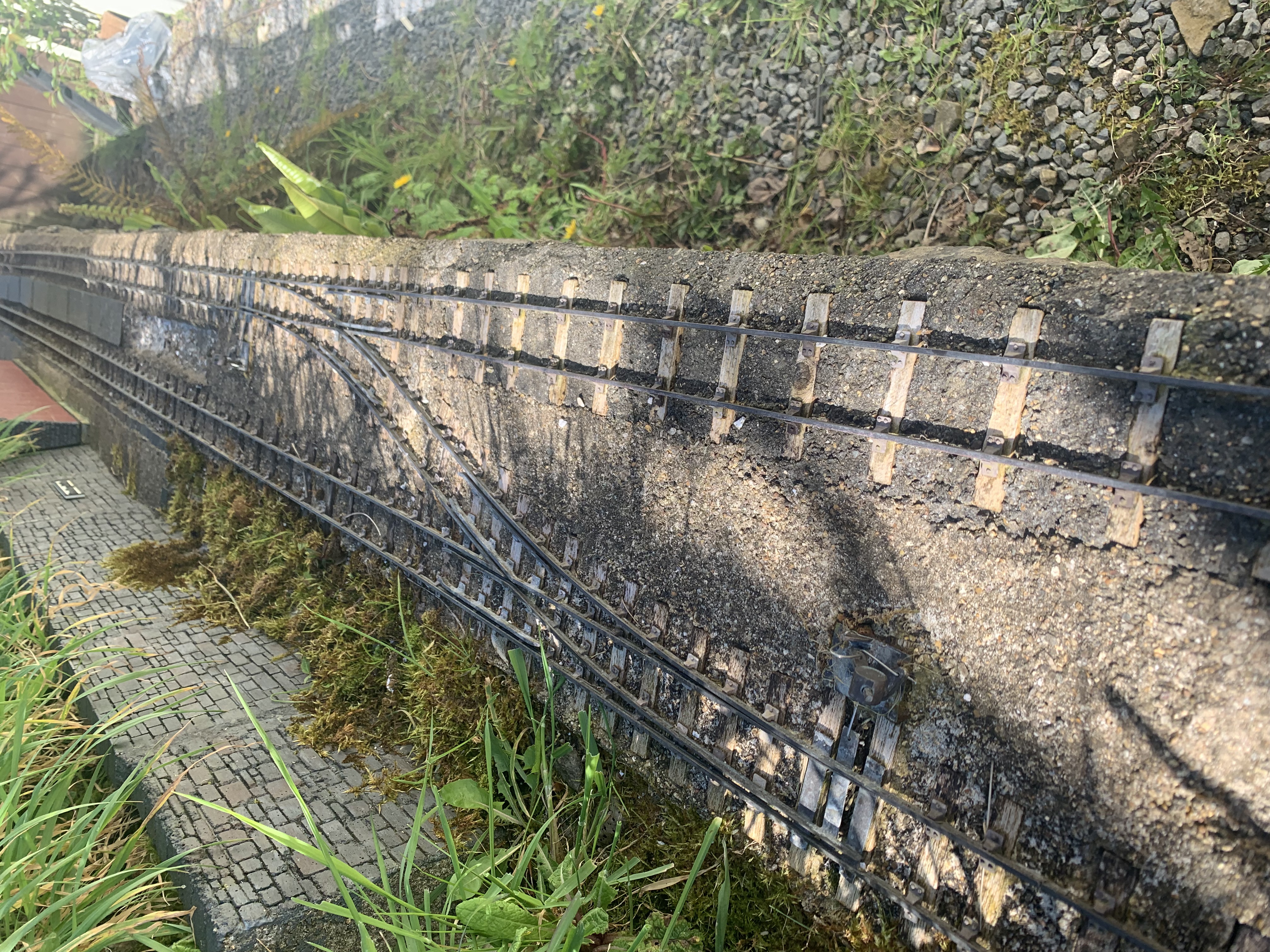

Lastly some of my early points are not working properly. These two have always caused the occasional derailment. So I have decided to rebuild them using my latest techniques ( which are still evolving after making 14 of them!). The points in question before being lifted:
More on the points later!
