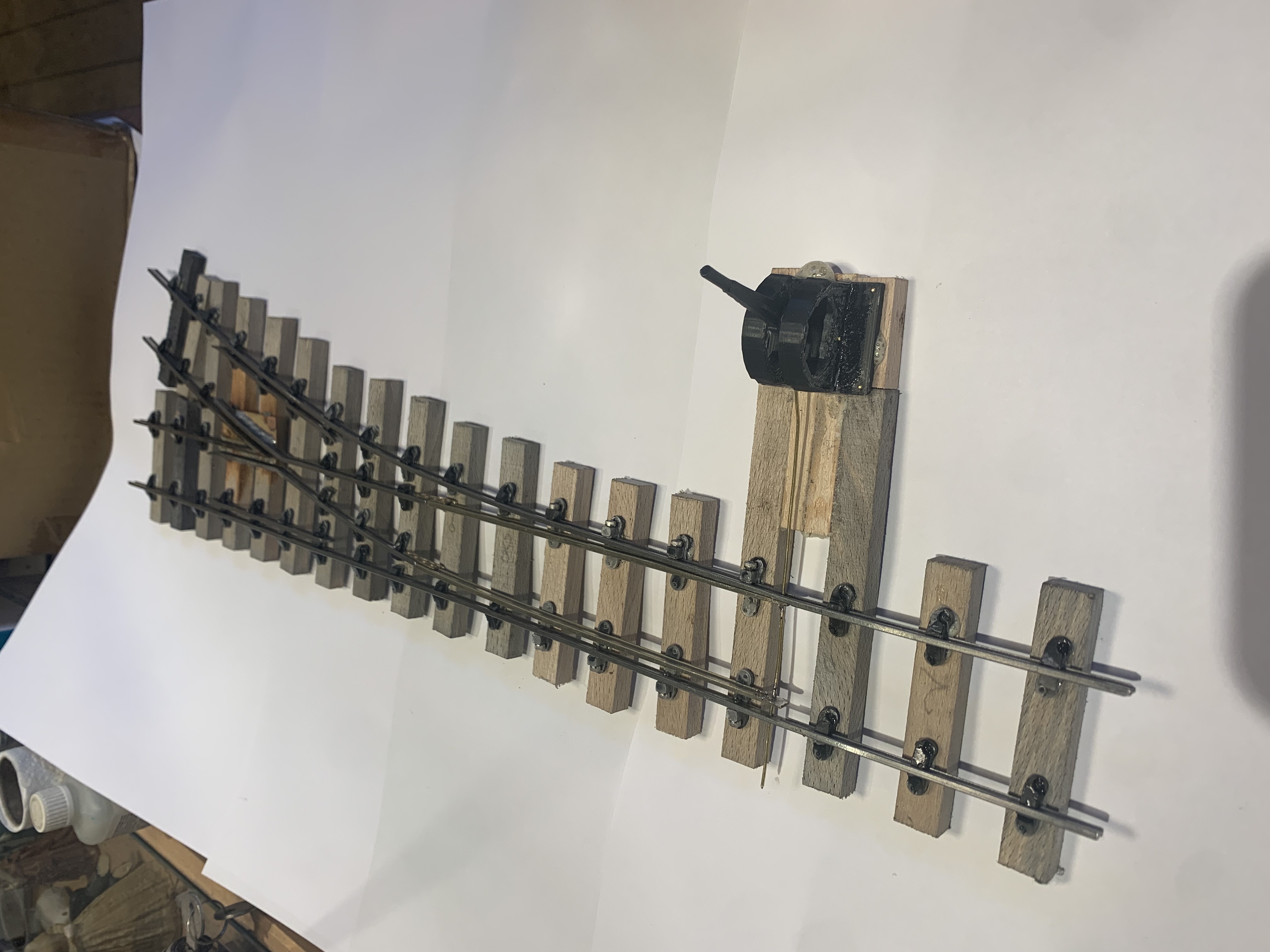

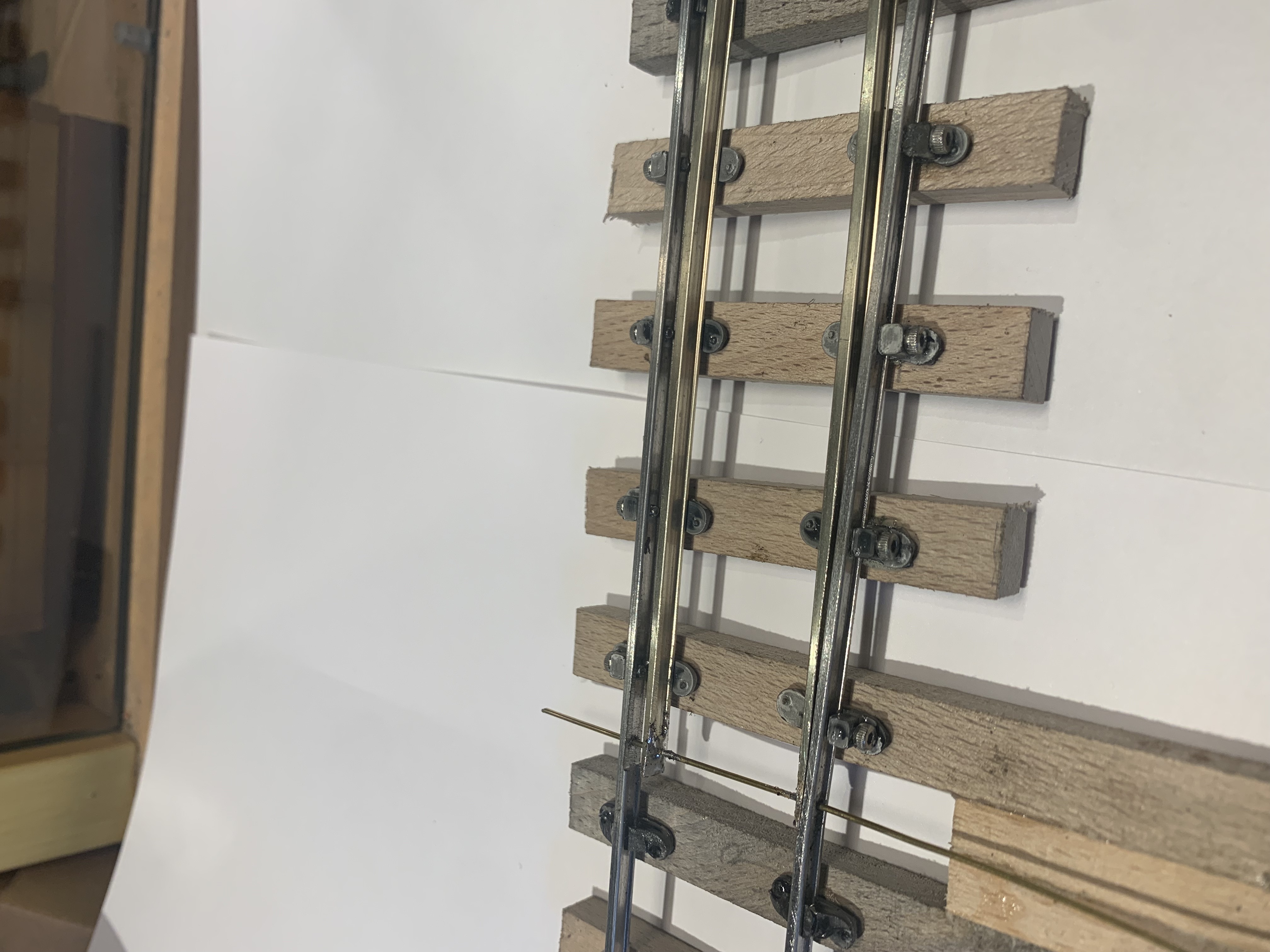

The first point is finished:
The rail is stainless apart from the point blades which are nickel silver, which is easier to solder reliably. I have used the same printed point lever I used the last time I made points. It seems to work and is quicker to make than the same made from brass.
Bolting the half chairs to the rail in way of the blades worked well, and I didn't even have to grind off any of the bolt to clear the blade. I think the trick to getting the correct track gauge in way of the blades is to introduce a slight kink in the rail on the curved rail. You will be able to see the kink in the photo. A detail showing the bolted chairs and the point blades:
I have found the most effective way of linking and controlling the blades is to drill a 1.3mm hole through the outer rails and the blades. Then pass a 1mm brass wire through the holes. Using whatever point actuator is fitted to this point I then solder the wire and the blade on the inside faces of the blades. In this case I measured the throw of the lever ar 4.5mm, so I placed a 4mm drill between the blade and the rail, while soldering them together. I then moved the lever so that the soldered side touched its rail, and repeated the soldering operation on the other side. After slight tweaking to even out the slight spring in the wire, the blades sat neatly where they should.

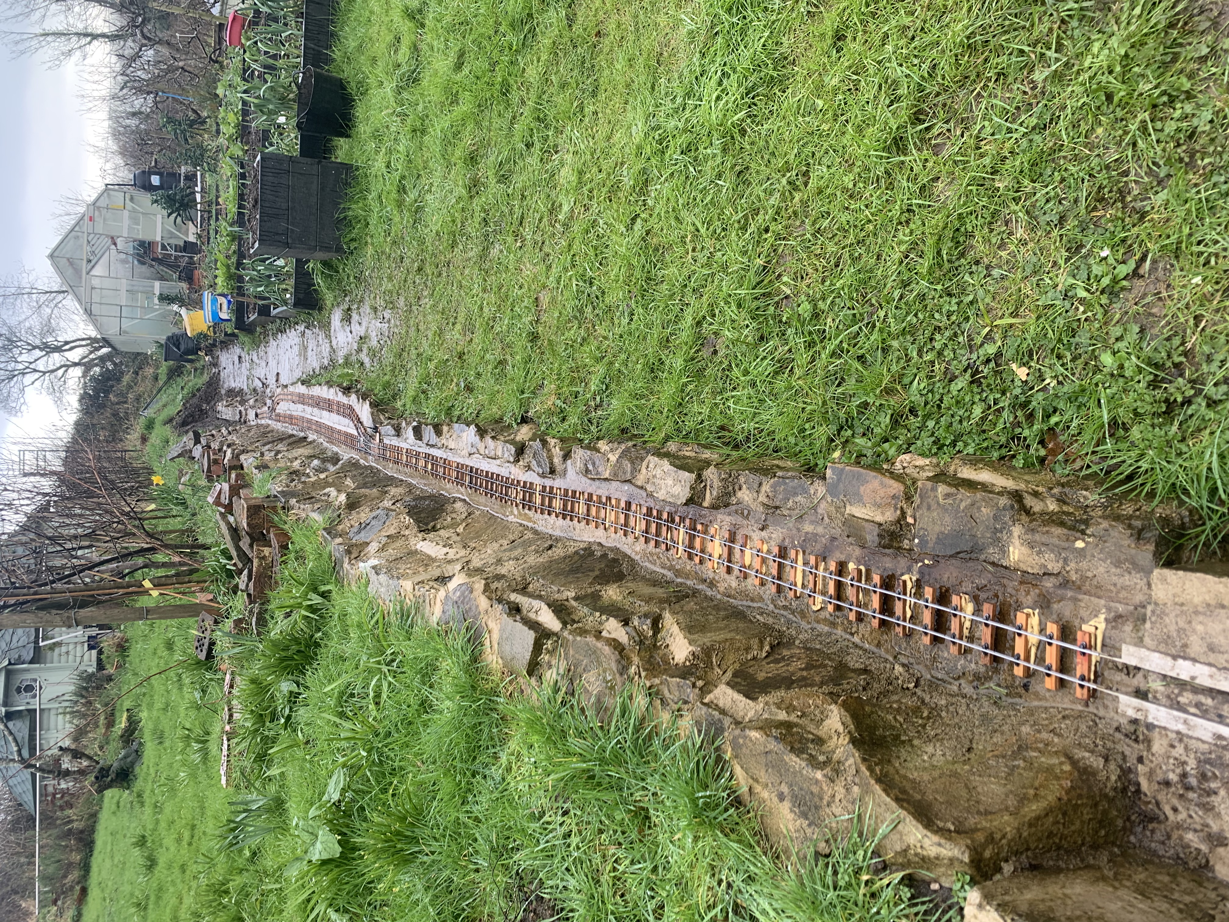

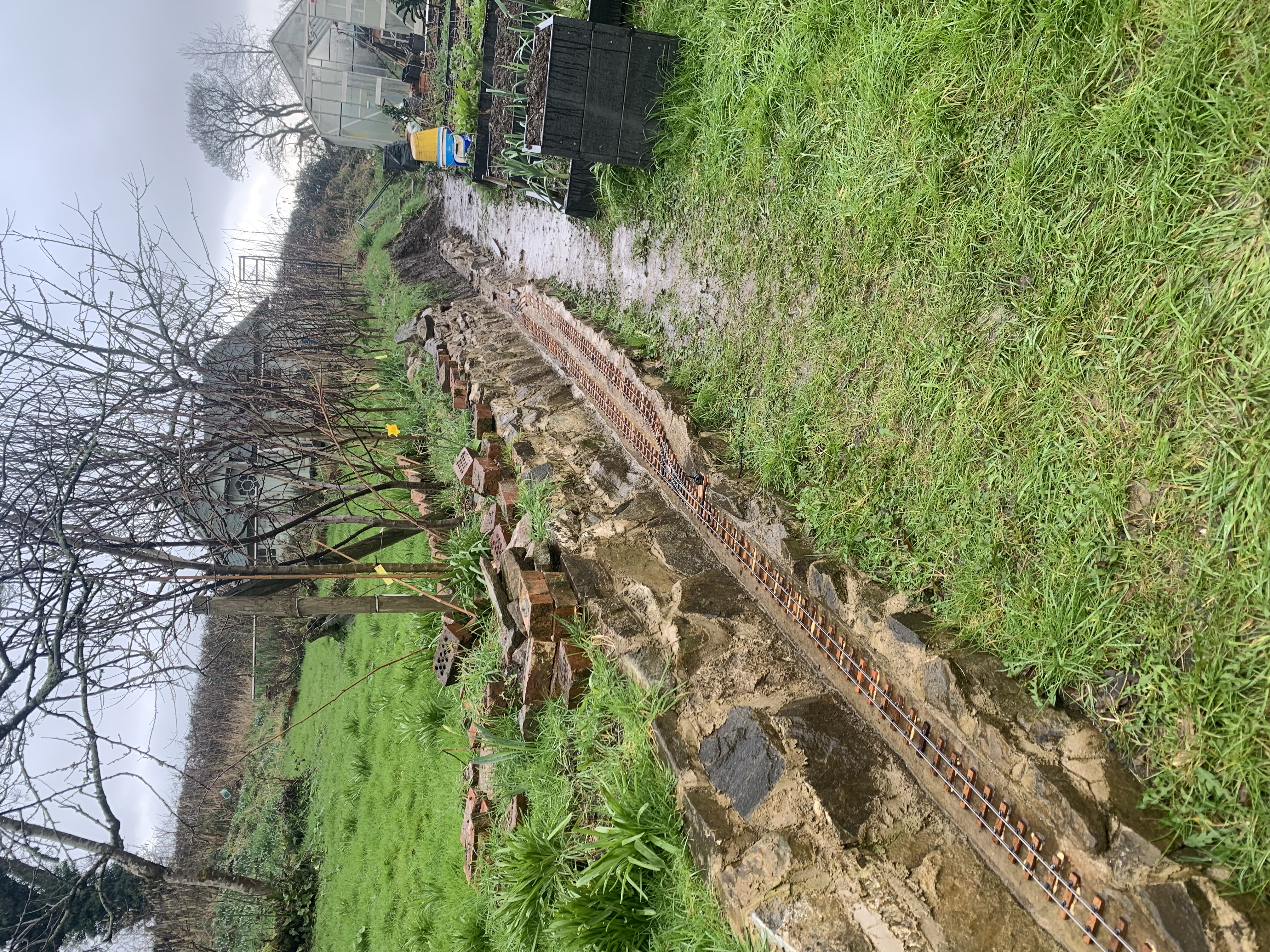

After more weather related delays I have now laid the track to create a passing loop half way between the tunnel and the proposed terminus:
the retaining wall is also slowly advancing towards the greenhouse, 2 metres at a time:
I just wish we had some dryer weather!
Posted: Sat Mar 02, 2024 12:35 pm
Is that Gorilla Glue between the sleepers and the trackbed? Ingenious idea for both levelling and for cushioning if so.
Posted: Sat Mar 02, 2024 2:35 pm
by Trevor Thompson
ge_rik wrote: Sat Mar 02, 2024 12:35 pm Is that Gorilla Glue between the sleepers and the trackbed? Ingenious idea for both levelling and for cushioning if so.
Yes -it certainly is. I use it a lot for all sorts of things. I like it being cured by dampness - really useful here. The only problem is getting it on my hands which I inevitably do, and that gets me into trouble. I can't really do fiddly things with gloves on.

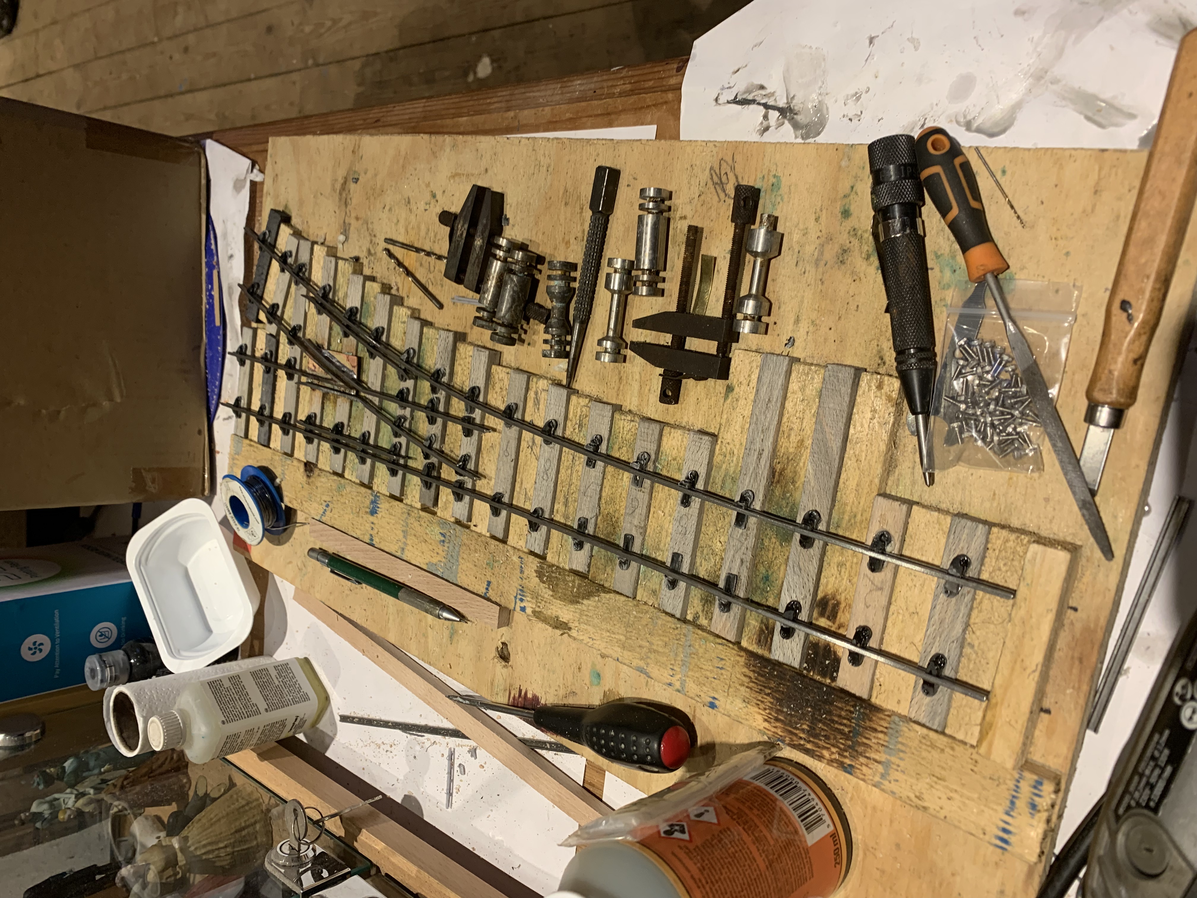

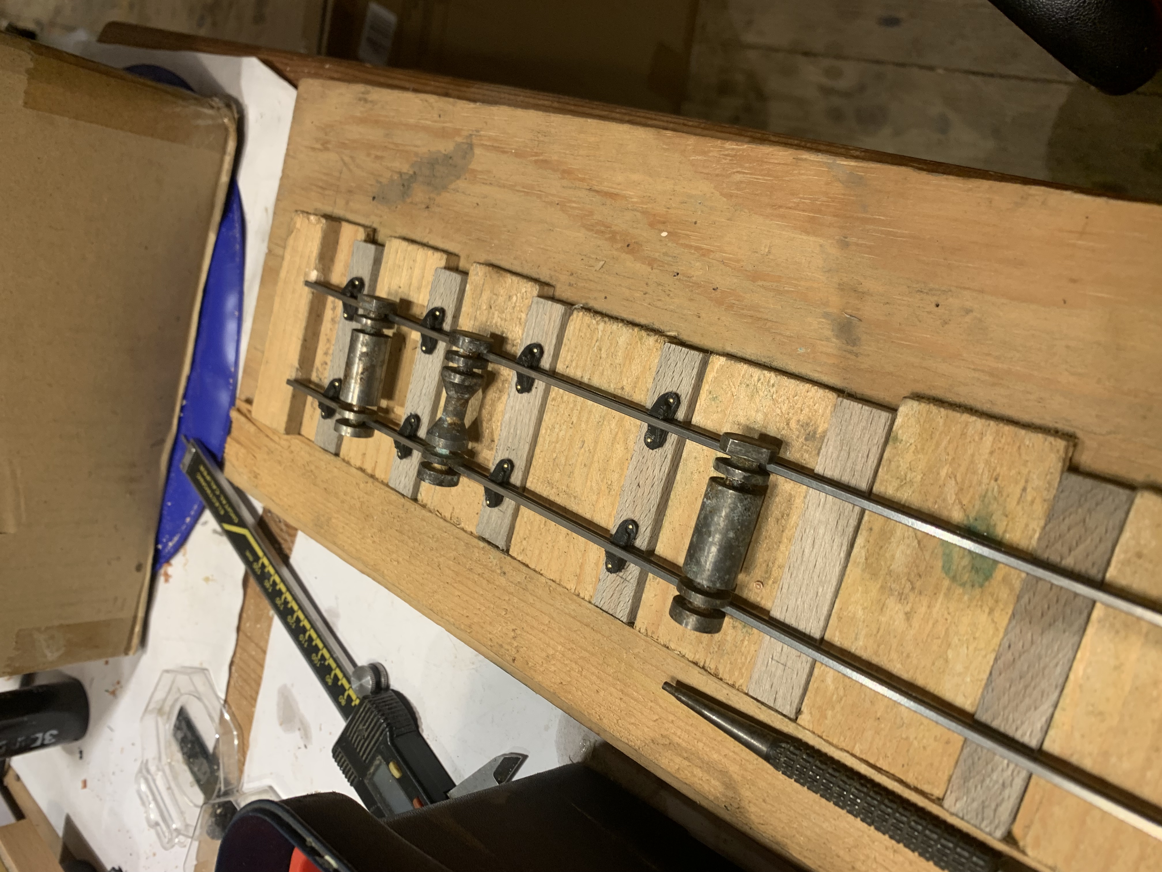

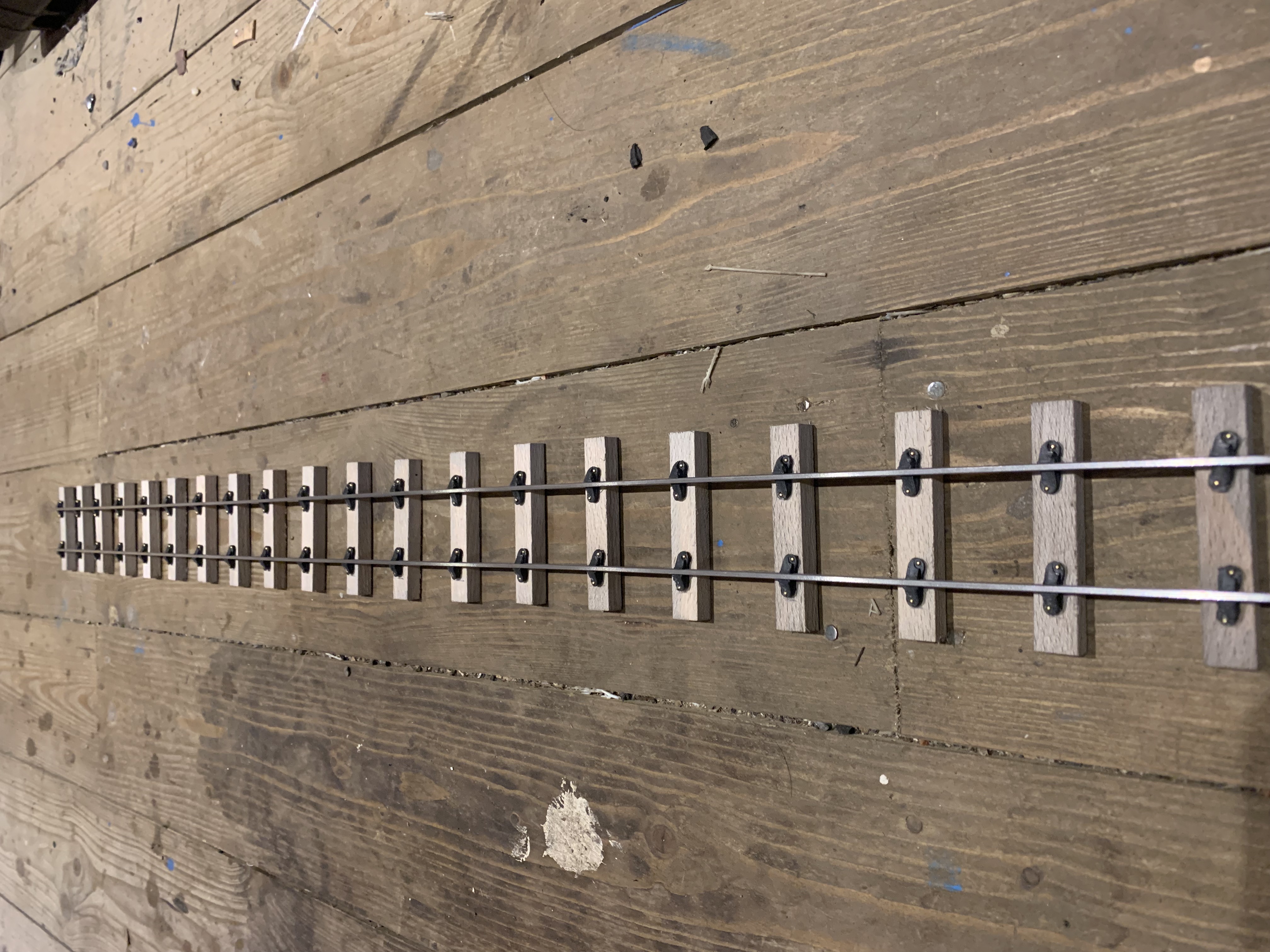

Making track again.
I am experimenting with ways of fixing chairs to the sleepers. I know I can successfully print my own chairs in ABS - but the weak point is the printed 3mm "pin" which fits into the hole in the sleeper. The batches of chairs with the pins printed in position don't always place the pins in exactly the correct place - there seems to be some sort of loss of registration during printing, which results in get gauge being oversize - say 34mm rather than 32mm. That has prompted me to go back to first principles and question why I was using the hole and in the first place. I suppose that I do that because that is what all of the bought chairs use. So what about doing it properly and use brass pins?
Would it be quicker to mark the sleepers (to centre the rails on the sleepers), drill the 0.5mm holes for each pin, and hammer the pins in or would it be quicker to drill the sleepers using my jigs, dip the chairs in acetone, and glue the chairs into the holes?
The design for the chairs has been altered to replace the dummy bolts with printed holes, and I'm trying it out:
I have already identified that the chairs are quite strong enough as printed - it was the printed pins which were the weak point. I will let you know how I get on after the first length of track is completed.
Posted: Wed Mar 06, 2024 7:13 am
Are you going for 45mm gauge with this track?
EDIT: Sorry, just realised the inner groove on the roller gauges is for the check/wing rails.
Posted: Wed Mar 06, 2024 5:52 pm
by Trevor Thompson
ge_rik wrote: Wed Mar 06, 2024 7:13 am Are you going for 45mm gauge with this track?
Yes that is correct - the only issue with the roller gauges is that the 16mm Association standards for wing rails are 3mm not 2.5mm - so that explains why I use a 3mm drill so set the wing rails!

Well printing should give accurate results, but I think in this case each chair is poised on the top of a 3mm diameter pillar which is about 7mm tall. It just needs the slightest loss of alignment to make some of the chairs inaccurate. Certainly dispensing with the pillar has made them more usable, quicker and cheaper to make.
The only holdup was waiting for some "no 76" drills (0.51 mm diameter) to pre drill the holes for the 0.56mm diameter pins. These small brass pins are soft and bend readily. Now they are going together quite easily and as hoped more quickly than my old method. It is also quite satisfying to make them in the same was as the real thing. So the first length of track made this way:
