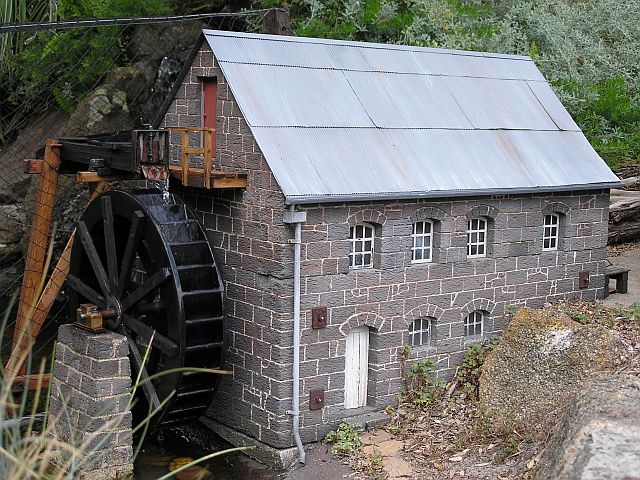

OK so Healy's Mill with the new wheel doesn't look much different to the old one.
Mill Repairs 6.JPG (121.13 KiB) Viewed 14644 times
But the difference is "what's under the bonnet" as the car salesman said.

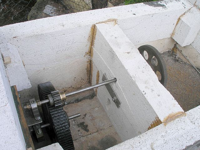

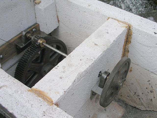

It's always bugged me that the wheel, although turning slowly didn't look like it was doing any work. It's hard to explain
and perhaps I'm a little pedantic! So I foraged around in past made junk to find some iron pedestal bushes, bored a hole in
the central wall, and mounted a second shaft above the wheel shaft. The flywheel already on the wheel shaft was a 112 tooth
7"diam. Boston gear, and a 16 tooth Boston with a roller clutch in it fitted to the second shaft gave me another flywheel
running 7 times faster than the wheel.

I've watched many British mill videos, and one of Calbourne Mill has a sign saying it ran at 6 rpm. for a 20ft. wheel. Mine
is 18ft. and while 6 rpm in model form looks too slow, the wheel now runs at 12 rpm all day and looks truly hydraulic in
it's action :D :D
