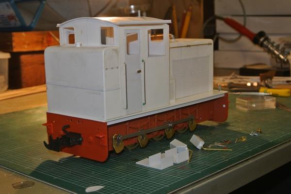

I spent most of yesterday making fittings such as cab handrails and lamp brackets etc. Christmas holidays are now rapidly running out as it's back to work Monday. What have i got left to do:
Cab glazing - i have a plan for this...
finish interior cab fittings
fuel filler (its mostly made)
some more strapping and rivet detail
a few more twiddly bits as the fancy takes me.
And then painting. Won't be finished this week, but maybe next weekend will see more progress.

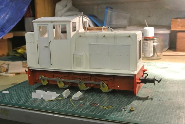

This evenings update
Post by ikcdab » Tue Jan 07, 2014 10:26 pm
Here is where I am now up to. Pretty well complete - only things outstanding are glazing and painting.
Seen here is the engine is bare plasticard with various fittings - sandboxes, windscreen wipers, handles for nose doors etc alongside waiting fitting when painted. Also i need to decide how to fix the cab roof down- the curve isnt quite enough yet. I may try a little gently reheating....
I now need to go to Halfords to get some paint - it wont be for a couple of days, but hope to see further progress by the weekend!

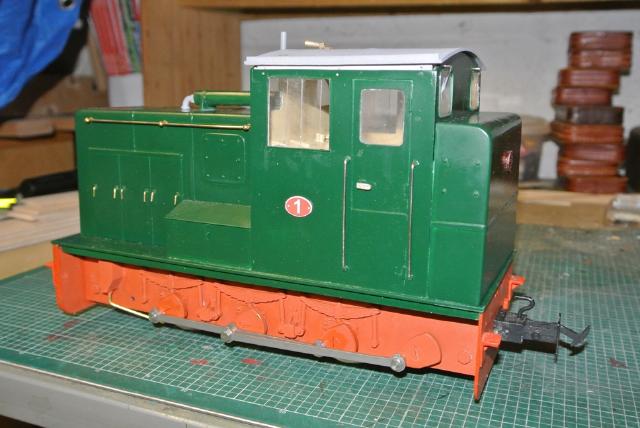

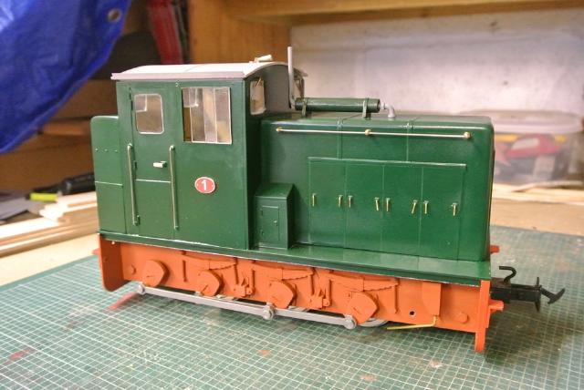

And now its finally finished....
Post by ikcdab » Sun Apr 20, 2014 7:06 pm
Didnt quite complete the project at Christmas and then work intervened, but keeping up the 'holiday' theme, I have used Easter to finish off the little beast. Here it is. All complete with Deltang RX65 radio control gear - highly recommended!

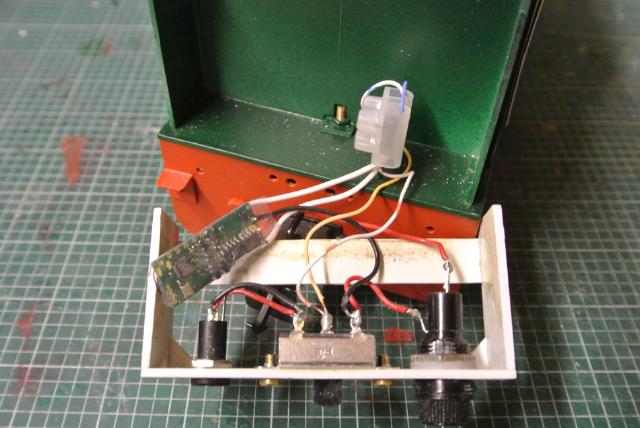

This shows the Deltang combined ESC and RX on the left. I have wired a DPDT switch so that the batteries are either connected to the ESC via a fuse (right) or to a charging socket (left). Should all be clear!
Power is 8 x AA rechargeable cells, mounted in the bonnet.
I dont yet have a garden line - it is just beginning construction, so all the loco has done is run up and down the kitchen worktop. So just now need a volunteer to let me run it!
