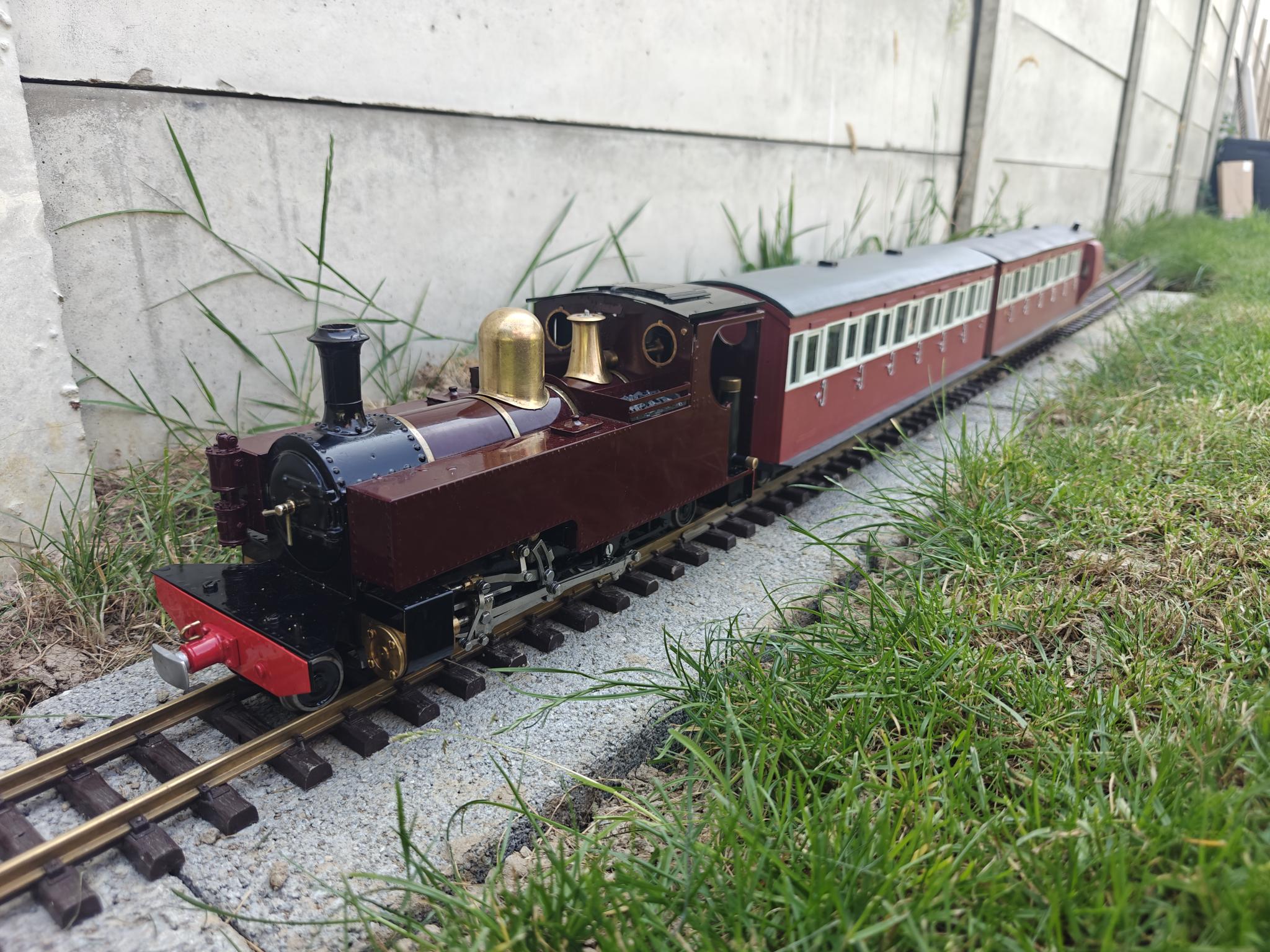

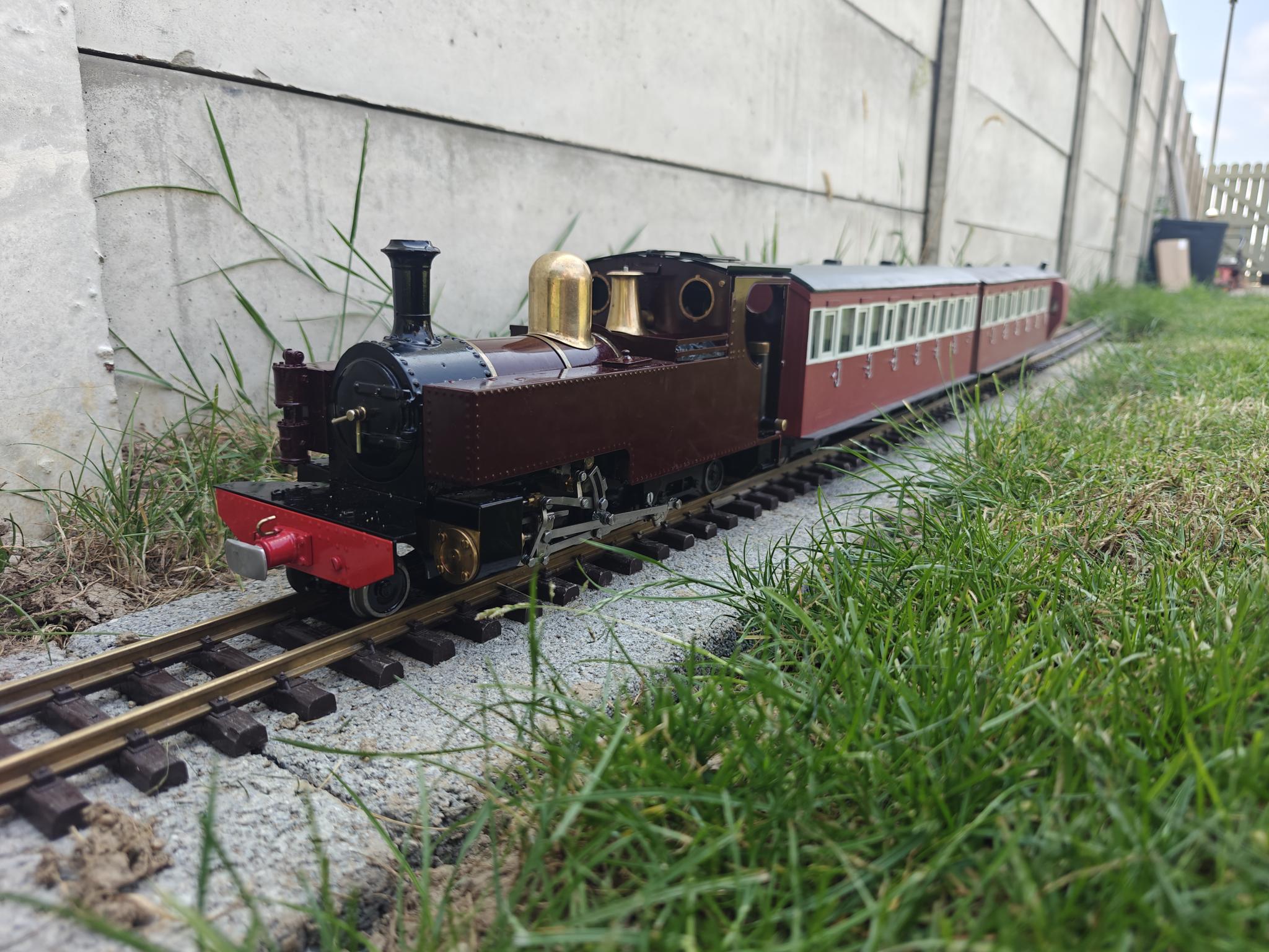

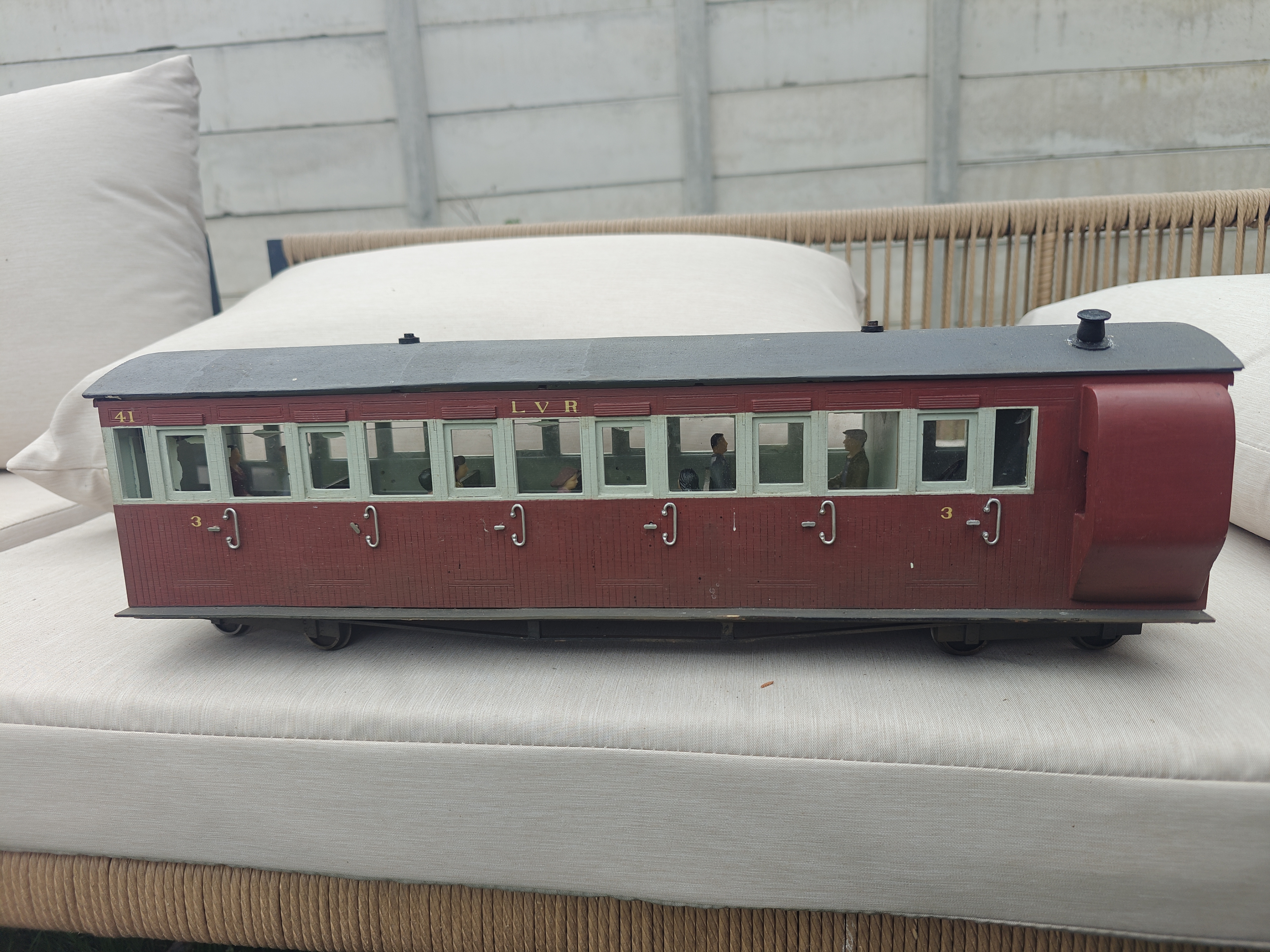

Couple of new additions to the roster, a Roundhouse Russell ran lightly bought for £400.00 because it ran really poorly, only the boiler was full of limescale and derailed everywhere, on closer inspection at home the front and rear pony wheels were installed in the wrong ends - resulting in derailments at every minor track imperfection. Ten minute fix and runs like any roundhouse loco should. An overnight limescale flush is next on the agenda for that. Coaches a purchase from eBay for £25.00 each, there are two more coaches of the typical Bachmann big haulers style in the same livery included in a job lot for £100 - all going cheap because one axle was snapped, but still present and included.... 5 minutes of no more nails and it runs wonderfully.
I also have a few more bits from where I got the Russell, I'll post those later.
Tomorrow it is back to laying the track bed and Wednesday I'll go to the builders merchants and buy £20 more of bricks... (that's all I can fit in a saloon car boot).
I appreciate the lining and ballasting tips, I will source some edging to go with the track bed Wednesday.
If anybody recognises the coaches let me know i.e. where they came from or what kit they're built from or even who owned them last, I wouldn't mind some more.

Looks great, you got a bargain there,
Posts: 7990
Re: Stawberry Valley Light Railway
Post by ge_rik » Tue Jul 21, 2026 8:31 am
gilfachphil wrote: Tue Jul 21, 2026 7:04 am Looks great, you got a bargain there,
My thinking on both counts.

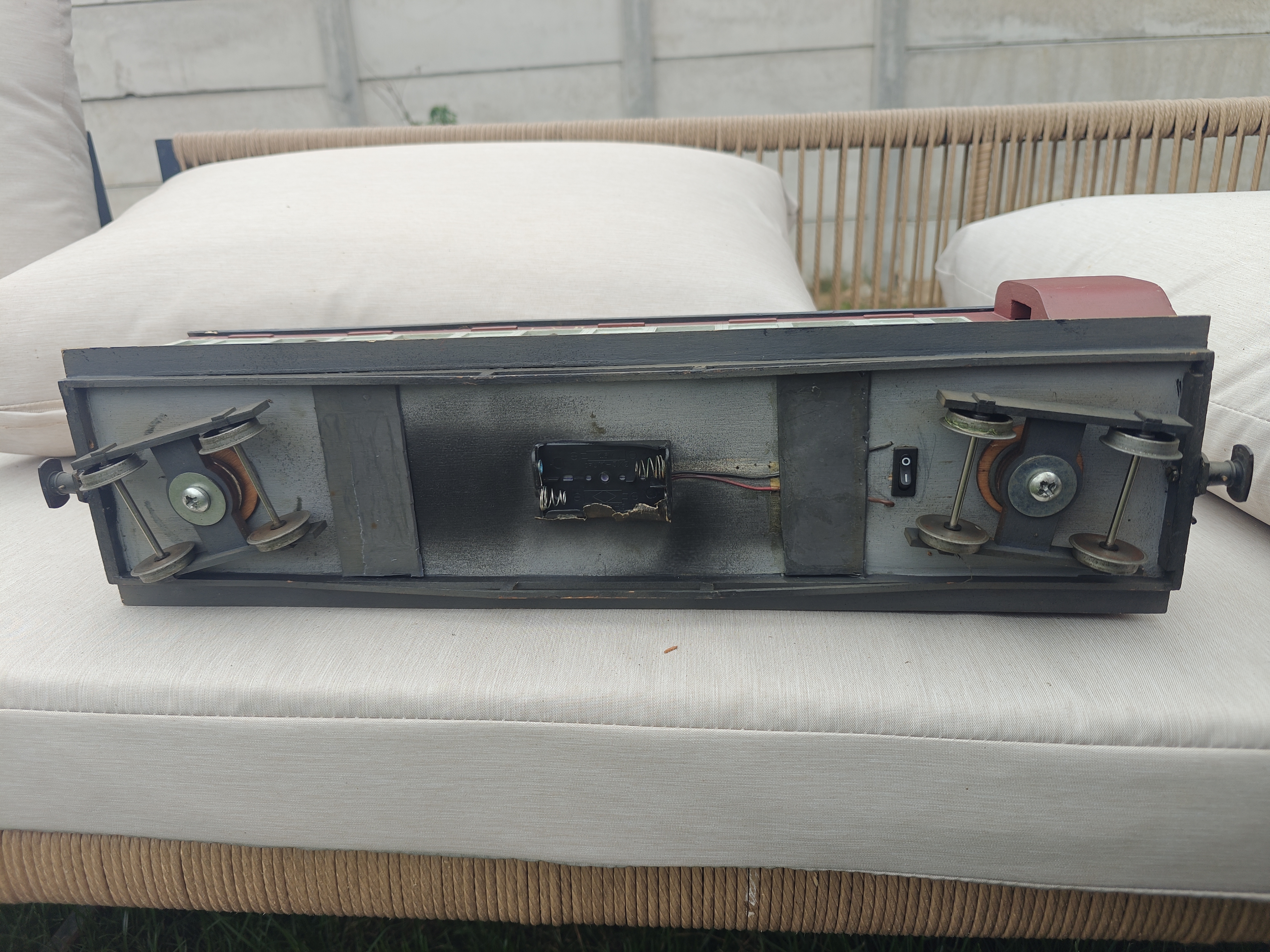

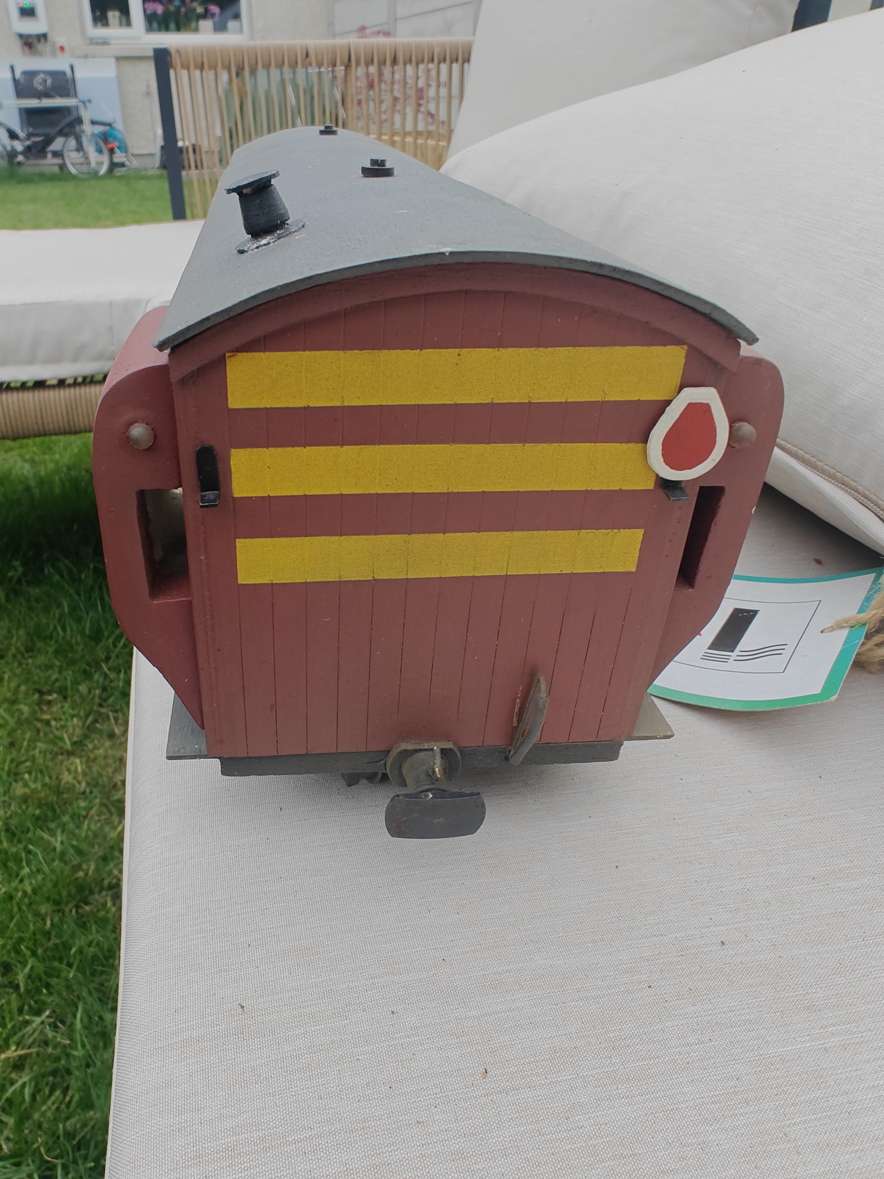

Can't identify the coaches. Are they ply or plastic?
It appears to be laser cut ply. Here's some more photos.

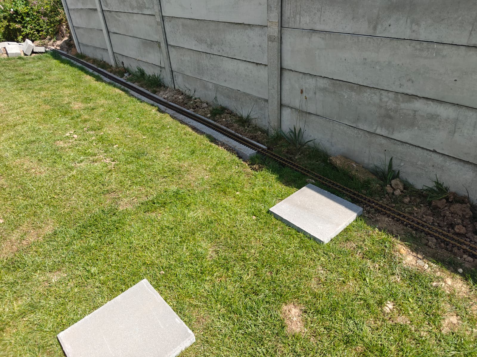

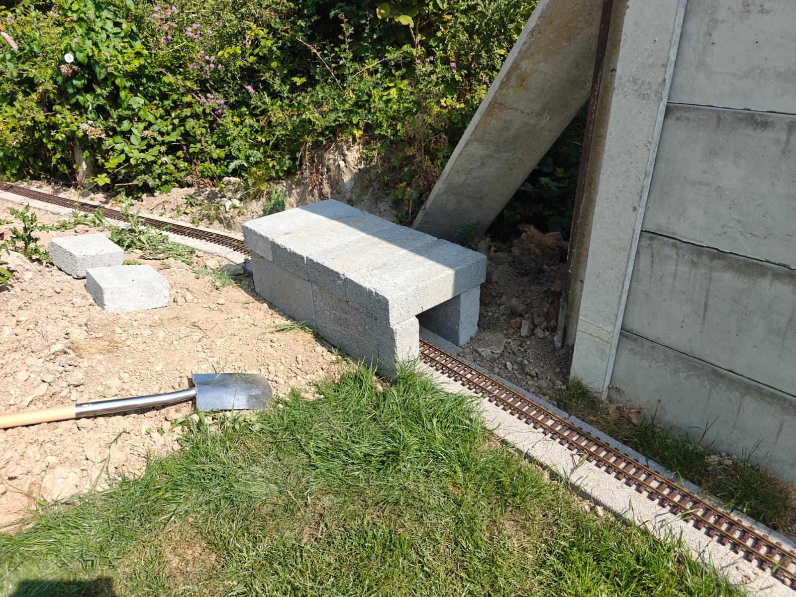

So I managed to get some more bricks today, and will pick up some more tomorrow...
I found a spot for a small station to be placed whilst I was laying the track back. I now have a siding where a station will be.
I also smoothed out some track bed that was already laid to make a smoother transition to slight inclines.
I put the bricks in where I will place a tunnel, It will be covered in clay from a small pond I am going to build. It will also have a small stream/waterfall running over it.
The paving slabs are for a shed the railway will run through in the corner of the garden.
Here is some more progress pictures.

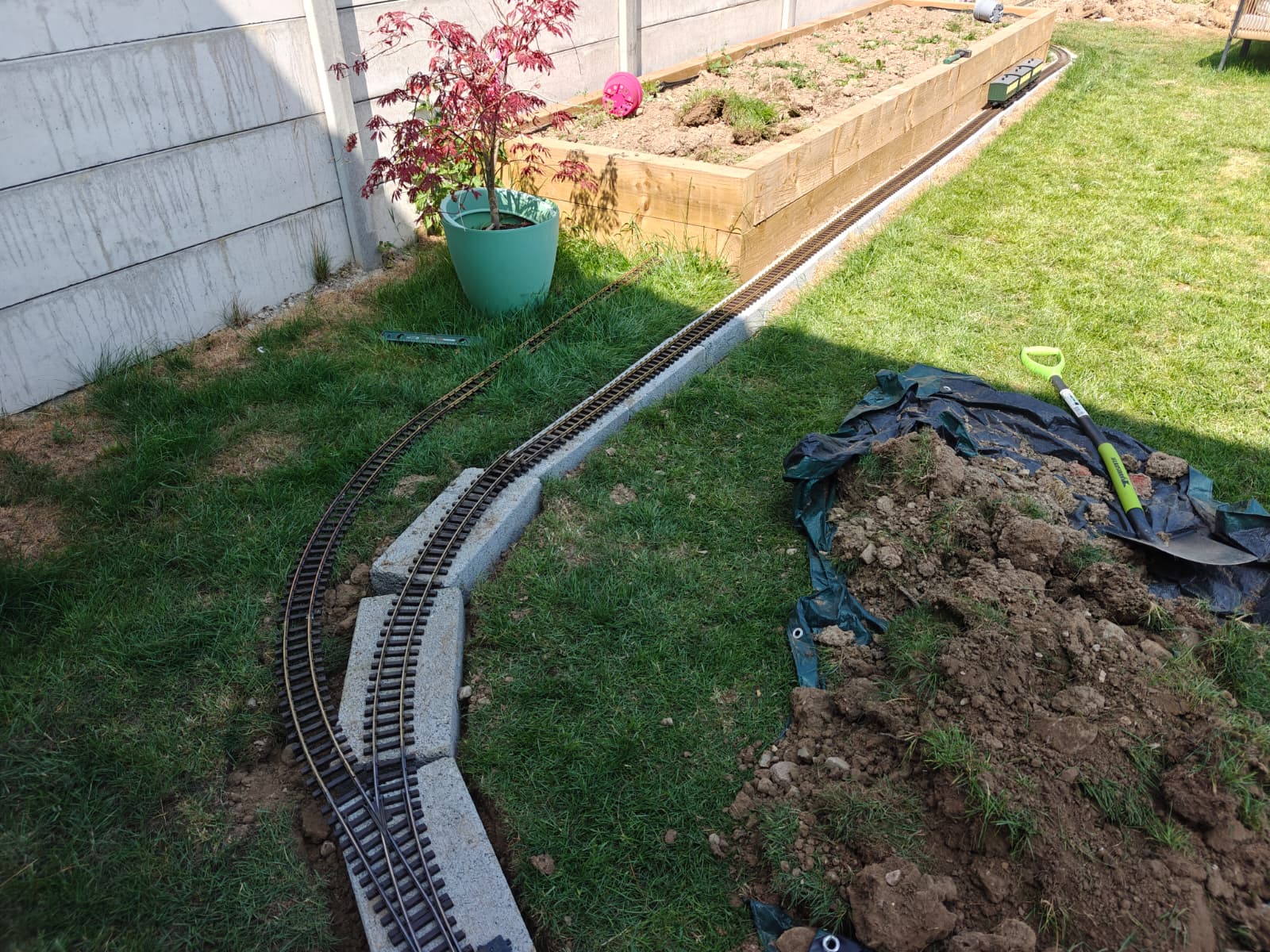

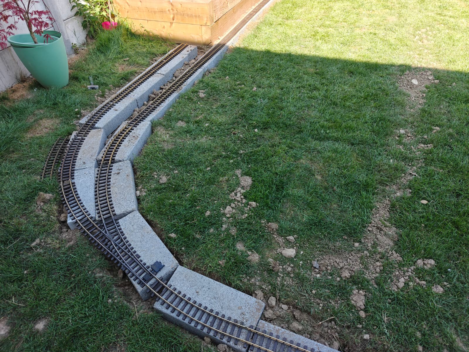

Post by nlc1072 » Wed Jul 22, 2026 6:54 pm
So I did a bit more work, more track bed down now. I'm going to let it sit for a while whilst I watch for subsidence and make sure I am happy with the layout before I concrete it all in.
Some track isn't quite lined up with the track bed, this is because I am awaiting a delivery of more suitable track with the correct geometry. Hopefully this gives more of an idea of where I'm going.
There is a last minute new addition new siding down behind the lavender plants, that will not have the same track bed as the concrete from the fence only a few cm below ground in this location. I will have to suffice with some sort of weed barrier, perhaps the really thick rubber ones.

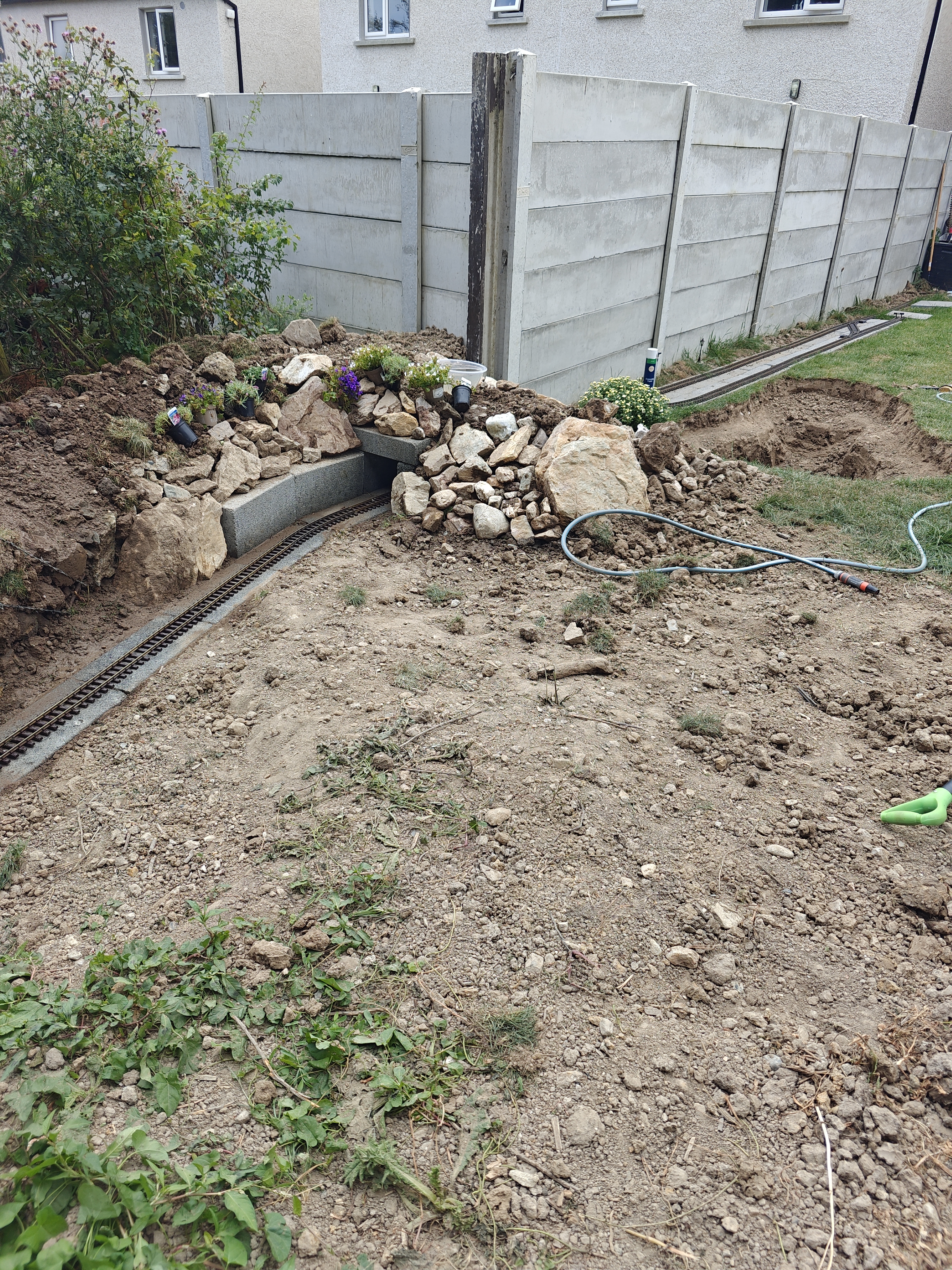

Today's update tunnel is a little more completed, I will cement in the rocks when I am sure of their location. Just throwing rocks and dirt at it with no plan to see what I like.

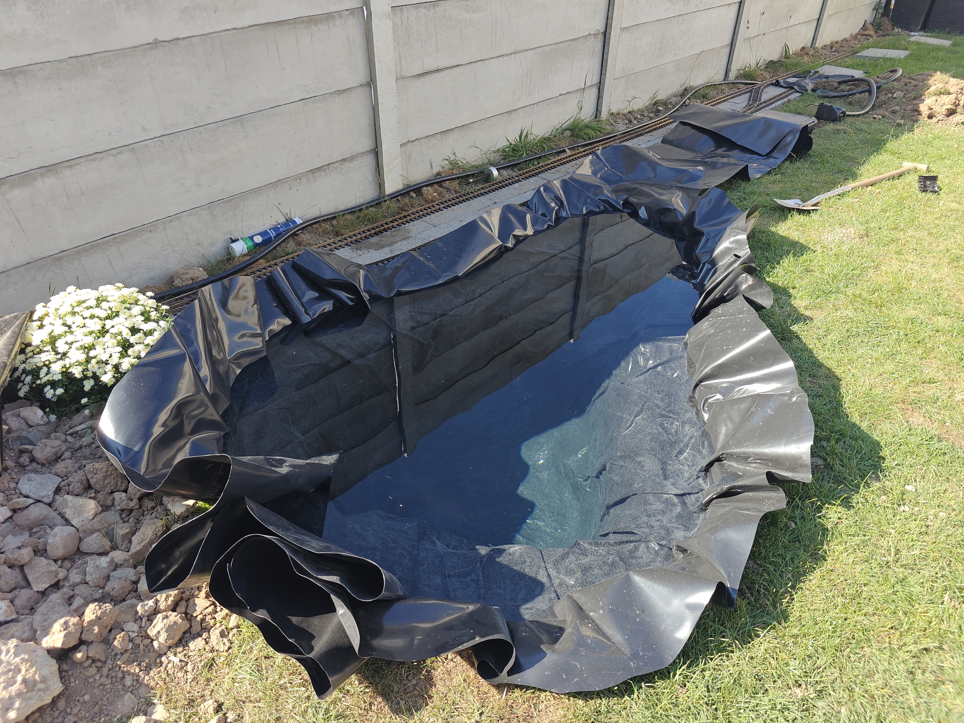

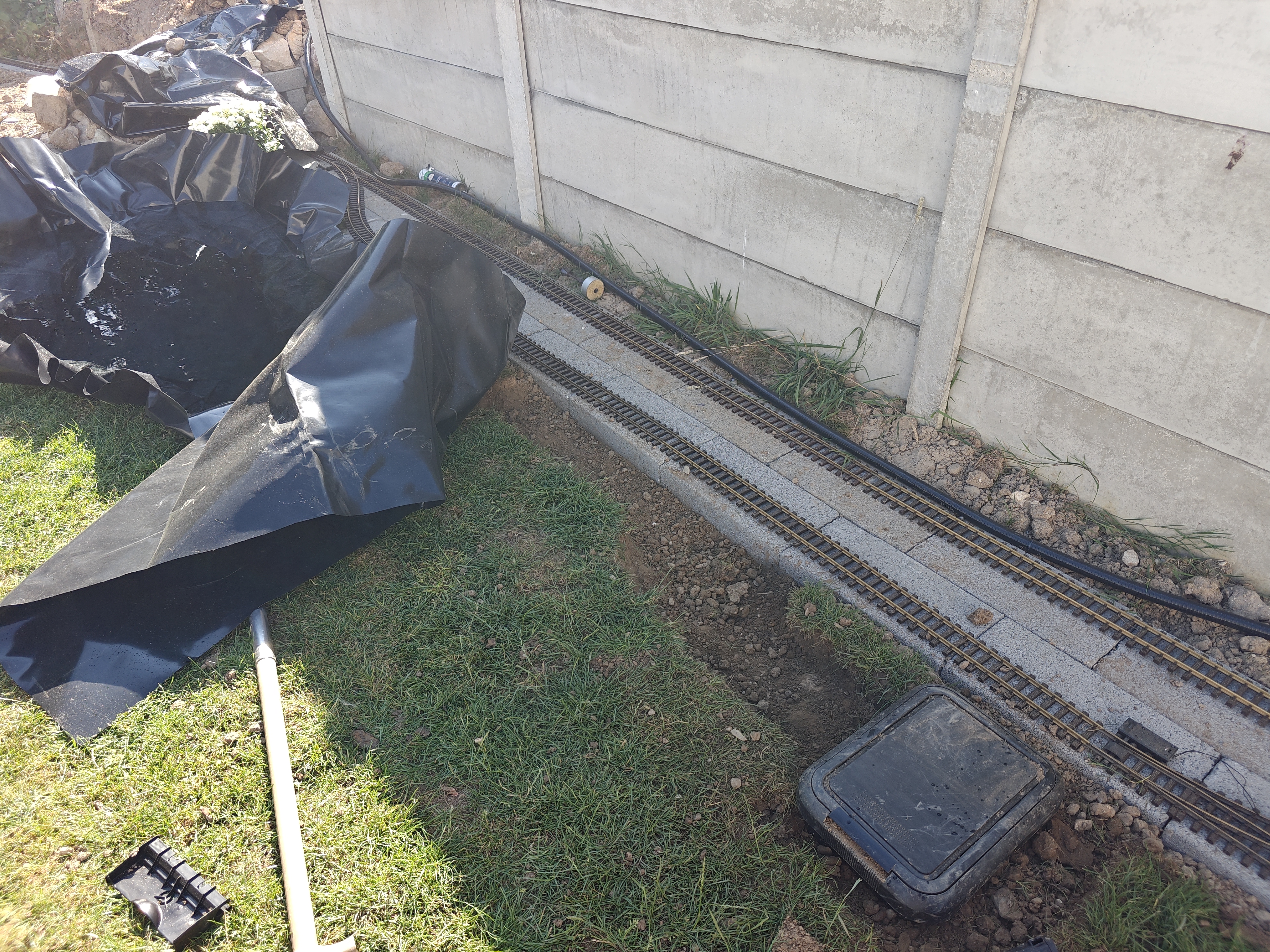

Post by nlc1072 » Mon Jul 27, 2026 2:38 pm

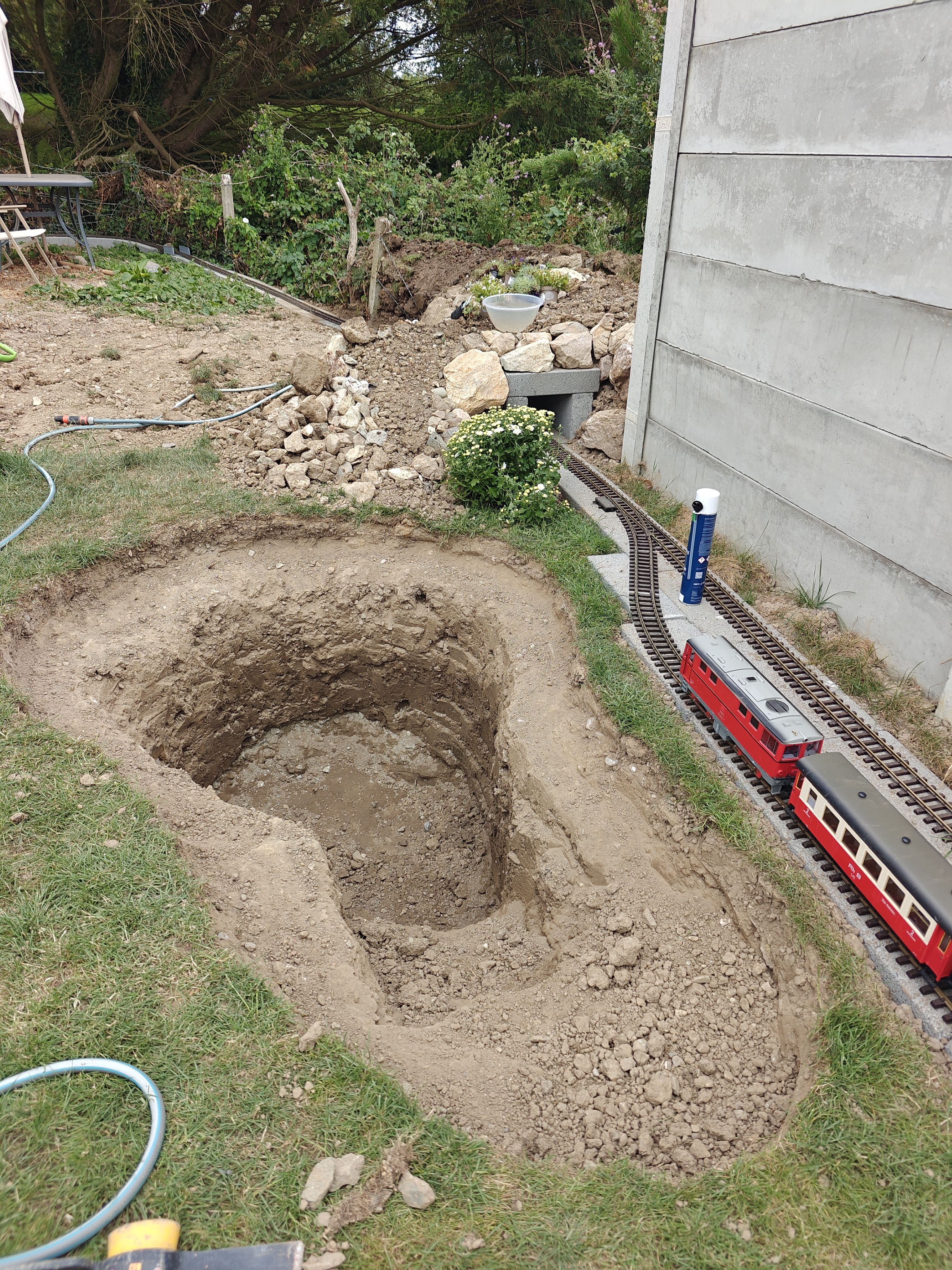

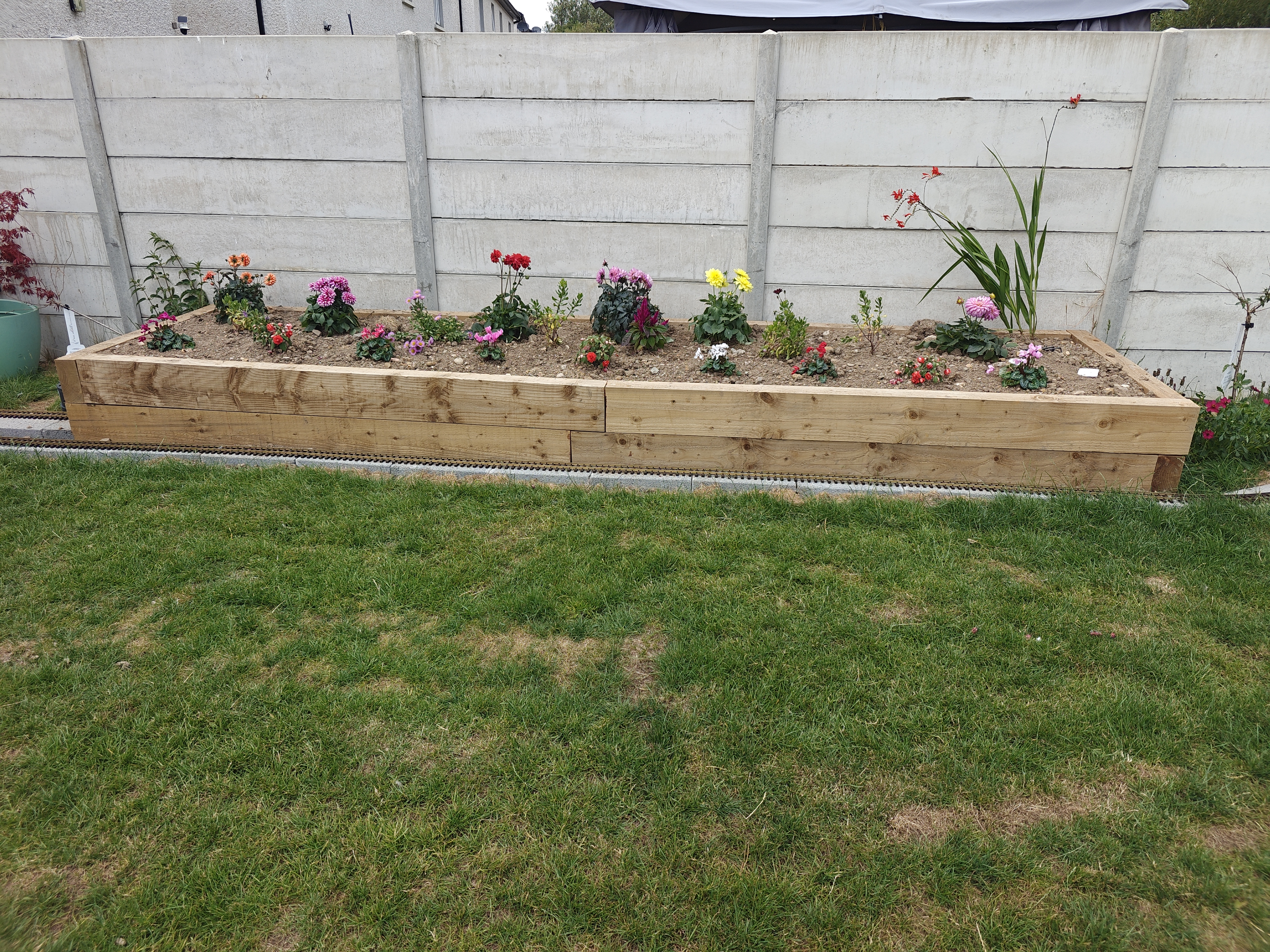

More progress to show, the stream going over the railway has grown into a full fledged pond... As soon as my partner said yes, there was no delay to be afforded.
Some flowers were also planted in the railway sleeper raised flower bed opposite.

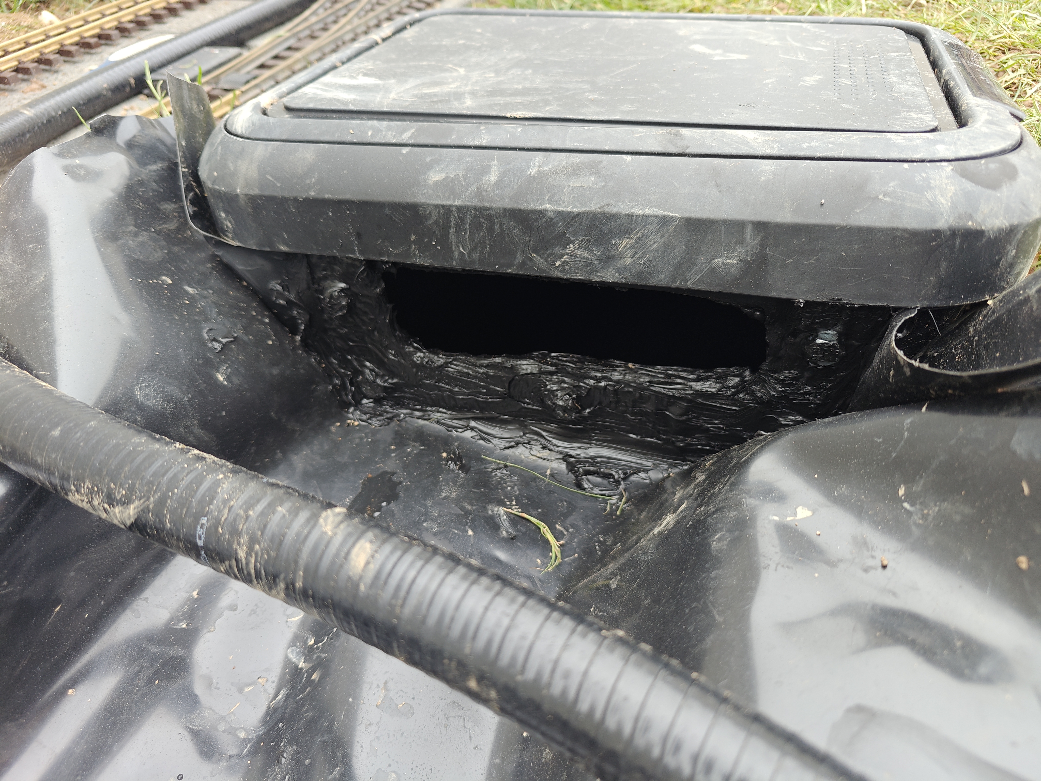

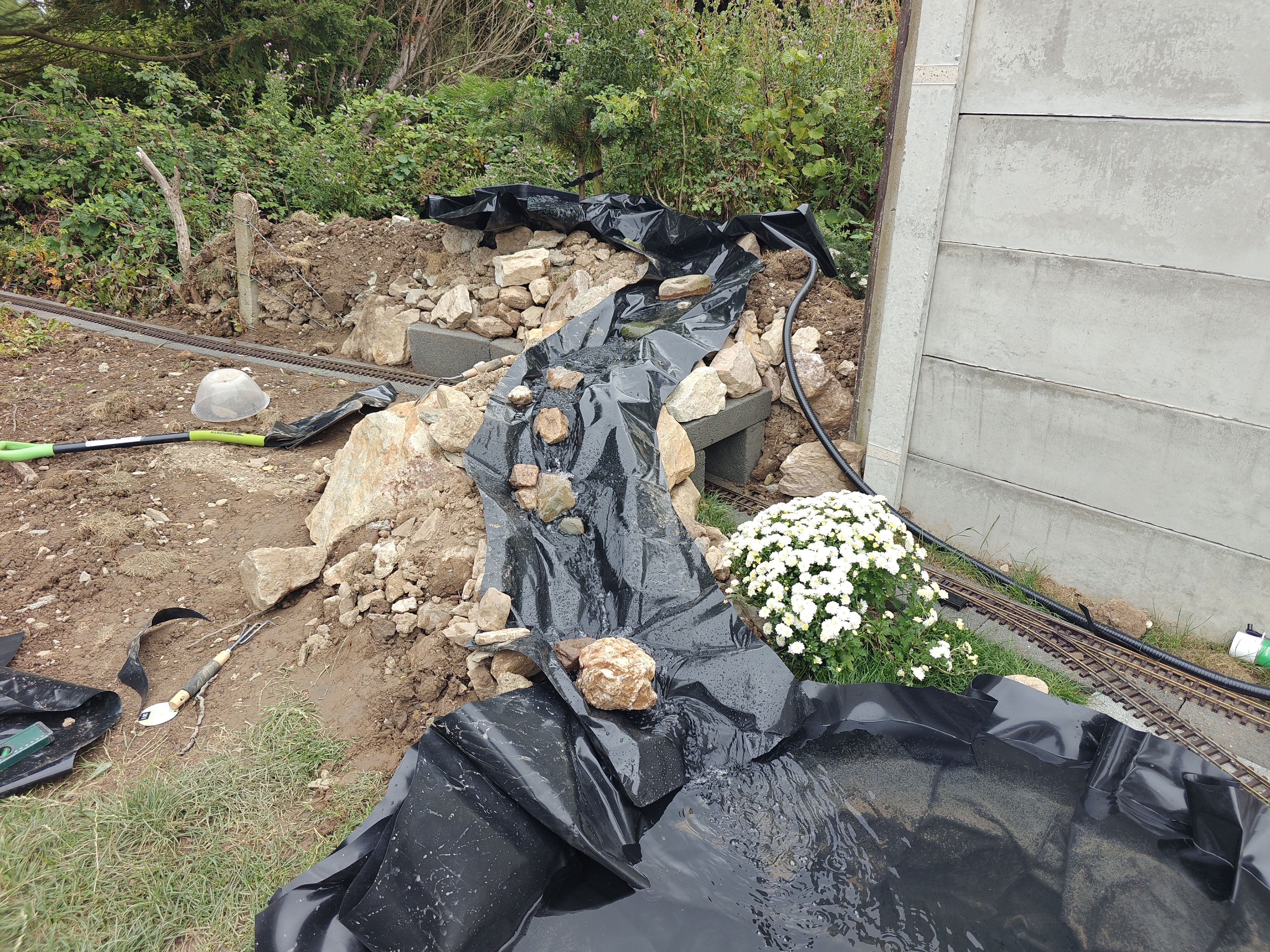

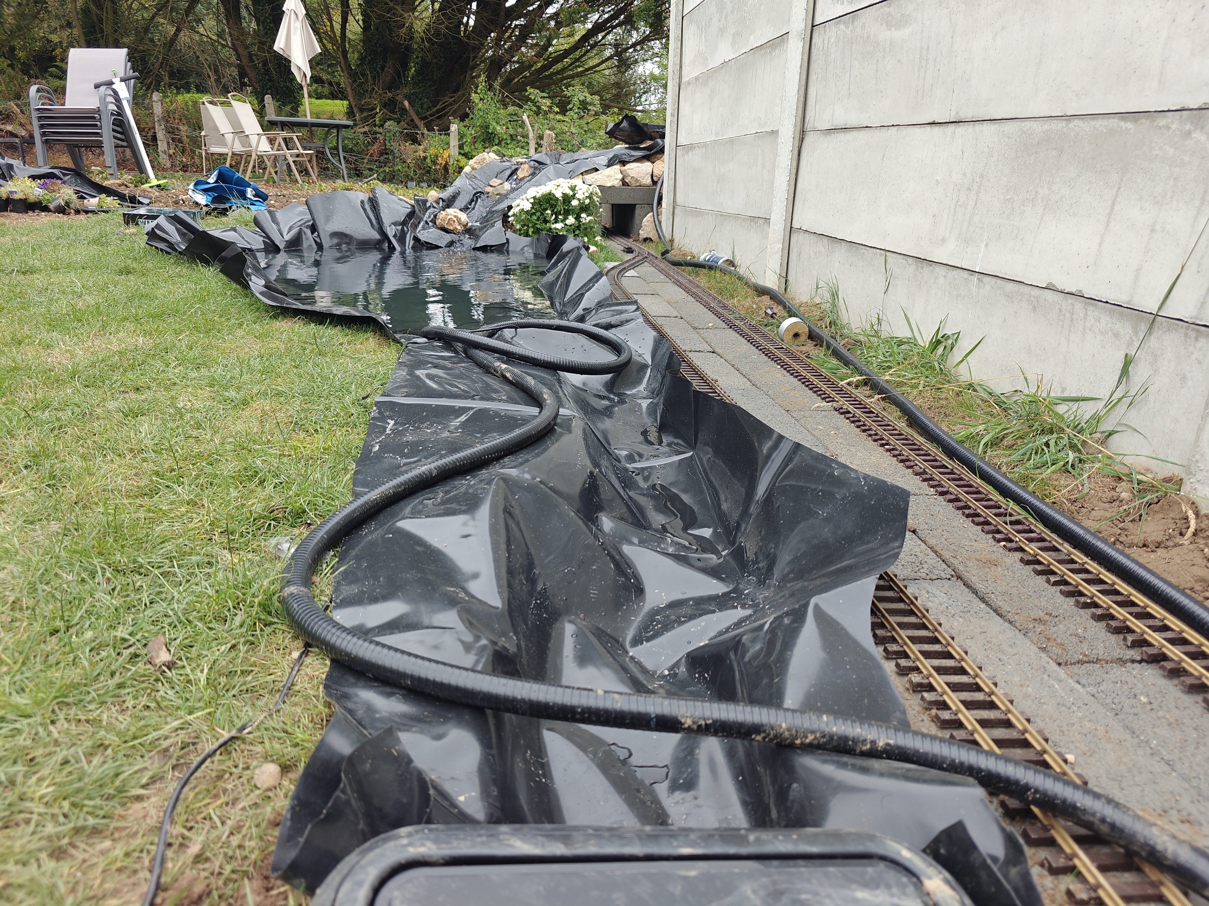

So I saw this video below and as I am making a pond, I thought now would be the time to incorporate a stream as well. So I dug it in...

nlc1072
Posts: 40
Joined: Mon Apr 27, 2026 2:20 pm
Post by nlc1072 » Tue Aug 04, 2026 1:03 pm
philipy wrote: Mon Aug 03, 2026 1:22 pm A stream is an excellent idea, adds so much interest in various ways.
Some years back I built a stream and documented it over a long and rambling thread, but if you haven't seen it already, there may be a few ideas for you:
viewtopic.php?t=12019&hilit=stream
Thank you, I have now read the whole thread end to end and I learned quite a bit, mainly to be careful of concrete cracking!
I have a test of the first half of the stream working whilst I await the silicone to set on the second half. I shall get paving slabs later for the edges this week.
Also I shall source more rocks and pebbles.
GAP
Posts: 887
Post by GAP » Tue Aug 04, 2026 9:50 pm
That look really good
I do like the rocks in the stream it makes it more natural looking mountain stream than a straight trickle of water.
Are you going to plant out the pile of soil it is sitting on so it looks like it comes from a distance away?

nlc1072
Posts: 40
Post by nlc1072 » Wed Aug 05, 2026 3:59 pm
GAP wrote: Tue Aug 04, 2026 9:50 pm That look really good
I will most certainly be planting the rest of the embankment out, still unsure where I am going with it though. I'm just making it up as I go along. I got some more pebbles to go in the stream now, it looks a bit better. I'll get some photos of that later.
