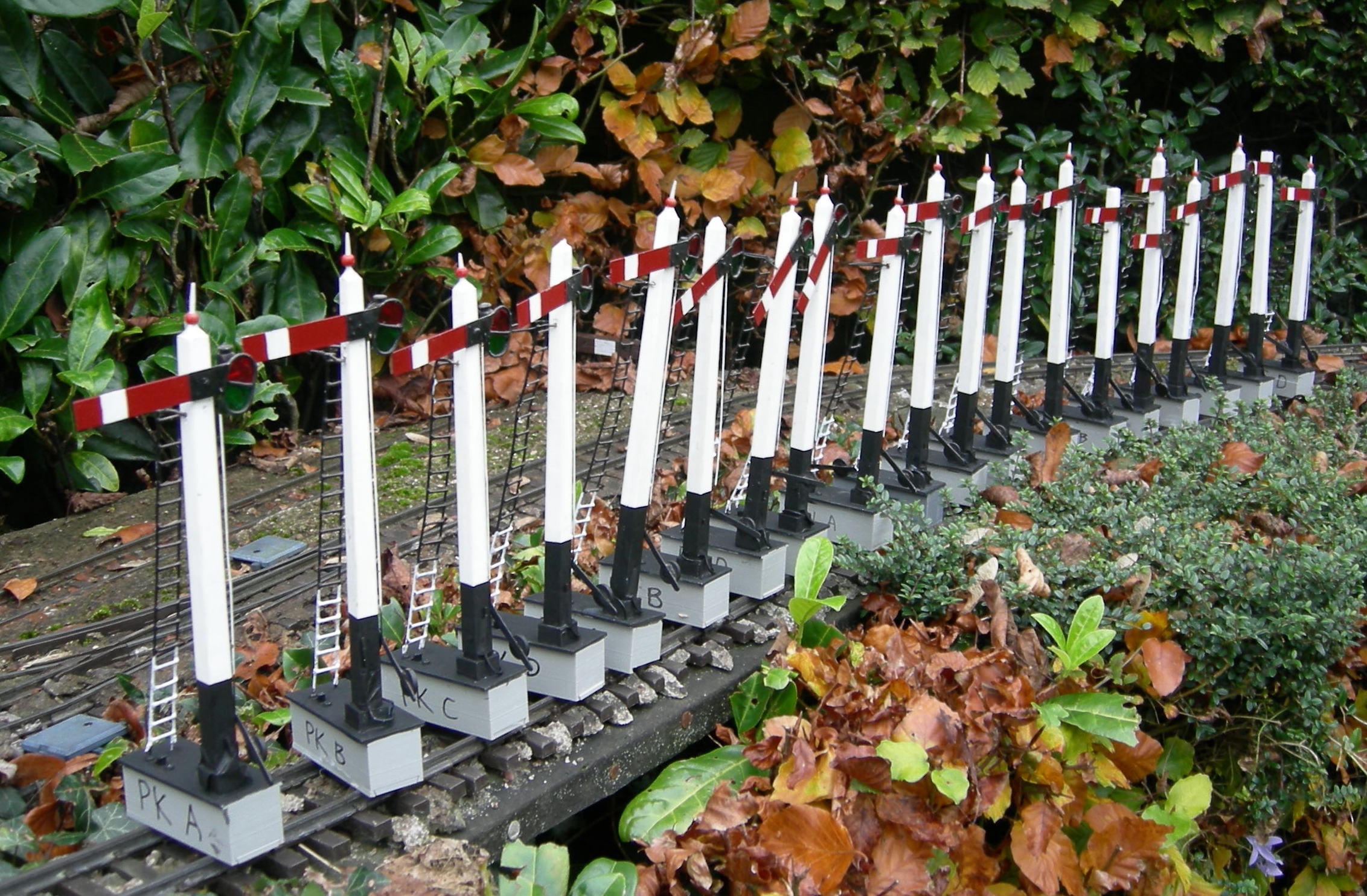

Now finished motorising all 20 signal arms (19 signals). A little bit of fine-tuning still needed to the coding for each signal to compensate for the slight differences in the linkages and then, of course, I've got to dig and line the pits needed for them to be deployed around the railway. That'll be a fun job.... :? :lol:
Re: RC semaphore signalling
Posted: Fri Nov 08, 2024 10:52 pm
by gregh
I pity the poor train driver faced with that lineup of signals. :scratch:
Great work Rik. They look terrific.

gregh wrote: Fri Nov 08, 2024 10:52 pm I pity the poor train driver faced with that lineup of signals. :scratch:

Semaphores are looking good Rik. I love to see the bounce when they go up and down, really gives a sense of weight to them. :thumbup:

Very impressive line up Rik.

Brilliant!

Nice work Rik. More arms there than the Rugby gantry!

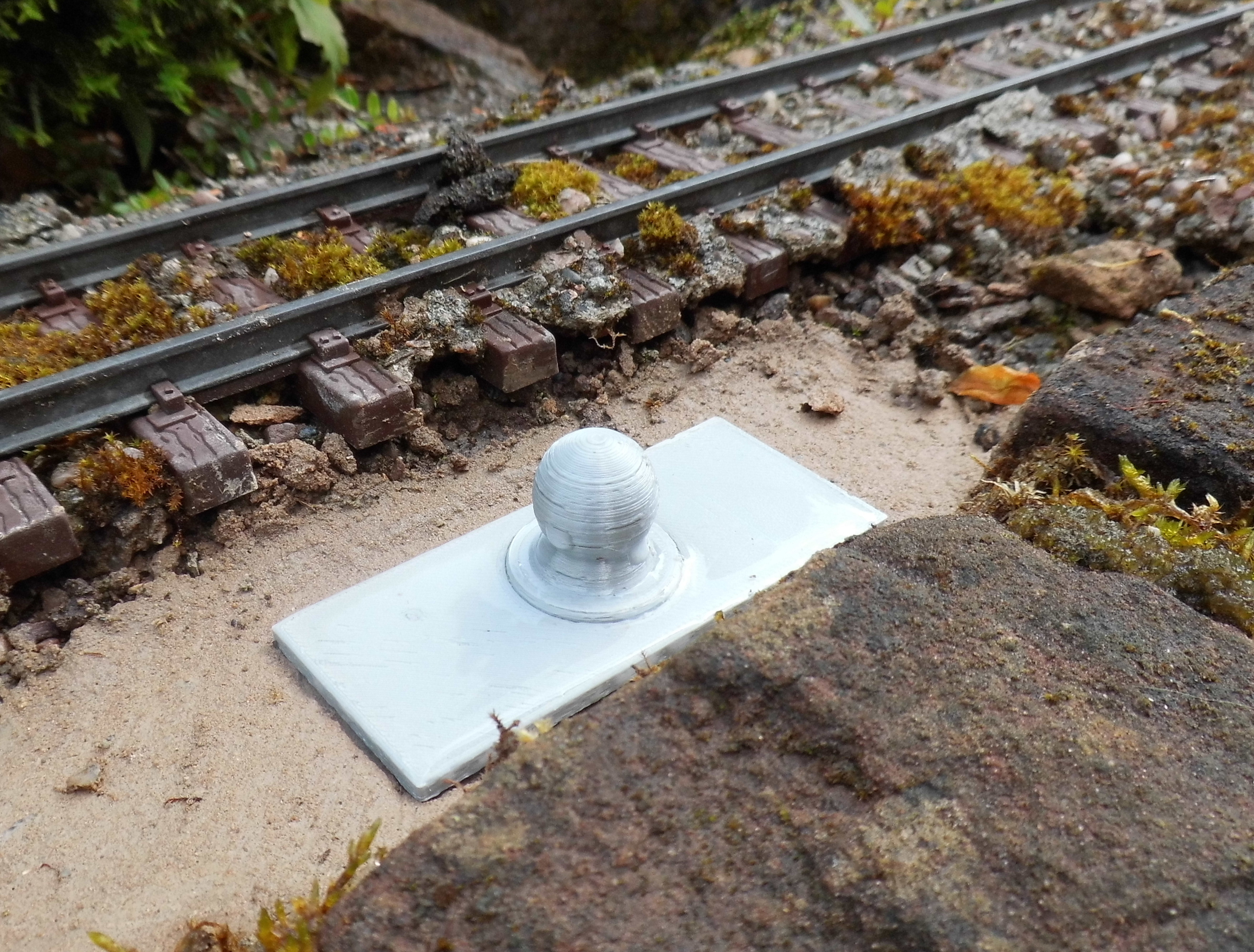

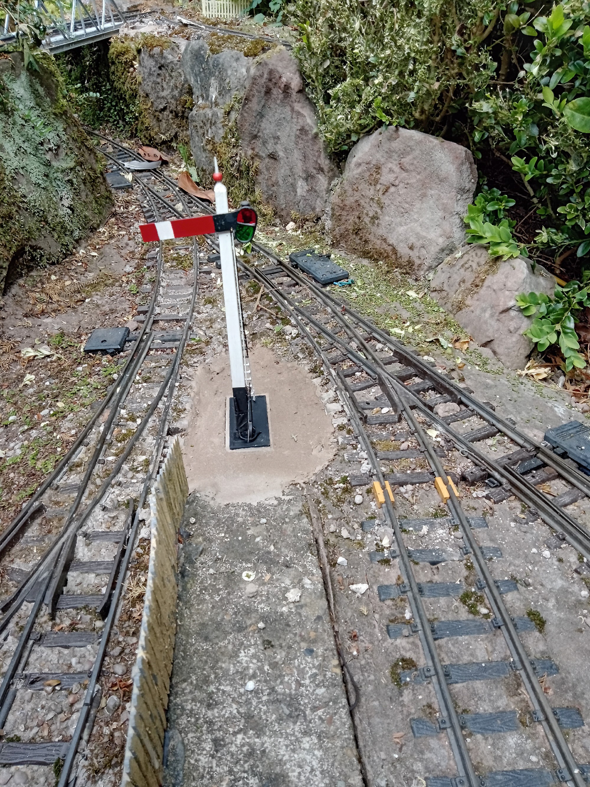

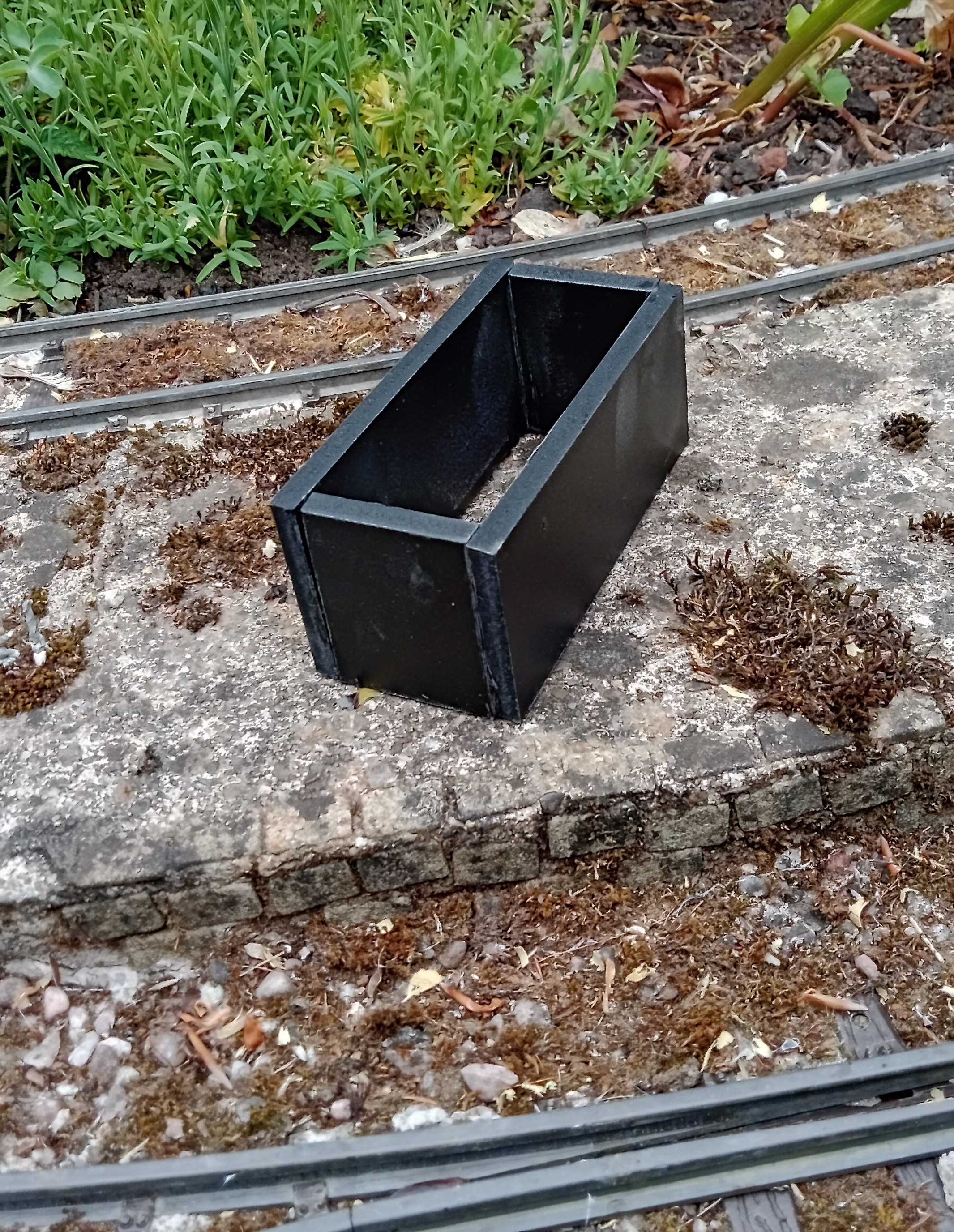

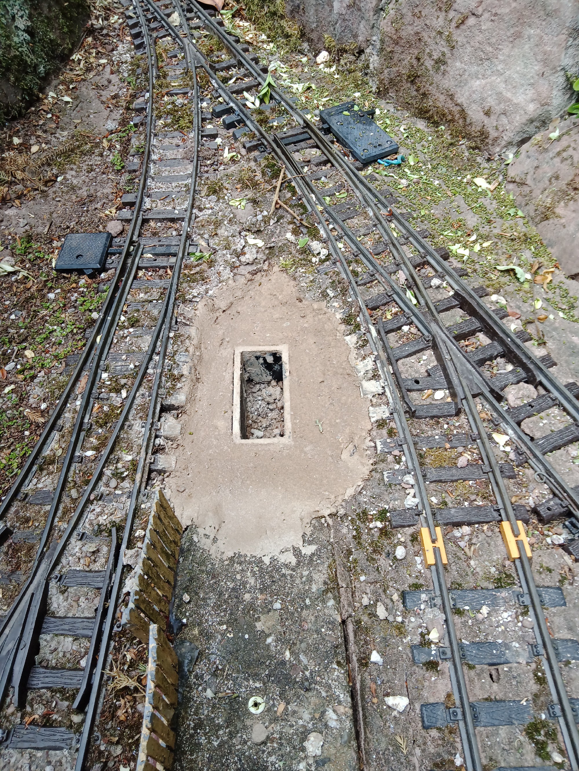

Taken a while, but I've finally gotten around to putting in sockets around the railway for the signals at each station.
The sockets are simply four pieces of foamboard, sprayed black
These have then been concreted in .....
..... so the signals can then be slotted into place.
The sockets will next have ballast and other grot applied to blend them in.
I'm considering making foamboard lids to try and stop debris from filling the sockets when not in use. But I suspect the woodlice will still find their way in.

ge_rik wrote: Mon May 19, 2025 12:04 pm
The sockets look good Rik.
How about a solid block of a rigid foam ( aka electronics packing )? Easy to cut, waterproof and would fill the space and keep the gribblies out.

Posted: Mon May 19, 2025 9:07 pm
philipy wrote: Mon May 19, 2025 12:50 pm
Nice idea, thanks.
Posted: Tue May 20, 2025 8:51 am
by SimonWood

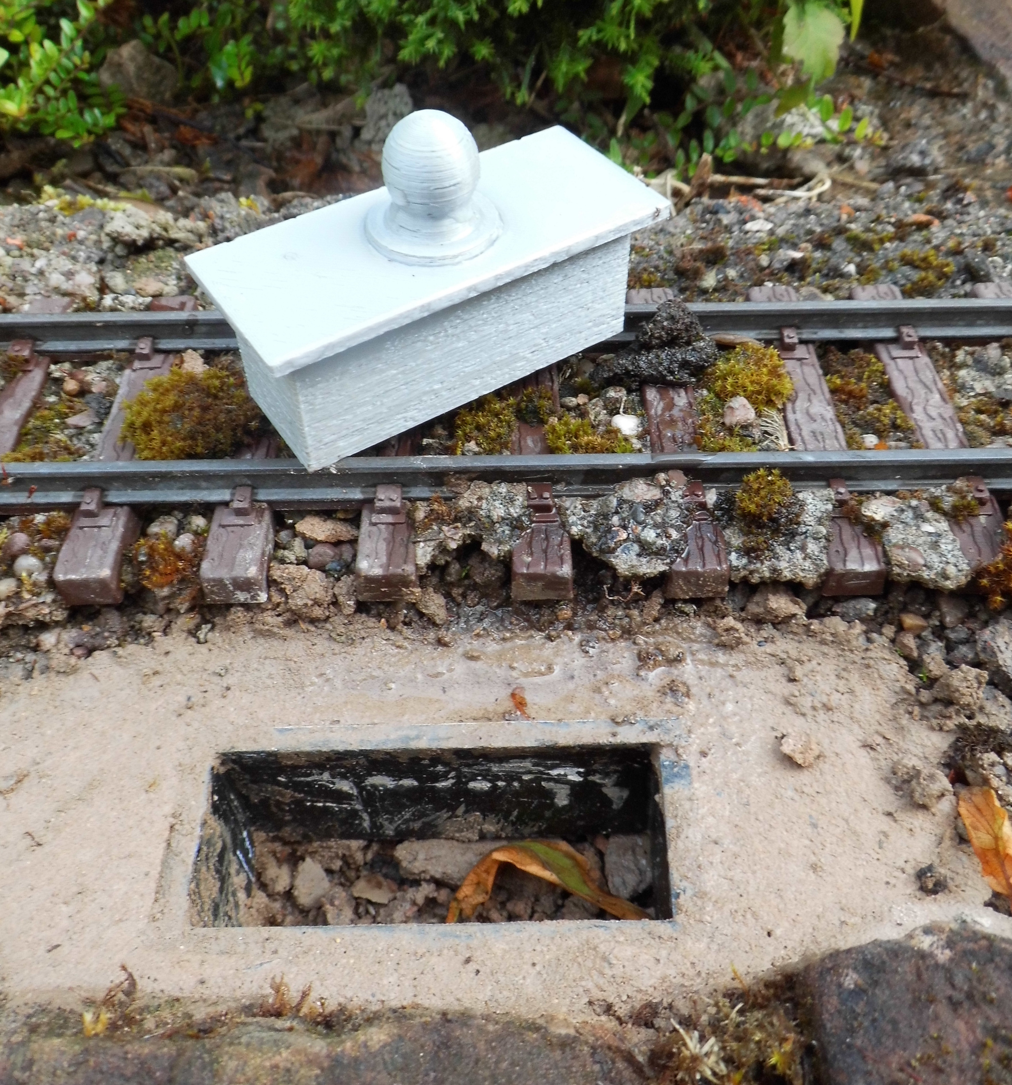

philipy wrote: Mon May 19, 2025 12:50 pm How about a solid block of a rigid foam ( aka electronics packing )? Easy to cut, waterproof and would fill the space and keep the gribblies out.
I was thinking along those lines - but I wondered if you could just print a spare empty gubbins case, perhaps with a little handle to facilitate pulling it out, and just swap it over with the one full of signal+real electronics when you have a running session?

SimonWood wrote: Tue May 20, 2025 8:51 am
Another great idea, thanks
Thanks for the suggestion, Simon. I've now printed out sufficient plugs for all the sockets around the line. Trying to decide if they need painting to make them a bit more weather resistant.
PS - Sorry about the bird poo. I see so much of it on the line I now don't spot it (until I look at closeup photos)
