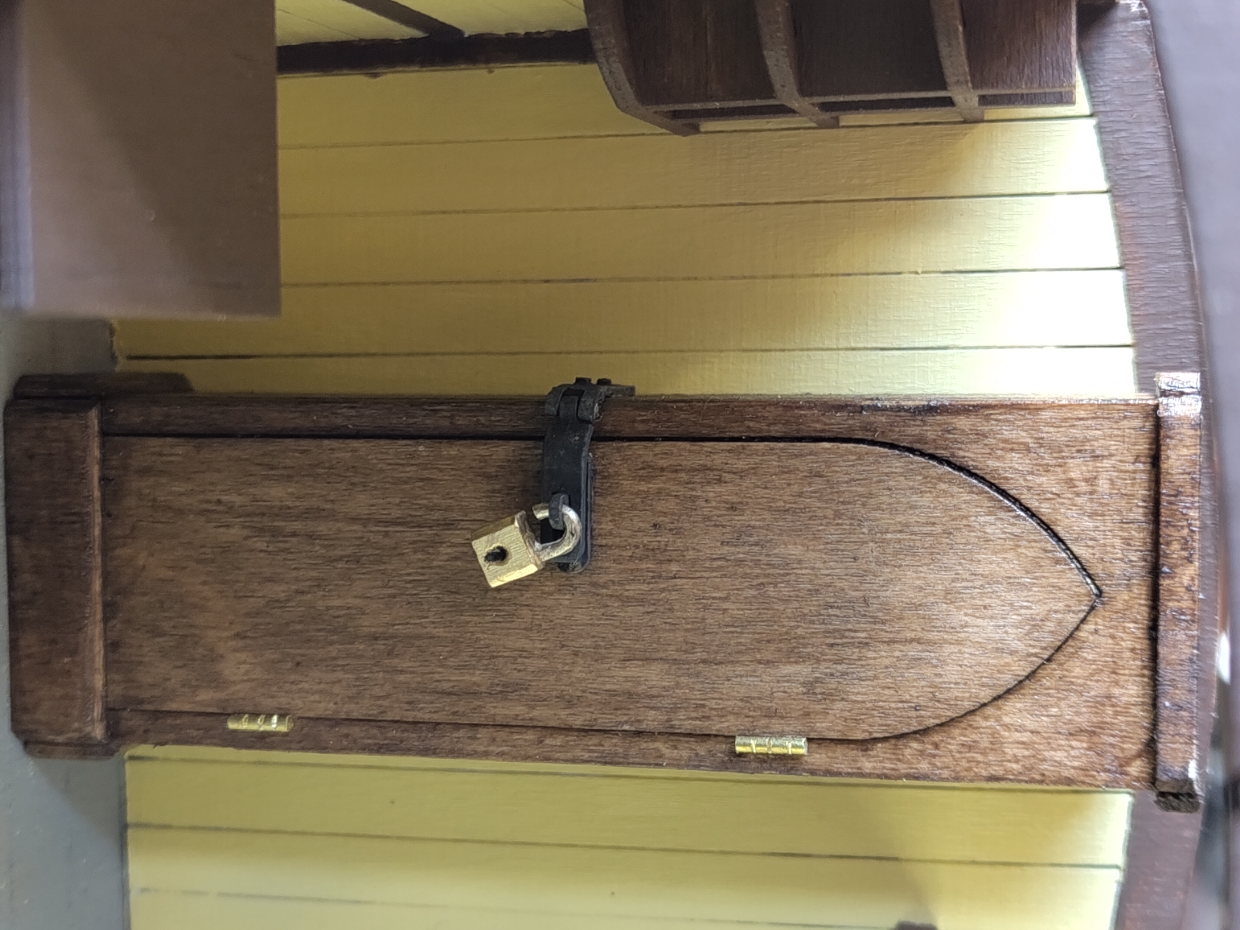

The hinges are very simple. Each half is a strip of thin brass sheet bent around a thin brass rod into a funny "R" shape. The doors and door frames have a pocket cut into them that the bent out leg of the R shape fits into. The lower hinge piece has a piece of brass rod soldered in.
I made a batch up and paired together the most similar halves.
These are then glued to the door and then the door and hinges glued to the frame with epoxy being very careful not to get any in the hinge.
Hopefully this close up goes someway to showing them. I think inspiration came from a Colin Bonnie droodle.

Still going on the brake composite. Thought I'd share the internal detail in the guard's compartment.
I needed a way of hiding a Lego pneumatic air pump. I use these so that the air brakes can be taken off even if a loco has no means of generating air. So, a tall cabinet was needed. Taking inspiration from real events on the Mid Suffolk Light Railway, the story goes:
Fed up with a certain driver poaching from the footplate, the board made the decision to amend the rule book to prevent the conveying of firearms unless in a locked cabinet.
So, a gun cabinet, I suppose this makes this carriage a shooting brake...

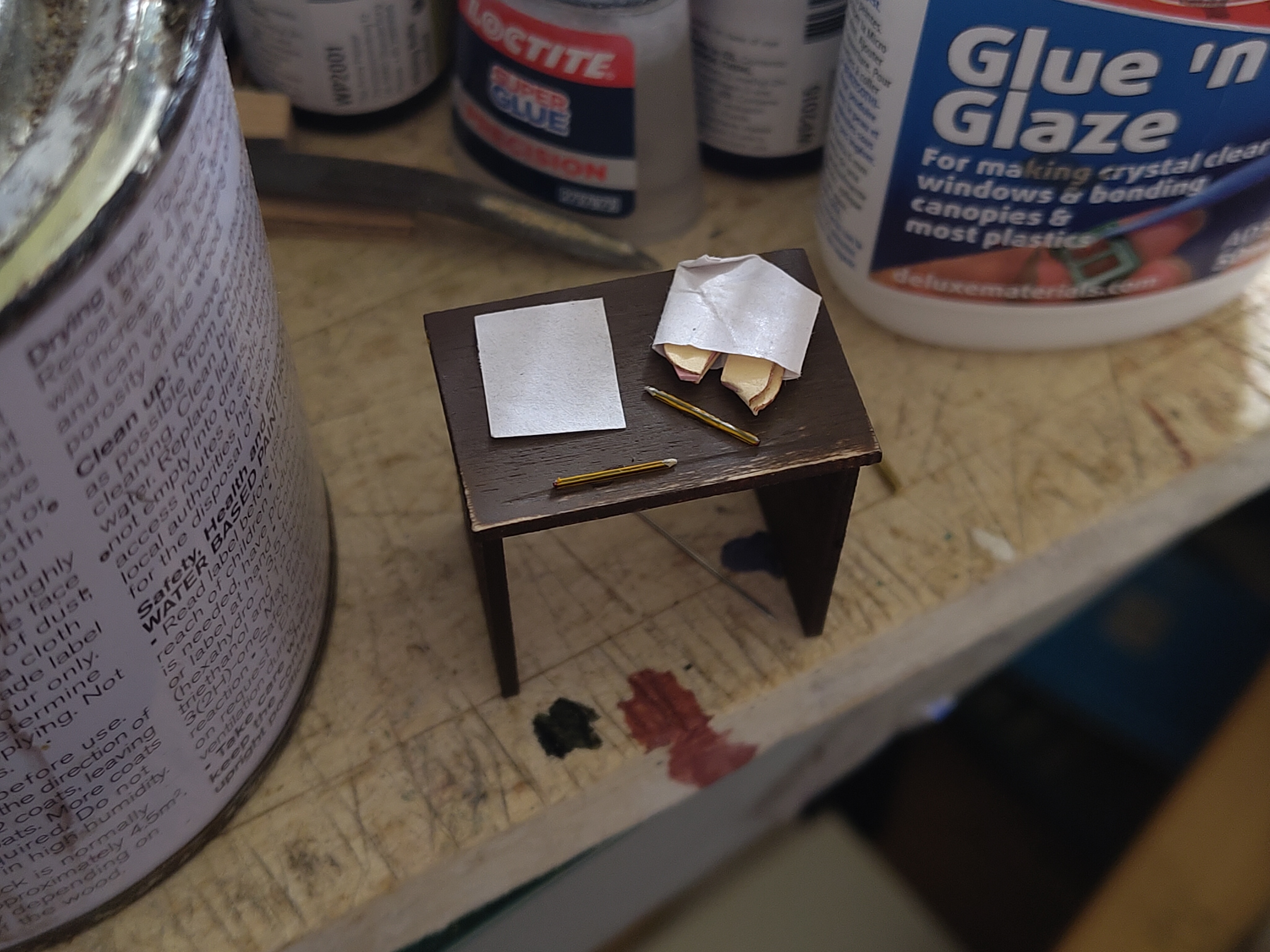

Thanks all, this is the sort of modelling I get a lot of pleasure from and, fortunately, it doesn't cost avery much at all making bits from scrap. Standard issue ham sandwhich - just bits of card glued together!
The pencils, I couldn't resist really. They are 0.5mm mechanical pencil lead dipped in yellow acrylic paint. The paint was scraped back with a craft knife to give the black stripes. Once dry it was snapped into suitable lengths, sharpened and then the sharp end was dipped in cream acrylic. Once dry this is rubbed back at the tip to give a working 16mm scale pencil. [attachment=0]IMG_20260411_150629.jpg[/attachment]
They don't bear up that well under very close scrutiny but the look convincing from a normal viewing distance.

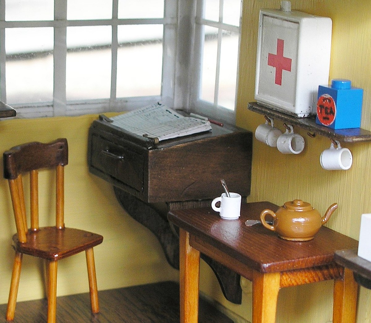

Dr. Bond of the DVLR wrote: Sun Apr 12, 2026 5:11 pm it doesn't cost very much at all making bits from scrap.
Couldn't agree more, it's the excuse I tell myself for the state of my workbench. I keep all sorts of off cuts of every thing, you never know what you might need for some detail item.
New Signal Box 9.JPG (270.51 KiB) Viewed 6169 times
I put pencils on the desk in my signal box, but didn't go to anywhere near the extent that you've gone to.

Grant: That signal box interior is spectacular. I like the hold down clips for the train register on the desk.
I've been thinking I need to make a tea cup - did you make the ones shown, if so could you share how you did it?

PS. sorry forgot about the cups, styrene tube cut to length, appropriate hole punch provided styrene ends and a bent piece of wire supa glued into place for a handle. Painted in thick white enamel.
