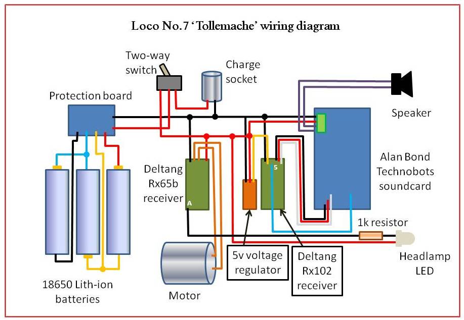

I've received my sound modules and tried programming P3 to servo on my MR603a. There's nothing written on any of the chips so I assume it's one of the first batch of Rxs which Andy released.
I've programmed the Rx to provide servo output on P3 following Ch1. However, I can't get the sound module to respond to the servo output on P3. In fact, if I connect both the motor and the sound module to the Rx, the motor ceases to respond as well. However, if I connect the just the motor to the Rx, then it works ok.
I remember having a similar problem with a Deltang Rx65. In that case, I could get servo output on one of the pads and it controlled the soundcard ok. But as soon as I connected the motor, the servo output stopped working. I solved the problem by installing both an Rx65 and an Rx102 in the loco, both bound to the same tx, with the Rx65 controlling the motor and the Rx 102 controlling the soundcard.
Tollemache wiring(1).jpg (63.59 KiB) Viewed 30325 times
That loco, #7, still has that installation and is still working well after nine years - https://riksrailway.blogspot.com/2015/1 ... e.html?m=1
Now, it might be that later versions of the MR603 can be programmed ok for servo output on a pad and will work with a motor attached, but if not, using a separate Rx for controlling the soundcard is a viable workaround.
