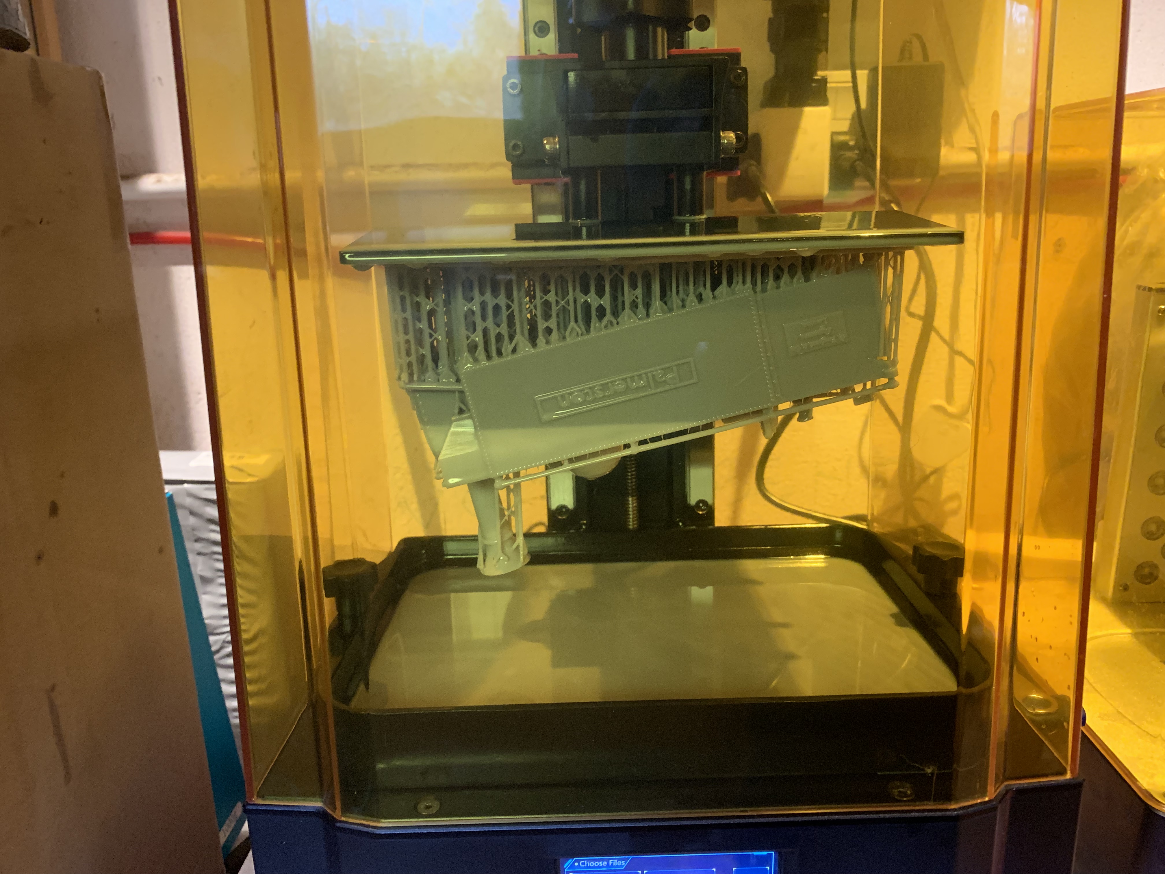

There have been a couple of updates to Anycubic's slicing software since I started building this locomotive - and I had another go at slicing the whole body as one piece - tanks, firebox and smokebox all in one part. This time it worked.
So I have placed the component on the bed at as much of an angle as I could. I tried to keep the "cab" sides as close to the bed as I could, and I used medium supports.
Well it worked! Here it is as it finishes printing:
That took 10 hours to print, and used quite a bit of resin. There are a couple of faults - but nothing that cant be repaired when it is fully cured. It has been washed - it only just fits into the tank, but it has yet to be cured properly. With the smaller printer I have got into the habit of curing things while they are still on the bed, but in this case it won't fit into the tank at all. So it was a rather messy business getting the whole thing free from the bed plate.
It is now drying before it is cured. I have noted that the resin is very flexible at this stage, and I have started to carefully remove some of the supports, the ones holding the detail in particular. As long as I can avoid breaking off the delicate bits it looks like a really good print. Apart from a slice missing from one side of the "cab" side, and a bit on the balance pipe which will need repairing:

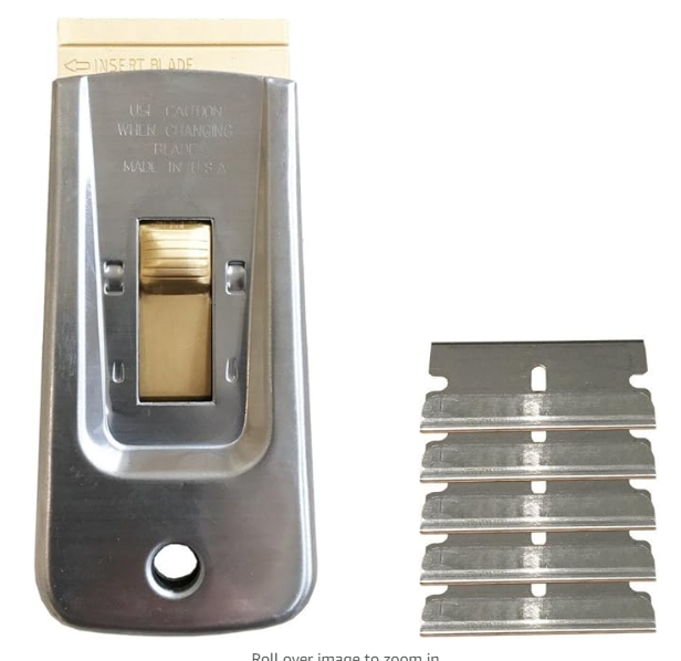

by -steves-
I use one of these, works a treat every time.
https://www.amazon.co.uk/Blake-Bull-Scr ... 2b2ec0f142
Re: Palmerston - Small England Loco as built
Posted: Sat Dec 09, 2023 10:06 am
Yes, I got one of those when you mentioned it before, Steve, and it is useful but I find I tend to scratch the ali bed with it.

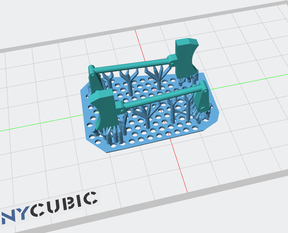

I've just noticed on your two pics above that the surface of the print raft appears to have a dimpled top, not just from the support connections. Is there a particular reason and how do you do it, I haven't noticed it in Chitubox options/settings?
The raft has a matrix of holes in it. It seems to be the standard raft in the latest version of Anycubic's slicing software. You can see it here:
Screenshot 2023-12-09 at 19.08.13.png (86.73 KiB) Viewed 38419 times
It does help to get the raft off the bed - as well as saving a small amount of resin.

Trevor Thompson wrote: Sat Dec 09, 2023 7:10 pm
Ahh, that probably explains it then, I use Chitubox not Anycubic, although I thought Steve also used Chitubox?
I have and use Chitubox, NovaMaker and Anycubic depending on which machine and what I need from it at the time. I too have not noticed the holes in the Anycubic slicer, I will have to have a look. :thumbup:
EDIT:
Oh yeah, so it does. Cool :D

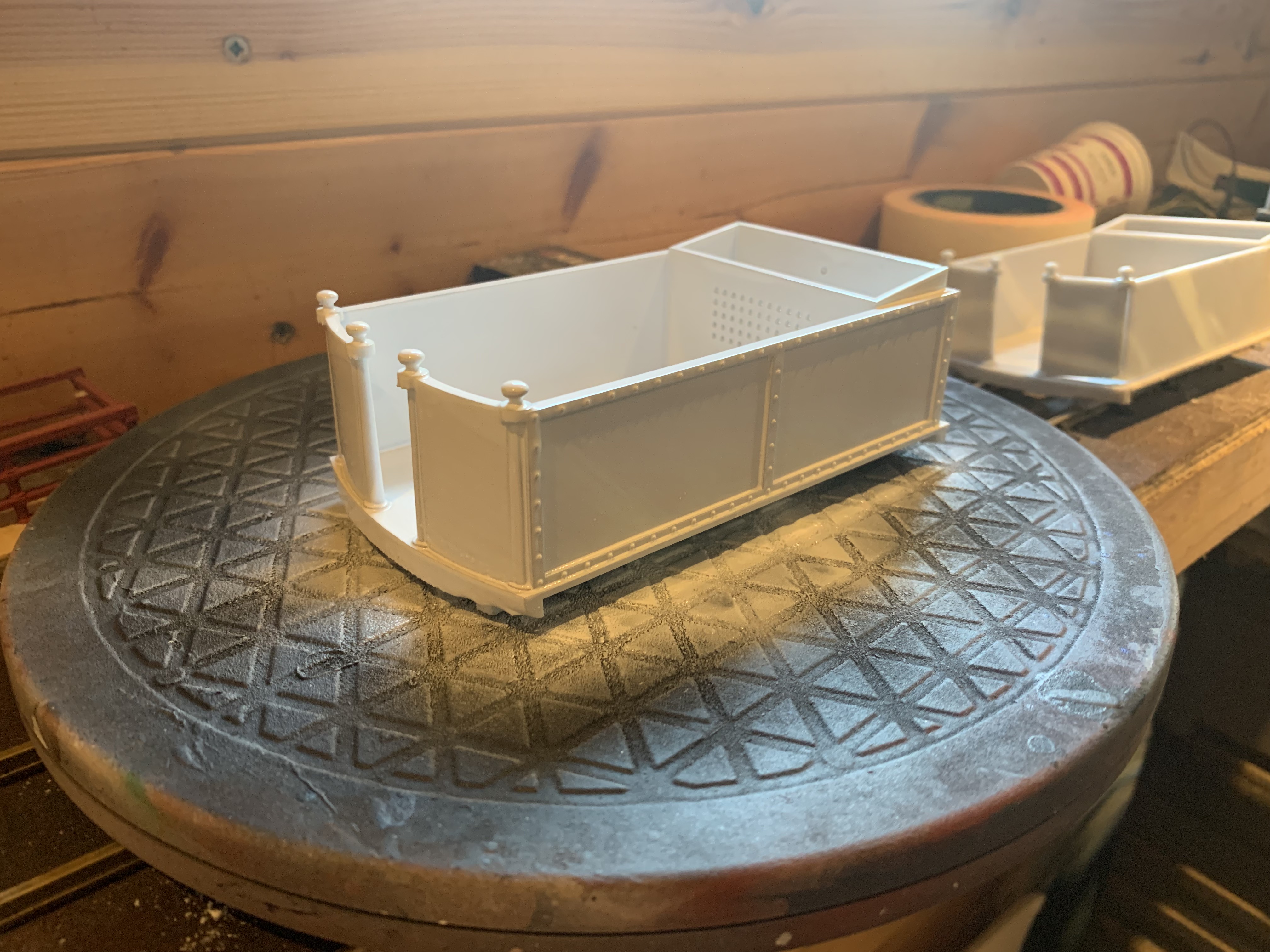

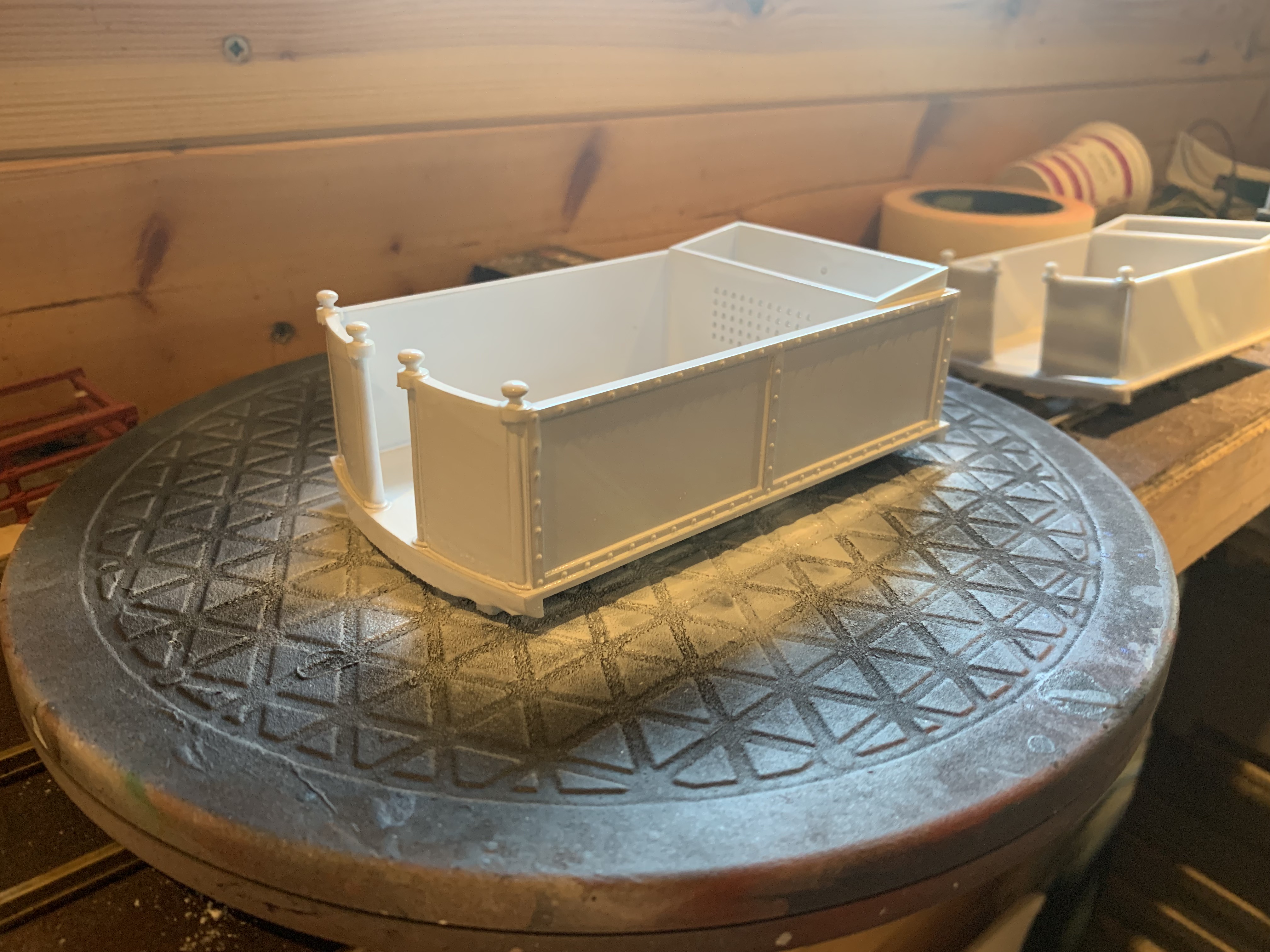

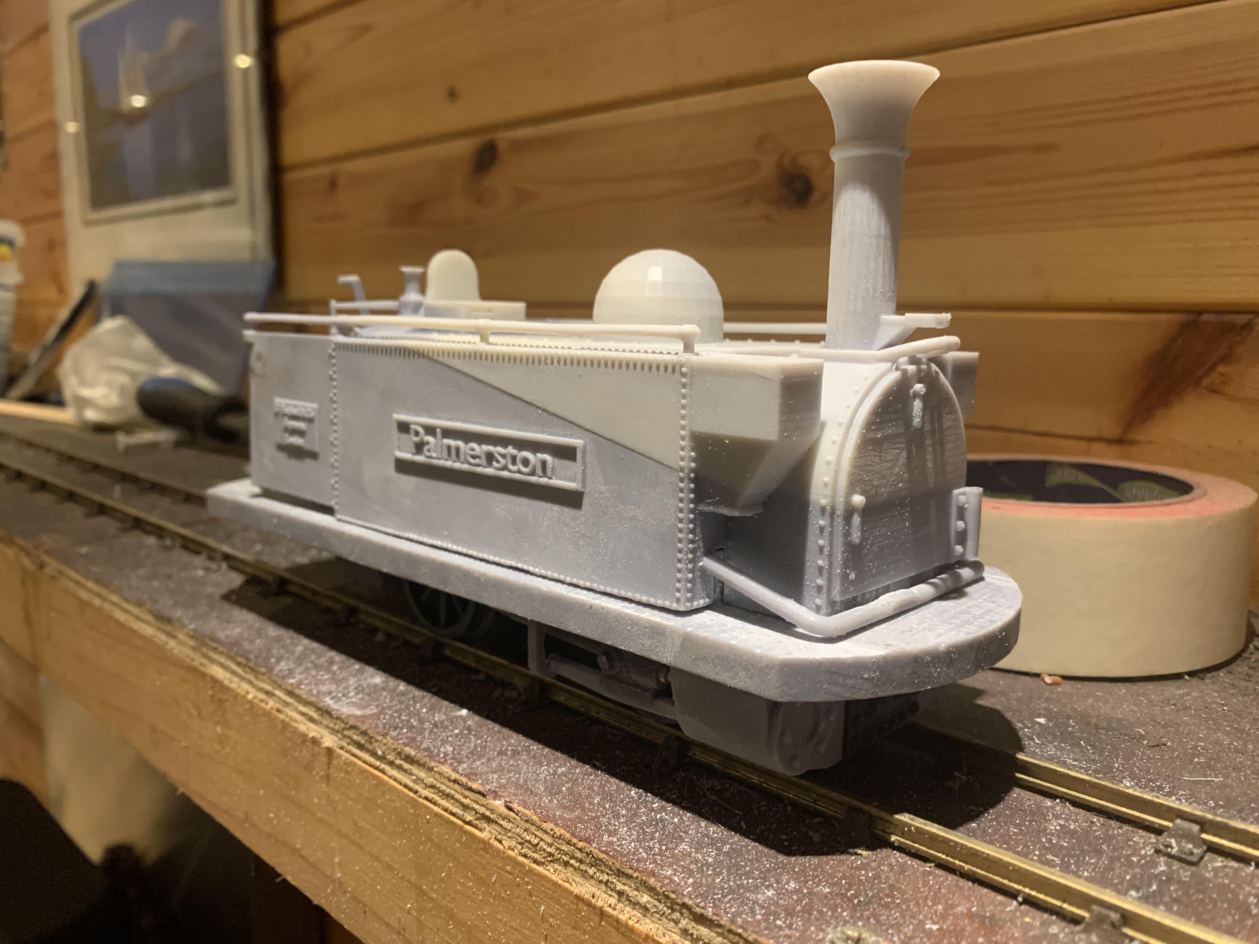

Building this locomotive has helped me to understand better how to achieve good results with this large resin printer. As part of this I have been altering the support settings in the slicing software, to see what gets the best results for the sort of model I want to print. So far I have settled on "Medium" supports, and adjusted the distance between the supports to 4mm, and the angle of the support ends to 45 degrees. I am currently using a 1mm diameter "ball" end with a 0.5mm "break point' 1mm from the model.

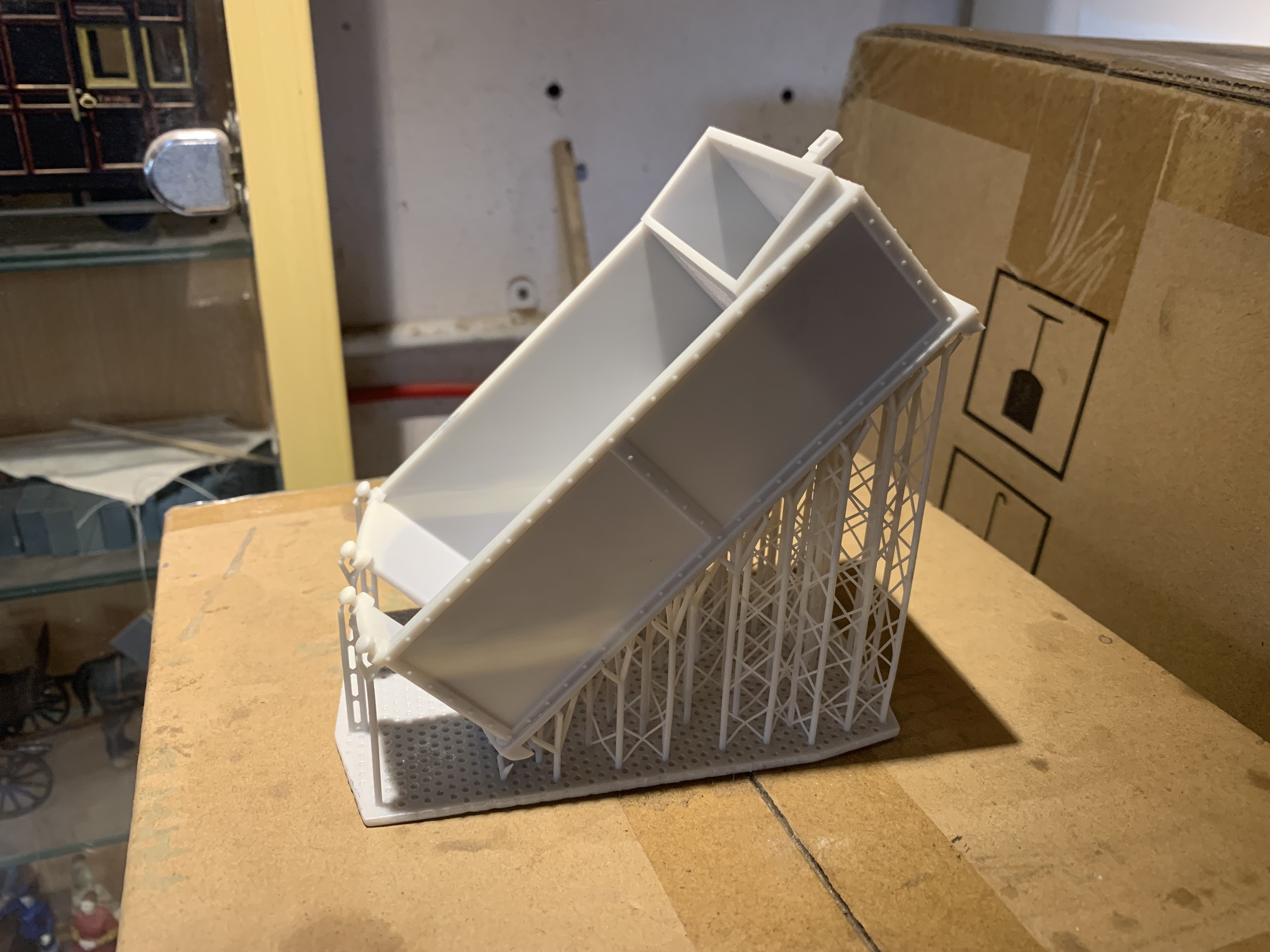

The latest component is the tender, as printed:
Note that the supports above seem more than 4mm apart - which is because the ends of the supports you can see branch out, and the 4mm is the distance between the branches. You can see that the support on the bottom corner has come free and that the end of the front buffer beam is distorted.
I manually added and deleted support "anchors" in certain places. All the supports which passed up at the side of the locomotive body and the tender were removed. They seem to get attached to the side of the model and are impossible to remove cleanly. Those supports are mainly attached to the ends of rivets - and it seems to work without them. Some of the supports attached to the handrail on top of the tanks on the loco body went down to the raft and some to the top of the tank. All of those going to the raft were removed for the same reason. Those to the top of the tank were left. The software treats short supports differently and I have tried different settings, settling on supports less than 2mm long being 3mm long and 60 % of the normal sizes, which seems to cover those supports.
The area of the model which seems to suffer distortion is the area closest to the bed - the first part to be printed. I have been manually adding lots of support around these areas. The front buffer beam on the tender and the footplate side screens, for example.
The tender with its supports removed and primed:

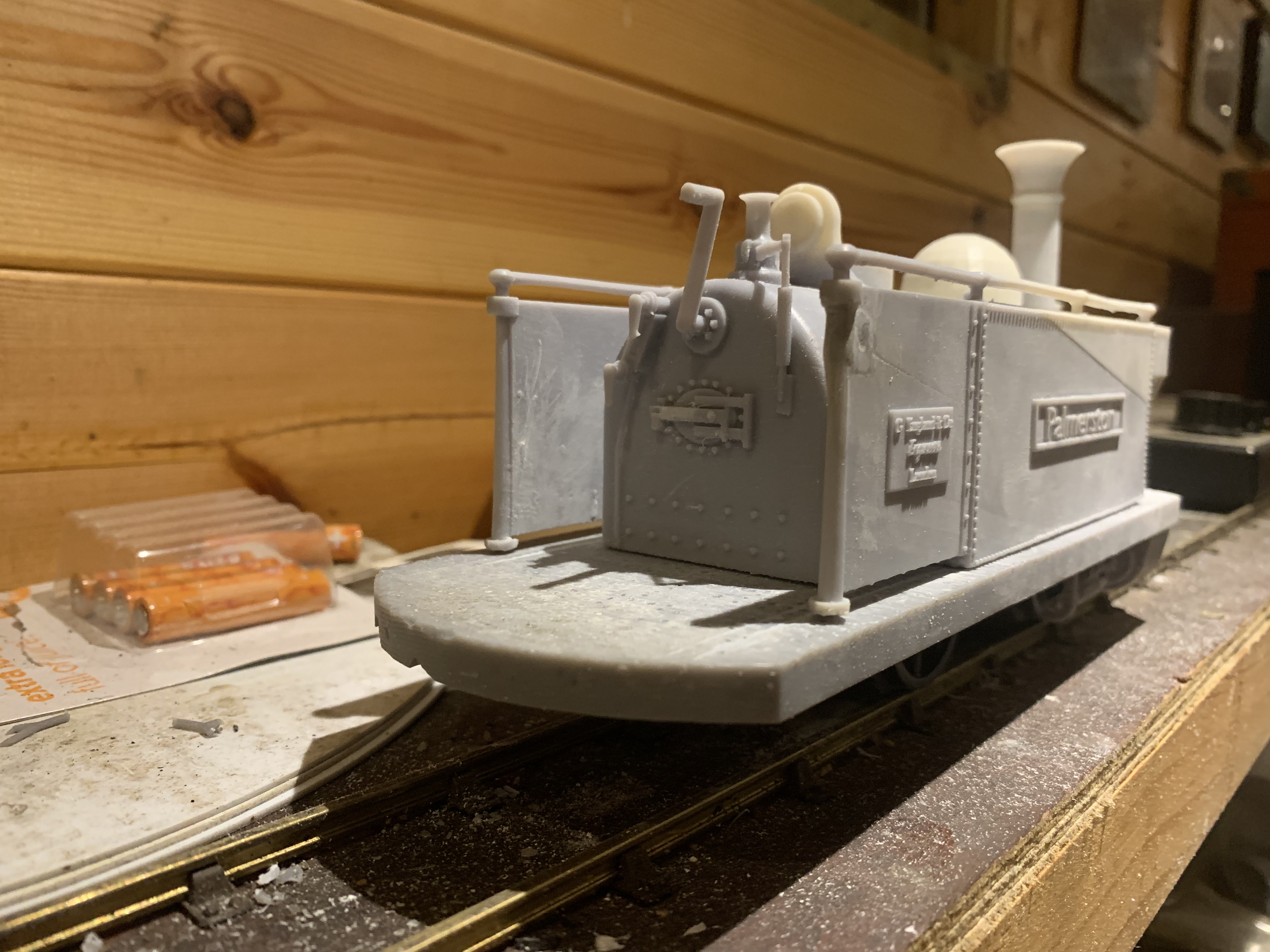

The print I made of the footplate has dome shaped depressions in it where the ends of the supports have been ripped out. Some filling and sanding required here. The bottom of the tender which has the balls and break points does not. In this case the remains of the ball are left in place with 1mm of the ball sticking out. Easily filed or sanded away. Much easier to deal with than a hole!
I am currently painting the body. The sidescreen repair seems to have been totally successful and I am working on the ridge on the tank sides. Whether I will be able to hide it remains to be seen. I have repaired and re-sliced the body in case I need to reprint it. I haven't decided how to treat the sidescreen rear stanchions which don't actually touch the footplate. I can decide how to treat that it the tank sides look OK.
In the background of the last photo you can see the first attempt at the tender. There were errors in the sketchup drawing which I only noticed after printing. The sides and front screens didn't actually meet the footplate in the drawing - so they printed hanging free . In selecting all of the components of the tender I omitted so select the rivet detailing component. I am now assembling all of the individual components into one component or group so that added bits cant be missed out.
