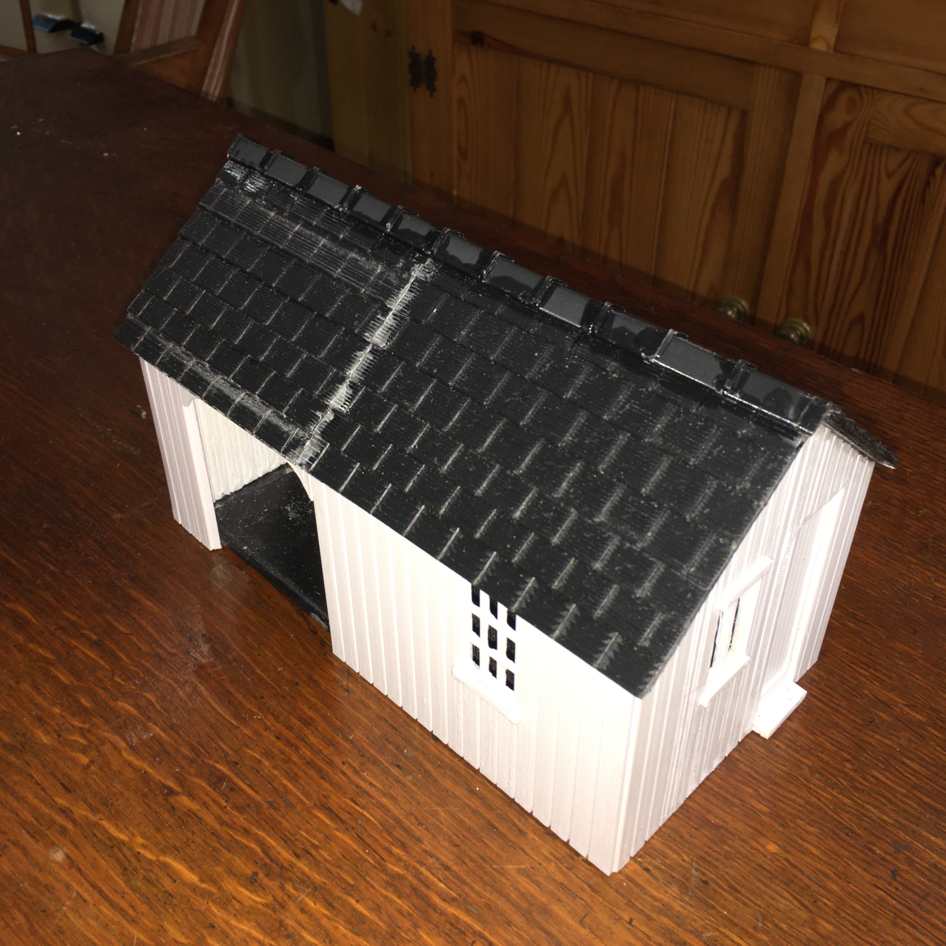

Post by Trevor Thompson » Mon Oct 04, 2021 9:48 am
The roof and ridge tiles are all successfully printed and fitted:
A few words about the printing. I had raised the extruder temperature to 235 degrees while printing the walls in white ABS. It seemed to improve the finish of the planking. However I forgot to reduce it again when I changed to the black filament to print the roof. I am fairly sure that this was the cause of some issues with printing the roof. The first two parts were fine, really nice finish, and clear definition, but the third part was less satisfactory:
This was difficult to photograph, but perhaps you can see that the upper part of the top but one row of slates is missing, and the top half of the bottom two rows is missing. I found a build up of cooled filament suck to the front edge of the extruder, which looked as if it was wiping away the hot abs as it was extruded. Cleaning it off seemed to solve the problem. I think that the raised extruder temperature might have caused this.
Since I primed the bed with the ABS slurry I have had no further problems with adhesion, but I am continuing to use a reft for these large flat prints. The roof was printed without raising the model off the bed, and I was able to separate the model from the raft fairly easily.
The roof tiles were printed as individual tiles, 14 at a time, on end, with the thicker part on the bed.

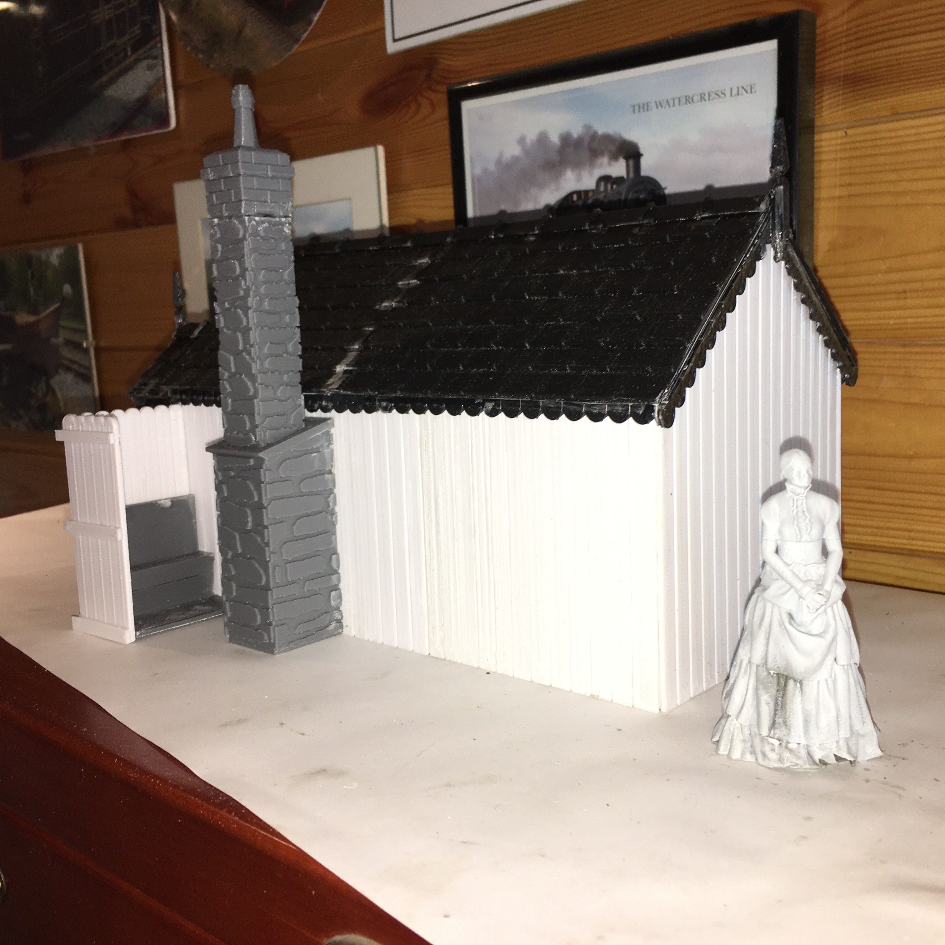

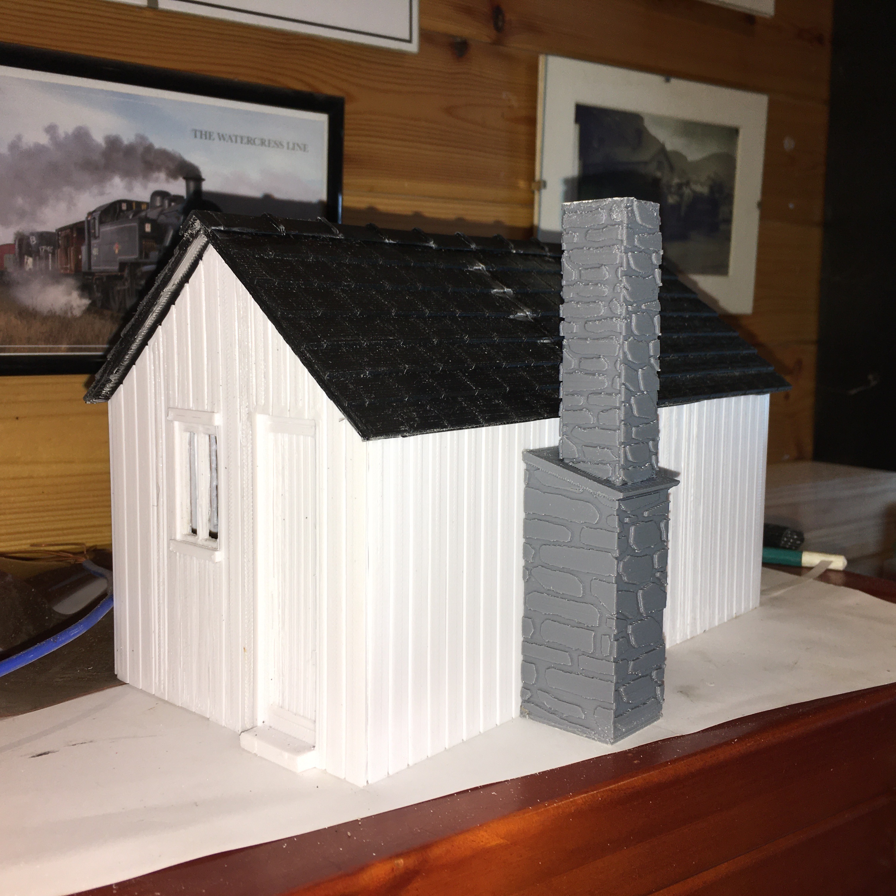

Post by Trevor Thompson » Sat Oct 09, 2021 1:38 pm
The building is now finished. Apart from painting of course.
That includes the ornate valence around the roof and porch, the finials on the ends of the roof, the porch and the urinal tucked behind the building.
The view from the back:
and from the front:
I am particularly pleased with the way the stonework and the brickwork on the chimney has worked out.
I will now update all of the .stl files, and check they are fault free before adding them to the files section.
Posts: 5717
Re: Dduallt Station building
Post by Peter Butler » Sat Oct 09, 2021 2:11 pm
I'm particularly impressed with the female figure, although she does appear to be searching for the lady's facilities and has ventured close to the gents instead!

Post by Trevor Thompson » Sat Oct 09, 2021 3:11 pm
She was from a file downloaded from Thingiverse, and printed on my resin printer.
I think she is out of luck, as I don't suppose ladies facilities were provided in the 1870's. Well there is no evidence in the photographs.

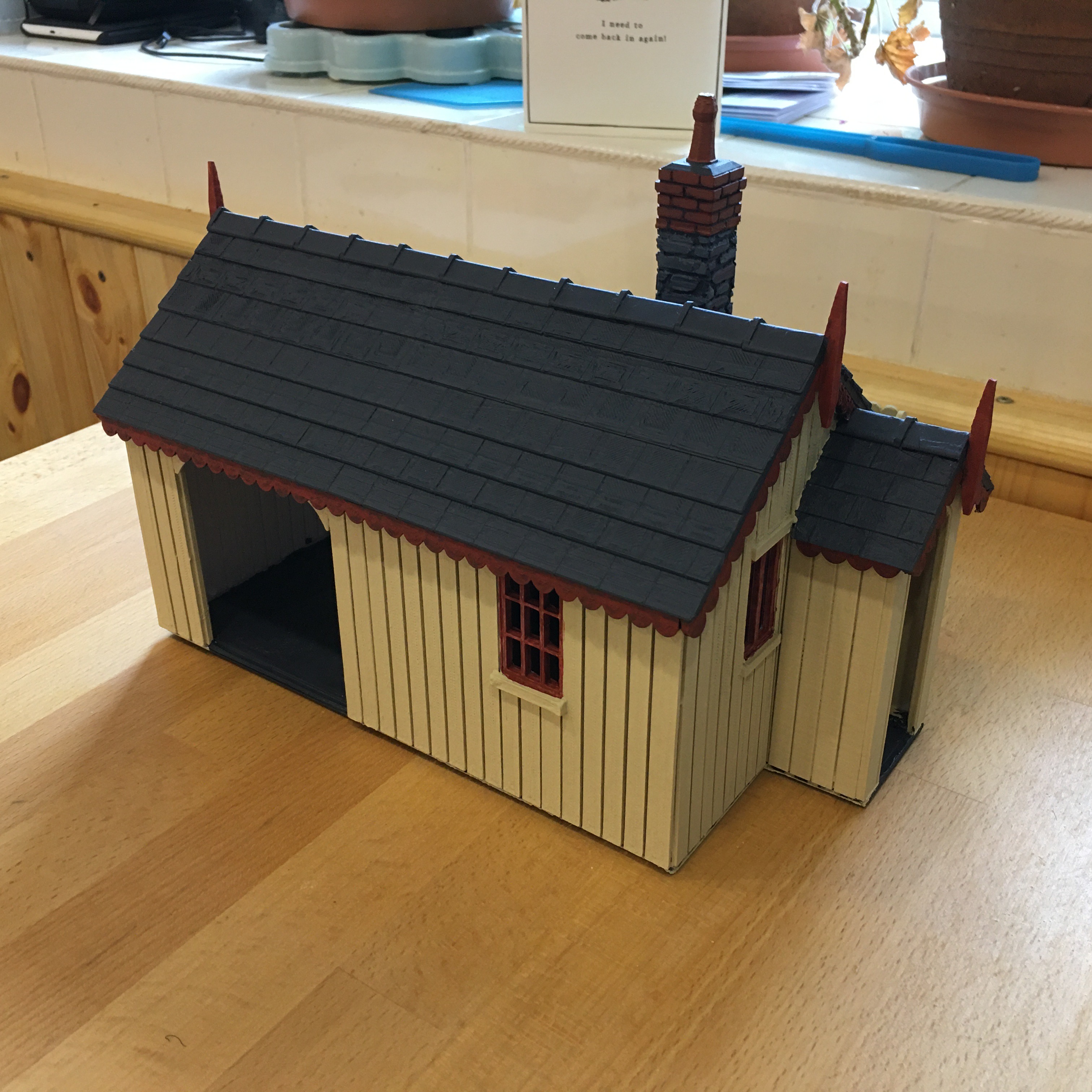

Post by Trevor Thompson » Tue Nov 23, 2021 11:30 am
Some photos of the finished building now that it has been painted:
and
I don't know what colours the Ffestiniog buildings were painted in the 1870's but some light shade somewhere between white and cream seams likely. The colourised photos in the 16mm association Ffestiniog document look cream. So my Tan-y-bwlch building is white and this one cream. So I cant be that far out!
I am pleased with the plank effect on the walls - perhaps they are too far apart but at least the gaps were not filled up with paint. The chimney represents my first attempt at printing the stone and brick effect within the walls - and that has worked. I think the brickwork on the top of the chimney was particularly successful. Note that the bricks are exactly to scale.
