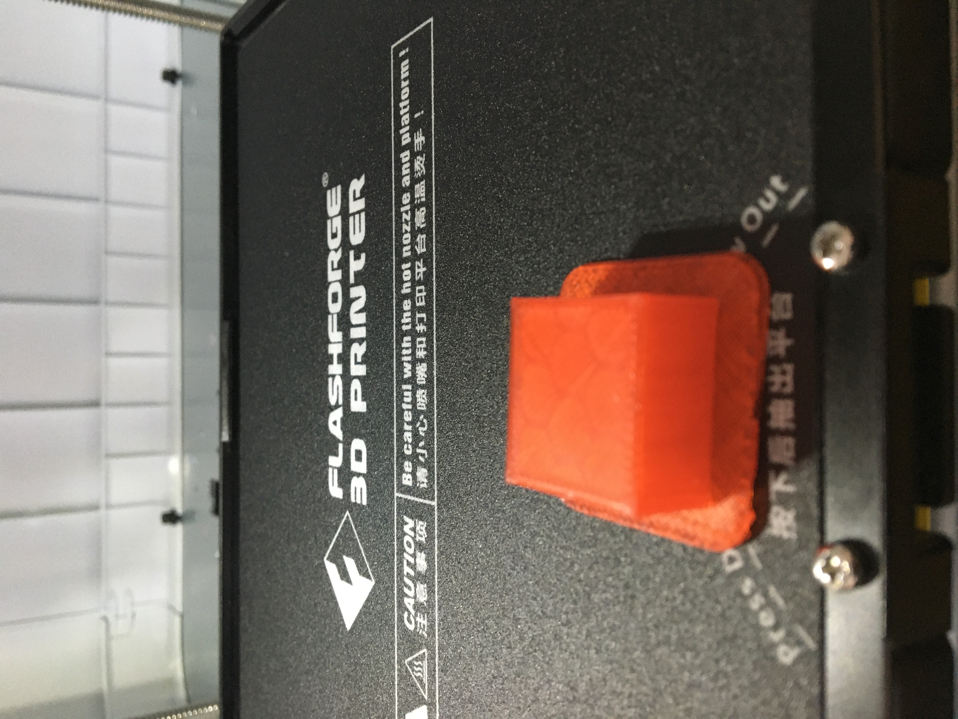

I have now got the adapter and printed off the square box. It's not bad, in fact it's pretty good for a 3d print that had no adjustments to it. Ok the base is a tad to much, but hopefully at some point I can get it to be thinner.

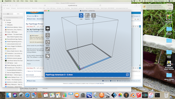

Now lets assume you want to print one of the files which we have shared on the forum. Lets take the oil drum as an example. You download the file from the forum. The filename takes the form of "Name.stl". The ".stl" is the important bit to note. That is a file which needs to be sliced in your slicing software.
So you need to download the slicing software from the Flashforge website ' the leaflet which came with the printer gives details - but it is easy to find. The software is called "Flashprint".
Next post in a minute.
- Posts: 1202
- Location: South West Wales
Re: My Flashforge Printer Journey.
So that barrel:

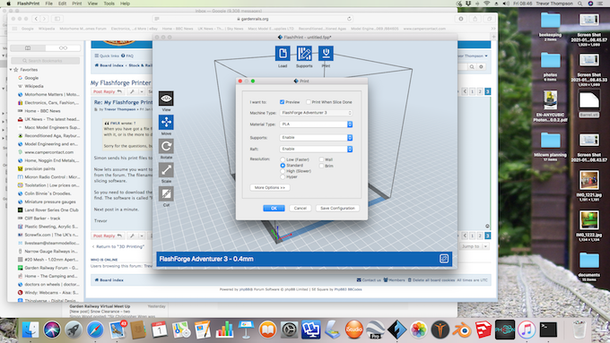

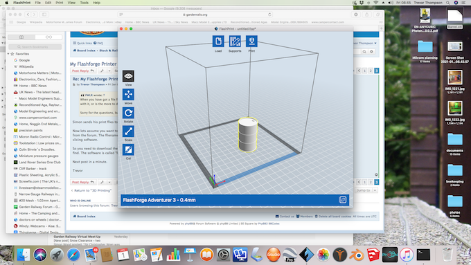

Opening the flashprint software, you get this screen" Click the top left button marked "load" and find the file you have downloaded "Barrel.stl". double click on it and this appears:

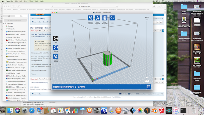

We can play with the positioning, the size and the orientation of the barrel - but it is fine for this purpose as it is. Now click supports (middle button at the top), and then autosupports: You can see supports added to the outside to hold up the top rim, in green. Click back and then Print:
You get this message. click OK. you get this message:

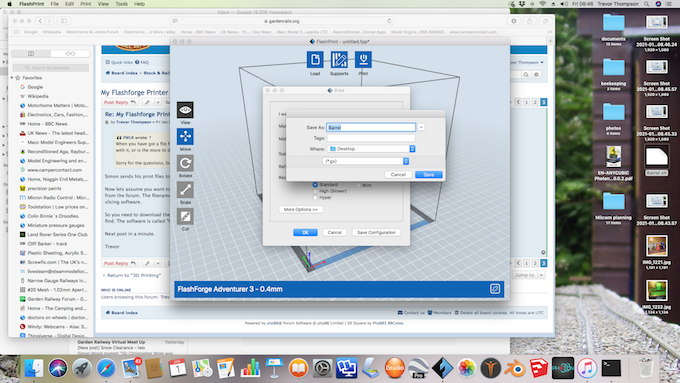

It is easy to save it on the desktop where you can find it.
All this will have generated a file called "Barrel.gx". That is the file to put onto the USB stick and take to the printer. I will let you take the stick to the printer and press print on the printers screen. Insert the usb stick and click on the screen over the usb icon. then click on the file name icon. It should now print. Go get a cup of tea!
