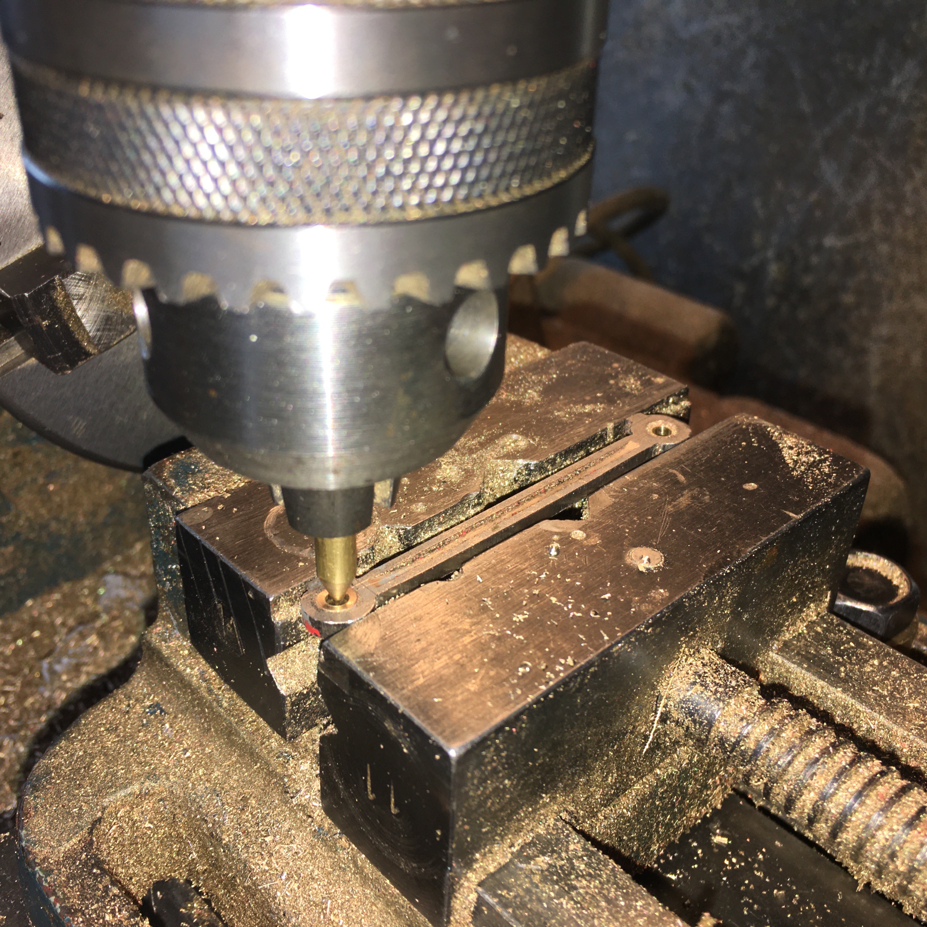

I drilled the right hand coupling rod bushes in the mill, setting them the distance apart suggested by the measurements and they fitted first time:
The left hand one fitted as it was (with new bushes) and the wheels went around without any tight spots. So I set the wheels at 45 degrees and fixed the remaining crank in place where the coupling rods had located it.
It all goes round, with slight resistance - but consistently free. I think the bushes all have around 0.05 - 0.08 mm tolerance - so they are a fairly close running fit.
