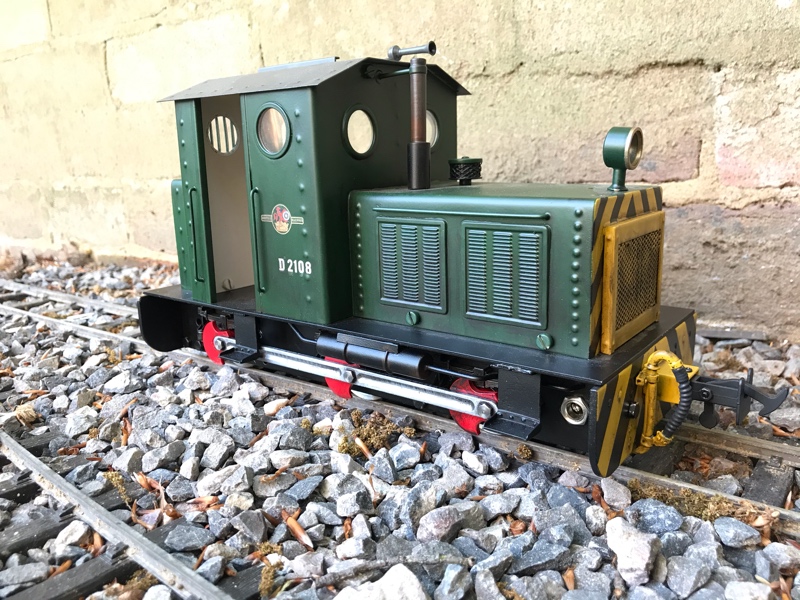

philipy wrote: Sun May 03, 2020 10:00 am Gareth, where are the louvred panels from? They add huge amounts of realism just on their own.
They’re brass etches from grs, save a lot of time over trying to scratch build something and from what I recall they weren’t expensive

A beautifully finished model. Plenty of good detail. Some impressive metal working skills in evidence.

ge_rik wrote: Sun May 03, 2020 7:11 pm A beautifully finished model. Plenty of good detail. Some impressive metal working skills in evidence.
Thanks very much, metal work comes fairly naturally to me, wood, plastic or electrics on the other hand are a completely different story!
Managed to get a bit of time in the shed over the weekend, ended up with some steps and some vac pipes. Pipes are brandbright, the ones that come with the spring, but shortened and with some heatshrink over the stretched out spring as I buggered up the spring trying to remove it for painting!

That's a real beauty, superb job all round.

Thread is now up to date with the current state of play on the loco so updates will slow down a bit! Raised the scrap box today for bits to make up some air tanks and pipework

All done with the air tanks, just getting the lamp up and running to go now. Right now it seems like a better idea to sit in the sun with a beer and watch trains go past though!

never really been a fan of the look of these diesel shunters, but you have me converted this one looks great, can you tell me what mfa gearbox did you go for

Post by ge_rik » Thu May 14, 2020 6:27 am
Not only looks good, it sounds good too. What sound unit are you using?

SeamusOD wrote: Wed May 13, 2020 9:29 pm never really been a fan of the look of these diesel shunters, but you have me converted this one looks great, can you tell me what mfa gearbox did you go for
It’s the 30:1 12-24v one, running on 12v. Pretty cheap and seems reliable so far apart from some bolts coming loose while bedding in.
ge_rik wrote: Thu May 14, 2020 6:27 am Not only looks good, it sounds good too. What sound unit are you using?
It’s a mls light diesel sound card with a 50mm speaker mounted in the rear section via an old aerosol lid sealed with silicone.

Got distracted by another project briefly but finally got round to wiring in the led for the lamp and making a lense, I think she’s finished for now!

Love it. The warm white headlight and weathering really tie it all together.
