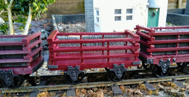

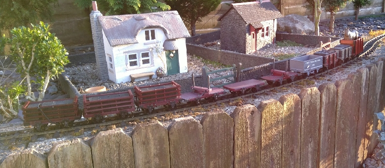

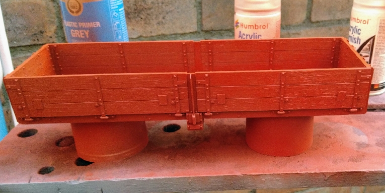

In between working from home I've been spraying more slate waggons, as well as making a real start on the Swift Sixteen WD D wagon (nice).
Braked waggon. The "brakes" are simple wire, with the mounting bracket being made from the kits original axle boxes.
This one has a thinner frame compared to the rest.
Dandy waggon, made from a Timpton kit with extra plastic corner strapping.
WD D wagon. Instead of the common grey, this one is based on Bachmann's 009 WHR wagon.

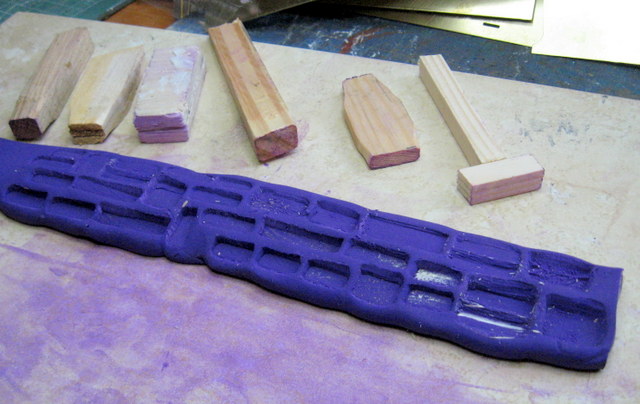

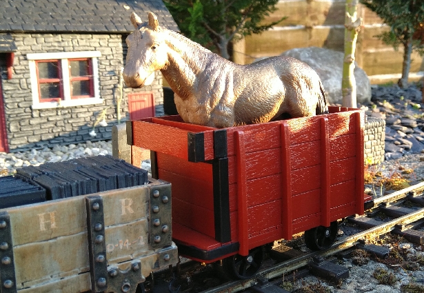

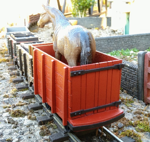

I like to have more than one project on the go at a time - so I can turn to something else when I'm waiting for glue or paint to dry or when awaiting a delivery or stuff I hadn't planned for. So, in addition to the railcar (awaiting delivery of various temperature low melt solders), I am continuing to revamp Bulkeley Station. Presently working on extending the platform (using a plasticine mould for concrete) ....

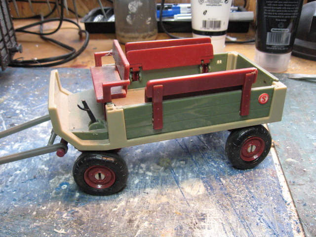

...... and rebuilding a Schleich horse drawn wagon to make it look more in keeping with the 1930s
I'll keep you posted on these developments as and when.

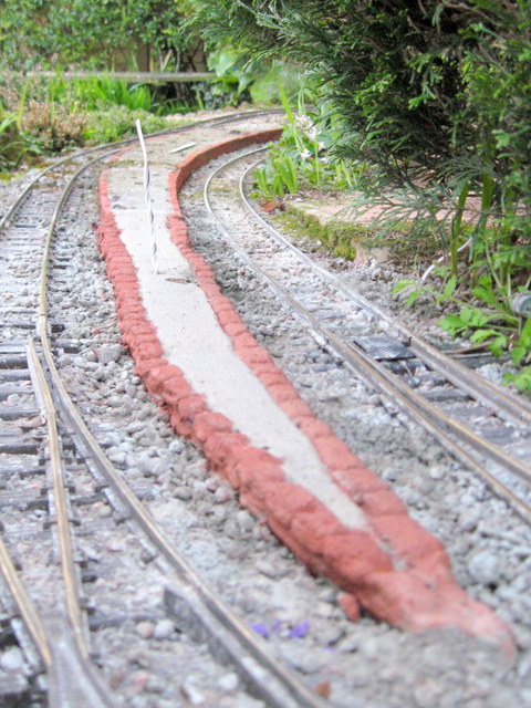

Finished off the platform extension for Bulkeley today...
Blogged wot I dun 'ere - https://riksrailway.blogspot.com/2020/0 ... keley.html

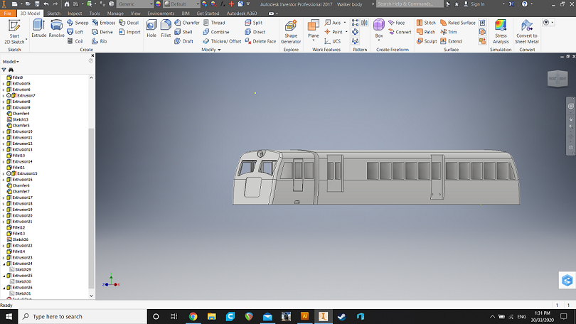

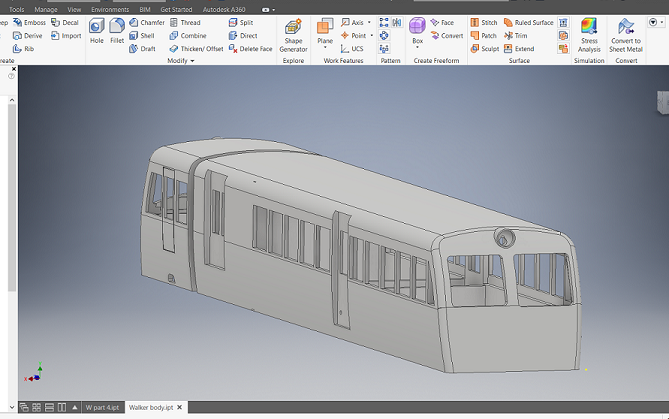

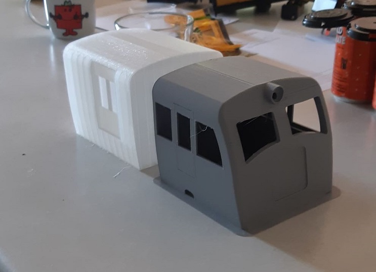

I recently bought a secondhand model of a 1920's Leyland railcar from Ssouth Africa and although its a very nice model its quite old and delicate. I still wanted a model of a railcar for more daily duties so i spent the last 2 days drawing this up and this morning I got the first pieces off the printer. Its a model of the Victorian Railways 102/153hp Walker railmotor with the larger baggage compartment and single headlight. The prototype was broad gauge but the same power bogie was used under 3' 6" railcars in other states and so rule 8 applies... (model is 1:24 scale)
should keep me busy for a bit
