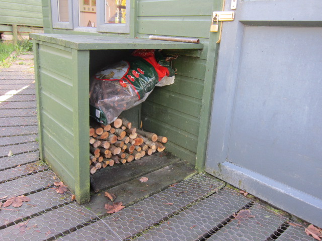

That looks a first class job of construction Rik, one which will give you years of useful service.
As you know, I have had my shed(s) in operation for some years now and many additions have been made to make life easier and more user-friendly. You might not think some are necessary or apply to you, but time will tell.
Firstly, I also covered the roof with felt as you have. The location of my shed is open to strong winds and driving rain which soon sorted out the inadequacies of the material, so a metal, box section, roofing sheet has now been added.... I found that when I wanted to open my shed in the rain I was getting wet whilst opening the lock, (we need to look after ourselves at our age), so I built a porch as protection against the elements. It also makes a comfortable place to sit and enjoy the view..... When you visit your shed with a cup of tea/coffee in one hand and that new kit which just arrived in the post in the other, what you need is a shelf by the door.... This also doubles as a wood store for my multi-fuel burner.
As for timber protection, your pressure treated timber should be fine for a while, although it should dry thoroughly before applying another coat of sealant. I use a coloured wood preservative with wax additive which remains flexible as the timber expands and contracts. I have doubts about products which form a hard skin as they can crack to allow water in, but hold it and not allow it to dry out naturally.
All of these things have been useful in my circumstance and may not be suitable for your needs, however, I have learned from my own experience which I gladly pass on to you.

I've already got plans for a verandah with some decking. However, that will have to wait for funds to replenish. I like the idea of a shelf and wood store. I don't remember seeing your multifuel stove - but then I've not visited you during the winter months.

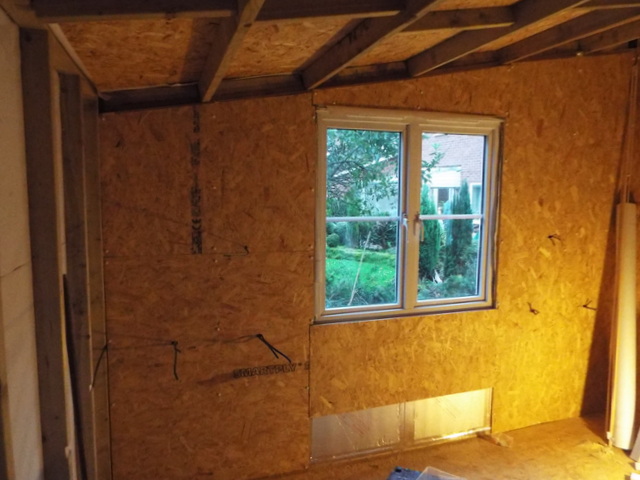

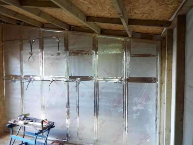

Now working on the interior. Funny you should mention foamboard, Andrew.....
The insulation I'm using is a sort of foamboard - foam between layers of foil. Not cheap but as my missus says, you're only going to do it once (unless of course I have a cunning plan!).
This is then clad with more OSB (Oriented Strand Board) - a cross between plywood and chipboard. .
Have now finished doing the cladding so am installing the electrical fittings - sockets, switches, lighting etc.

Great progress Rik, and well timed to be working on the inside.
You must have worked out in advance where you want to site everything and fitted ample power points in strategic places.... something I couldn't do as I tend to work organically as times, and temperament, change.
Interested in the high level power leads.....?
- Posts: 7947
Re: Workshop/shed
For wall mounted spotlights (thanks to IKEA) over the workbench. These days I need a lot of light when working on small details ..... or maybe I need new glasses? The ones midway up the wall will be for double sockets just above the workbench so I don't have to scrabble about on my knees to plug in a soldering iron or mini drill.
