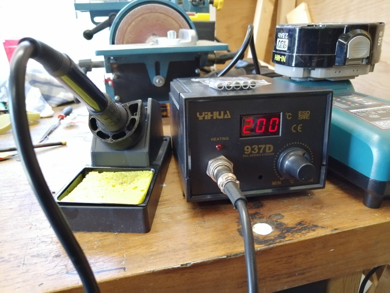

I finally got my temp soldering iron out to play and what a world of difference it makes, I will never go back to a standard iron!
Cheap one off Amazon, comes with different soldering tips and a stand.

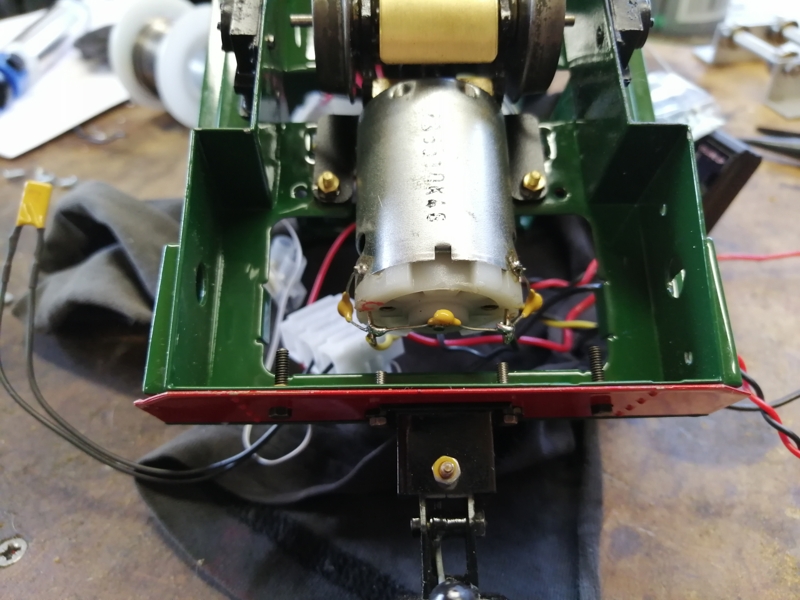

Allowed me to make a neat job of soldering capacitors to my Brandbright Circket motor:
Thanks for the suggestions!
What do you lot use to clean the tips after use? Years ago, I made the mistake of using files which you shouldn't do as that removes the protective coating off the soldering tips so this time around I don't want to ruin my new ones!

tom_tom_go wrote: Sat May 04, 2019 1:07 pm What do you lot use to clean the tips after use? Years ago, I made the mistake of using files which you shouldn't do as that removes the protective coating off the soldering tips so this time around I don't want to ruin my new ones!
I'm not sure I could still solder with the old style hot electric poker. my father was taught to use what was basically a large lump of copper with a handle that he put in the kitchen wood stove to make it hot. He had one big soldering iron and one very big soldering iron. never have worked out why a lump of copper is called a soldering 'iron'. I watched him plenty of times, but it was well beyond my skills......
The old way of cleaning a soldering iron tip was to wipe it on a damp sponge, which is that yellow thing in the soldering iron stand. Some years ago I changed to using what is basically a brass scouring pad. It keeps the tip clean as a whistle, scrapes off excess solder and doesn't affect the tip temperature, or the tip coating.

Don't be tempted to use a cheap stainless steel scourer from the supermarket, it is hard enough to damage the iron coating on the copper soldering tip. The iron coating is there to stop the copper tip dissolving into the solder.
If you will be soldering whitemetal as well as electrical work, get a separate tip for the lowmelt solder. If the two solders mix, you can get brittle soldered joints.
