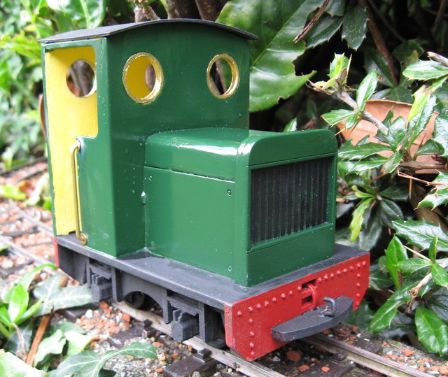

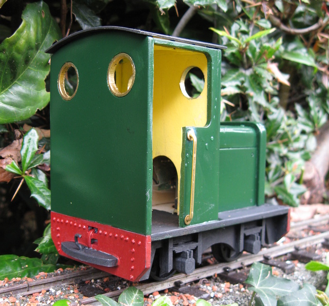

Taken a while (since May) to get around to finishing off this wee beastie - but she's now resplendent in PLR colours. Still need to add some detailing such as the cab interior, a driver, an exhaust pipe and some general clutter on the running board - oh and name and number plates - but otherwise she's ready to enter service. I'd forgotten what a fag painting plywood rolling stock is .....
I've blogged the build for anyone who might be interested.

Re: IP Engineering Albert
Albert looks good Rik. All painting is a drag. One reason it's taken me around two years to paint my Newqida coaches. I've a load of OO stuff to paint and I can't be bothered.
Love those little extra details on the buffers Rik.
Just read the blog and you have made the build even easier for people with little or no experience in building kits. You are correct about encouraging new people into 16mm, it is a cheap and easy build.

And thank you Rod. Nice to get such supportive feedback.FWLR wrote: Tue Jul 24, 2018 8:37 am Love those little extra details on the buffers Rik.![]()
Thanks Rik.![]()
