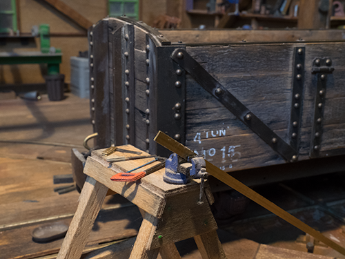

Keep 'em coming - great amount of detail just in those two pics - love the black stripes on the yellow screw driver - I have a screwdriver just like that - albeit (1:1)

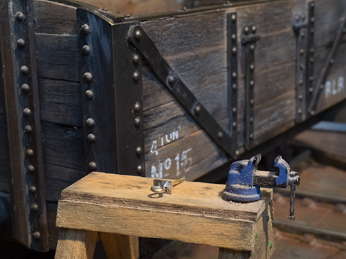

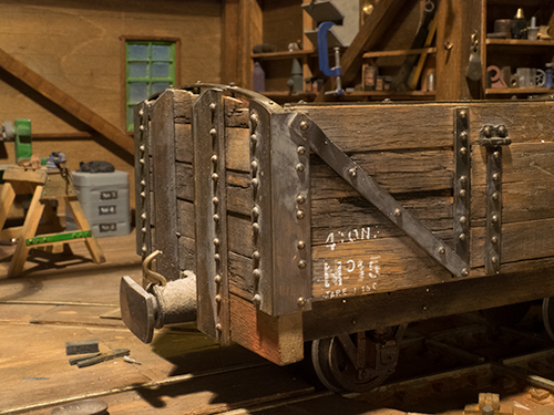

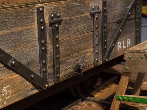

THE NEXT FINISH WAGON No15.
As I was preparing to restart the Lister I realised that a top-hinged door coal wagon (No15) still needed its door catches fashioning and fitting (and some tare weights added).
No15 with no door catches. Fashioned largely from reclaimed wooden fruit boxes which are an excellent source of distressed wood.
Marking and cutting out the catch from stock metal bar
One fabricated catch
Finished catch
Detail of the distressed effects you can get with using reclaimed wooden fruit boxes
And that another completed projected (I think).
Finished catch

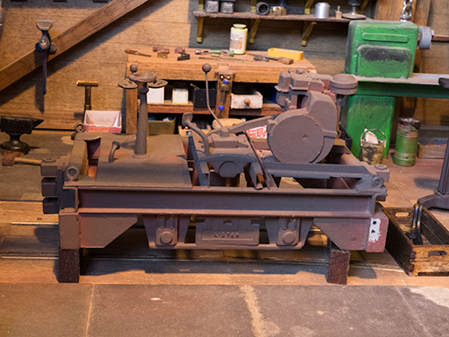

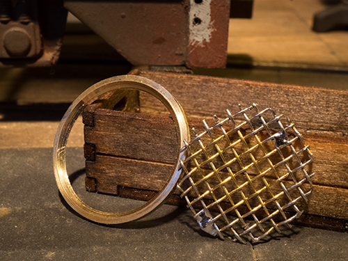

The NEXT FINISH: The Lister (in progress still)
The IP engineering Lister was a stalled rebuild. I was trying to be too clever and put in a microprocessor control to make it more, well, controllable. The electrics worked but it proved a bridge too-far to fit it all into the limited spaces available. After much fiddling it was consigned to the back of the study-desk. To be honest I feel "KISS" is the winning principle here and decided to re-install something akin to the designed electrics.

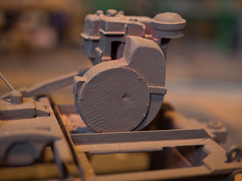

The kit is some years old but I think is still listed on IP's website as current. The white-metal engine block casting is good for its era but the fan-cover has always looked to me as an oppressively blank face with the merest hint of casted grill.
Lister in uniform matt brown
Detail of fan cover with casting of grill just visible

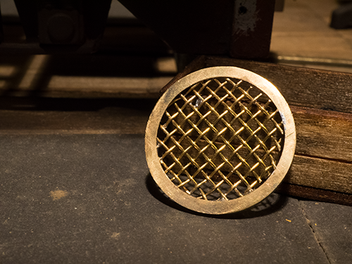

Hopefully we can do better, a web-purchase of woven brass mesh from The Mesh Company cost a total of Β£3.39 for an A5 panel. They knocked 50p off for a Christmas bonus!
This was soldered to a turned brass bevel
And when offered over the original casting: it definitely shows promise.

Very nice job on the fan cover.

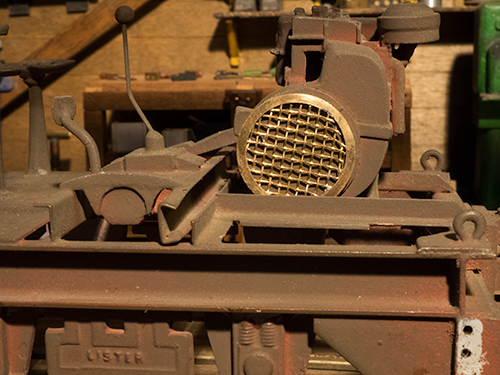

I am not milling away beneath the grill until I am happy the grill is convincing. It is clearly over-scale thickness. But I just gave it a quick dip in Carr's Metal Black for Brass to make it less obvious and offered it up again.
The final version will be finished in Lister Green with just the grill fading to black. Need to sleep on it.

I think the engine is supposed to be a Lister LD. It may not have had a fan cover as it depended on what tinwork covered the flywheel. I think the mesh cover you have done is spot on. These engines and the locos they were fitted to were adapted and repaired over the years so I think that it is a case of anything goes.
