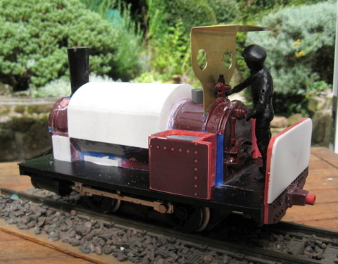

Rik, I'm wondering if the spectacle plate could be a little lower. On looking at the relationship between the drivers head and the roof plate in the video. Just a thought, perhaps cardboard could be used to see how it would look before cutting brass.
- Posts: 8004
Re: Otto bash
Hi GrantLNR wrote: Mon Aug 14, 2017 12:18 am Rik, I'm wondering if the spectacle plate could be a little lower. On looking at the relationship between the drivers head and the roof plate in the video. Just a thought, perhaps cardboard could be used to see how it would look before cutting brass.
Yes, I think you're right. The plate is mounted in a slot and so can be adjusted before I fix it into place. Ironically, I did try a card template before cutting the first plate, somehow it looked OK in card - except I didn't take and look at any photos before transferring to brass. I'm finding that photos seem to be more revealing than the eye somehow.

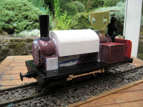

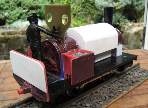

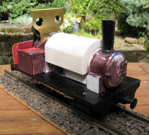

Part 8 - Taking shape (and weight)
Latest progress. The new brass sheet arrived and I've cut out the spectacle plate. It's a few mm wider than the temporary wide plate - I did try making it even wider but it didn't look quite right. Because Otto is wider than No.3, it's difficult to get the proportions right.
It may not look like a lot of progress has been made since the last posting but a lot has been done 'behind the scenes'. A fair amount of lead flashing strip has been shaped and forced into the saddle tank, the old side tanks (now bunkers), behind the front buffer beam and in the smokebox (to counterbalance the lead in the bunkers).
Some of the gaps where mouldings have been removed have been filled, sanded, filled and sanded again.
The chassis has been sprayed black and some of the rivet detail has been added (eg to the buffer beams).
There's still plenty to do. I hope to fit the electronics this weekend so I can do some test running. The spectacle plate needs to be fitted into place permanently after some half round beading has been soldered around its edge (awaiting delivery). I'm not sure about the chimney - it's the Otto one cut-down, but it looks far too chunky. I might have to sort through my stock of biros and pens to see if I can find something a bit more delicate and in keeping with the original. Then it'll be time to spray the body and to start adding in some of the finer details like safety valve, tank filler and all that lovely copper pipework.

- Posts: 6057
Re: Otto bash
Looking good overall, Rik. I think the spectacle plate looks good as you have it now. I thought your previous wider one still looked a bit skinny, tbh.
- Posts: 5717
Re: Otto bash
Very nice conversion Rik. Proportions look good despite the variation from the original. Spectacle plate a vast improvement on the first one and worth the effort.

Hi Philipphilipy wrote: Fri Aug 18, 2017 1:42 pm Looking good overall, Rik. I think the spectacle plate looks good as you have it now. I thought your previous wider one still looked a bit skinny, tbh.
Yes - I agree. The problem is that Otto is wider than the Black, Hawthorn and so even if I did the spectacle plate to scale it would still look overly skinny. Proportionally, the plate is wider than the original but seems to look about right in proportion to the width of the firebox.
