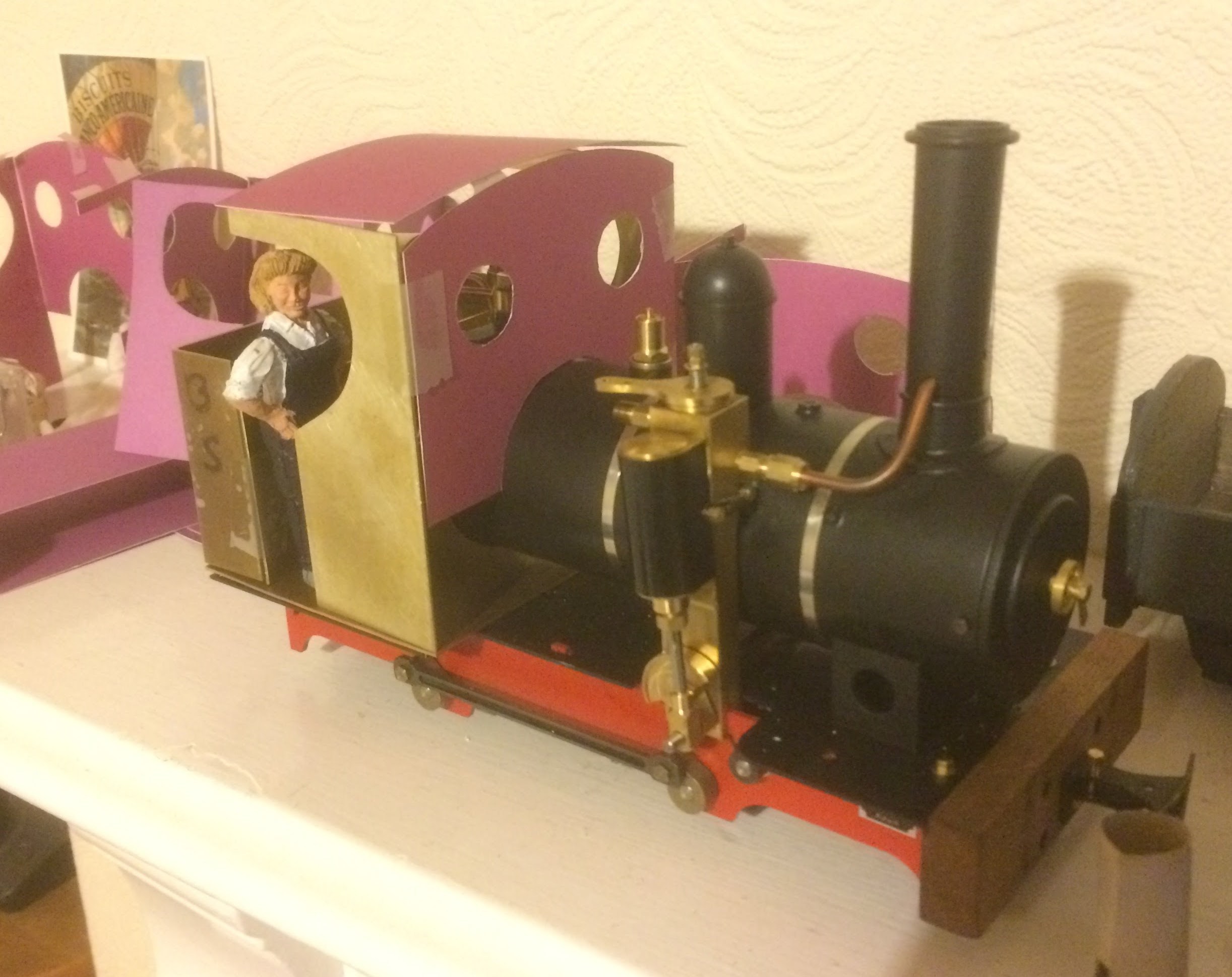

Ok, I've been making quite slow progress with building my new cab, but I've been even slower in actually writing it up.
In the last 20 months or so (although only really doing anything during the winter months). I began cutting out the cab from brass, and fabricating some angle for the joins. Here's most of the pieces held together with tape:

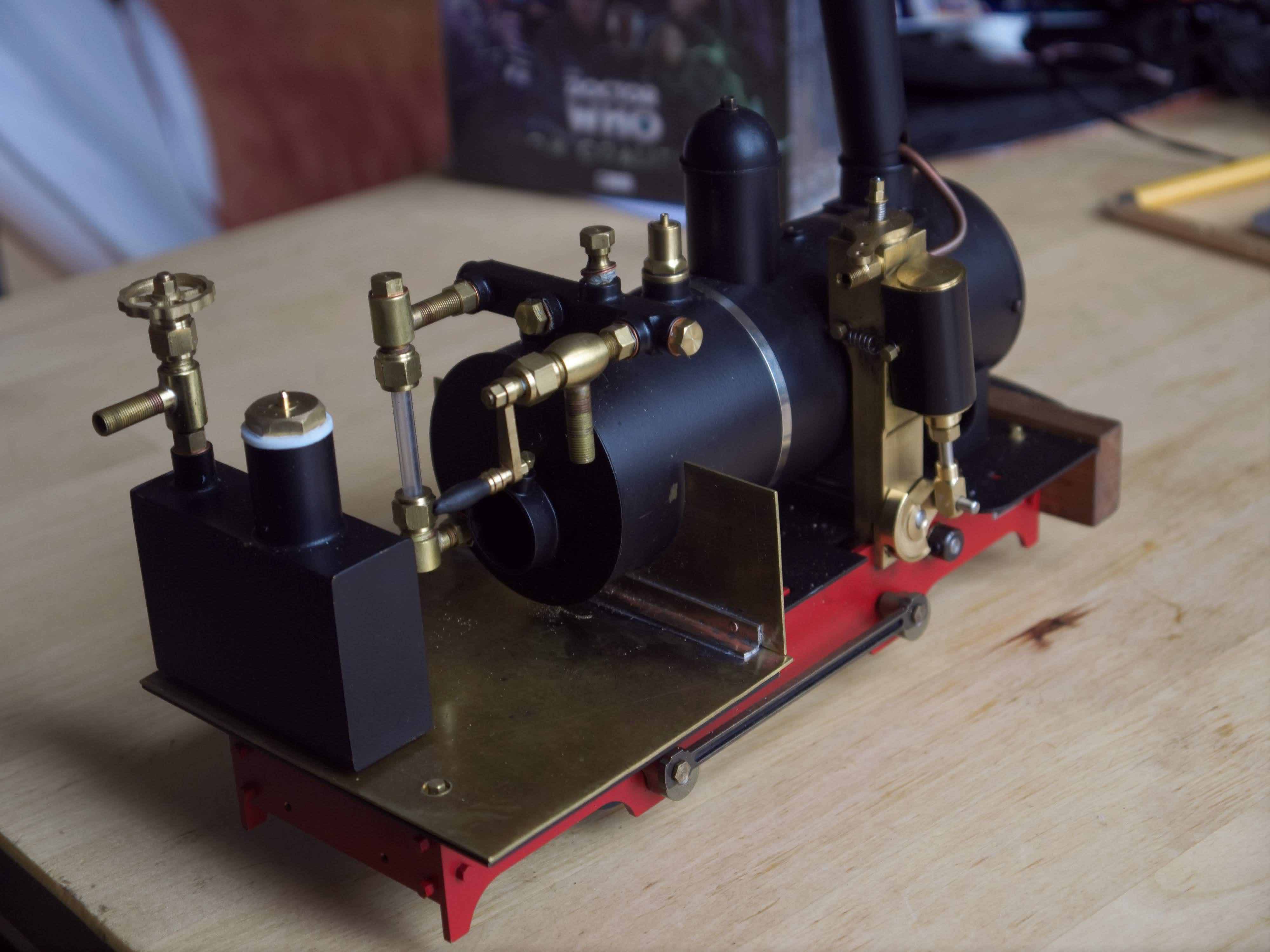

And here is the new footplate in place soldered to the lower half of the cab front:
The footplate is held in place by the screws that go up into the gas tank, now moved to its new position in the bunker.

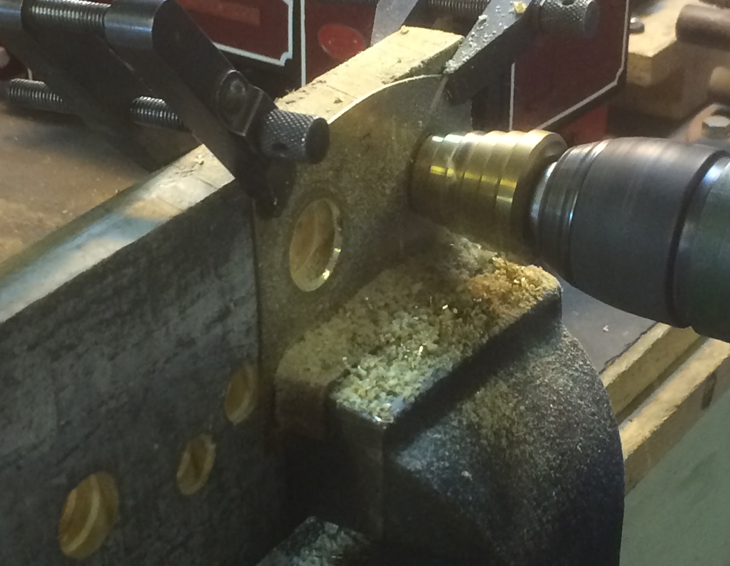

I decided to use Swift Sixteen's revolving spectacle plates so that determined the size the holes would need to be in the cab front. Here we are drilling out the holes (and by "we" I mean Tony Bird is doing the hard work while I take pictures).

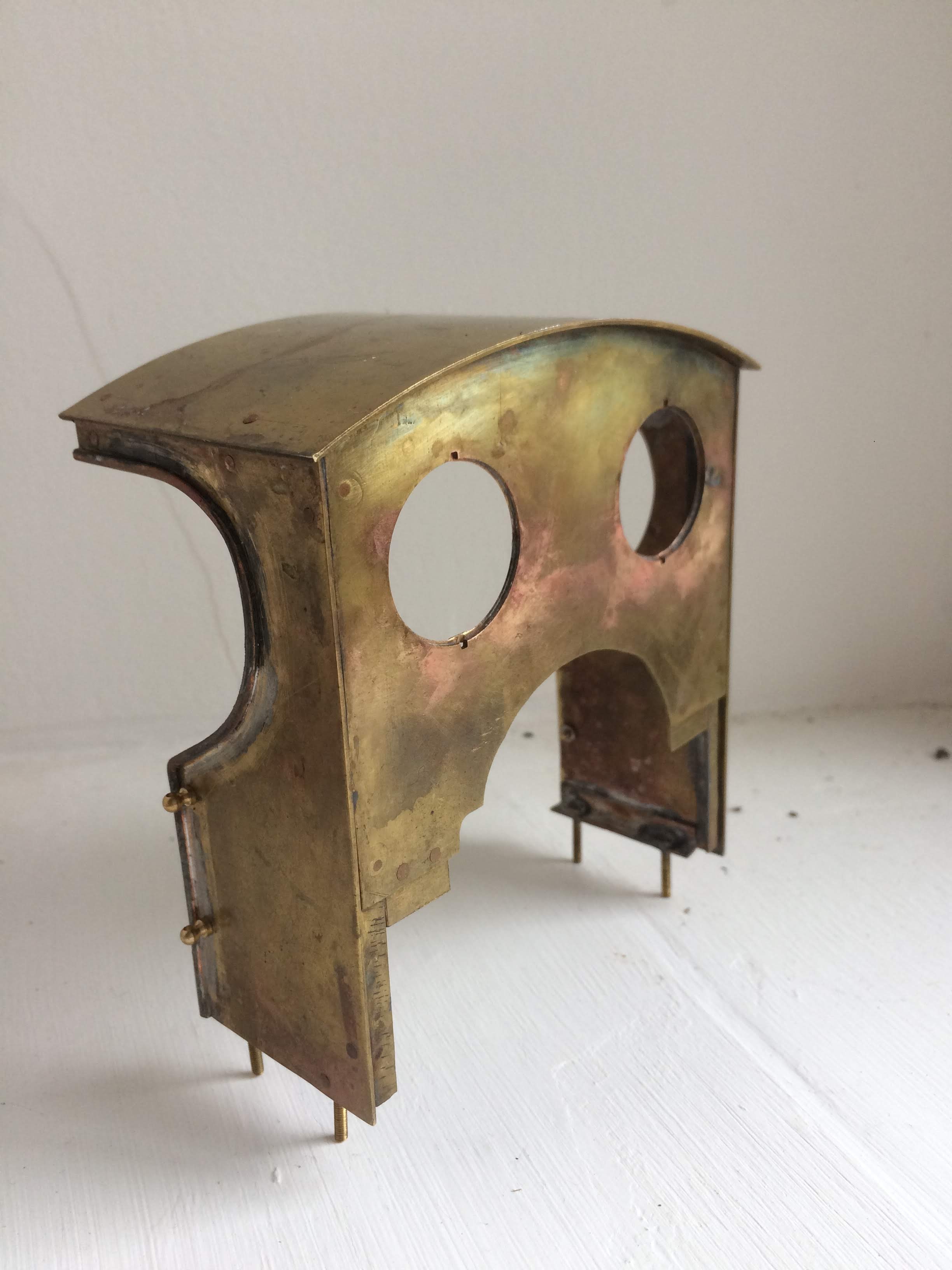

The following winter I started (inexpertly) soldering the bits of the cab together:
The frames of the spectacle plates are soldered on inside the cab. Once painted (not a job I'm looking forward to) I will fit the spectacles and then glue on the front frames. I've also added Chuffed 2 Bits handrail knobs, and soldered beading down the cab sides. This whole upper part is designed to be removable, so we soldered bolts to the angle and the bottom of the cab sides and drilled holes through the footplate to take these. (I think I should be able to shorten the bolts.)
