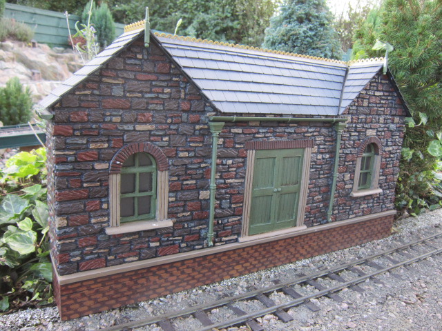

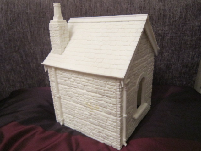

Hi Andrew,

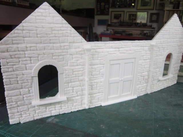

back in my thread is a full description of how I made the crossing keeper's cottage but, briefly, it is made from left-overs from a Pendle Valley station building kit which I chopped into a low relief, track-side, warehouse.....
The rear gable end wall sections and a pair of side walls, along with part of the resin roof, became the cottage.....
Dogs are not included in the kt!

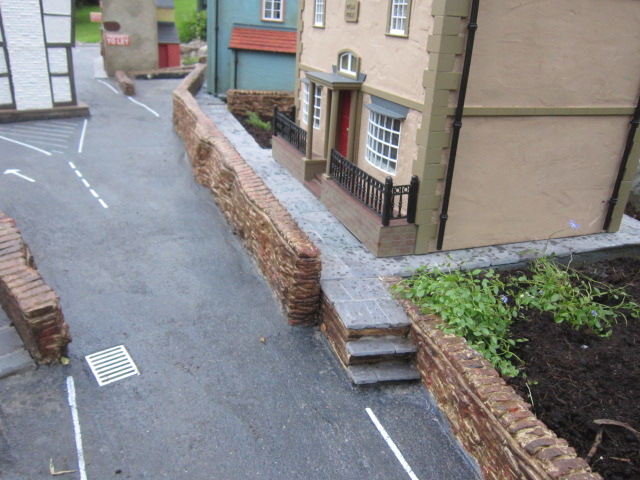

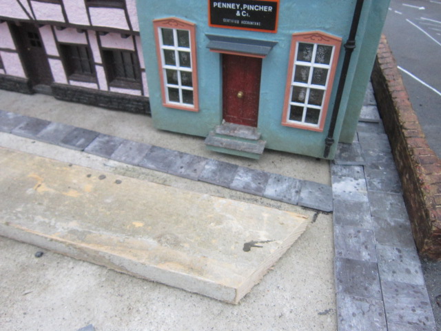

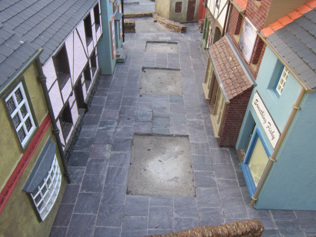

Although it has been overcast but dry today I got on with more slab laying around the Manor House and the shops on the High Street. The cement I'm using is waterproof and fast drying so I thought I'd risk it. As it turned out it has only just begun to drizzle so I think they should be OK......
The next area to tackle is probably the trickiest as I have two rows of shops facing each other in a pedestrianised roadway. I have begun by positioning one row and laying out a dry line of slate slabs to get the feel of it.......
Tomorrows forecast is poor so I might have to wait a while before I can continue.

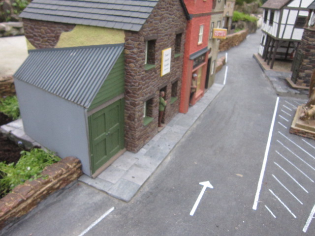

Post by bazzer42 » Mon Sep 10, 2018 9:59 pm
Love that strangely roofed side shed, it looks so real. Something you see in real life but rarely modelled. Genius!

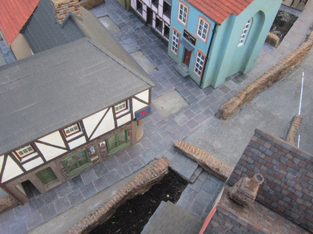

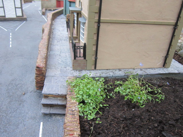

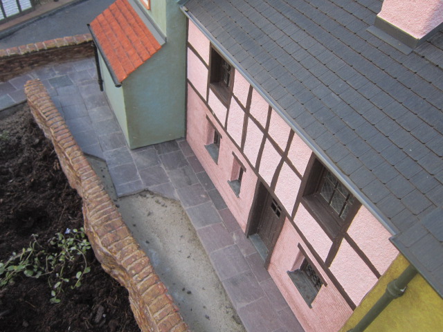

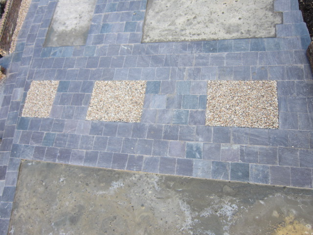

Onwards and upwards... as they say. Lots of slate cutting, lots of mess and lots of tile cement, but the slabs are now all laid, set and grouted....
Still some detailing to do but nearly there.
Posts: 6057
Post by philipy » Sat Sep 15, 2018 6:52 am
Incredible how the paving brings it all together, especially evident in the first picture showing both sides ift he street with the paving right across. Presumably the 'holes' are for flower beds or something?
Posts: 8004
Post by ge_rik » Sat Sep 15, 2018 7:11 am
Luverly paving, with the added bonus of embedding the buildings.

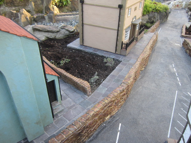

After a terrible storm throughout yesterday at last the sun is shining, so I decided to remove the tarpaulin which has been protecting my SBR coated, crushed oyster shell to see whether it has set.... it has! This is the area where the rectangular gaps were left between the slabs in what will be the pedestrian zone.....
Not much to look at without the buildings and seating arranged but gives an idea of the Town Planners vision!

I don't know about the town planners visions ( too much of the hard stuff perhaps?) but I can visualise it and it looks very nice to me.

Thanks for the comments, at this stage it does look a little firm underfoot! There are planting areas surrounding the site which have not yet been filled and will soften the overall appearance when they are. That is something I have to wait for nature to take care of and this is not the best time of year to expect quick results.

Peter, Just curious, is your drainage system working as you had hoped? I believe you've had a fair bit of rain to test it recently.
It did occur to me when you first showed them that the drain grid slots might be too fine for surface tension to allow easyflow through. I hope I'm wrong and I'd love to see them in action with a nice swirl of water going down the plughole!
Posts: 5717
Post by Peter Butler » Sat Sep 22, 2018 2:40 pm
Hi Philip, I'm afraid I can't show a 'swirl of water', firstly because I have no intention of standing out in rain sufficient to see it happen! However, I can say it definitely works, and very well too, as the areas where the drains are show no surface water at all, whereas, in a couple of dips elsewhere in the road surface, water pools form as I have not been clever enough to manage a fall across the entire space. As long as there is an escape route for the majority of the wet stuff I am quite content with the remainder as it recreates 12"/ft. scale where surface water does occasionally gather in puddles.

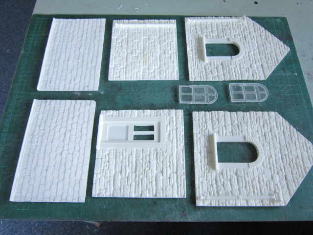

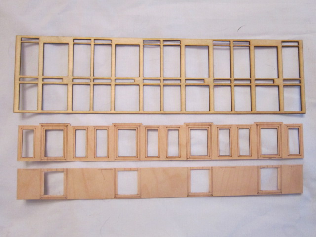

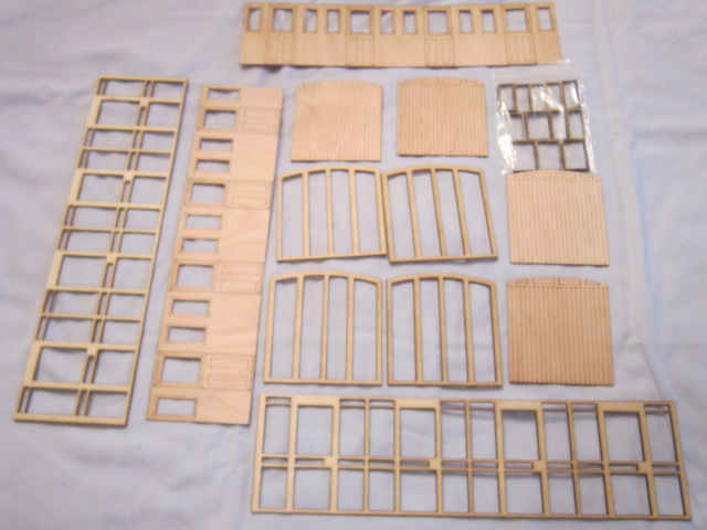

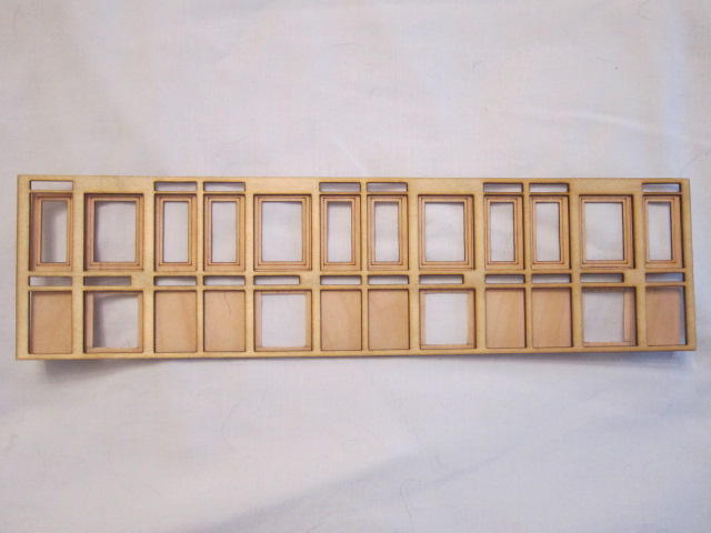

As mentioned elsewhere (Help and advice) I have now received some kit parts from The Lineside Hut and they look to be very well produced. My original intention was to order just the CRV kit but as I have no experience in wooden kit construction I also ordered some home builder parts to practise on. They make a range of coach sides and ends and I purchased the four compartment option with the intention of cutting the sides in half thus making two, two compartment coaches. In the event I have decided to stick with plan 'A' and build one bogie coach.
The parts as supplied.....
After some surgery.....
Resulting in.....
I have spray painted in primer and three top coats of gloss to hide the wood-grain effect and will post the results of that next time.
