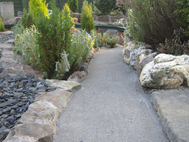

bazzer42 wrote: Sun Aug 26, 2018 7:18 am It will probably fade as it dries as you say. Any work I've done with masonry colours or cement never dries the same colour as wet.
Looking back at my previous roadway, which I laid in much the same colour mix, I can see how much the black has become grey over time....
For now I am content with the colour as it represents the laying of new surface through the village which has undergone a complete refurbishment to encourage more tourists to visit and spend much needed cash.

Peter Butler wrote: Sun Aug 26, 2018 11:51 am
Getting back to the subject of road colour :D , I think your weathered grey road looks really good. It seems to blend quite well with the adjacent rocks and doesn't grab the eye, which in my mind is how a model roadway should look. It's something that is simply 'there' and is needed to link the scene, not as a focus.
I think mortar colours always seem to fade. The concrete bridge pier that I posted last week was quite distinctly green when new and has faded significantly now.

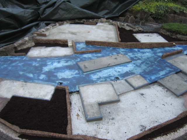

Phil, I managed to buy a white marker pen with 2.2mm point and will practise on some suitable material first before attempting the real thing. At the moment it wouldn't be possible as I have done the unthinkable..... remember the old saying... 'Put your money where your mouth is', well I have done it today just to show my confidence in SBR to do its job. The concrete has been under cover since laying it on Saturday, it still has a high water content but is firm to the touch. I thought I would give it a top coat of SBR to help stabilise it and add a surface for me to paint the white lines. Prepare yourselves.....
This is not a trick of the light, it really is that colour.
It has done this before so I was well prepared for the result knowing it will eventually settle down to normal colour and the sheen will also fade leaving the original black finish. Just have to be patient now, the cover is back on and will stay there for days... possibly weeks?
Also, I have filled all of the planting areas with compost ready to add some softening colour.
Post by tom_tom_go » Mon Aug 27, 2018 9:21 pm
I quite like the ocean look, maybe some boats are in order if the colour remains :thumbup:

Post by Lonsdaler » Tue Aug 28, 2018 10:40 am
It's quite horrifying the first time you see that, isn't it Peter :shock: , but as you say, and know from experience, it will all settle down. I'm glad to hear you got sorted with a pen. I like the Molotow ones, as they do a range of alternative and replacement nibs, which can be used in the same pen.

Post by Peter Butler » Tue Aug 28, 2018 11:05 pm
ge_rik wrote: Tue Aug 28, 2018 9:26 am Does that give protection against frost, Peter? I'm waiting for Beeston Castle ruins to dry out before applying masonry waterproofing agent. SBR might be an alternative if it can be applied to damp Thermalite...... :?:
I'm placed on the spot now because I can only report on my experience. The road surface I laid previously was treated in the same way and has survived two or three winters without suffering frost damage. Whether it is because of the SBR I couldn't say but concrete has some resistance to frost if laid thickly enough.
