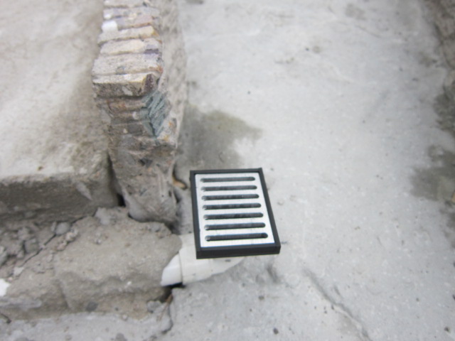

As previously mentioned, drainage is important as there will be quite a lot of hard surface to clear. I have already laid pipework (overflow pipes) from the road areas and a friend has now made me metal drain covers (milled from solid alloy sheet) to place in the gutters of my roadways. A plasticard surround is now fitted to each and will be installed at the correct height to allow a slight fall for the water to enter.....

Absolutely brilliant so far. Those drain covers look so realistic. An otherwise insignificant detail turned into a miniature work of art!
