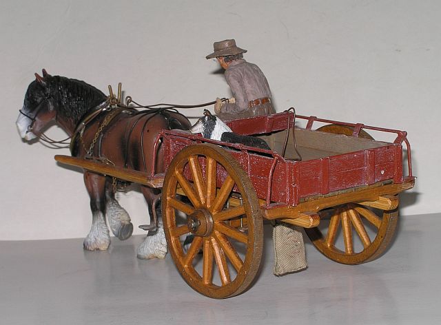

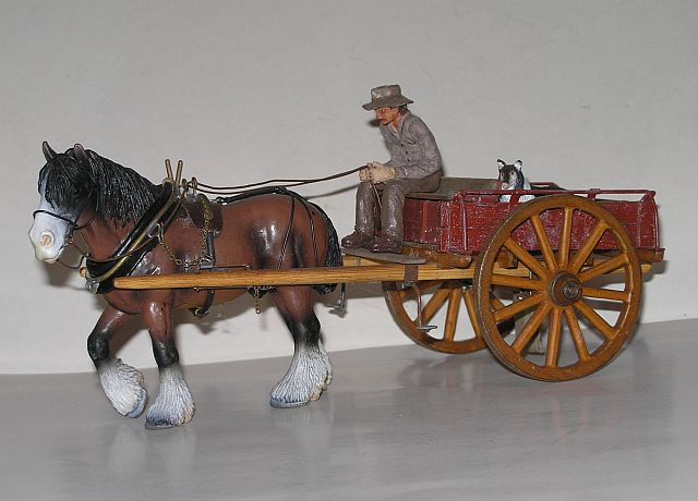

So, next we have a little more horsepower. The dray was built before the Bakers cart, and in order to do the harness,
I used black and brown wire, which unfortunately looks like, well, wire. I hadn't tried the leather with glycerine at this
stage, and wanted reins etc. to sit where I put them. Once again wheels of ply, steel tyres, no springs on these working
drays, only the bend in the seat board.
Horse & Dray 7.JPG (57.76 KiB) Viewed 10668 times
It wouldn't be a dray in Australia without a Cosco Fertilizer bag hung underneath on the axle for the horses nosebag.

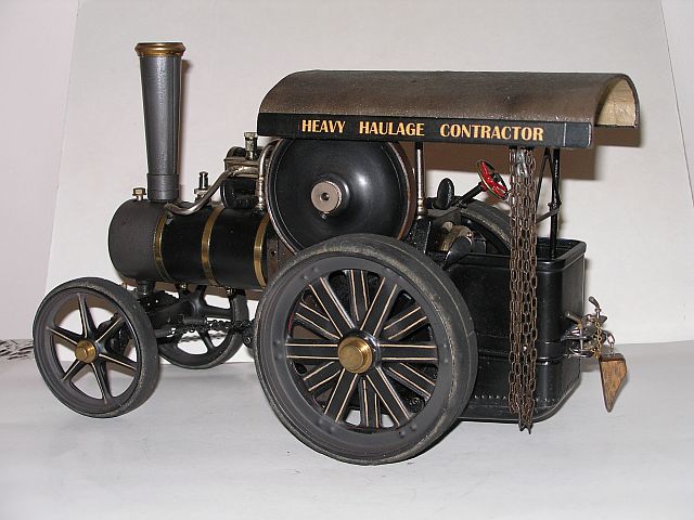

This next one is not for close ups. Its origins are obvious. I measured up a Fowler B6 and found the Wilesco pretty close in
all except width if I remember. Disguised with road tyres, flywheel cover, water tank, scale steering wheel, tow hitches
front and back and a suitable canopy along with loosing the blue colour it might pass at a distance.
Fowler B6 Road Loco.JPG (68.48 KiB) Viewed 10668 times

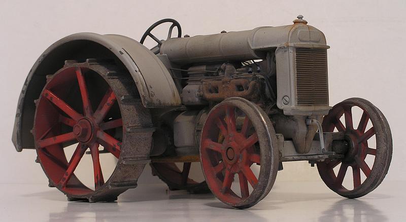

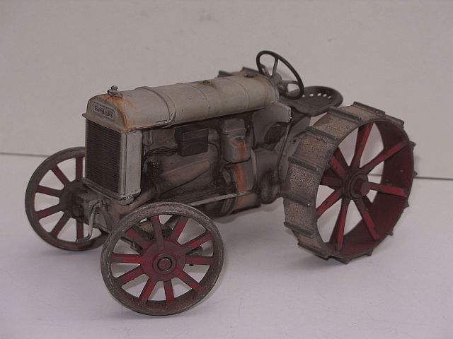

The Fordson has been covered before, much molded on detail removed, to be replaced with separate items, wiring, control
rods, steering wheel, crank handle, and a paint and chip job.
My Fordson Model F Weathered 4.jpg (43.37 KiB) Viewed 10668 times
With guards as they mostly were in Australia, as the guards were to provide some safety when the tractor reared up on its
hind wheels on striking hard ground with a plough. Unlike England our topsoil is measured in inches, not feet.

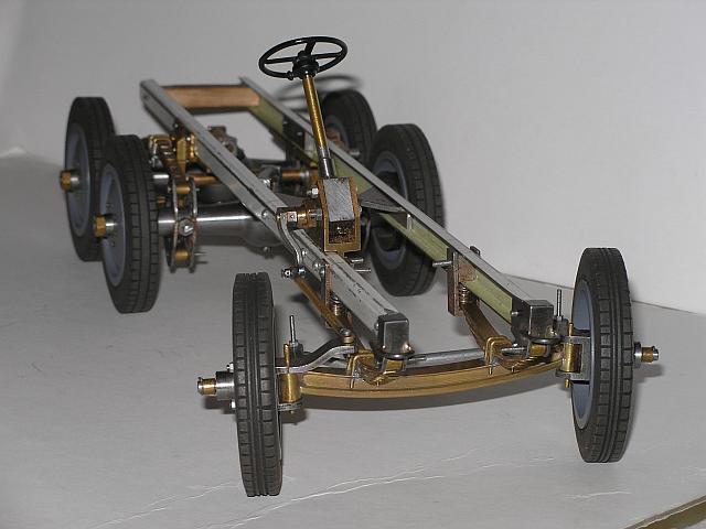

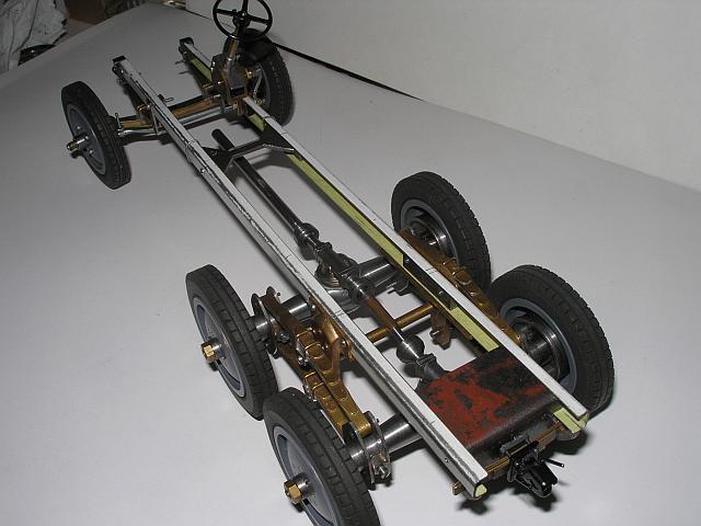

This came about from reading an MOD requirement for an articulated twin axle suspension for trucks.
On finding patent drawings and following it through I was missing something. I started building, and finally found the
missing action of the puzzle. Thornycroft used this suspension, plenty of info on the web re measurements etc. so the pics. tell the story.
Th'croft A5 RSW Model 005A.jpg (33.89 KiB) Viewed 11477 times

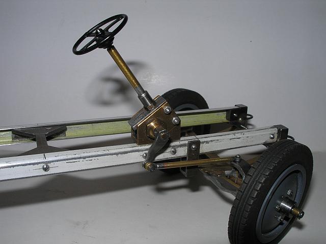

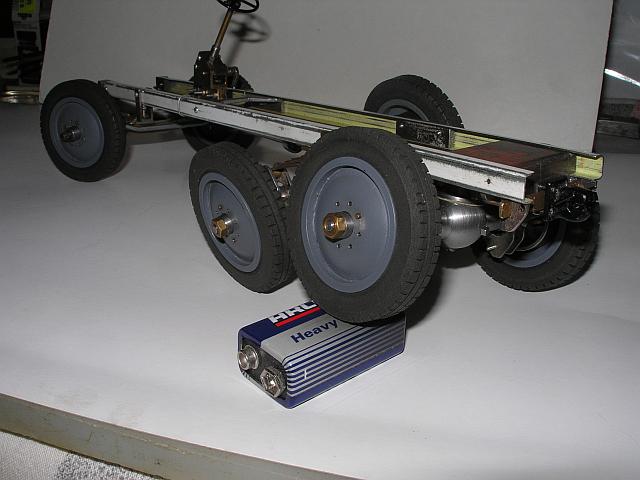

Chassis, steering, front axle ( a piece of brass track) rear diffs and axles set up with tyres machined from plumbing grommets.
Th'croft A5 RSW Model 007A.jpg (30.68 KiB) Viewed 11477 times
Close up of the steering box, drag link etc.

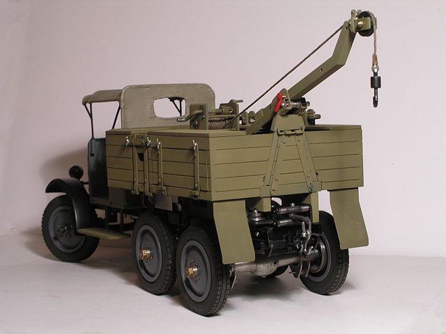

Rear view showing the patent suspension, upper and lower spring sets brake drums prop shafts and the all important gimbals (the missing link)
Th'croft A5 RSW Model 009A.jpg (34.86 KiB) Viewed 11477 times
I actually achieved slightly more articulation than the patent called for as this pic. shows. each axle had to be capable of moving through so
many degrees ( 18deg. I think)with out affecting the other axle.

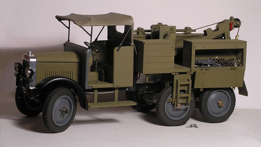

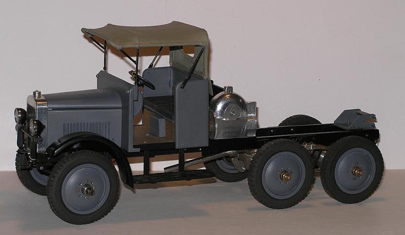

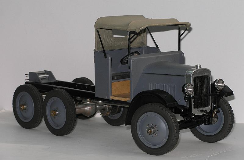

on with body work, starting to look like a truck, hopefully a 1927 Thornycroft A5 RSW (rigid six wheeler)
Th'croft A5 RSW Model 025B.jpg (40.19 KiB) Viewed 11477 times
Building the large winch that the army fitted when these were used as gun tractors (became the Tartar) it's front and rear capable.
Th'croft A5 RSW Model 042.jpg (58.52 KiB) Viewed 11477 times
Jumping ahead in time frame,( my railway) those conversant with these things will know that the body is straight off a WW2 Scammel .
Crane works, full recovery gear, snatch blocks, slings, ground spades, anchors, rigid tow pole and pintle hook all carried in the lockers
or stowed on board.

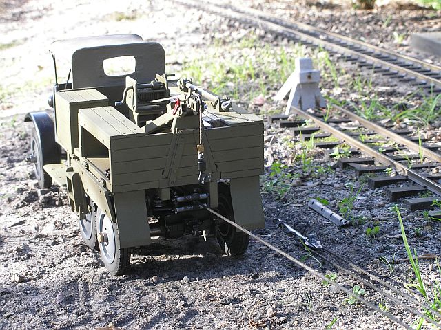

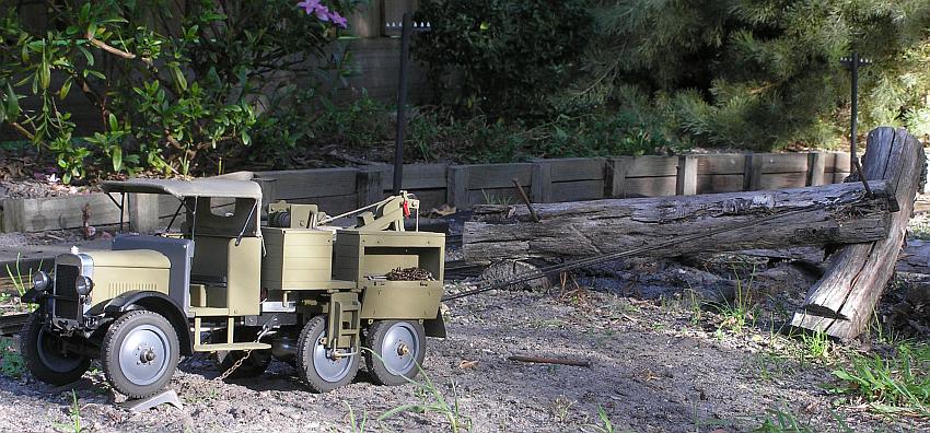

Just to finish off, this is what happens when wanting to see how effective the ground spades were. I set the truck up with a three to one tackle from a ground anchor onto the log skids that used to be at Warringine.
Th'croft A5 RSW Model 048.jpg (122 KiB) Viewed 11349 times
The winch is very slow, and I was running the mechanical loco as well and went to change a set of points.
Th'croft A5 RSW Model 050A.jpg (106.36 KiB) Viewed 11349 times
This is what greeted me when I got back, the ground spades work, and the log skids are no longer.
