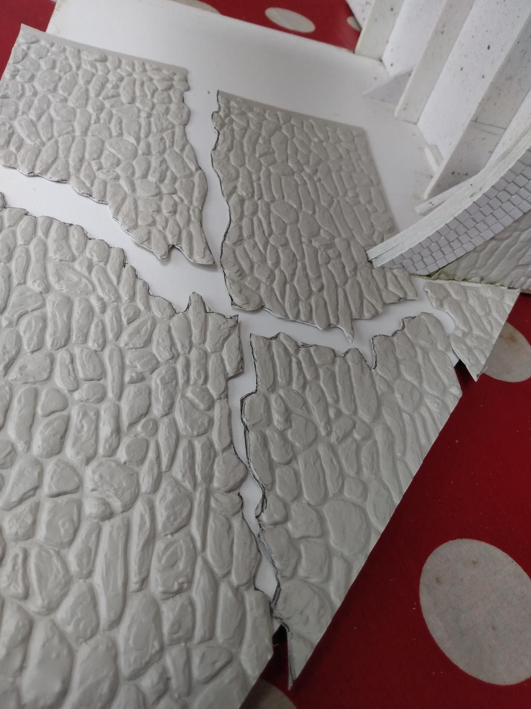

With warmer weather approaching I'm looking forward to running trains semi-regularly, but first I'd like to get the area around the tunnel sorted out - it's currently a complete mess, and it's where the signal box will end up, so both projects are kind of linked.
As reported here, I created the basic shape of the tunnel mouth a while ago, but it hasn't fared well out in the elements. The stone cladding has come unstuck, peeled off and then curled up. I think the problem is that the glue dries really quickly, so it's hard to get enough on a large area. With that in mind I flattened out the old embossed sheet as best I could using boiling water to soften it, then cut it into smaller pieces that are easier to glue.
I did the same on the other wall, which has remained un-clad until now:
That's all glued on now, and the gaps filled, so I'm tidying up and adding a little detail with the Dremel now, then hope to start on the painting...

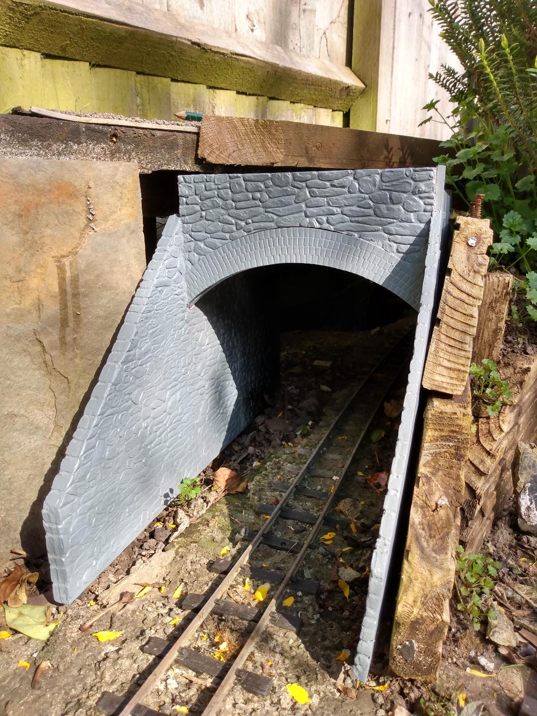

Re: (WH)WHR Buildings
A little more progress - primed and temporarily back in place prior to final painting:

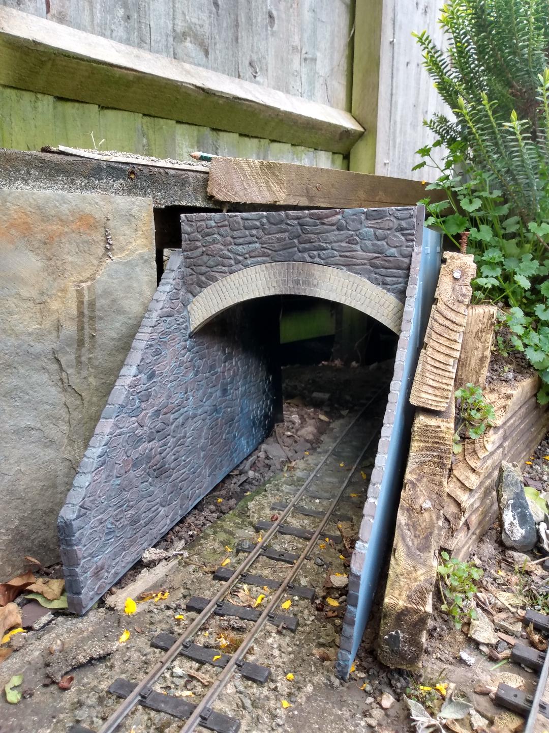

Evening all,
I finished the paint job on the tunnel mouth this afternoon, so it's now back out in the garden awaiting a little landscaping and planting to soften things a little:
On the whole I'm pleased with how it's turned out. Ideally I'd have had a bit more space to work with, the constraints of the site having restricted what I could do design-wise, but I managed to squeeze in some NWNGR features, and when the area's all planted up it should just become part of the landscape...
