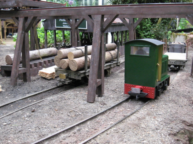

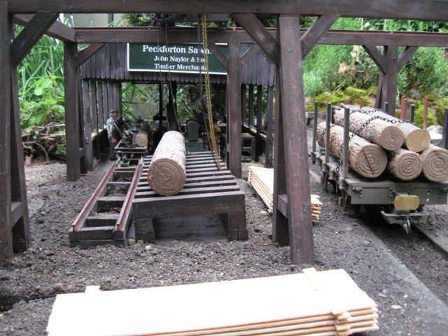

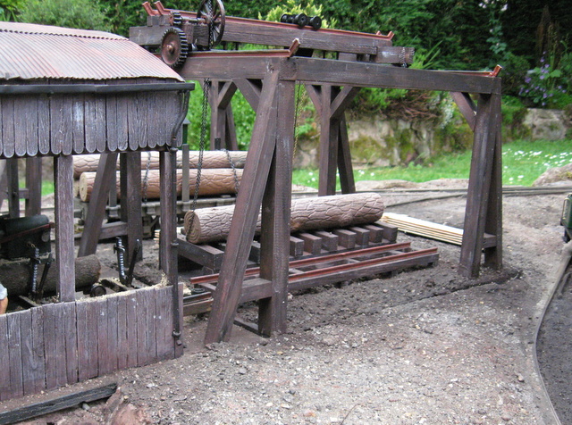

More or less finished the landscaping and re-ballasting of the station area so here are a few pix of the sawmill and gantry crane in their natural setting.
A view from the end of the sawmill sidings.
The HGLW loco seems quite at home pottering around the sidings moving wagons under the gantry as needed.
View from the head of the sidings.
Moving in a bit closer. I need a few more stacks of sawn timber and a fair bit more clutter to finish off the scene.
The boilerhouse for the mill engine will eventually be placed in the bottom left of this pic.

I think I've run out of superlatives now, but you deserve all of them. Fantastic!
Next time you have the camera out, a distant view showing it in context would be good, please.
Posts: 5717
Re: Peckforton sawmill
Post by Peter Butler » Sat Jun 02, 2018 8:54 pm
Just wonderful... it looks so well placed and functional. The detailing would be hard to fault as you have clearly thought of every operation in the process of machining logs into planks..... Exceptional!

ge_rik wrote: Sat Jun 02, 2018 6:08 pm More or less finished the landscaping and re-ballasting of the station area so here are a few pix of the sawmill and gantry crane in their natural setting.
Am I looking at a real scene ? can't distinguish anymore.

Rik this is brilliant and far from anything I will ever achieve as I would of lost interest and moved onto something else. Using real wood for structures outside makes all difference.
I feel like an bottom saying this though but those plastic logs are the only negative for me as they look like they belong in a Playmobil scene.
Have you got a local wood you can go and grab some dead wood from the ground and cut up? You can then scatter the sawdust around the timber yard.
Posts: 8005
Post by ge_rik » Sun Jun 03, 2018 5:22 pm
tom_tom_go wrote: Sun Jun 03, 2018 4:40 pm I feel like an bottom saying this though but those plastic logs are the only negative for me as they look like they belong in a Playmobil scene.
Hi Tom
I'd like to improve their appearance, sure. Their advantage is they are lightweight for wagon loads and weatherproof. I have tried various branches and twigs, but I find that if I leave them outside for a couple of months, the bark falls off and they end up looking,....... well, like twigs. I could probably use a couple on the loading platform for the saw carriage (underneath the gantry) as I take that inside when not in use, but I would like to have some permanent stacks of logs left outside.
If anyone knows of branches which have bark which is weatherproof, the please let me know. I'm sure I'm not the only one with this problem.
