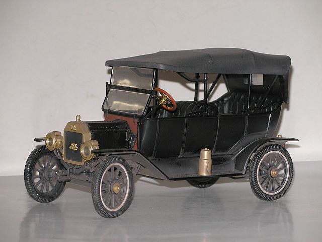

Another vehicle easy to get in several forms, and the most popular on our roads of the day, the ubiquitous T Model Ford.
Ford T Tourer 3.JPG (54.25 KiB) Viewed 9227 times
This one in standard 4 door tourer form.

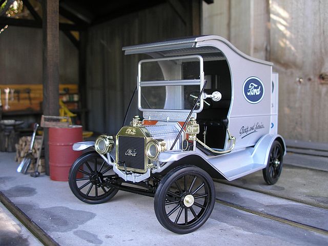

Another version.
Ford T Van as bought 1.jpg (72.94 KiB) Viewed 9227 times

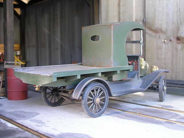

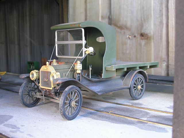

Now if you remove the body (iridescent silver in 1929?) and build a metal cab with wooden tray you get this.
Ford T Truck 1.jpg (62.05 KiB) Viewed 9227 times
Ford T Truck 2.jpg (63.11 KiB) Viewed 9227 times

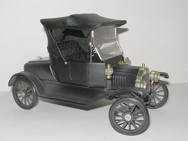

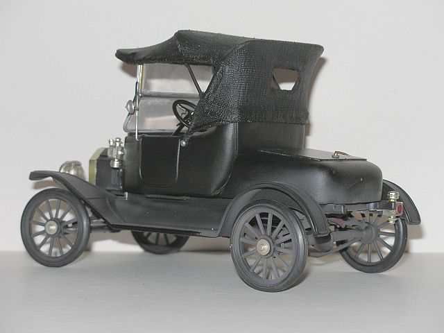

So you buy another one, remove body, panel up a 2door coupe body with boot, metal hood frame with "leather" from an
old Lycra cycling suit and a carved wooden seat, and you get this.
Ford T 3.jpg (55.2 KiB) Viewed 9227 times
Ford T 2.jpg (49.74 KiB) Viewed 9227 times
And you still have two van type bodies left over. More on that next.

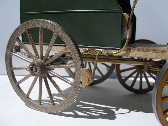

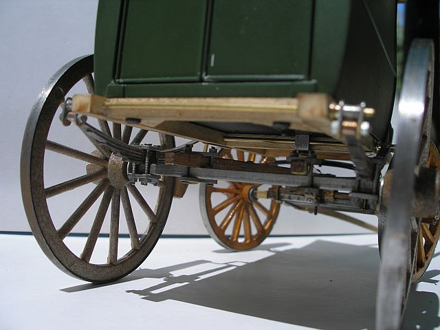

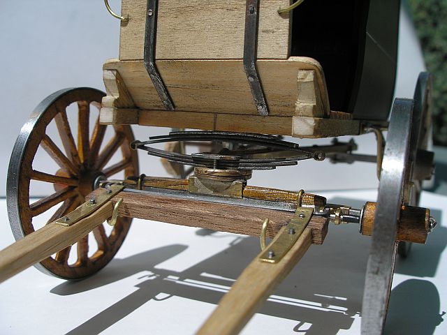

An advantage of my time frame is that there was still many horse drawn vehicles around, so as I had van bodies and two pairs of plastic spoked wheels some research revealed a bakers cart with a very similar style. It required a pair of smaller diameter wheels for the fore carriage so these were fretted out of ply, spokes rounded and steel tyres made and fitted to all four. A timber reach frame with fore and aft semi elliptic leaves (working shackles) at the rear, a fifth wheel at the front with transverse double elliptics, removeable shafts carved from bamboo gave me a platform to build a body chassis with footboard and brakes.
Bakers Cart Log 006.jpg (61.36 KiB) Viewed 10284 times
An underneath view showing the reach frame and rear spring axle set-up.
Bakers Cart Log 004.jpg (72.89 KiB) Viewed 10284 times
Front view of the fore carriage, fifth wheel and springs.
Bakers Cart Log 005.jpg (67.37 KiB) Viewed 10284 times
Body fitted, hand brake assembled, plastic wheel to rear.(temporary pin!)

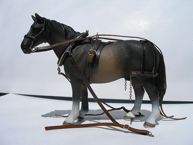

Next choosing a suitable horse (Schleich Hanoverian Stallion) the making of harness could begin. I still have a few pieces of real harness hanging in the workshop, bit of a soft spot with me. Collar, bridle and bit, reins, trace and breaching straps were made out of very thin leather being rubbed with glycerine to make it subtle. Hames, buckles and hame hooks from wire completed the outfit.
Bakers Cart Log 008.jpg (56.35 KiB) Viewed 10284 times

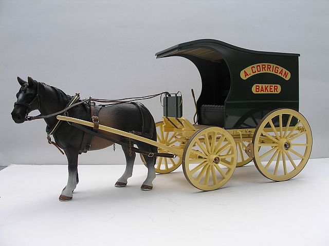

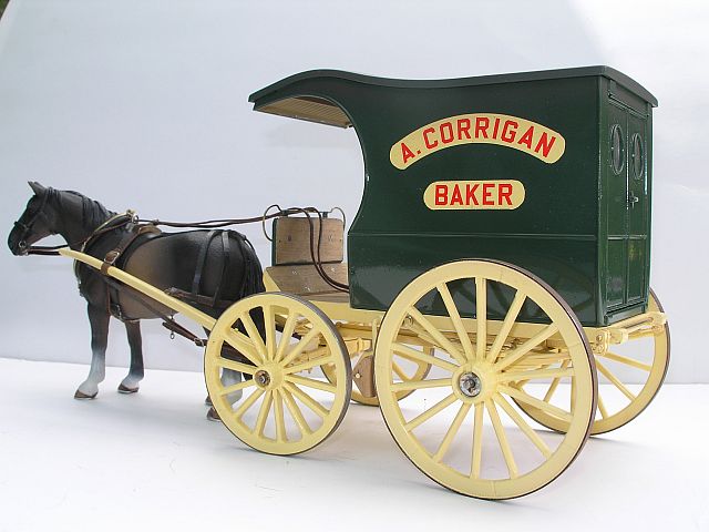

Horse with all the gear laid out. Traces not cut to length yet.
Some paint, decals and the completed Bakers cart before a light weathering.
bakers Cart Log 016.jpg (53.53 KiB) Viewed 10284 times
Bakers Cart Log 017.jpg (62.04 KiB) Viewed 10284 times

by LNR
Thank you Dave. :oops:
For the tyres, just a matter of measuring wheel circumference, add a smidgen (Blacksmithing term) then cut steel strip and beat into a circle on redgum block (I don't have bending rolls) and silver solder the ends together. Beat it again over steel round, check size (hopefully only having to subtract not add) then press on. I run them on concrete vigorously to give a nice matt steel look.
Grant
