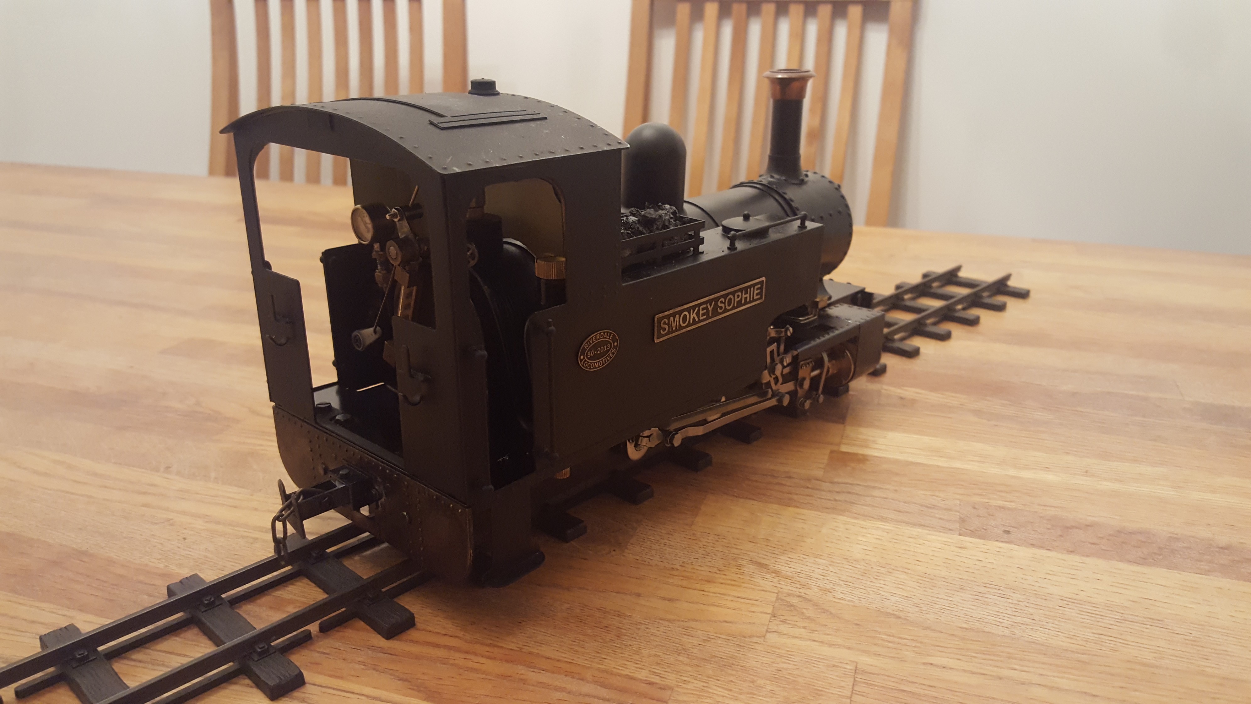

Thanks for the comments, she is finally coming together.
The name/works plates were a bit too shiny given the appearance of the loco so I chemically blacken them slightly and now they fit in just right:
You will also notice the cut down running boards with mechanical lubricator and leaf spring detail. As I cut down the front buffer beam on my locos Locoworks sold me only part of the running boards I needed (cheaper as well, which is nice).
Just need to finish fitting the coupler to the rear buffer beam then get both weathered for it to be finished enough for her to earn her keep on the railway.
If the Lady Anne slomo fits and given by the photos on SSP's website I don't see why it would not then I will be fitting one of these as well.

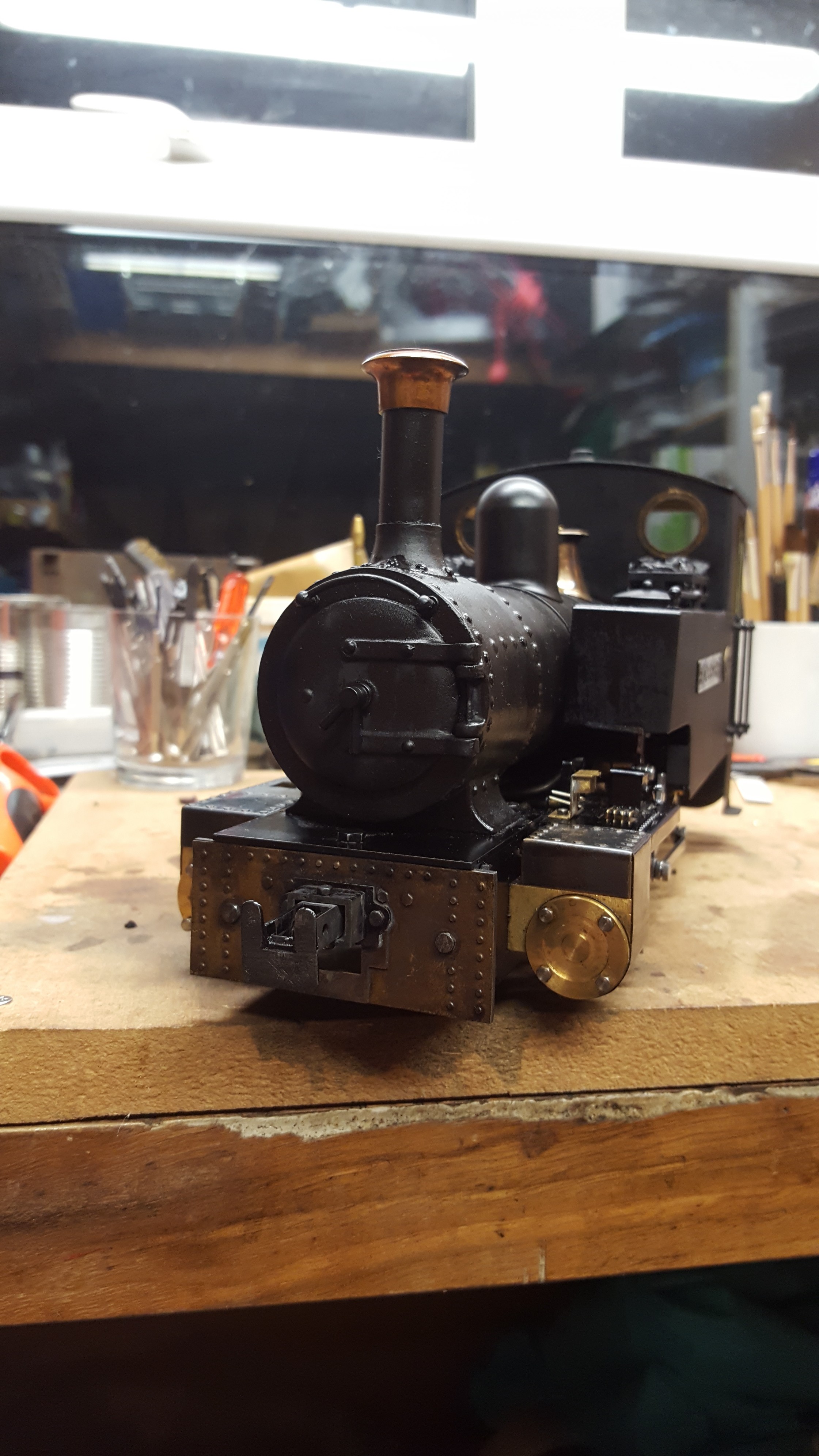

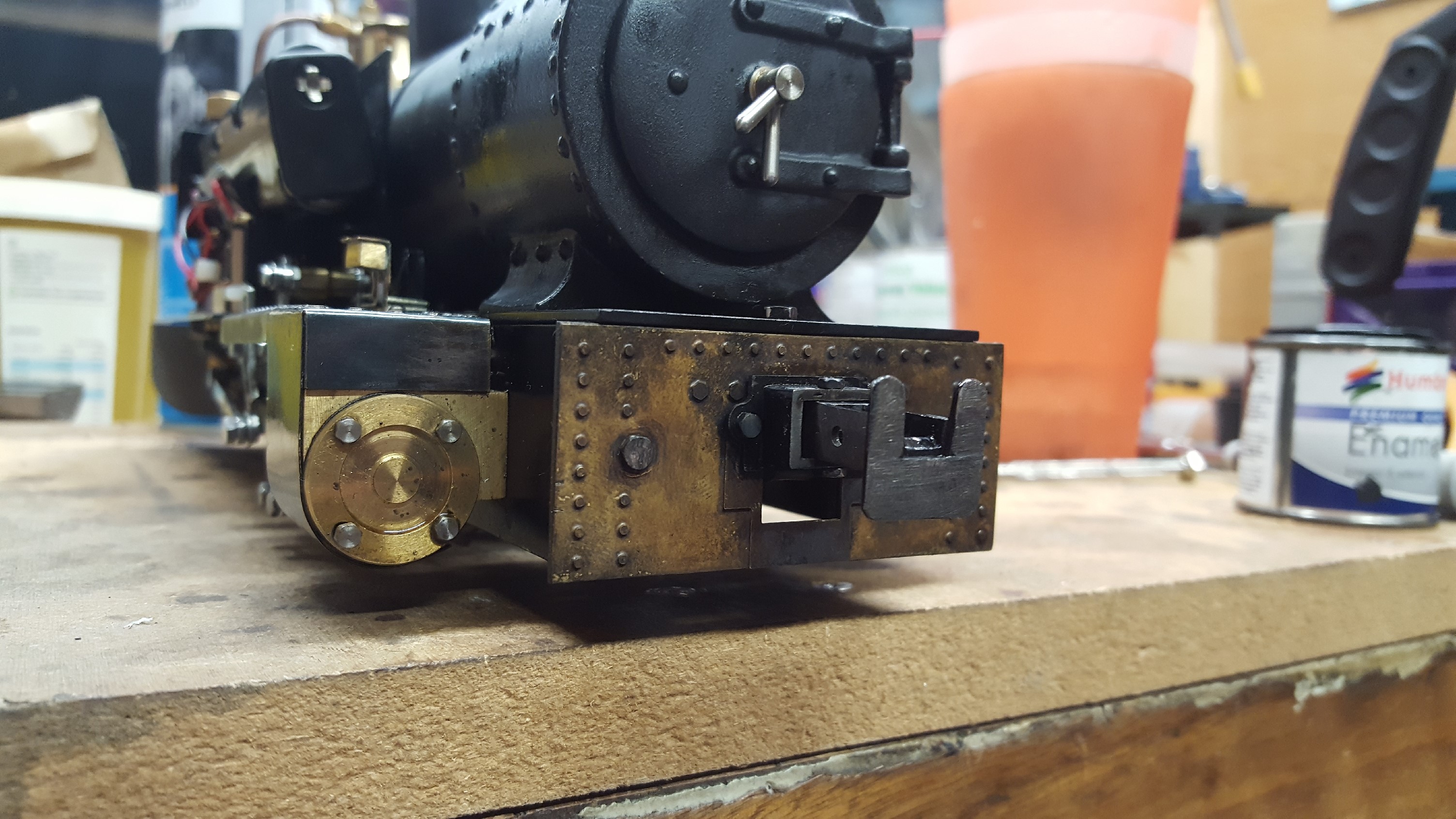

I have procrastinated about what colour to paint the buffer beams for a while now. As the loco is entirely black I have come to like the contrasting yellow brass colour but they needed weathering so rather than trying to mix paints and buy a spray gun I used chemical blackening which in 15 minutes ended up like this:
20171031_204142 (2).jpg (948.11 KiB) Viewed 16154 times
Very tempted now to go to town on the cylinders and running gear with the chemicals!

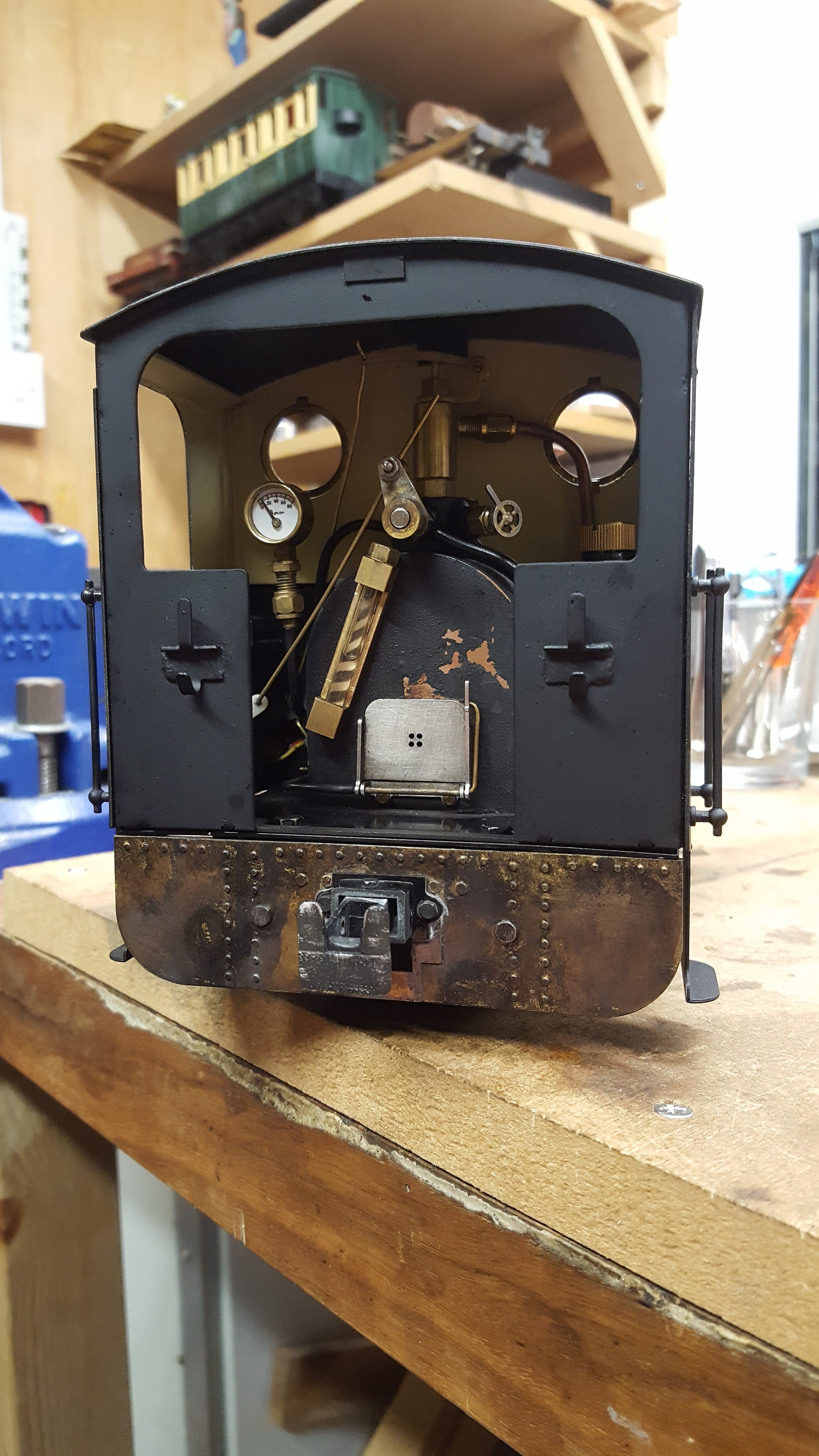

More chemical fun, this time on the cab windows and the safety valve bonnet:
The polished smokebox dart had to go:
Rear buffer beam all dirty now:

Very good, i like how it affects different areas slightly differently - very prototypical
