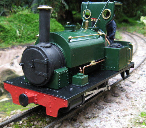

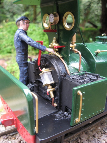

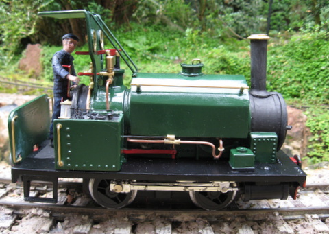

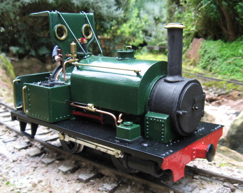

Part 12a (for the superstitious) - Final(?) detailing
Very nearly there......!!!
Most of the pipework has now been added. I've decided to omit some of the thinner oiling pipes which spider across the running board but quite pleased with the pipework around the safety valves and whistle. Slightly simplified from the original but looks OK.

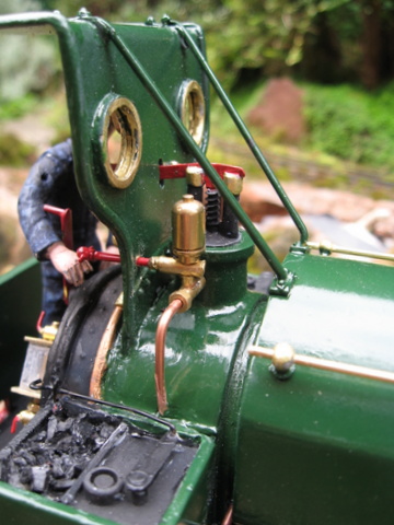

As the cab interior is very much on view, I spent a while constructing the water level gauge from bits and pieces. It's slightly overscale, but I can live with that. The pressure gauge dial is a photo of a real gauge reduced in size.
Just given her a small test run and she seems to perform OK with all the gubbins on....
Just noticed that I need still need to install a brake standard and reversing lever in the cab. Slightly less space than on the real thing as the firebox is somewhat wider - but no doubt will find somewhere for them.
She needs a number on the bunker sides and buffer beams and I need to order some nameplates and makers plates from Narrow Planet - then give her a couple of final coats of varnish - then I think she'll be ready to roll!

Great detailing - my fav is the water gauge - what did the glass section start life as? a square biro case?
Posts: 8004
Re: Otto bash
Post by ge_rik » Thu Sep 07, 2017 7:41 am
markoteal wrote: Thu Sep 07, 2017 7:11 am Great detailing - my fav is the water gauge - what did the glass section start life as? a square biro case?
Hi Mark
I cut two corners from the top of a pack of cocktail sticks. It was all quite serendipitous - I usually have a pack of cocktail sticks on my workbench - handy for applying small quantities of superglue and, just as I decided to make the water gauge, the top of the pack happened to be sitting on the work bench. A couple of deft slices with the razor saw, chamfering with a file, a dab of superglue with a cocktail stick, and the body of the gauge was done!
