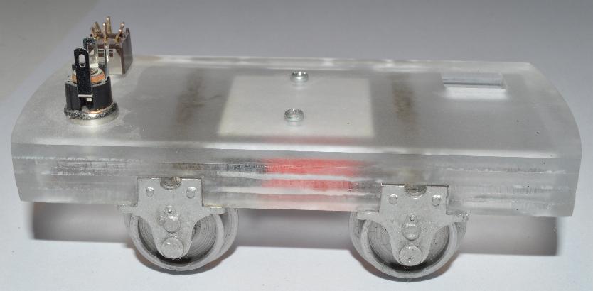

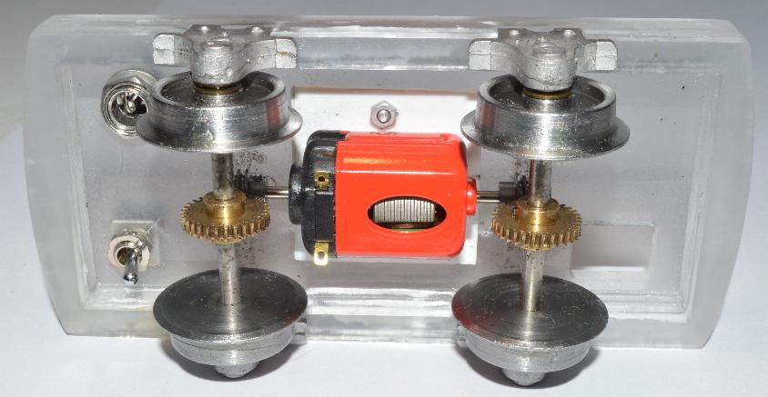

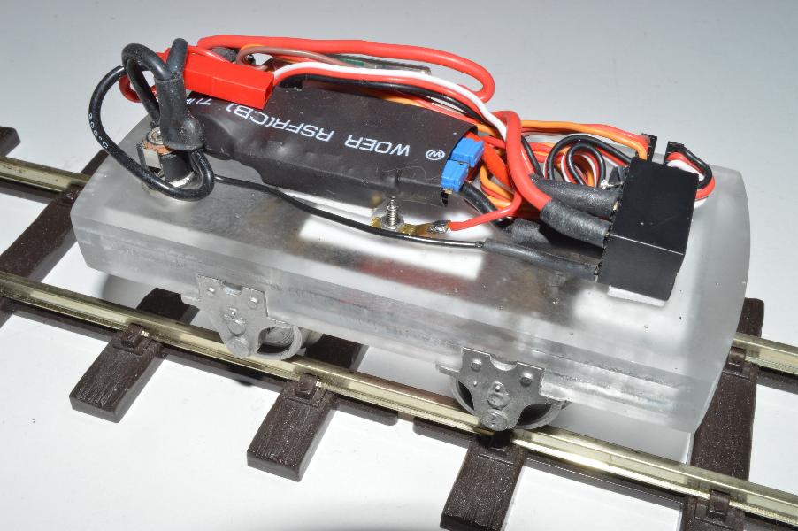

With the CAD drawn up for the chassis, it was decided that 4WD would be essential, so a suitable motor
was sourced from the local model shop. The motor is 12 volt and the type used in slot cars with a shaft at each end
this made it perfect for 2 axle drive via 30:1 ratio Cambrian gears.

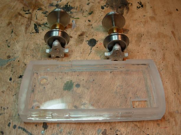

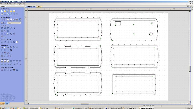

The chassis was made from 1/8" acrylic, actually an old car number plate, and cut out on a CNC router.
The wheels, axles and axle boxed are IP engineering.
Then for a variety of reasons the whole project came to a halt, but 20 months later I have managed to get around to
finishing it.

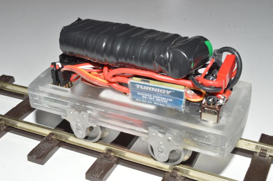

As I'm a great believer in "If there's a difficult way to do it then that's the way it should be done" I decided that the
power unit should be radio controlled, with 2 channels, for speed and forward/reverse, after all if it's anti-gravity then
it may as well go backwards as well.
Things were a bit of a squeeze especially as I decided to go for a 6 volt NIMH battery with an on-board charging socket.

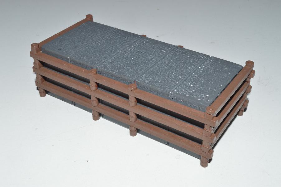

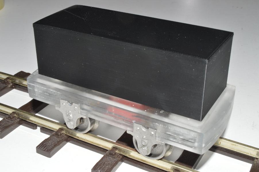

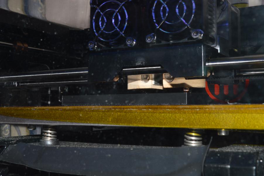

But it doesn't look much like a slate wagon yet, so the next thing was to 3D print a cover for the electronics which could
be made to look like a dummy slate load.

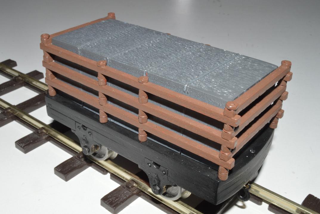

To finish the cover off, I used a soldering iron to melt the plastic to give the effect of slates and made a slate wagon
wooden body on the laser cutter.
Finally the 2 pieces were painted and assembled to form the body of the power unit.
So I now have the makings of my train, with 3 scratch built and 4 Binnie slate wagons, the next part of the project is to make
