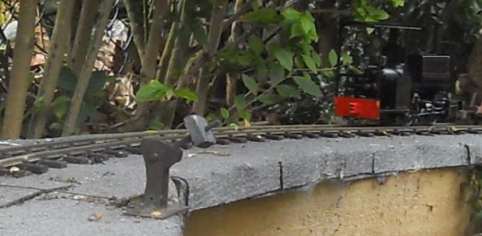

I have a couple of weighted levers which came from Keith Bucklitch's line a couple of years ago - very effective they are. Dave Watkins of this forum also has some of basically the same design, which was written up by John Oliveria in 16mm Today No. 25.
It's a bit dark and wet just now to go and take a photo, but here's a cruelly resized screengrab from a recent video which should give the idea. The points need to be pretty free moving for these - regular oiling from the S&T gang - but with that done pretty much everything except the lightest of slate wagons and tippers trails through safely.

Don't worry the screen shot is quite clear enough. And yes, that is the sort of thing I have in mind. The main matter that needs attending to is the loop that divides the S&CLR into two sections. A lot of the time the long section staff is in use, so it makes sense to lock the 'up' side OOU so all trains use the 'building side' or 'down' platform. Going through right handed means that trains have to negotiate not just facing loop points, but the goods siding is facing when one uses the platform line wrong line. I would be a lot happier with a weighed lever on both of those, as I do not facing making FLPs and the present sprung arrangement is, to be polite, cumbersome and unsightly. I am not going to tell you what I really think as there may be under-14s reading!

What may not be totally clear from the photo is that there are three bits here: the stand, the Y shaped bit that pivots in the stand and drives the point blades, and the lever and weight that also pivots in the stand and moves the Y shaped bit.
The dimensions seem fairly critical (at least, one of mine works rather better than the other, and there seems to be more to it than just the weight and how free-moving the point blades are) so I will try to take some dimensions in due course.
