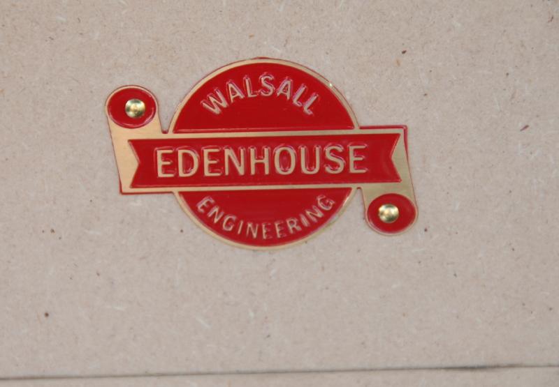

It came in an attractive carrier box with very classy leatherwork and the makers logo on the front . Inside was the locomotive, a user manual, Boiler certificate, shovel, fluebrush and rectus valve male tip for water topping.

Back to my loco, please pardon the dirt/ash particles and grime in the photos as they were taken after my attempt to fire it up on coal which i must confess could have gone more elegantly.
