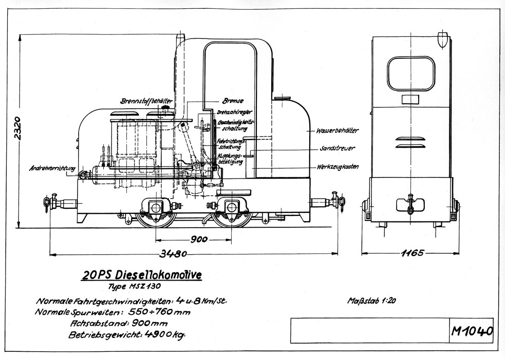

Why does it remind me of a motorised shoe?
PS Nice to see they've provided a drawing

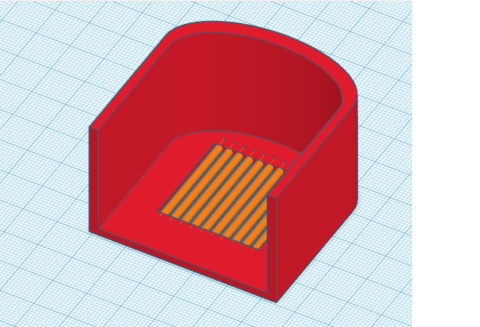

As I've got the HGLW loco as a starting point, I'm just designing and printing the parts I need to modify it.
Tink bonnet.jpg (176.99 KiB) Viewed 45067 times

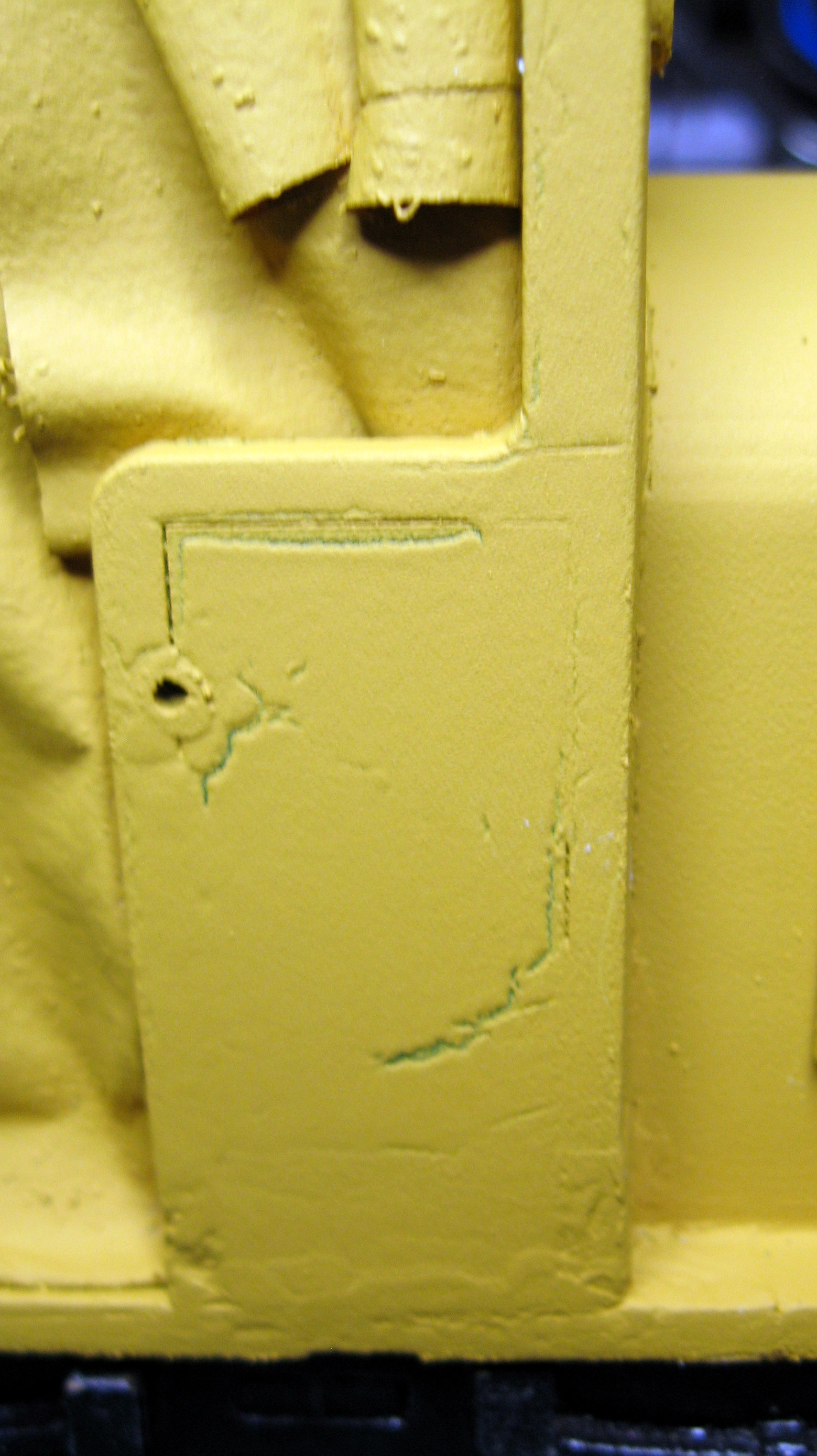

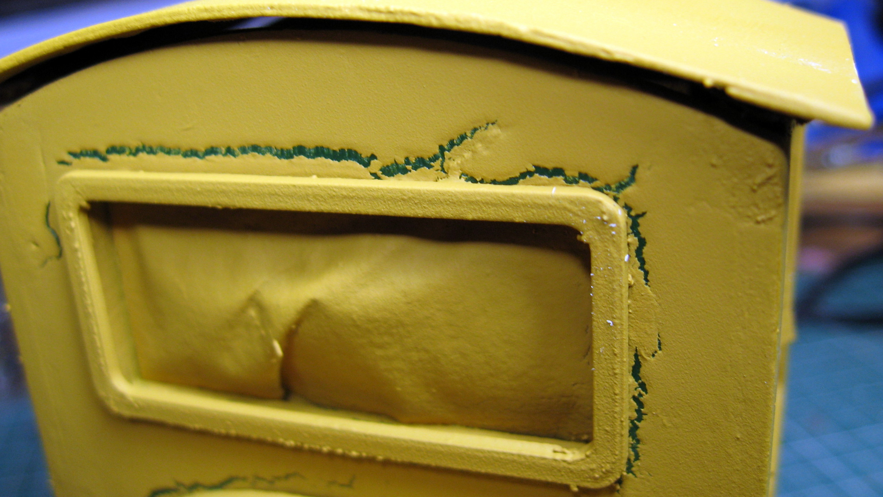

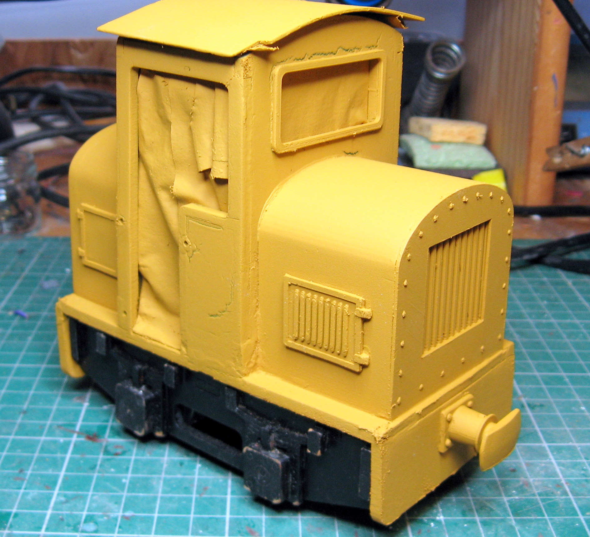

OK. So things are progressing, albeit slowly.
After looking closely at the photo of the prototype loco, it was apparent that the cab isn't central and so, I decided to move the cab on the HGLW loco back by around 15mm. This required a considerable amount of hacking with razor saw and Stanley knife. The bonnets were duly modified and printed out. These were attached, together with window frames and the model given a couple of coats of Halfords plastic filler primer. So far so good.
However, when the primer dried, I discovered it has reacted badly with whatever was used to paint the loco previously.
So, it's going to require a lot more filling and sanding.
In many ways, it would have been a lot simpler to have 3D printed the whole body - but (like TV's Repair Shop) I wanted to retain as much of the original as possible. Ho hummmm ......

ge_rik wrote: Wed Feb 28, 2024 9:15 am
I love The Repair Shop. always keep as much as you can :thumbup:
I have had this a number of times spraying over old paint. Unless you manage to remove it all, unfortunately I fear it might keep reacting. :oops:
Posts: 8004
Re: HGLW loco tweak
Post by ge_rik » Wed Feb 28, 2024 12:06 pm
-steves- wrote: Wed Feb 28, 2024 11:25 am I have had this a number of times spraying over old paint. Unless you manage to remove it all, unfortunately I fear it might keep reacting. :oops:
Me too. I've usually got around it by filling and rubbing down the affected areas, but it's always a bit of a gamble.
If all else fails, I'll just 3D print the whole body.

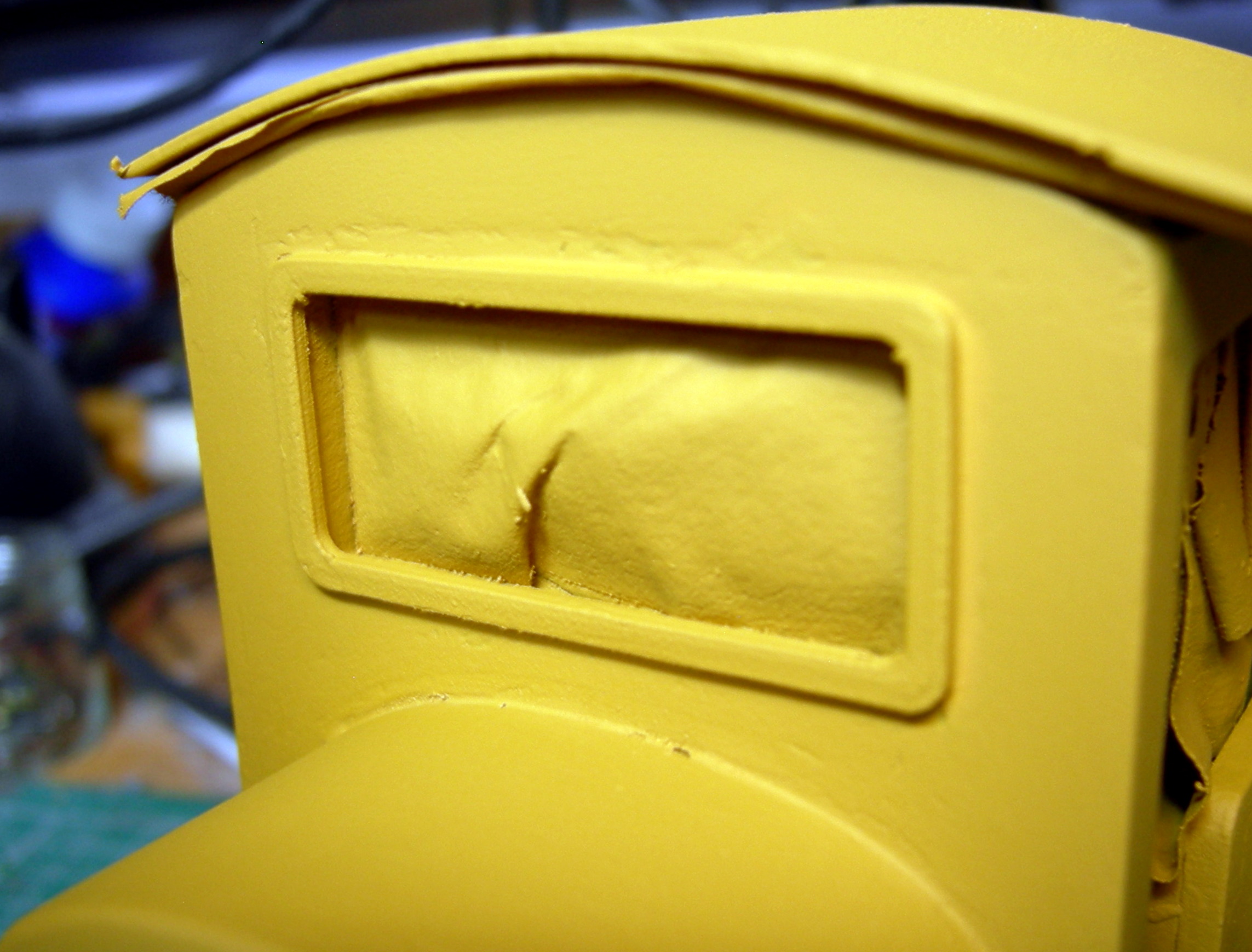

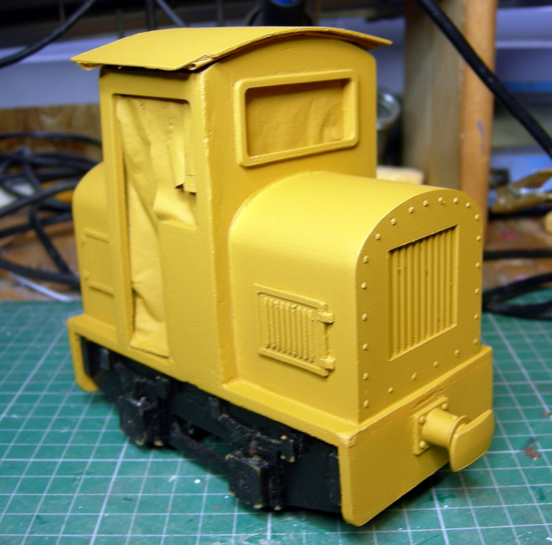

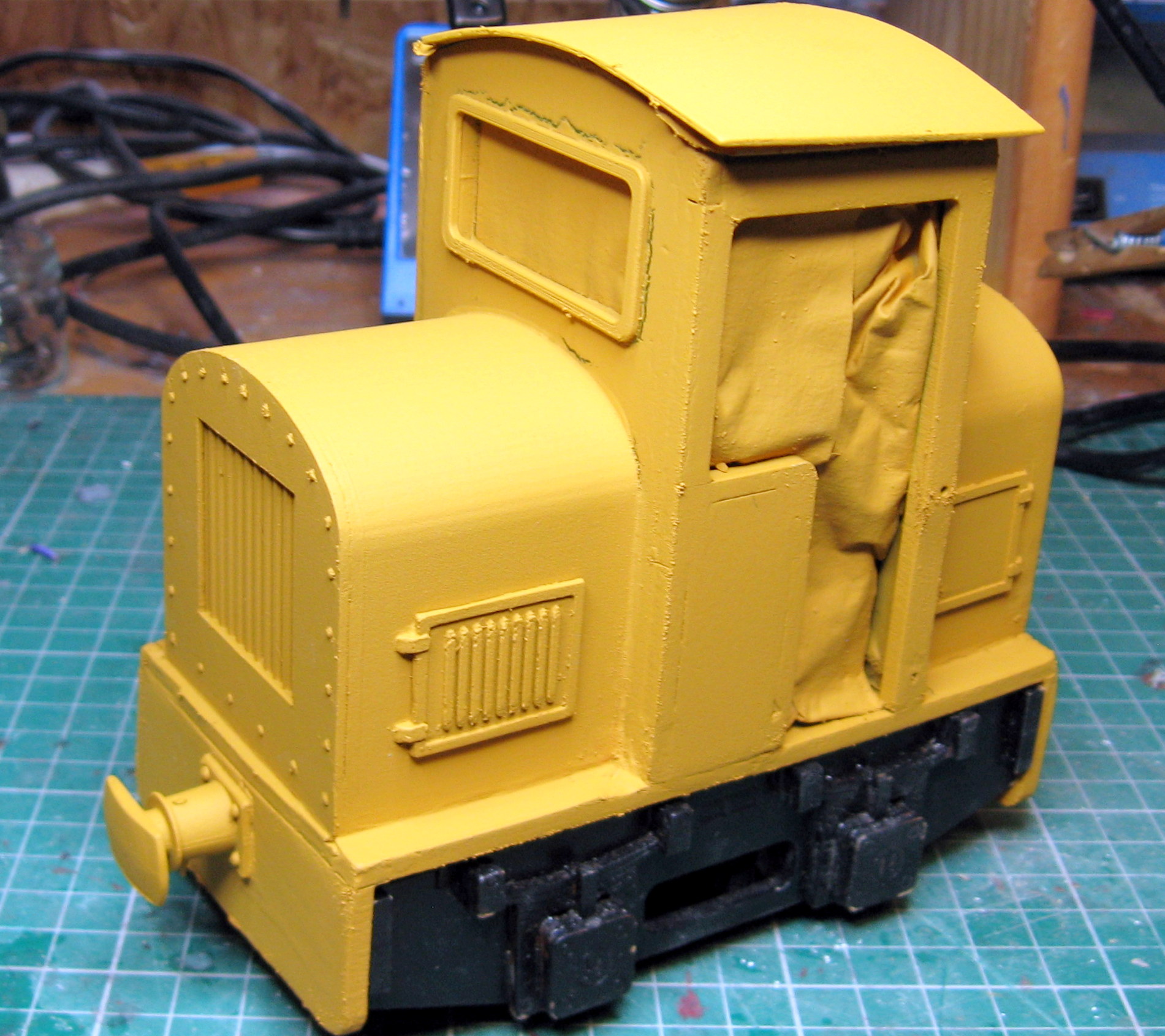

Posts: 8004
Re: HGLW loco tweak
Post by ge_rik » Wed Feb 28, 2024 4:19 pm

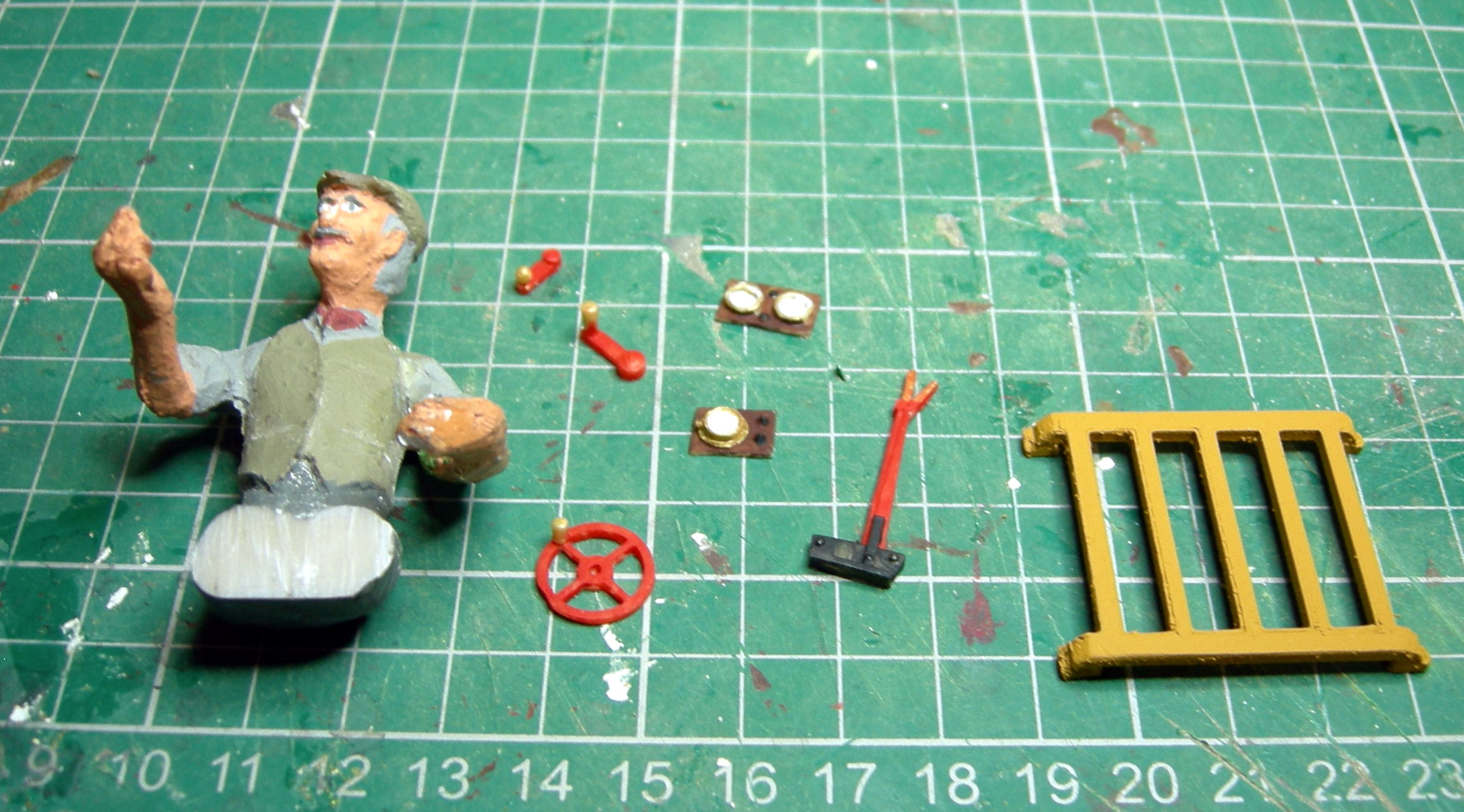

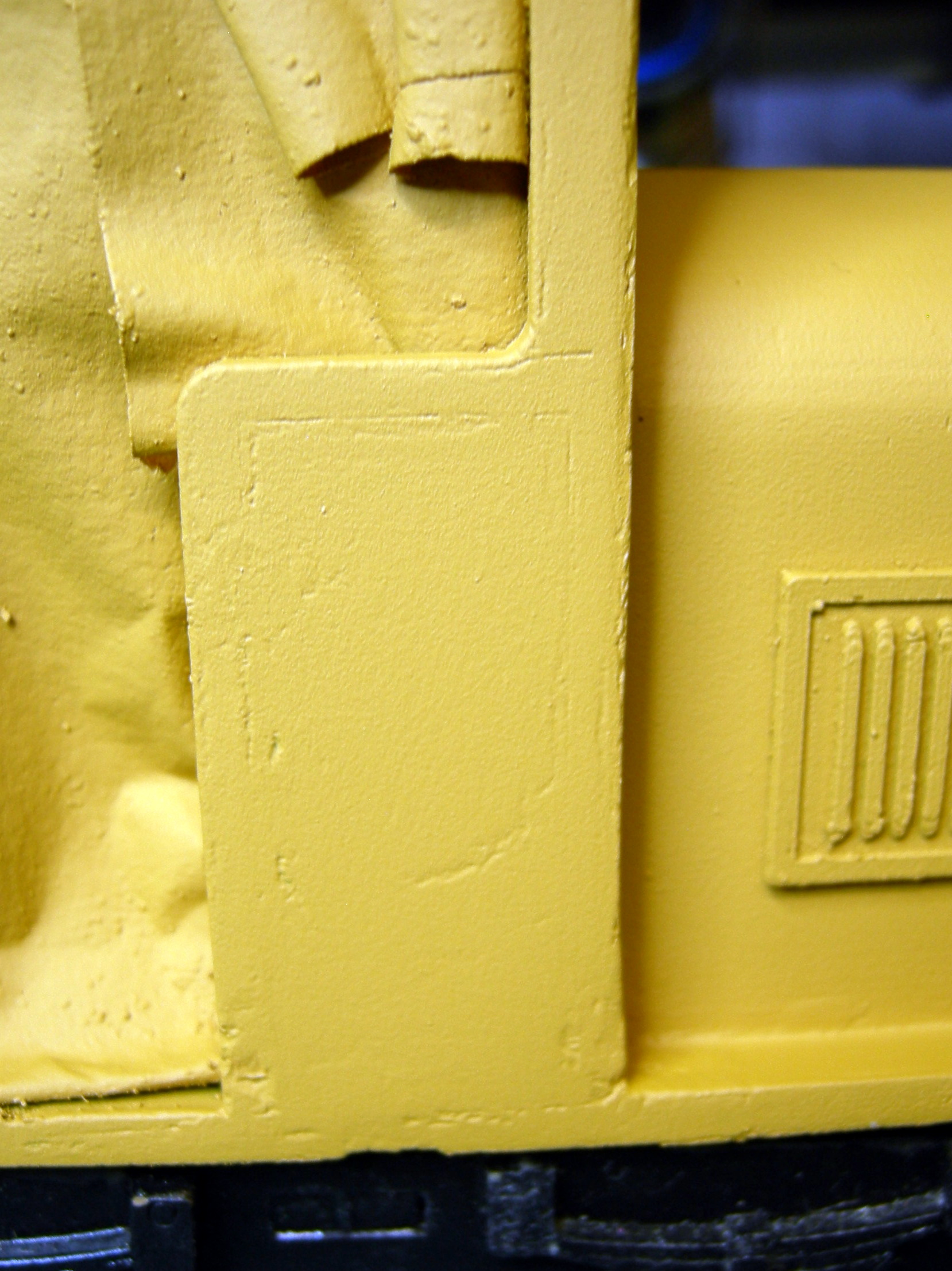

I've now done a bit of remedial work.
Still some small areas of filling and flatting to be done, but the worst crevasses seem to have gone.
In the meantime, I've been painting some of the cab interior detailing. Sorry about the major surgery to the driver, but it's the only way I can fit him in.
