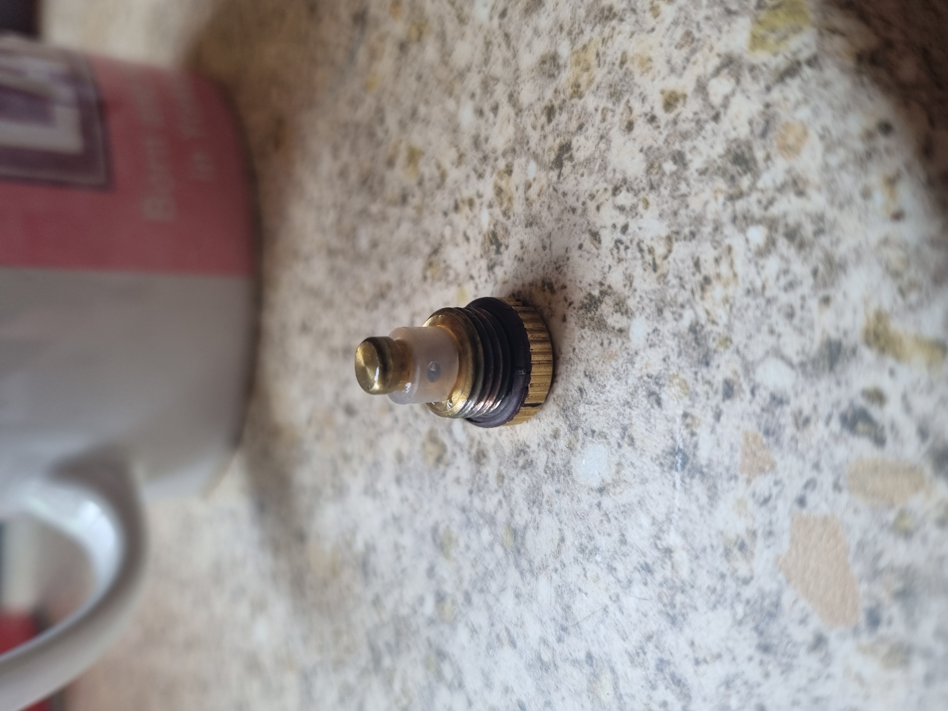

Any chance you can post a pic of how short you cut the tubing on the valve? I'll try the same!

An observation on the Goodall Valve pictured. Does the hole in the valve go all the way through the valve body? The water should have 2 openings at the bottom of the valve for the water to pass through. Accucraft's Goodall valves use this arrangent. I have bought an aftermarket unit and it was not drilled through. By only having one opening it made the required pumping pressure from the pump bottle much harder. I drilled the valve body and it helped greatly. Might take a look and see if this was done. I have 10 engines, and all have the Goodall valve cross drilled and they work great.
The tubing as shown should be shorter and not be over the bottom edge of the valve.

Ted,
Here's a picture of the modification I did to the silicone tubing.
Hopefully it helps.
Hopefully it helps.

Hey Simon. Are you able to pump water through your Goodall valve with the valve removed from the boiler, as in the pic? I've cut the tubing on mine to a similar length to yours, but still can't get any water through it with a syringe. It just seems to me like the tubing fits too tightly around the valve body. Then it occurs to me that perhaps, when hot, the tubing is more pliable and allows water through more easily? I wont get to steam mine until next weekend at least, so curious if yours works "ex-vivo" so to speak?

I've never done it with the goodall removed from the boiler since I did the mod. What I did was take advice & buy a proper water refill bottle. The one I ordered was a regner one which is still to arrive.
I have managed to get my roundhouse bottle to fill the boiler though so to speak. I cut the end of my filler bottle which is a good few years old as the pipe end had warped a bit with the heat of live steam boilers. It's still not perfect & does give a spray back from the goodall but it is filling the boiler also. I know because when the safety valve starts feathering & I fill water its stopping the feathering of steam plus the gauge glass is moving.
When the regner bottle arrives I will do another test to see if it works any better. I have picked up this with GRS, personally I think its a poorly designed goodall valve & could do with refinements especially as the model is in accucraft territory regarding price.

My issues with the Goodall valve were completely resolved with replacement tubing from GRS and a Regner filling bottle from The Train Department in the US. The loco has run fantastically every time I had it out, with the exception of last week, when the performance seemed to have dropped. Running seemed 'lumpy' and pulling power was greatly reduced. I suspect the timing has slipped somewhat, as I also note that there is significant movement of the valves, even in mid-gear, which doesn't seem right to me. I've emailed GRS to see if there's instructions to check/reset the valve timing available.

I just purchased a similar machine so I add some of my thoughts here. My GRS Hunslet is second hand so it is run-in already. The goodall valve did not work in my case also but thanks to this thread I cut the short silicone tube in the valve shorter and now it seems to work with the Regner bottle. Keeping the filler tube in place is still a bit tricky though, some of the water shooting back when filling. I have not measured precisely, but I think the boiler capacity is around 120 ml maybe somebody has measured it bettter?
