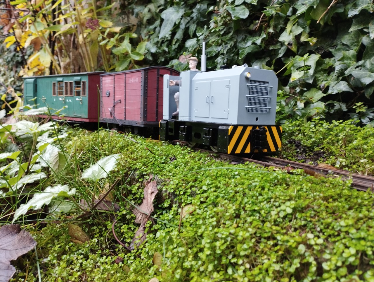

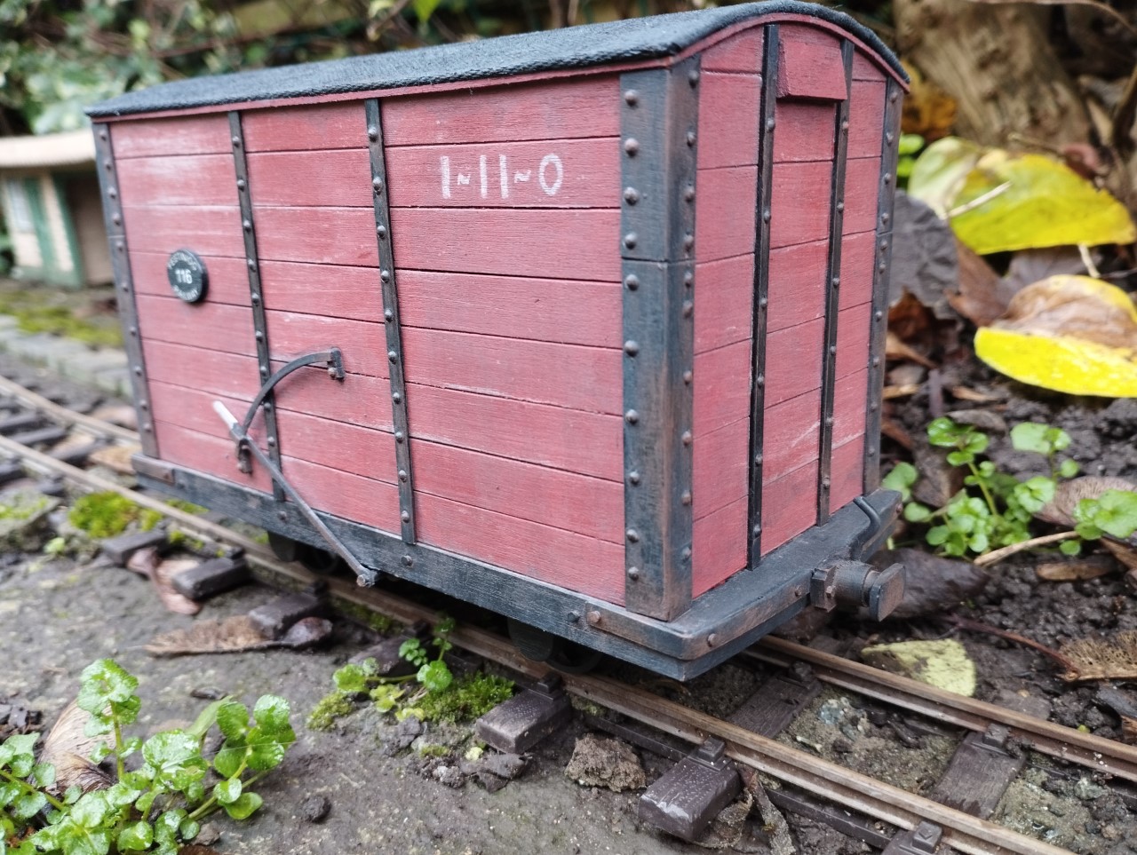

Back before I was distracted by the coal truck, I was distracted by an "H Jones Engineering" kit for the Ffestiniog van currently numbered 99, which was originally 116.
I've built the kit into what I hope is the van's 20s/30s guise, in the process embellishing it with individual plank overlays and rivets, swapping some of the strapping for chunkier alternatives, and adding some extra brake detail.
Here it is posing for its official photograph, and then going for a quick test run...

I like the subtle weathering
Re: (WH)WHR Rolling Stock
Post by Andrew » Fri Dec 02, 2022 11:19 am
ge_rik wrote: Fri Dec 02, 2022 7:56 am I like the subtle weathering
Thanks Rik - I wanted to go for "work worn" rather than "worn out" with this one...

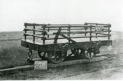

Inspired by JMORG of this forum, indeed by his words on this very thread, I'm having a go at using a couple of Lineside Hut slate wagon kits to recreate a pair of the NWNGR's wooden slate wagons, as seen in this builders photo (courtesy of Gloucestershire Record Office, D4791/16/1):

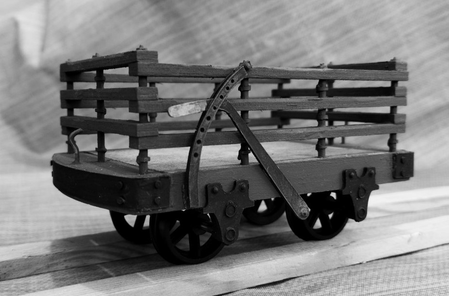

At first glance, it's pretty similar to the Ffestiniog's wooden slate wagons, so my first attempt at a model used the classic Binnie kit. The problem is it's clearly too narrow, so Take Two involves Lineside Hut's wider wagons intended to run on 45mm track, as suggested by JMORG. LH kindly made me a special version of the kit, with an extra chassis piece, so I can use larger wheels of the correct pattern.
So far, I've made up the kits, with various minor modifications along the way, including biro inner tube slices on the uprights to represent the "bobbins", extra planks along the sides, and Binnie axleboxes. I've pinched the distinctive brake handle from the original Binnie version, which will revert almost to its original FR guise as art of the project.
Before I undertake lettering and weathering, I thought I'd temporarily put it together and try a quick recreation of the works photo - and here it is:
Gloucester slate wagon B (2).jpg (133.21 KiB) Viewed 18863 times
You can clearly tell that it's an approximation rather than an accurate model but it (and its unbraked twin) are turning into quite attractive models, I think...

Looks very good Andrew. As you say "approximation", but the curved brake plate should have 2 rows of holes and a man of your perspicasity could surely knock one up from styrene?
Post by Andrew » Thu Dec 08, 2022 10:01 pm
philipy wrote: Thu Dec 08, 2022 8:49 pm Looks very good Andrew. As you say "approximation", but the curved brake plate should have 2 rows of holes and a man of your perspicasity could surely knock one up from styrene?
Ah, naturally I would have loved to make myself go cross-eyed doing that, but that's an optical illusion - the second row's on the rearmost plate. Phew!

Question..... on the 12" scale wagon, with 'bobbins' on the posts, how would the laths be slotted on and what then keeps them in place?
Post by Andrew » Fri Dec 09, 2022 9:29 am
Peter Butler wrote: Fri Dec 09, 2022 9:09 am Question..... on the 12" scale wagon, with 'bobbins' on the posts, how would the laths be slotted on and what then keeps them in place?
I don't actually know, but there are nuts on the top lath, so I think there's probably a threaded rod that runs all the way through, with the bobbins acting as spacers?
