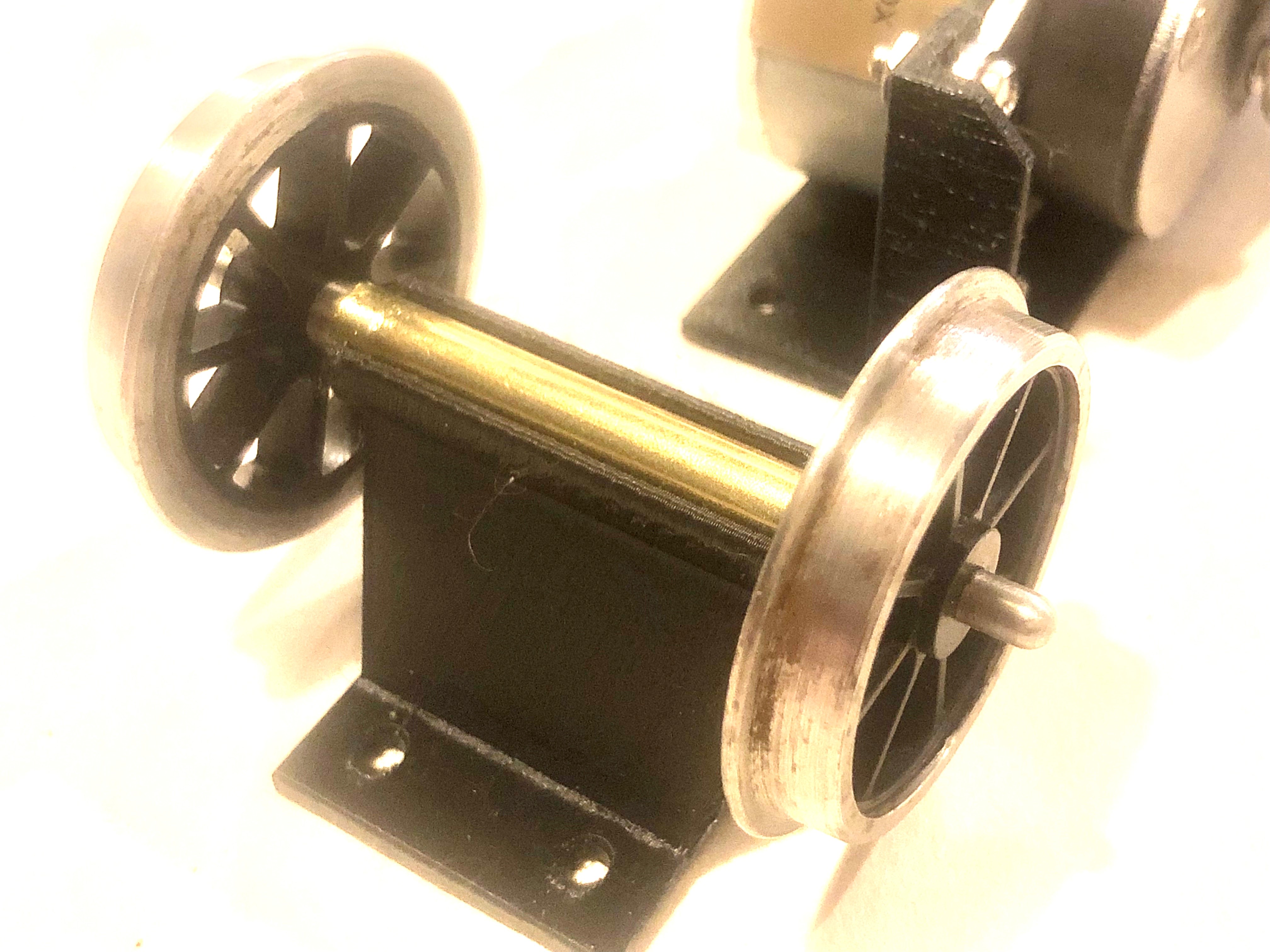

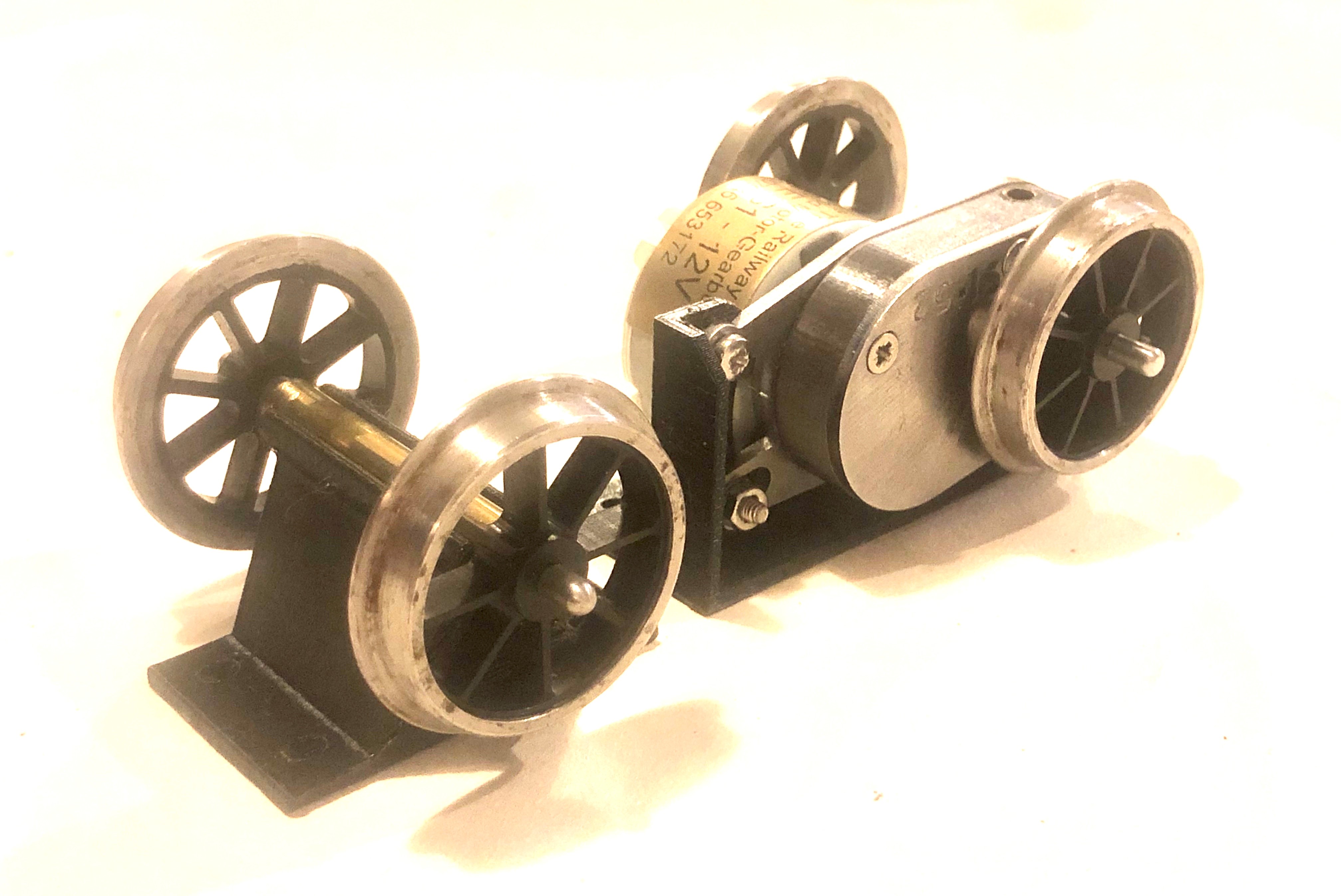

Tim Gleed-Owen of Apple Tree looked at the issue I have of being able to mount his motor/gearbox without outside hubs and this is what he has produced:
Apple Tree Bracket-4.jpg (1.36 MiB) Viewed 97036 times
Apple Tree Bracket-3.jpg (745.08 KiB) Viewed 97036 times
Apple Tree Bracket-2.jpg (1.1 MiB) Viewed 97036 times
Apple Tree Bracket-1.jpg (873.67 KiB) Viewed 97036 times
  • Wheels/Axles: These are slaters from the G1 (10mm) range with 1/8” ends and 3/16” axles.
  • End of the axles can cut off flush with the wheels.
  • Any axles set from the wagon/coach range will fit.
  • Hangers: Axle centre height from the base is 21mm
  • The height can obviously be increased by packing under the bracket but is the minimum centre height.
  • Price: Each bracket with fittings is £8. As per photos that's the brass tube with axle stand and fasteners with gearbox stand (motor/gearbox not included)
Note: I have no connection with the business, just very happy with the supplier help and assistance.
For further information please contact Tim on appletreerailway@icloud.com
Moderators I hope this not fall outside the scope of permitted posting, just trying to assist anybody who has had similar issues to myself in tram building.

Re the actual system, my only comment would be that it would be preferable to put a recess in the centre of the trailing axle mounting and use top hat bushes at the ends, rather than the tube. Less friction that way and less chance for muck to get jammed in the tube, plus less solid lump under the vehicle.

Philip, the issue was the narrowness of the bogie frames, not being able to support top hats in the axles boxes, so the actual axles support was inboard of the wheels.
Swift Sixteen uses the tube method for many (if not all) of his kits. I can't say I've noticed any issues with them on the kit's I have in use.
