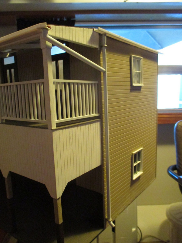

With "Victoria" overhauled and awaiting testing, the bench was clear for the pub to re-occupy it. The downpipes (non-funcional, they'd just clog) had been made some months ago, and could now be fitted using screw eye-hooks for picture hanging, as "good enough" mounting brackets. Holes were pilot drilled for them and Sikaflex applied to the "threads" before screwing them in. After fitting the downpipes, the brackets were etch-primed.

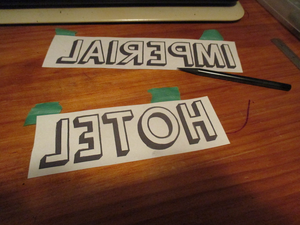

After more practice by lettering the aforementioned bank, it was time to bite the bullet and letter the fascia. I don't have the skill to hand-draw my templates, so these were made in the computer, reversed, and printed out some months ago. A hard charcoal pencil (with frequent stops for sharpening) is then carefully used to outline the letters.
The outlined templates were then carefully positioned on the fascia, taking my time to ensure they were correctly located. With that, one could see the letters' edges through the paper; these edges need to be rubbed with something, to transfer the charcoal pencil outlining to the fascia surface. I find a cheap ballpoint pen is best, as the ball rolls over the paper without tearing it, and the ink lubricates the ball and shows clearly where you've already been over, without soaking through the paper. Carefully flipping up the paper reveals where the charcoal didn't properly transfer, so you could either run the pen over the paper again, or touch up the surface directly with the pencil.

Looking good Aaron. I'm in awe of your patience doing the lettering by hand, and using picture hanger eyes as drain pipe brackets - what a great idea! That's something I always struggle with. Thanks for the tip :thumbup:

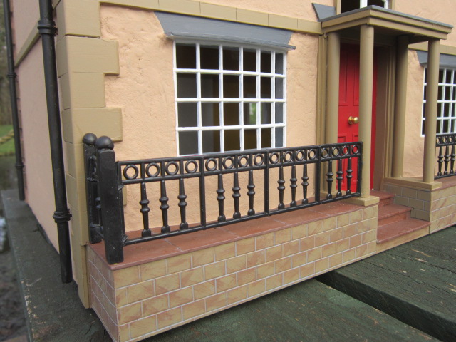

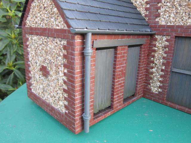

I have tracked down some pictures of down-pipes I fitted to my structures back in 2016 (mentioned on my Time to build a railway thread) where I described using picture screw-eyes with the addition of a small collar of plastic tube either side. This helps to make the 'bracket' more realistic.....

Peter Butler wrote: Fri Apr 09, 2021 2:22 pm I have tracked down some pictures of down-pipes I fitted to my structures back in 2016 (mentioned on my Time to build a railway thread) where I described using picture screw-eyes with the addition of a small collar of plastic tube either side. This helps to make the 'bracket' more realistic.....
Clearly a detail I missed Peter, or filed in the wrong brain cell :lol:
